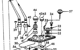

Ive gotten this ford 2600 1975,ish tractor from my father inlaw. I know now it is a deisel powered tractor, it has 2 wires on the gear box tunnel. I am assuming they are for the glow plug switch. That is just a guess, maybe it did not have a switch for that. But anyway here is a pic of the wires, and the tractor. Thanks in advance for any help, as I am tractor illiterate.

Actually.. pic #1 unquestionably nails it for a ford trans cover... it's a SN switch..
under that cowl there will be 2 wires but connector-ed together so the solenoid pops when the key turns...

According to NH Parts, that is a Safety Starter Switch, Item Number 55. It is connected to the Neutral Start Switch inside the tranny.

That is definitely the neutral safety switch. That notch in the sheet metal beside the wires (as seen in your first pic) is where the wires should come through. If you remove that cover with the notch in it, there should be 2 wires hanging down with a molded plug on the end. There are 2 halves of the plug, 1 on the safety switch harness and one on the main tractor harness. Each plug has a male and a female. These are round bullet type plugs.
When the neutral safety switch would fail, a lot of people would cut those wires (like done to yours) and connect them together to bypass the neutral switch. With this switch bypassed, the tractor can now be started in gear.(not good)
If it was mine, I would definitely fix it. If you choose not to, please be careful.

The purpose of the cut wires has already been described accurately twice in this thread. THe cut wires and underlying switch can be tested with an ohm meter without the bother of removing the transmission cover. Sometimes it just doesn't make sense for an admitted 'tractor illiterate' to engage in recreational disassembly.
