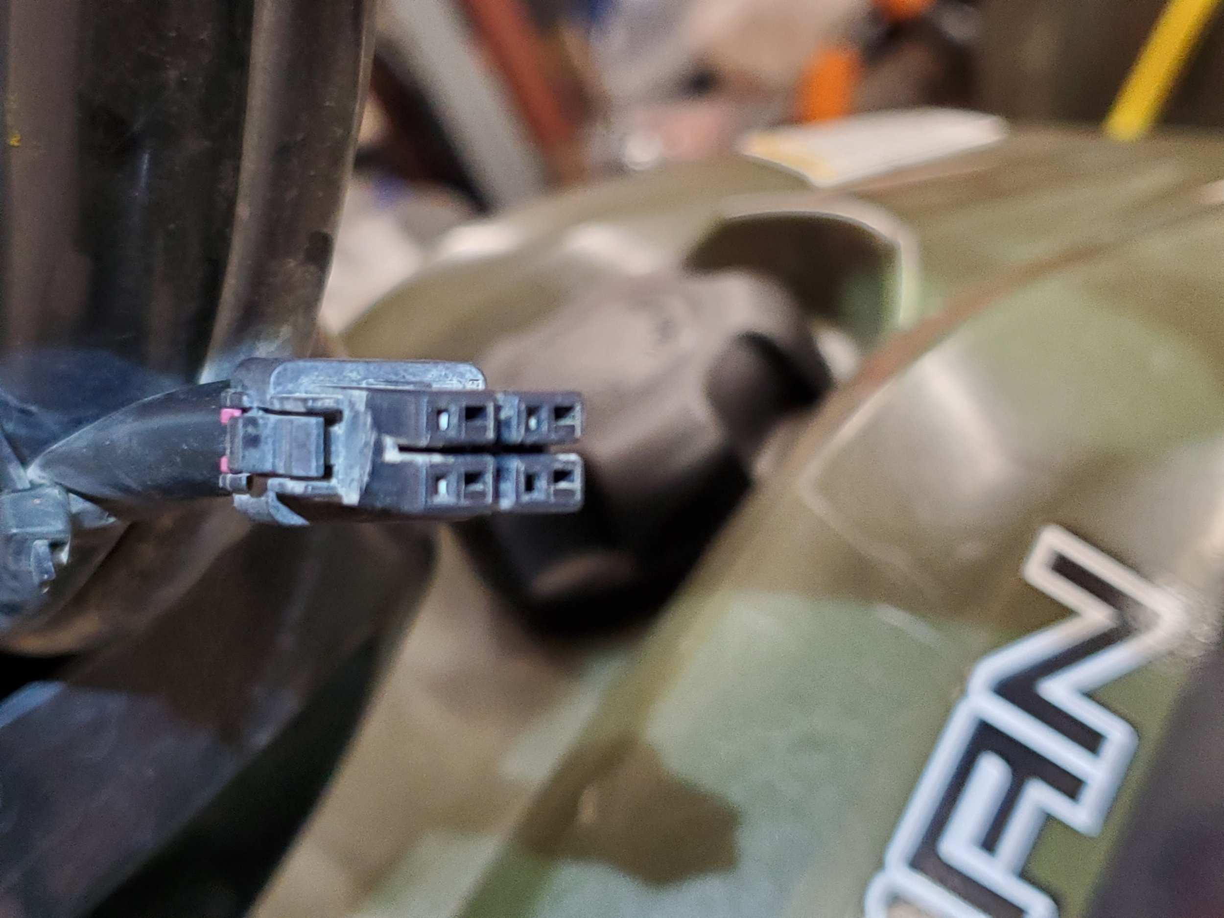

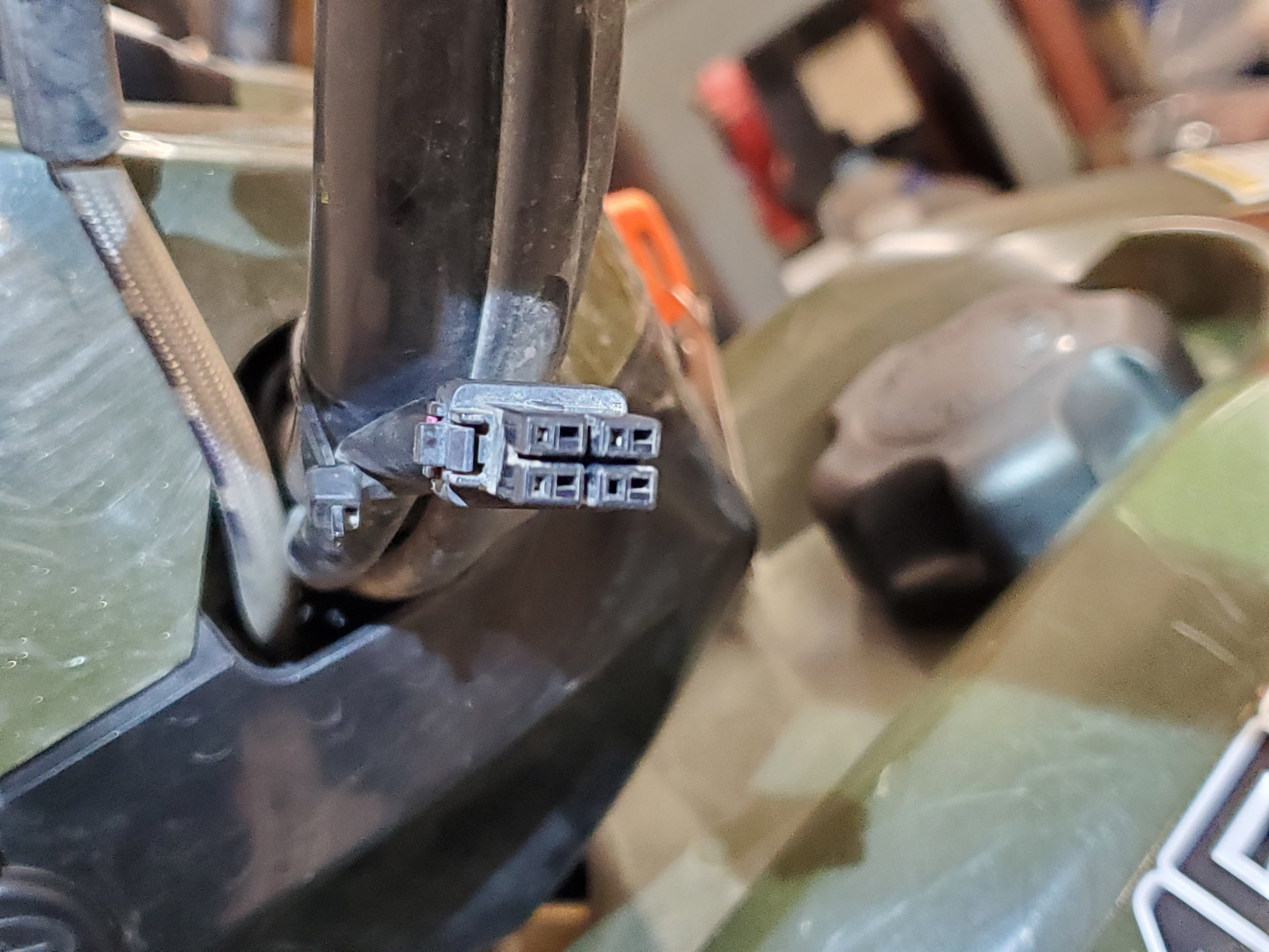

'16 Polaris Sportsman 450. Anyone know what this socket is used for? It is capped off under the left handlebar.
   / Mystery pigtail socket #2
Does wiring go into handle bars ? Might be a hand warmer add on option .
No, it disappears into the harness inside the pod. There isn't another one on the right side. Seems to be too many wires just for a horn button.
   / Mystery pigtail socket #4
Winch control?
Winch control?
Possibly? But according to the service manual only the SPORTSMAN FOREST 570 EFI / EPS came with a factory installed winch.
But you are correct!
Thanks all. Factory winch wiring it is. Mystery solved.
