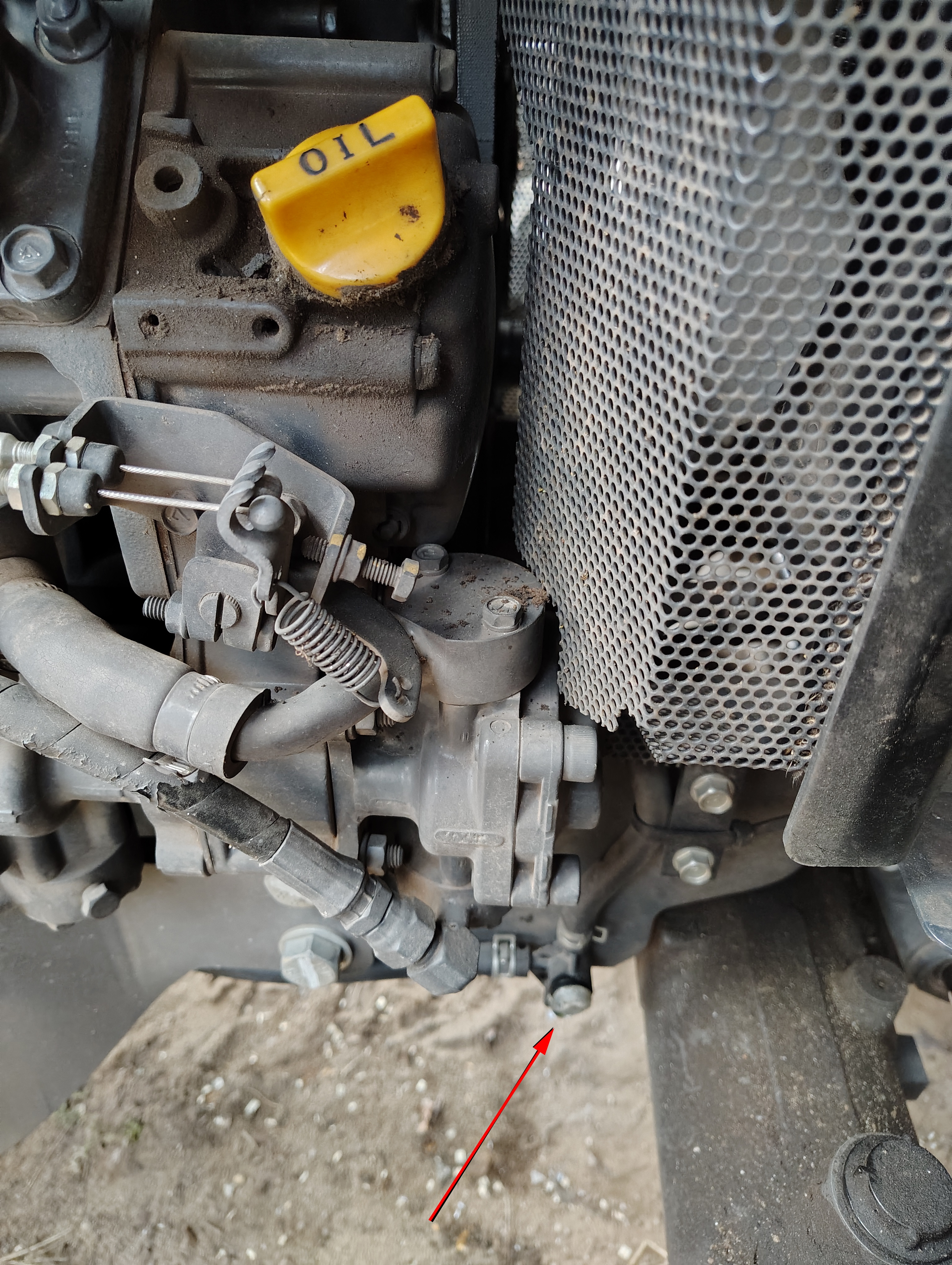

Can anyone tell me what this (see photos) is on my Massey Ferguson MF 1726E? It's on the right side, below the oil fill cap. It seems to be a cap or a valve in a rubber tube. I think the cap had a tab on it so you could use your fingers to turn it. But the tab may have broken off when my metal funnel fell against it. Either as a result or a coincidence, the tractor will not start now. It cranks fine, but does not fire. Any thoughts?

Looks like the coolant system drain. The left hose is pretty hefty though. Where does it go, to the block?
/ Mystery part
Yes, you're right. I finally was able to see that one end went to the engine block and the other went to the radiator. I opened it and radiator fluid came out.

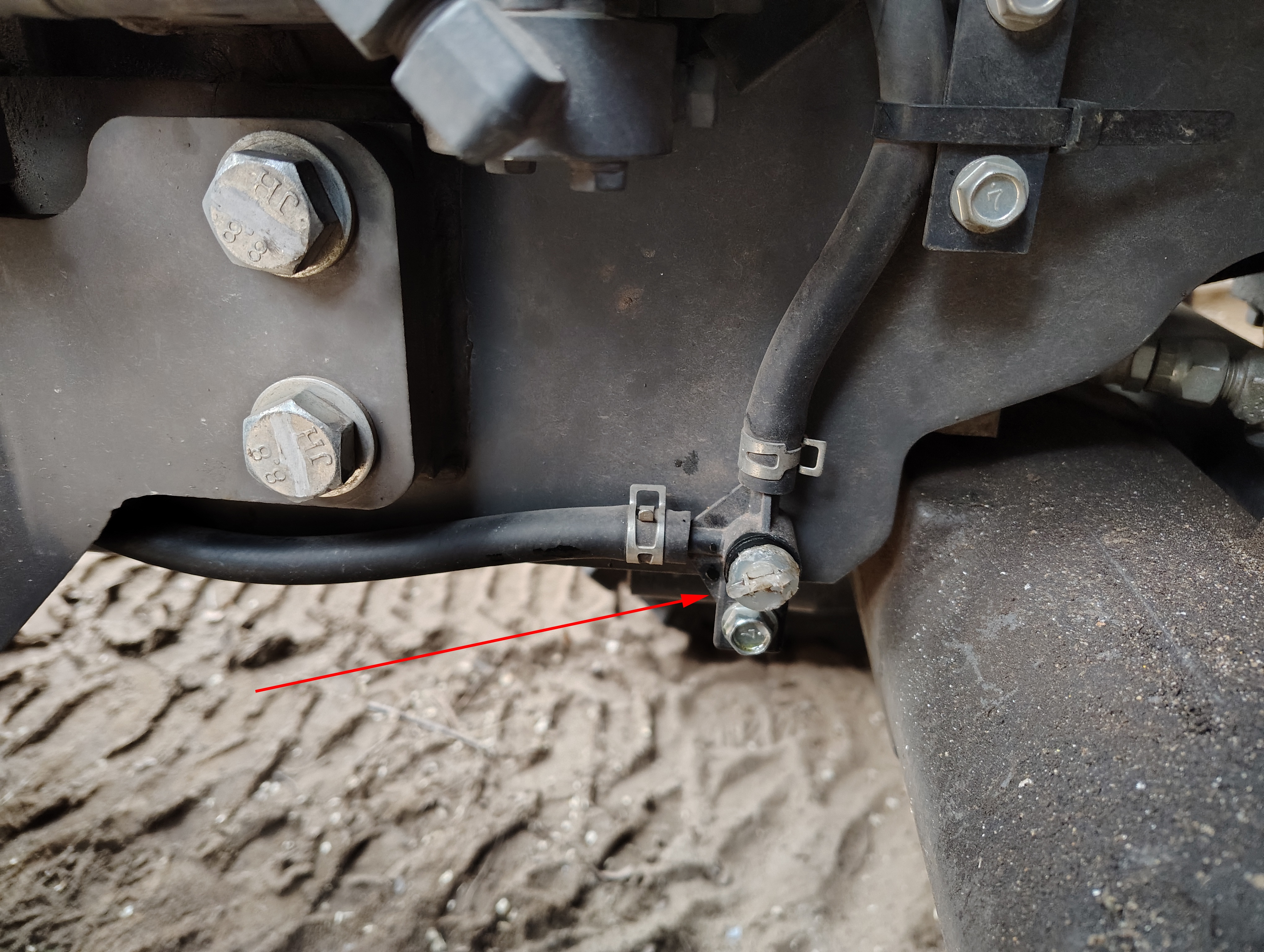

Thnx, but no, it's a coolant drain. See below--
/ Mystery part #7
Not exactly a great spot to put it. But, it's a subcompact, so there are not a lot of options.
