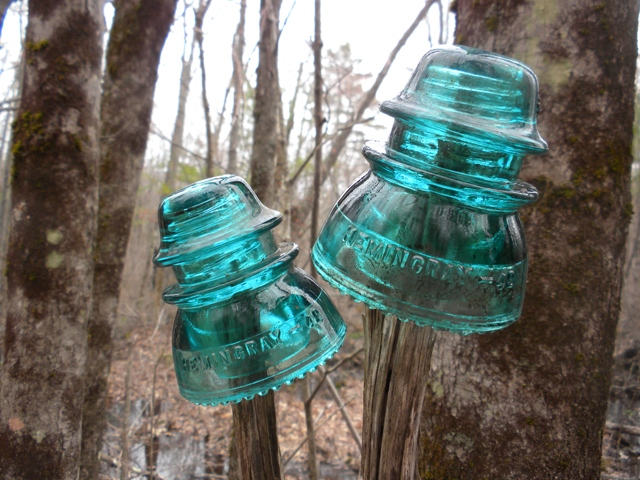

Brucix,
Maybe you'll be lucky enough to find other treasures at that site.....
Last weekend I found these two gems after seeing a setup like you found sticking up out of the ground about a mile deep in the woods along an old abandoned RR track .....
/ Mystery object in the ground #10
Not really worth much.....probably the story of the find is worth more.....:laughing:

Those glass isolators may actually have antique value. List them on Ebay.
I dug one of those Hemingway insulators up with my FEL a couple of years ago and thought the same thing. Turns out that there were more than 50 of them on Ebay for $5-$10. I kept mine for the conversation value it offers. Its fun to ask kids to guess what it is.

Brucix,
We found one of those on our place a few years back. It is clear glass and has the date December 1944 on it. It is now a conversation piece sitting on top of a gate post.

I've got around 60 glass insulators I picked up in 1991. Value was $2.00 back then. There are some out there that are worth $100s. Good Luck finding those.
