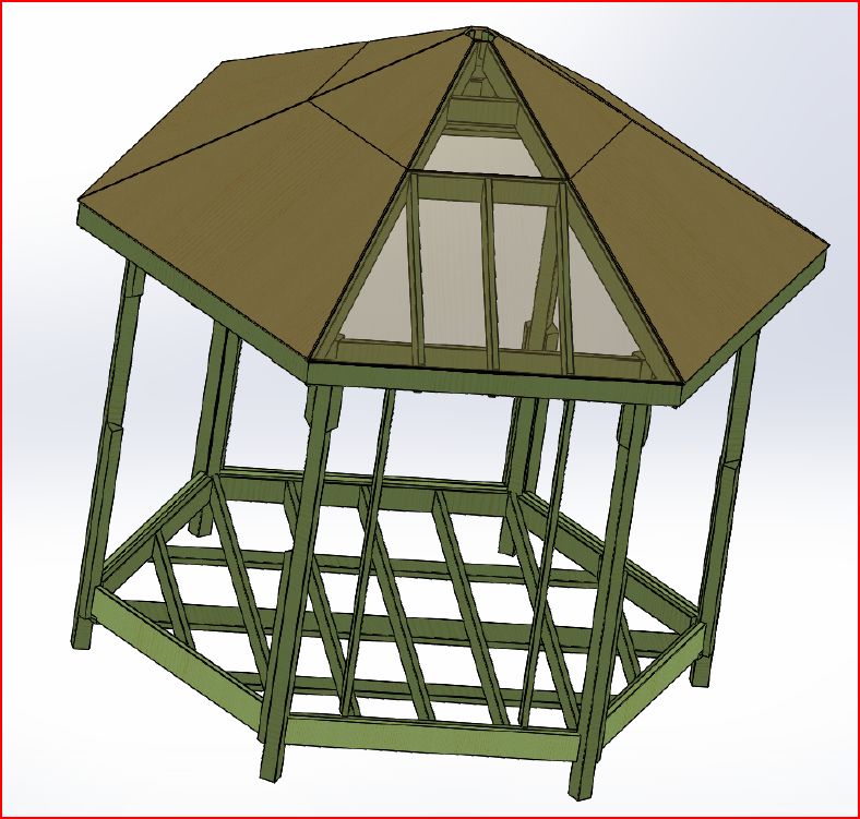

I got some pricing on the stock list I put together for my 10 foot Gazebo.
I'm thinking I should use what is left of the 22 gauge standing seam roofing when we had the solar panels put on our barn, asking the fellow who did our roof to get what extra he need s to sheath and roof the Gazebo after I get the frame up. That should be at least a 50 year roof. I'll be gone by then.
Including all Lumber, 5 sets of composite railings, Ten Fancy Iron Bracing, Screen Door, Screens, Railing and a step, Simpson Strong Ties all over, large Pyramid blocks for the posts, Metal roof, a Little Cupola,and all hardware and paint, I should do this for less than $3,000 in materials, and my DYI will be better built than any "Store Bought" or "Built on Site", production model at about 1/2 the $$$$ outlay.

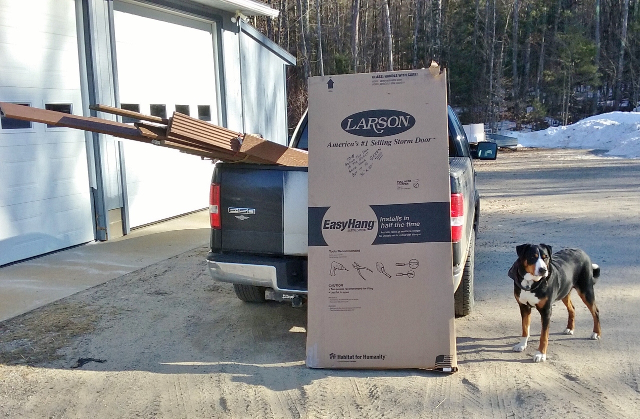

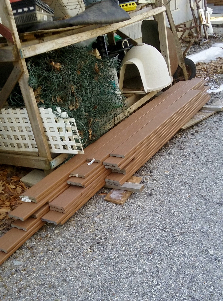

See photos what I picked up today at: All the decking, a nice door and some other trim for $320

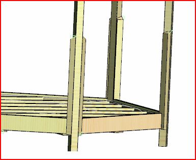

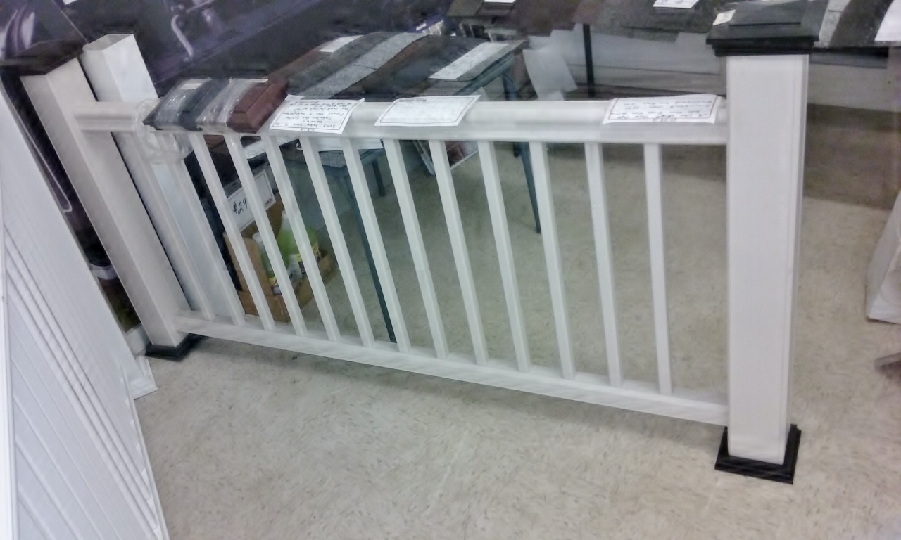

...5 sets of composite railings...
Since a gazebo does not have a solid wall to give it the sheer strength found in a house or other building, it needs all the support it can get. Your metal brackets will help, but the rest of it needs to come from the railing. When the railing is tied to the posts, it locks it all together. I went with steel on mine for the most strength that I could possibly get. Each of my railings are held in place at each end with four 6 inch Ledger Lock lag bolts.
My concern is that if you use composite railings, they will not provide any structural support.
   / My wife wants a Gazebo, Help!
#58
Eddie,
Your correct about the lack of stiffness due to no walls.
That's why I'm using the Simpson Strong-Ties:
Mudsupply.com - Specialty Construction Products
along a 2 x 6 with 2 x 8 Double sill.
The Deck is going to be plenty strong with the under deck bracers.
Maybe you can't see to well in the .pdf but I will have two mitered posts to the 4 x 4 post that I'll attach the rail to. These also screw to the sill and to the post.
The roof will also help.
My wife not thrilled about my chepo composite ides, even though they are the sturdy Aztek brand, so I maybe forced to go metal at 3X the cost.
So if anyone has suggestions on metal railings, please chime in.

   / My wife wants a Gazebo, Help! #59
I saw that extra lumber on your posts, but did't realize they where intended to add structural rigidity to the gazebo. I've never seen this before and I'm not knowledgeable enough to understand how it will work. Seems to me that the rotation point is still at your deck and that your posts are going to want to sway back and forth from that point if they are not locked together with something like a railing. You don't have to go with metal. I did because it's a look that I felt was important for what I was doing. Most gazebo's rely on wood railings to lock their posts together. Or you can always go with digging your posts into the ground three feet or more and getting your rigidity that way without any posts. There will still be some movement depending on the posts, how you anchor them (concrete or compacted soil) and how high you go with your roof, but it does allow you to not have a railing at all.
