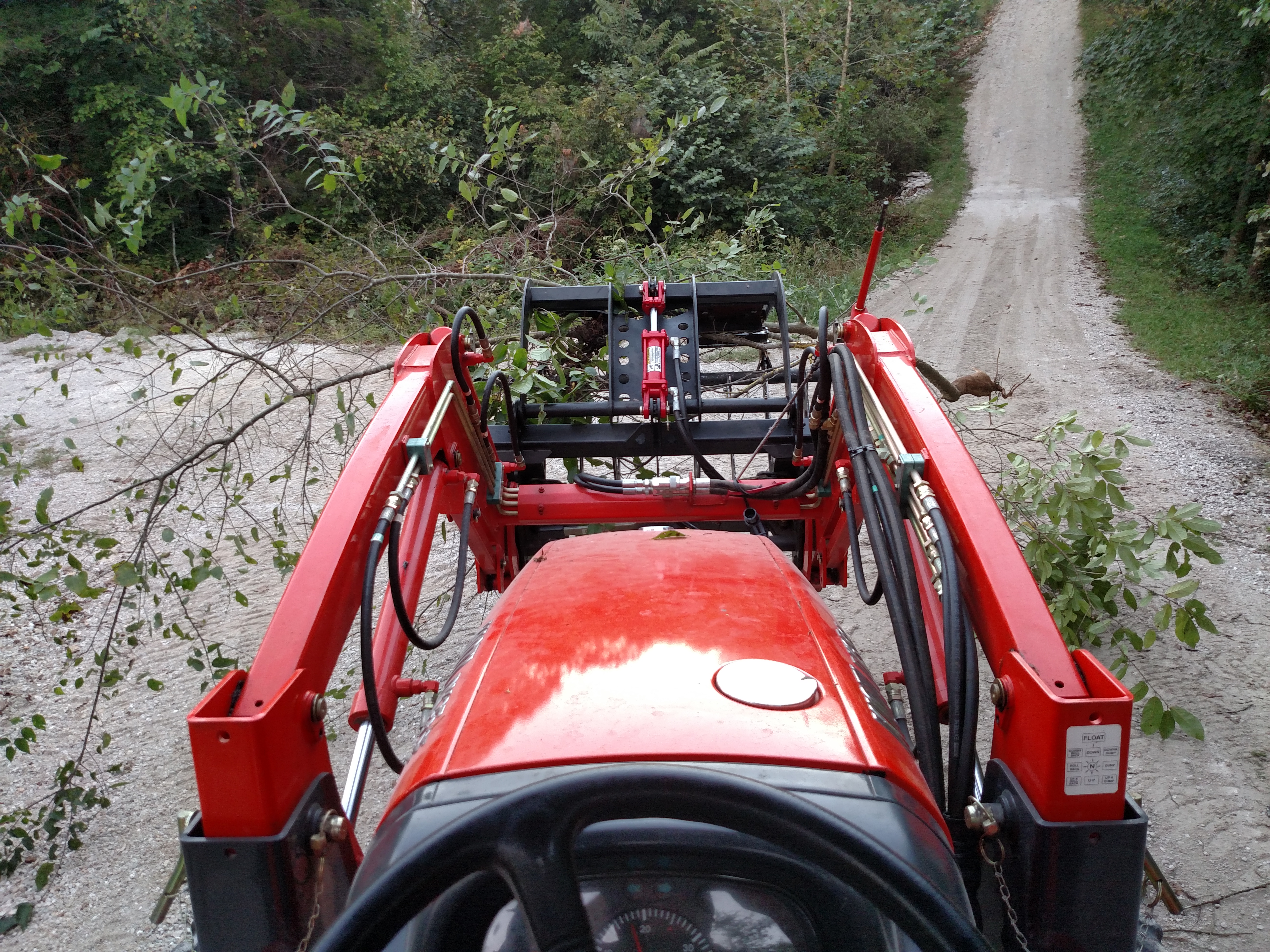

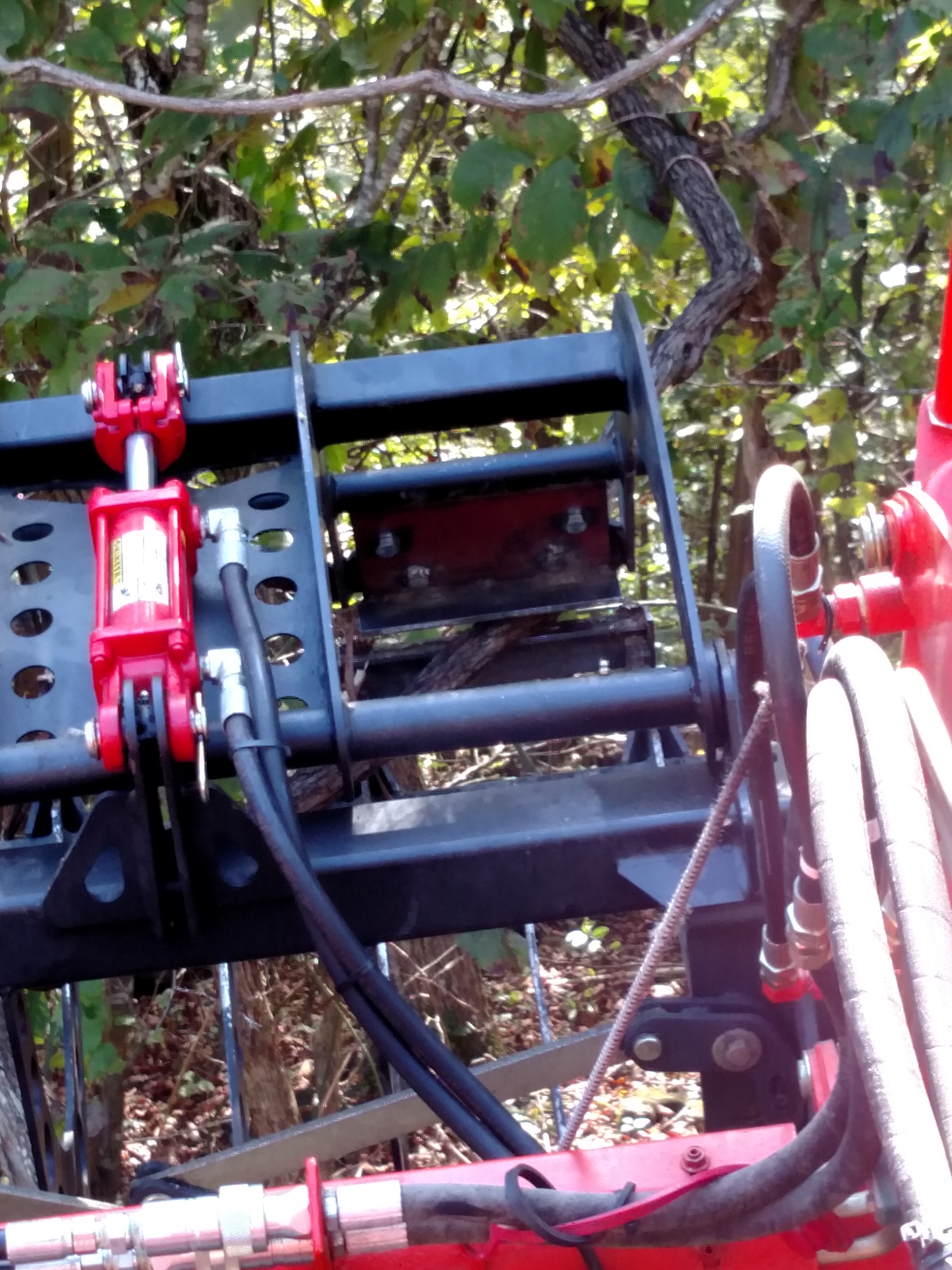

Yeah, I don't see how it can hurt anything. I did latch onto one larger tree with it and the FEL lift hydraulics went into relief. No damage. My original goal is just to use it for pulling up bushes, brambles and small saplings. It seems to work for that.

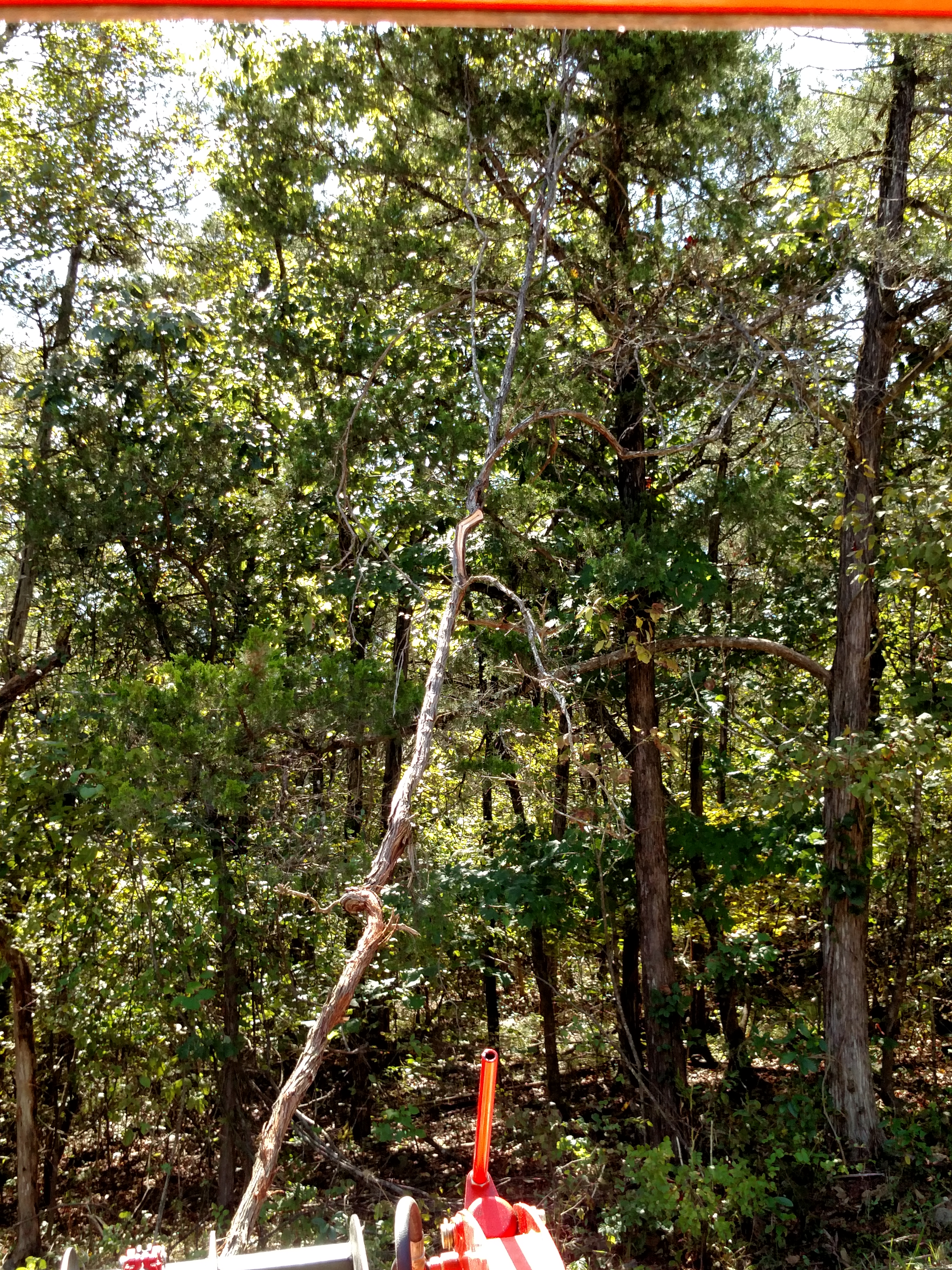

James, is the 2" limitation based on FEL lift capacity or how tightly you can grab with your mod?

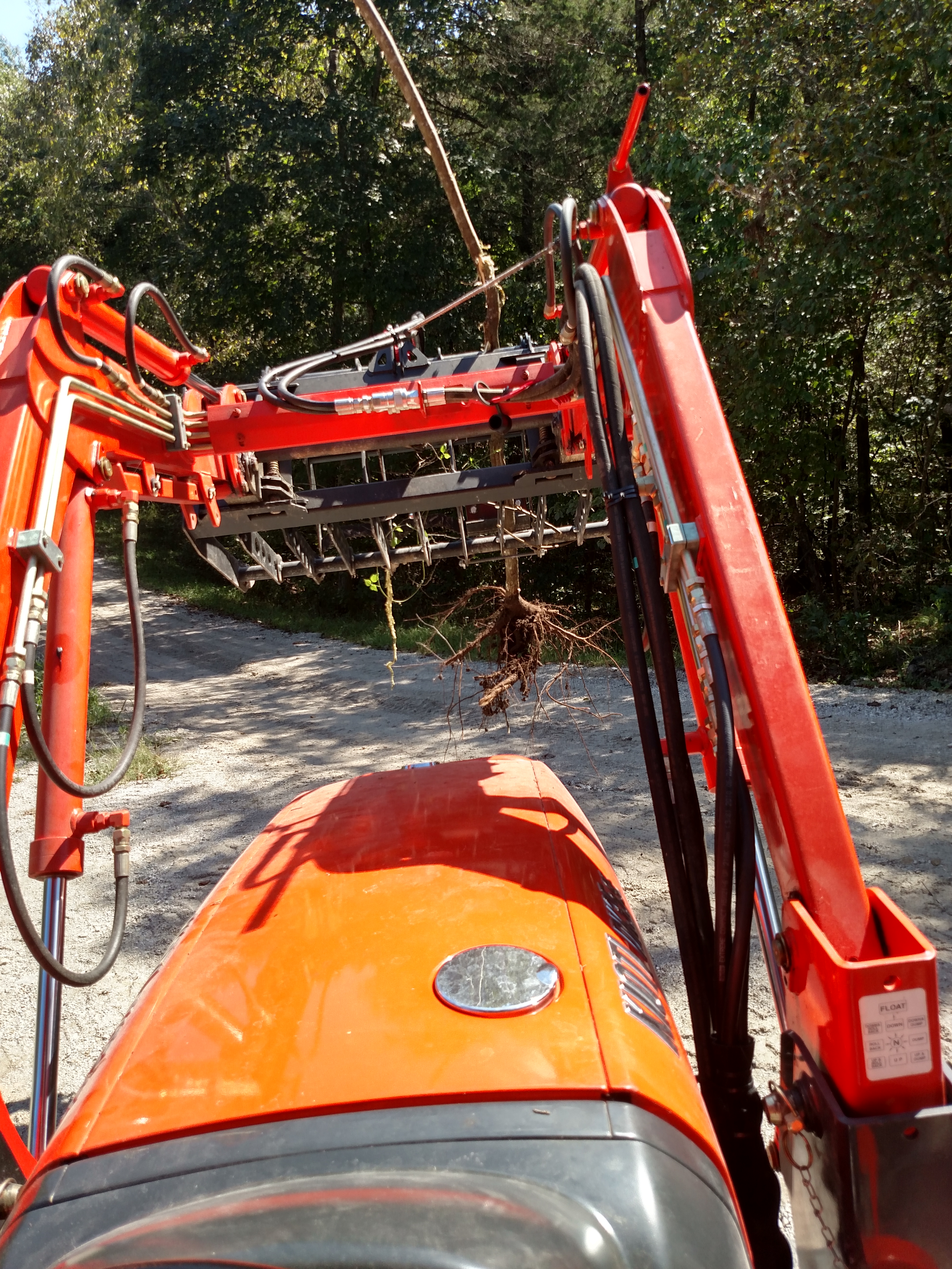

The FEL relief valve. I have went into relief several times. The best way to rip out the bigger ones seems to be to lift and curl a bit at the same time suddenly while moving the tractor a bit too with the hydro pedal. A 3 way application of force. But some things wont come out. Remember I have a lot of shelf rock and the even the little trees put roots down into the rock cracks.
This thing is so satisfying to use. Gone are the days of chains and a ground man. You can rip this stuff out in seconds and transport it immediately to the pile. This is more fun than mortals should be allowed to have.:laughing:

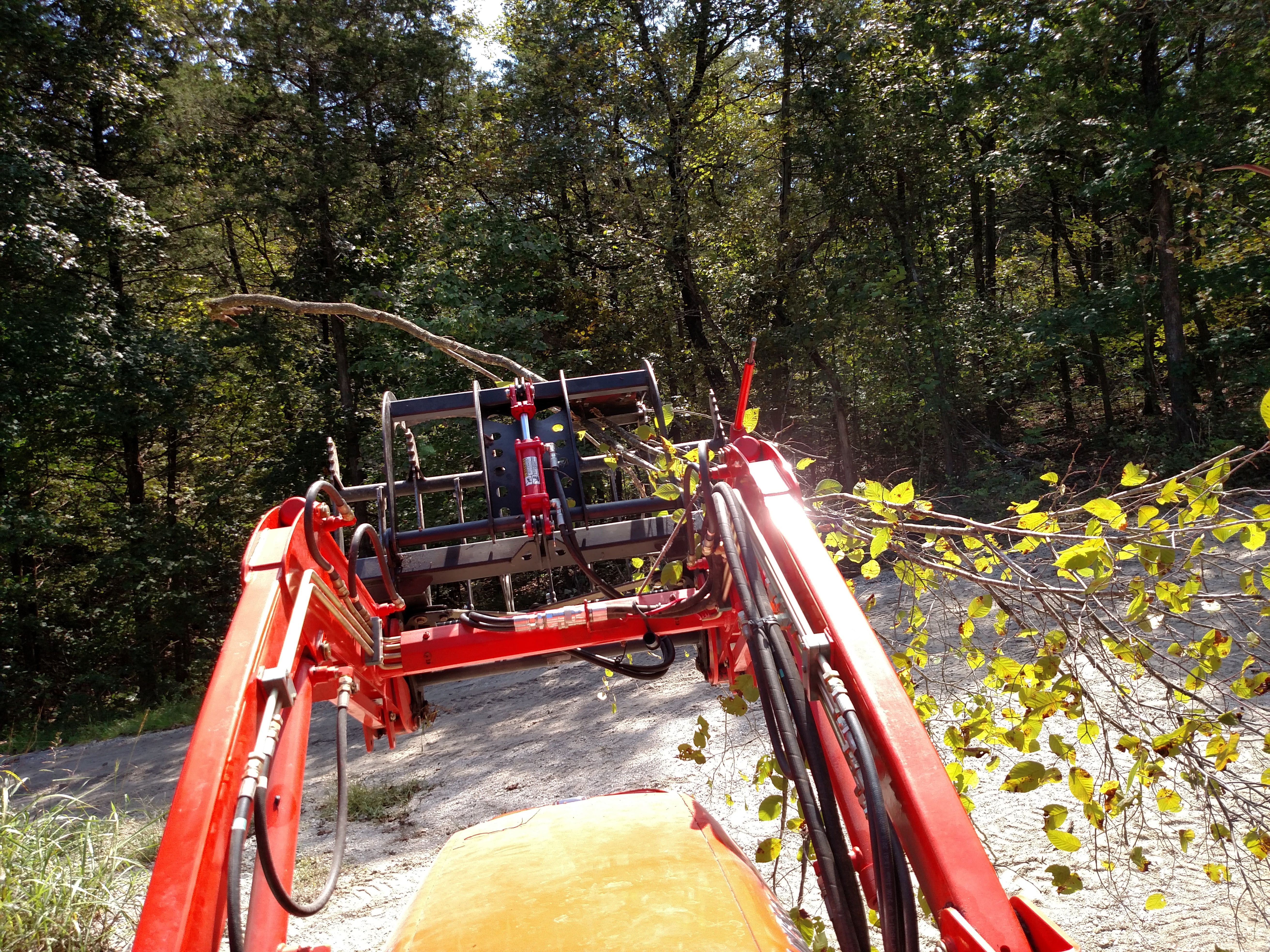

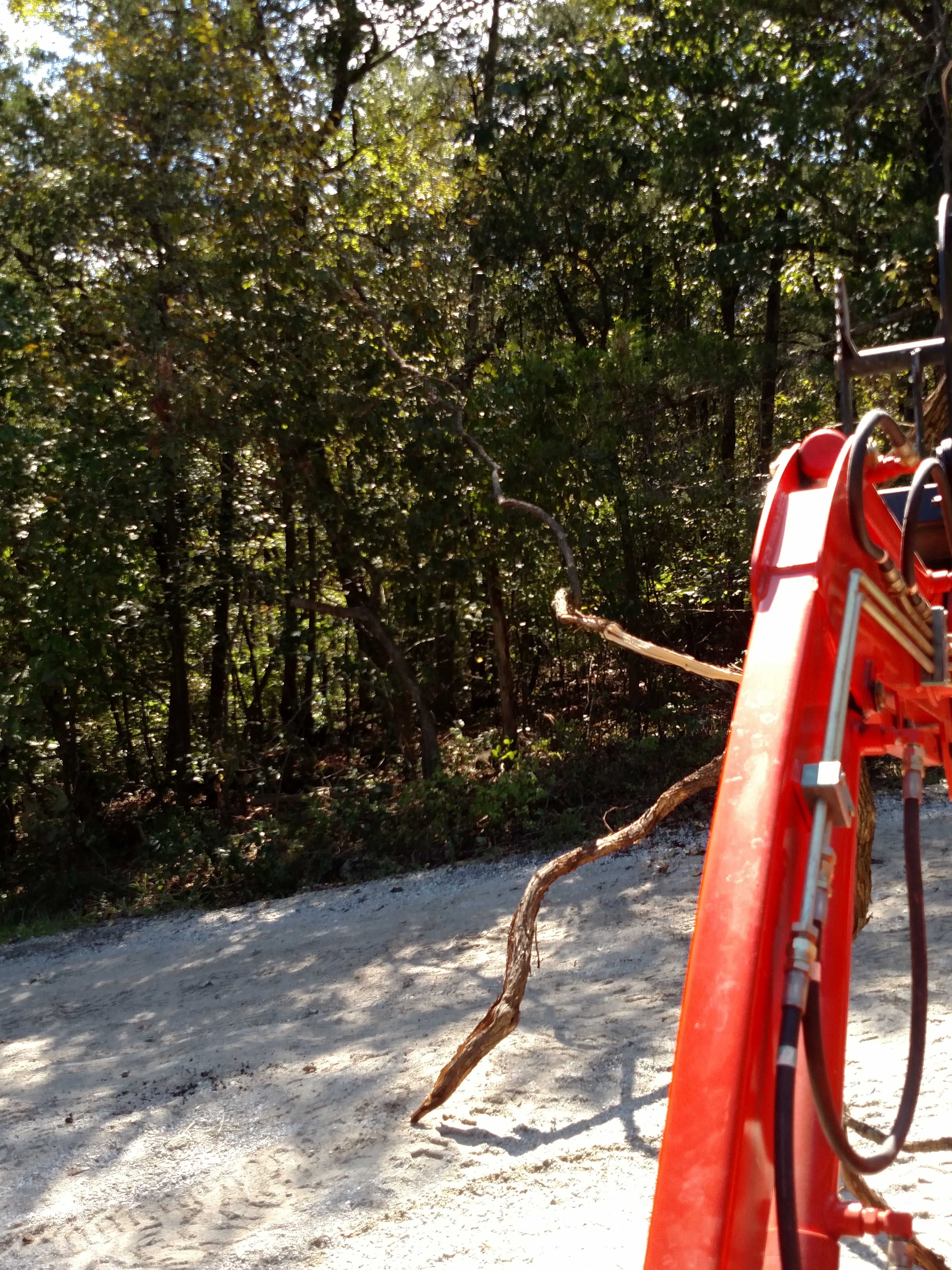

I may have to go hunting for some blackberries to yank. I pulled out a greenbrier the other day. Does that count?:laughing: This thing is so much fun to use. It really has worked better than I could have hoped. And if you look at it, the whole thing doesn't amount to much, and wasn't much trouble to make. A couple days ago I welded a 6011 bead on the lower jaw instead of the little 6013 bead I had originally and it helped it grip better. The 6011 rod if you remember makes a rough bead and that is what you need. some very small saplings have a slick surface and the really small ones would sometimes slip. I tried to pull some weeds but it just clipped them off. I need to practice feathering the valve.:D

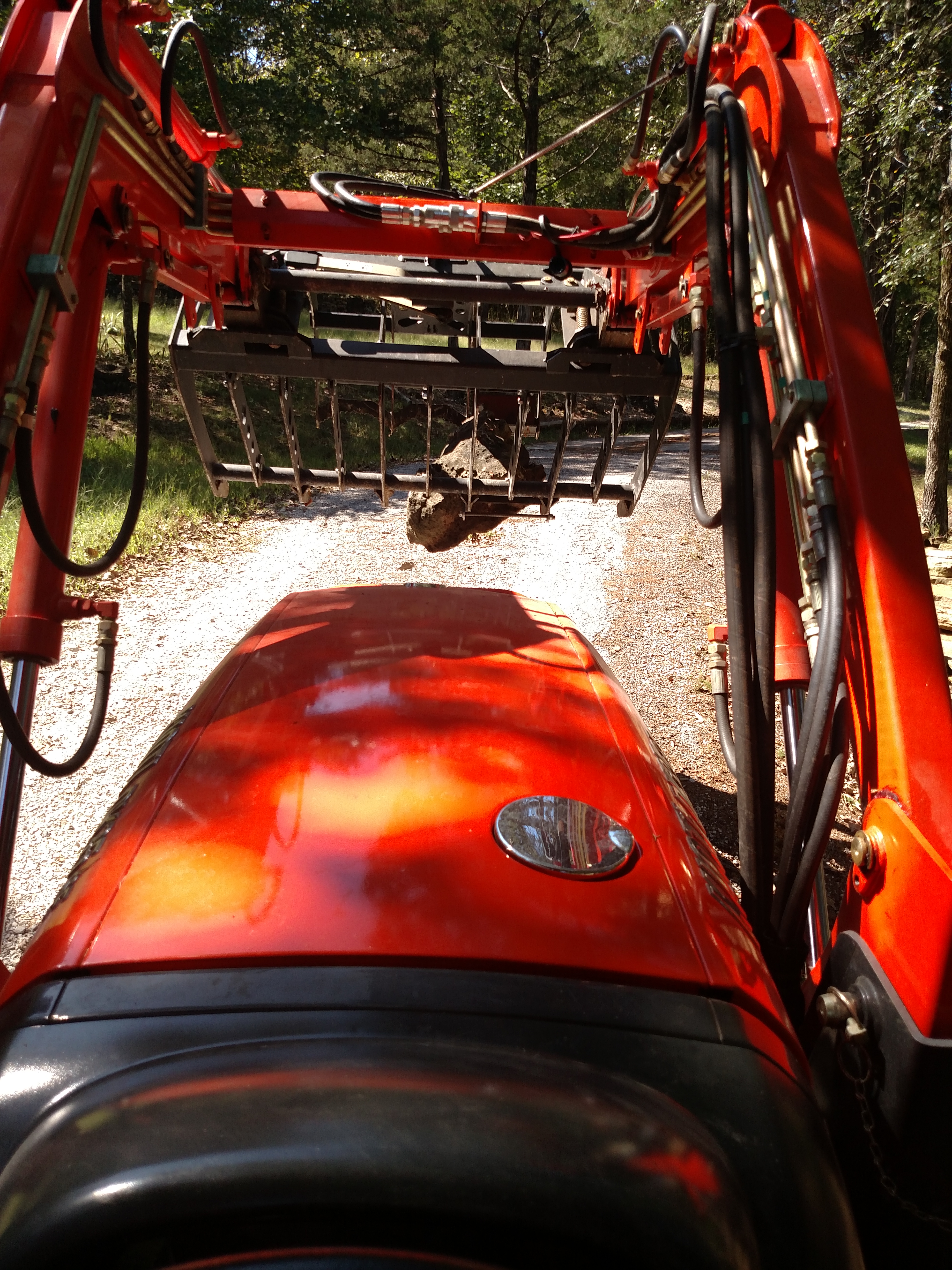

Yep, I think about anyone with some modest welding skills and a bit of steel could whip one up (or even maybe some better design) pretty quick. I am just astounded how useful this thing is. It even makes picking up small rocks easier. I picked up plenty of them before by pinching them between the points but this device makes it just a little easier.

Thanks. Yes, easy on and off, but the More I think about it, I may not take it off much. It doesn't really affect the normal operation of the grapple. I may wind up just leaving it on.
Of course I achieved my goal of no modifications to the grapple, but it would have been a lot easier to just weld up the plates directly on to the existing grapple parts. Hmmm. Maybe EA should include this as a feature.:)
