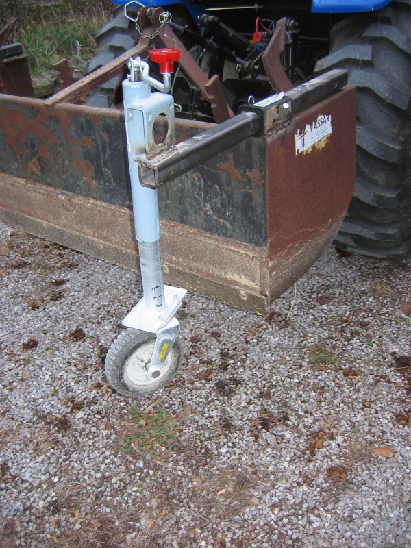

Just a quick update - Last weekend, I welded two more of the 6" tubes to the sides of my old box blade. It worked like a charm. I really needed the box blade to clean up some pot holes that the rake wasn't cutting. Changing from the rake to the box blade is a snap.
My old back blade is next, but it won't be so simple. I'm going to have to build a frame, something like SkunkWerx used.
Thanks to all who started and built this design. It is a great idea.

LH,
Nicely rigged on the BB! :D
They probably work very well being out there at the edge of the implement.
Let us know how they perform. ;)

I've never been happy with this box blade. I purchased it at a sale a few years ago and have only used it a few times without good results. I have been thinking of trading/selling it. I thought I'd give the wheels a shot. I couldn't believe the difference. It was like a different implement.
My drive is about 1400', going up a couple hundred feet in that distance. It goes up, makes a sharp 90 degree turn, up some more, then another slightly greater than 90 degree, then up some more. The first 90 degree turn frightens the whatever out of drivers, who slow, then spin their wheels trying to make the curve. So I get good size pot holes at that point.
The rake works great, but I needed more to shave the tops off the pot holes and the box blade worked perfectly for that - without being too aggressive. The wheels let me set just the right level. Trying to use it in the past had resulted in a less than perfect fix. I'm sure I might have learned to just use the 3pt, but the wheels just made it simple.
Thanks again for that first post.

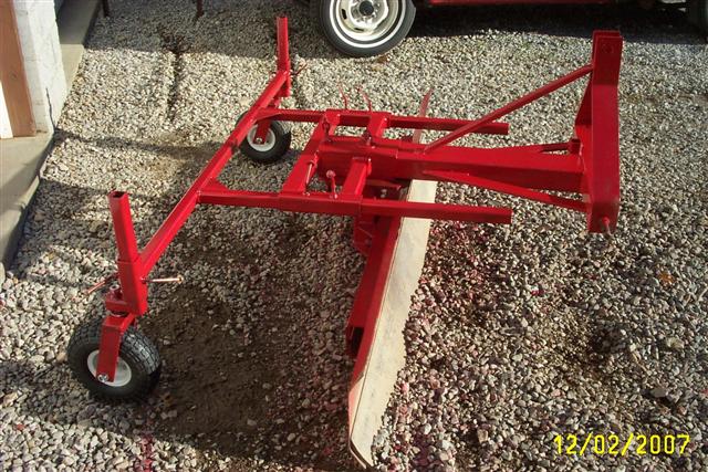

Haven't actually used it yet, but here is a hybrid somewhere between SkunkwerX and MadReferee's designs. I used the stock blade once and immediately decided to give the gauge wheels a try.
