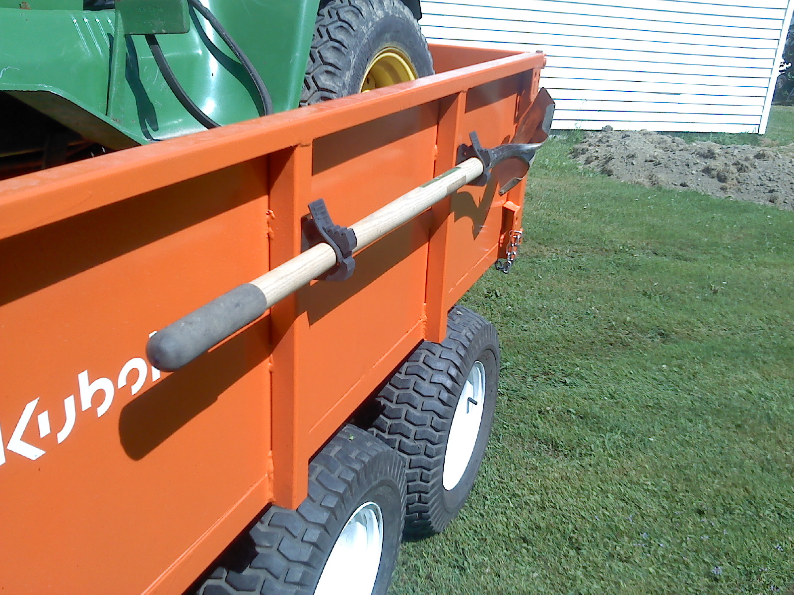

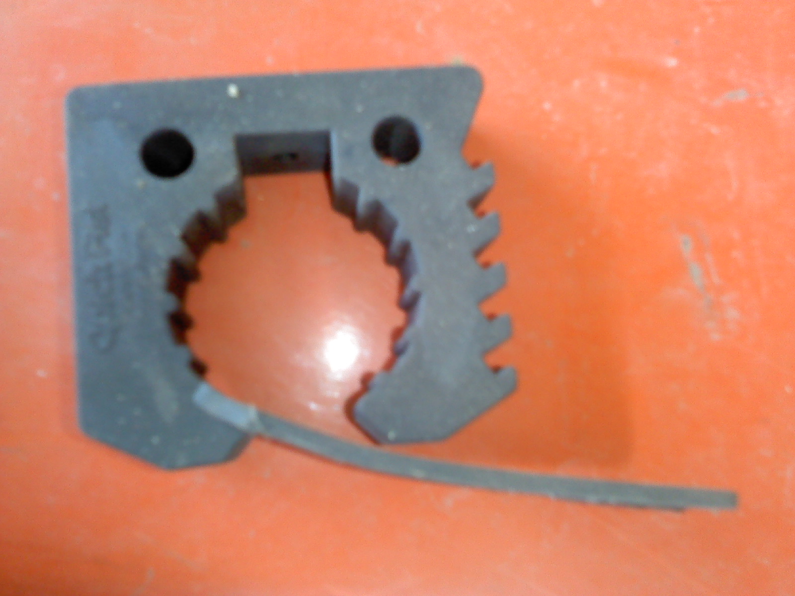

I made some modifacations to the KF DT2.16 today, I added some clamps to the side of the dump so I can carry yard tools with me. I may add another set, not sure. I bought them on ebay a couple years ago after I read a post on TBN about them but can't remember where it is. They are called Quick Fist rubber clamps and they work great :thumbsup: for holding all sorts of tools or pipe, I have one on my Quick hitch to hold my "D" handle round point shovel so it is always with me. I also put a SMV on the back so if I am taking it down the road I don't get hit from the rear.
The last pic is for banditbooker's benefit!!!! :laughing: :D I'm just giving an old timer a lift!!!! :D

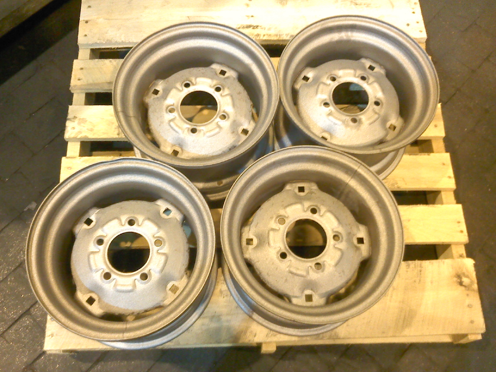

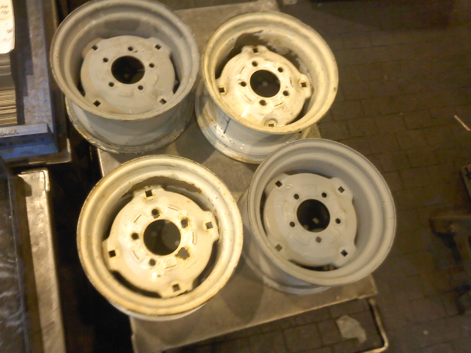

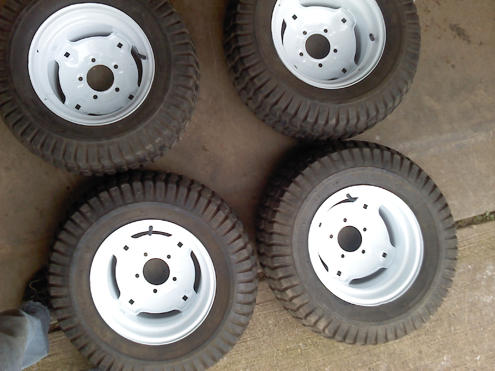

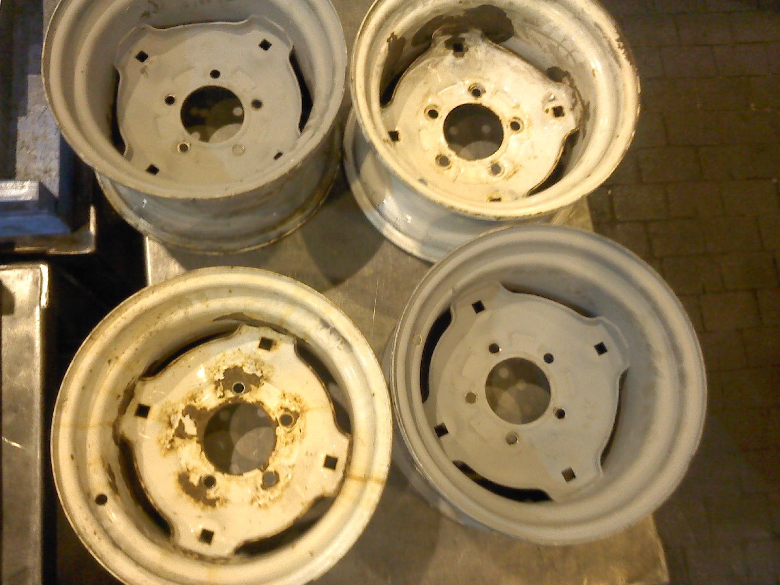

Wheels and tires used $20,
Hubs from salvage yard $20 and I pulled them off,

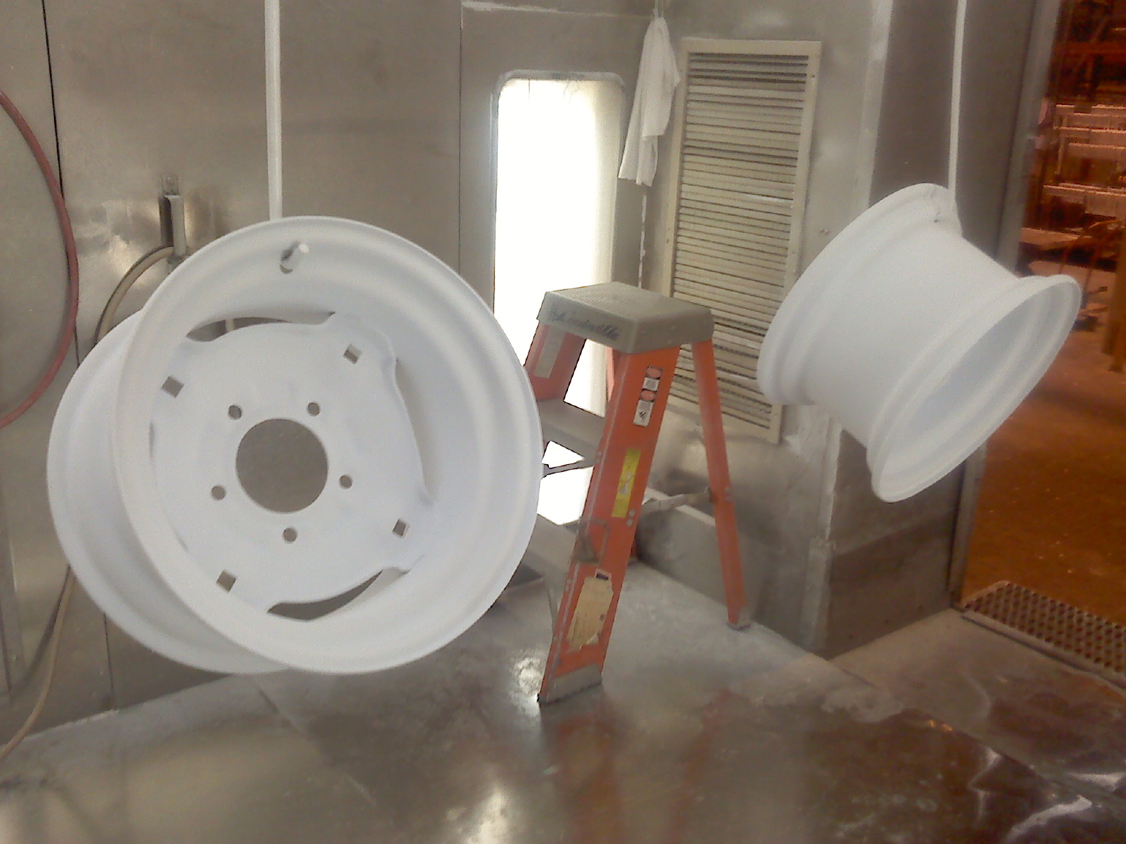

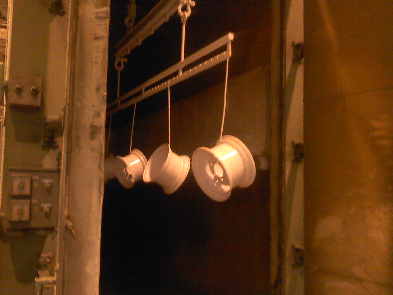

Primer and had someone else do it $125,
Paint and I did it $40

The tires are 23x10.50x12 and brand new at TSC are $109 each without the rims! Thats more than I have in the whole trailer!!!!!
