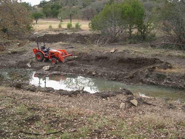

they say a picture is the next best thing, sooooo. many good holes to you in the new year. toothbar works like a champ....... /forums/images/graemlins/grin.gif

Just curious: In what conditions are you digging ? I need a little advice on these toothbars.
Does a toothbar only improve digging ease in clay or loam soils, or also in my Dutch conditions of sandy soils, free of any rubble and roots ?
How does it compare, for example digging with a 2 meter bucket with toothbar compares to digging a 1,5 meter bucket without toothbar ? /forums/images/graemlins/confused.gif
If a toothbar could make digging a lot easier, i need one too, but if the difference is little, i dont want one on my bucket when i am scooping up manure from the bunk silo... /forums/images/graemlins/smirk.gif
   / MY TURN TO SHARE ATTACHMENTS
#28
Let's see...best I can remember the soil there can be very compacted until it is loosened up. (I lived in Nymegen and Rotterdam when I was a kid before immigrating in 1957 and have never been back.)
So "digging" with the toothbar will be far better than without one. The 2 meter bucket with toothbar will dig better in your soil than the 2 or 1.5 meter bucket without....That is for real digging and not just "scooping" as you say. I noticed you don't have to loosen up the soil first (like ripping with my boxblade) to cut a section of dirt as I said in one of the earlier posts.
If the soil has already been loosened up and you are just scooping it up, it would be about the same. Although I have found the toothbar to "slide" into the soil easier especially if there are a few rocks or clumps in that instance as well. The most significant improvement I noticed besides "digging" is the ability to get some of those larger rocks into the bucket MUCH easier than without one.
Now that it is installed on my bucket, I doubt I'll ever take it off again. It becomes much easier to scrape up shrubs and loose debris than before.
