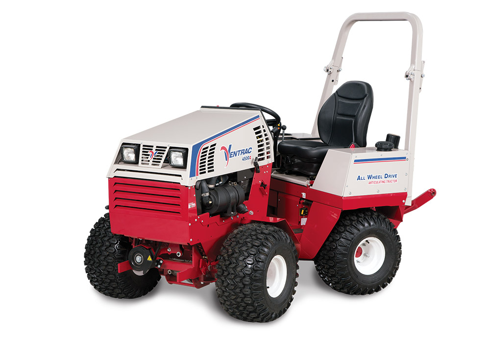

If you are looking for a tractor exclusively for mowing and turf applications there are none. I wonder if that would be rugged enough to stand up on rough terrain. My property is not a golf course. Then there is the issue of not being offered a front mount PTO.
For exclusively mowing and turf applications I recommend Ventrac, now a division of Toro.
THINK OUTSIDE THE BOX.
Far as tractor size goes the Kubota LX or Deere 3 series is the right size but is lacking some on PTO hp. The truth is those are my only two options far as (Three Point Hitch) tractors go that fit my criteria.

Ventrac 4500Y Dimensions​
Ventrac 4500Y industrial tractor photo
2012 -
4500 Series
Groundskeeping tractor
Variants
4500Kair-cooled gas
4500Pliquid-cooled gas
4500YKubota diesel
4500ZKubota gas/LP
Ventrac 4500Y Engine
Kubota 0.9L 3-cyl diesel
Fuel tank6 gal
22.7 L
Ventrac 4500Y Power
Engine25 hp
18.6 kW
Ventrac 4500Y Tires
Ag front21x11-8
Ag rear21x11-8
Lawn/turf front22x12-8
Lawn/turf rear22x12-8
Dimensions
Wheelbase45 inches
114 cm
Length81.5 inches
207 cm
Width48.5 inches
123 cm
Height (ROPS)68 inches
172 cm
54 inches (folded)
137 cm
Weight1655 lbs*
750 kg
1750 lbs*
793 kg
Ground clearance5 inches
12 cm
