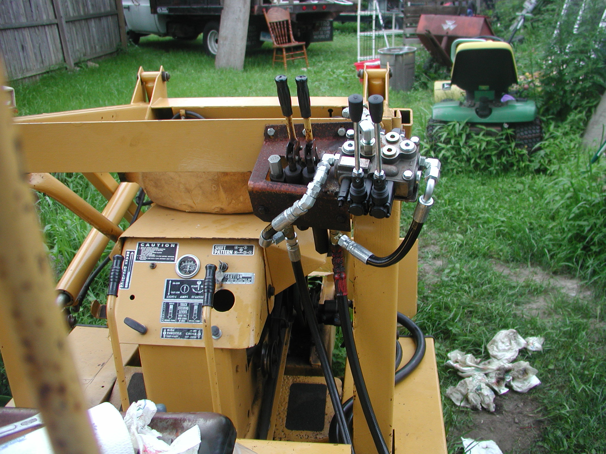

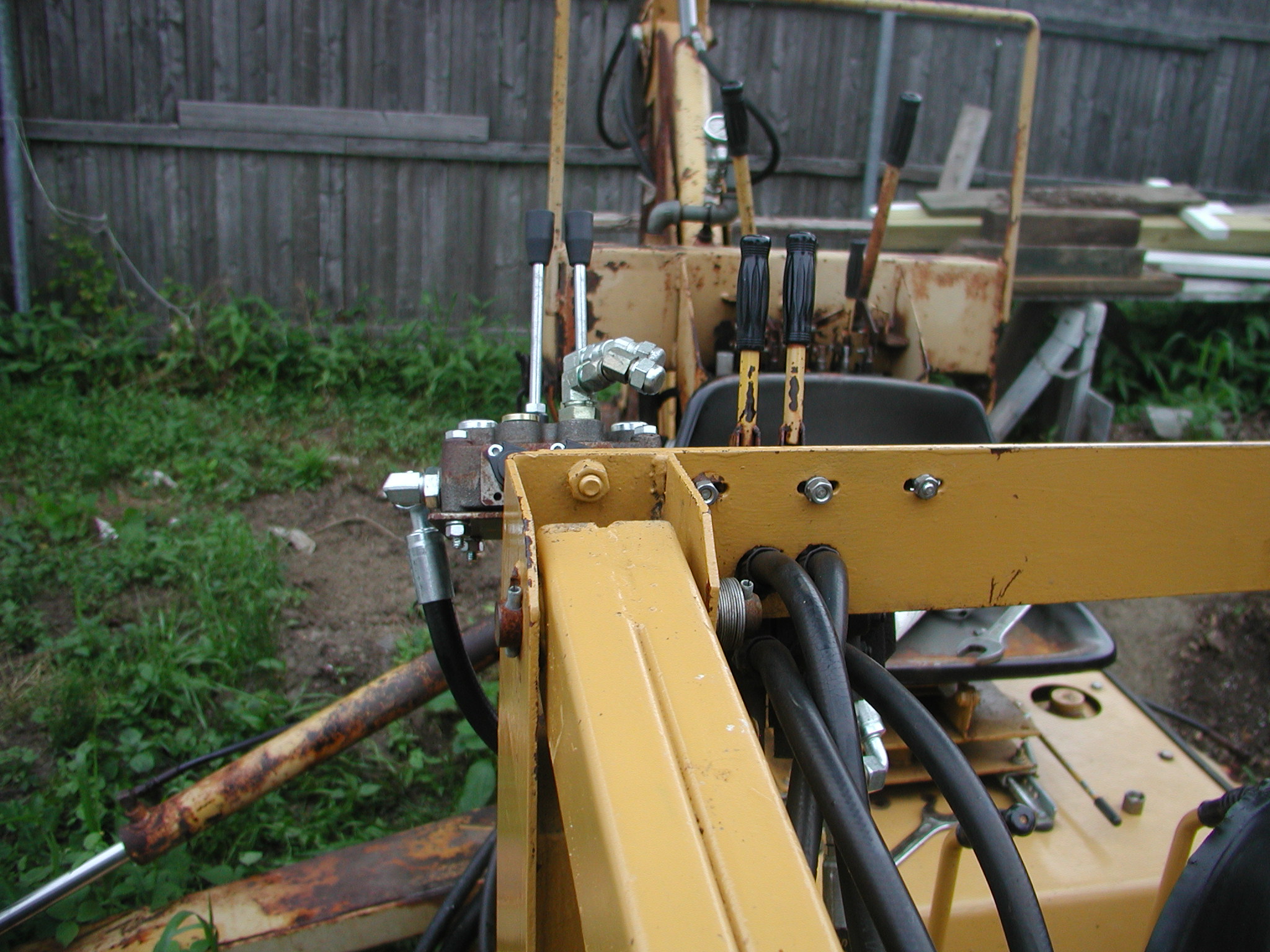

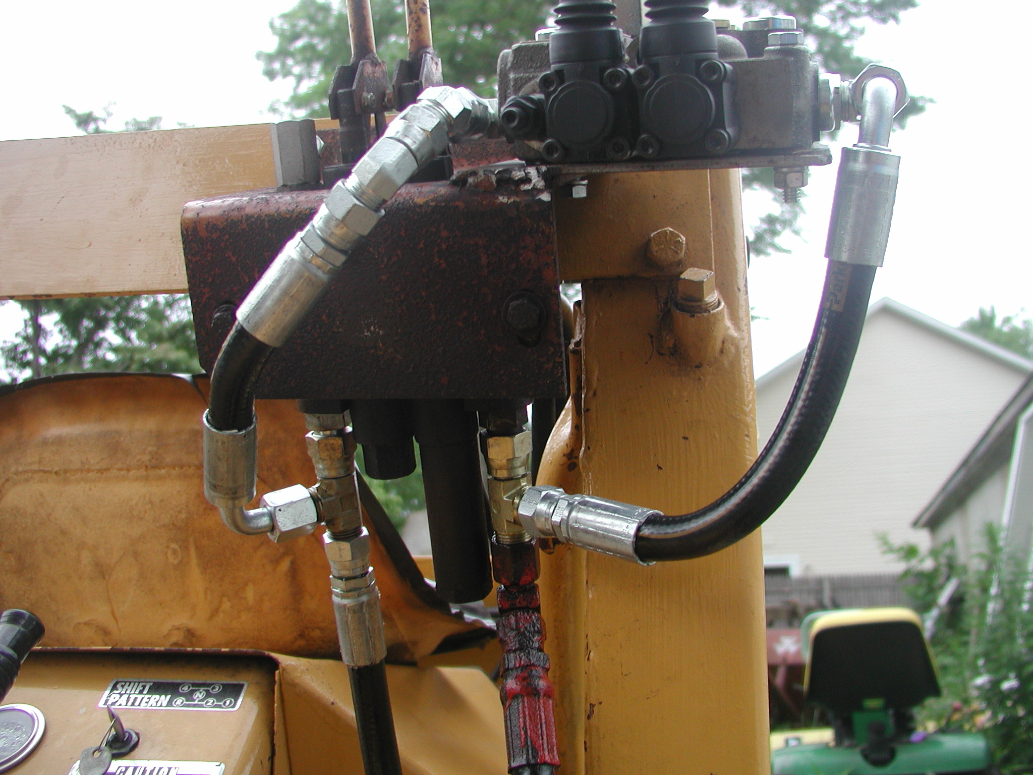

I just added a couple of valves to the loader side so I can use my grapple bucket .

I know you can't tee into a 'open' type system like that, so shall I assume this is a 'closed' system ?
   / My Struck Magnatrac
#29
Willl I was going to go series after the loader valve , buy my friend Frank T'd it in like that . The loader didn't work unleess I pulled a lever on the new valve first and held it until I put the internal plug in the new valve . I still havent tried the new circuit .
My loader is fed pressure from the hoe , what is the difference between open and closed system ?
   / My Struck Magnatrac #30
If you tee into an open center circuit, the fluid will follow the path of least resistance, and that will be through the old valve. So by pulling a lever on the old valve, you then blocked the flow of fluid through the valve and pressurized the new valve. You could slip a gate valve in the circuit and use one of the other. You really want a valve with PB.
If you put it in series, the the specs on the old valve should have the pressure on the input and the output the same, due to the fact that activating the second valve, the max pressure would be flowing through the first valve. If the old valve is not designed for the high return port pressure, you run the risk of damaging the valve, Some folks might not agree with that, but facts are facts.
