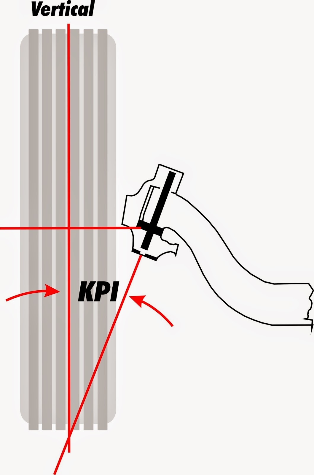

Auto Makers use "Load-Sensing" systems for over the road applications - which is why you can let go of the steering wheel after completing a turn and the vehicle wheels return to center on their own
With "center" based on the king pin geometry. Turning the wheels actually raises the vehicle, inducing the "load". The tendency then is to lower and center at the same time.

Auto Makers use "Load-Sensing" systems for over the road applications. Load Sensing systems adjust hydraulic pressure based on the load sensed from the front wheels, which is why you can let go of the steering wheel after completing a turn and the vehicle wheels return to center on their own.
In my experience, the reason the front wheels return to center on their own is because of the caster.
It works whether the steering is manual, power assist, power, or not connected at all. It even works on bicycles, motorcycles, and such.
