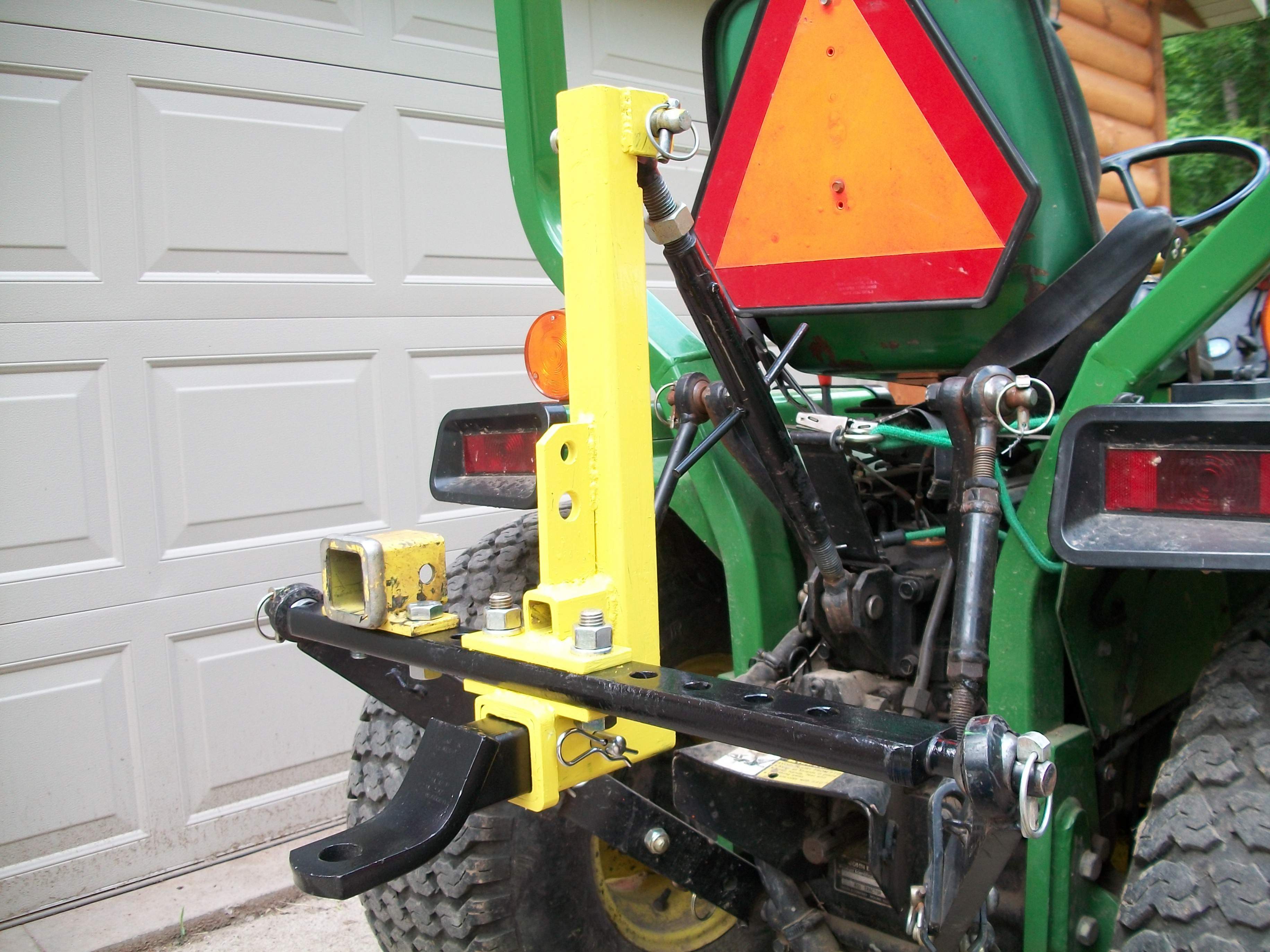

Since I like to build things, how well do you guys think my home made potato plow/sub soiled will work? My thought was to use it to make trenches for my drain pipe. Will it work?
When I bought the box blade it was missing the center ripper (mine only has three total). So I went to tsc and bought one they had. It was two inches longer, but the adjustment holes are very close.
Anyways, I got to thinking. Instead of buying a subsoiler why not make one? I had extra material around so.... I made an adapter for my trailer hitch/Reese hitch that I made... I drilled and tapped two holes in the tip of the ripper and bolted a small plow blade that I got at tsc for 6 or 7 bucks.
I haven't tried out the plow yet, but I did use the riper by itself and it works awesome! I might have to make some modifications to the plow because the angle of it when bolted to the ripper might be too far forward... Idk yet.
I took a piece of 2" box tube and used a porta band to cut out a slot for the ripper to fit.
Then I capped it with some 3/8" thick angle and added a forward and reverse stop on it. Then I drilled and tapped the tip and bolted the plow blade on
Like I said, I might have to make some angle changes as my top link is shortened all the way in this pic and might make initial ground engagement difficult

Looks like you may need to get the toe of the shovel down a little. Rather than change your angle on the ripper, why not look for a shorter top link or make one out of 1/2" bar stock. 1 hole at the tractor end and 2 or 3 holes at the other end to give you some adjustments.

That looks like a sweep, not a plow moldboard. I would guess that if you are able to get it down a few inces into the ground, the swwep is going to fold over like a piece of paper.
You can order middle buster moldboards from TSC, but they are WAY cheaper at ASC.

It looks very nice, I will be interested in how it works. I need a subsoiler/poly tubing trencher and I never thought of using my 4x4 receiver attachment. Speaking of laying poly tubing, if that was in your plans, I am not seeing how the L pipe would fasten up very well with how your scarifier fits into the 4x4 bar. But maybe you don't have a need to trench poly. Other than that, it looks great and I would be happy to test it out for you. LOL

I would suggest a gusset (it can be pin on) from the top link connection point to the top of the ripper shank.
I bent the snot out of my first receiver hitch build, and had to redo it.
