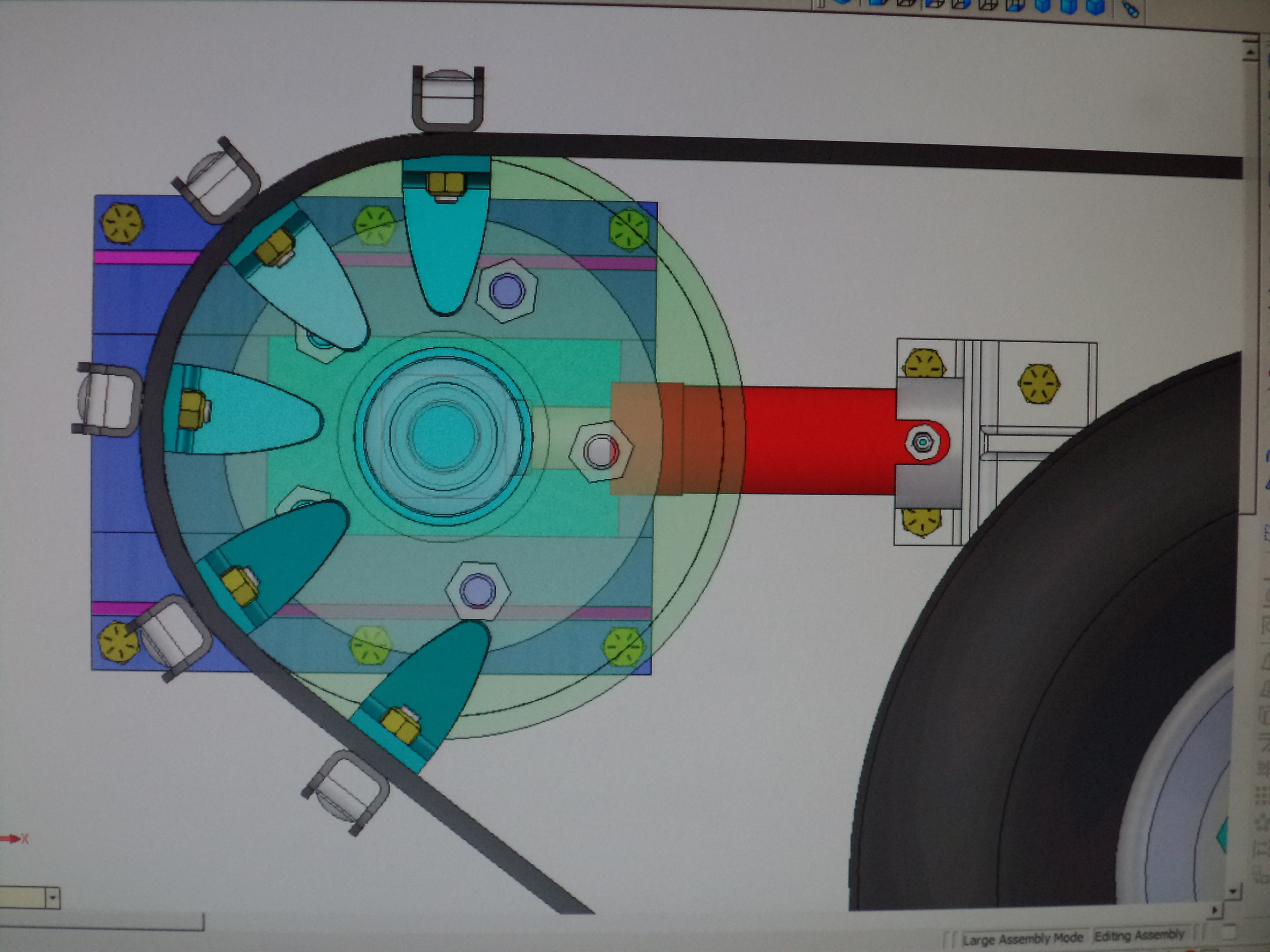

Here's is the rear spindle / slider arrangement. I may move the slider baseplate forward to provide more clearance between the track bars (channels) and the slider plate.
   / My Senior design project - a "Swamp Thing" tracked vehicle clone #278

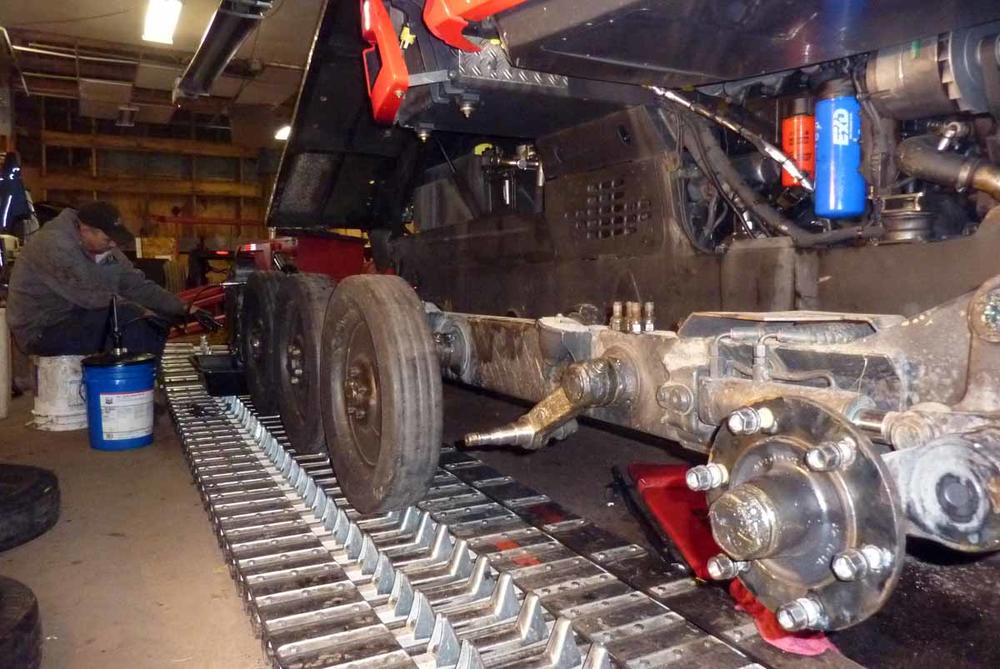

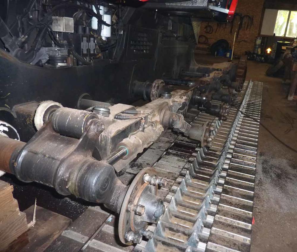

Your setup is similar to Bully's and I like it. They pivot the front idlers, so the front axle is hinged and both are on it creating a single unit, or a solid weldment. Two cylinders pressure the axle near the idlers, thus tensioning the tracks. Clear as mud I'm sure. :) So I'll add a couple of photos. In the 1st photo you can clearly see the hinge.

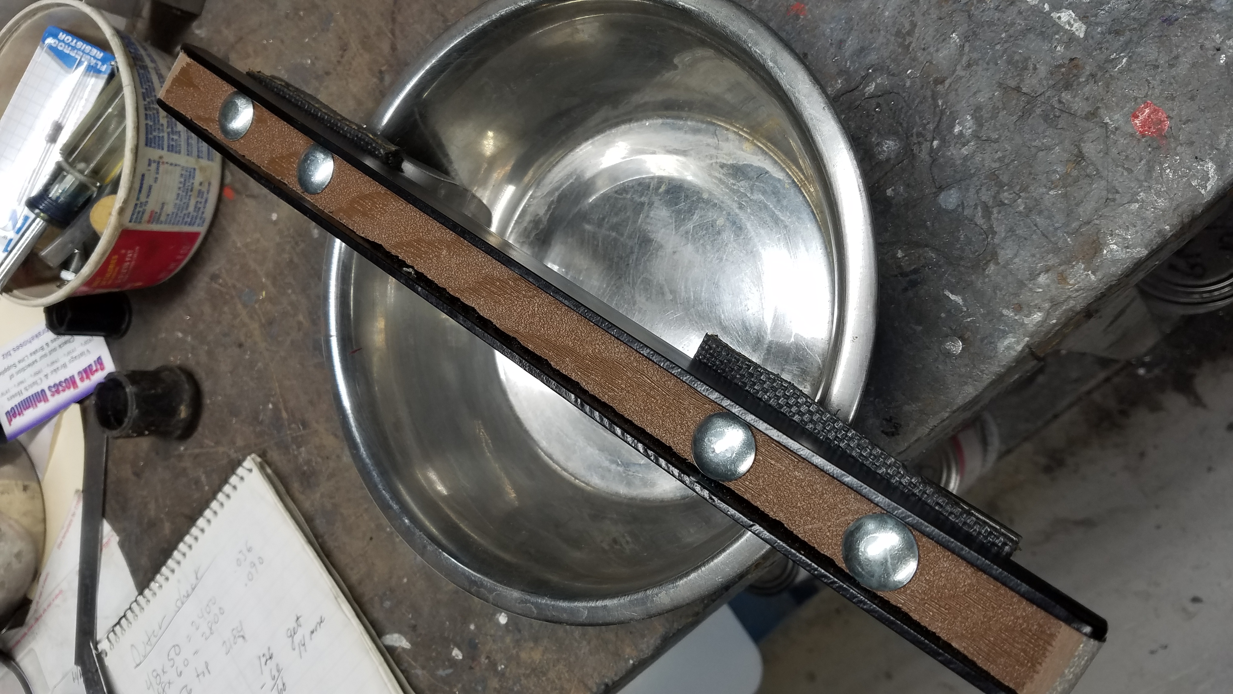

I made up some track splice plates today. Thanks Arly for the suggestion of using these instead of alligator lacing to connect the rubber belts together.
