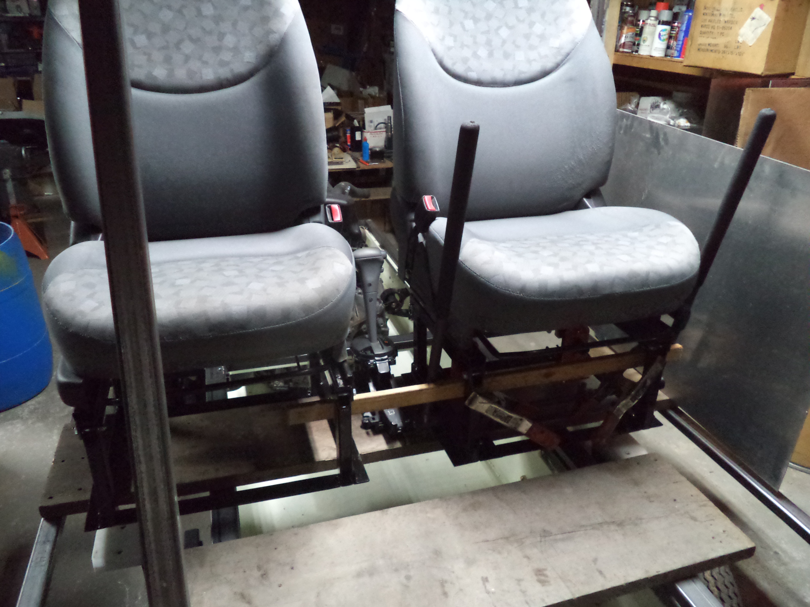

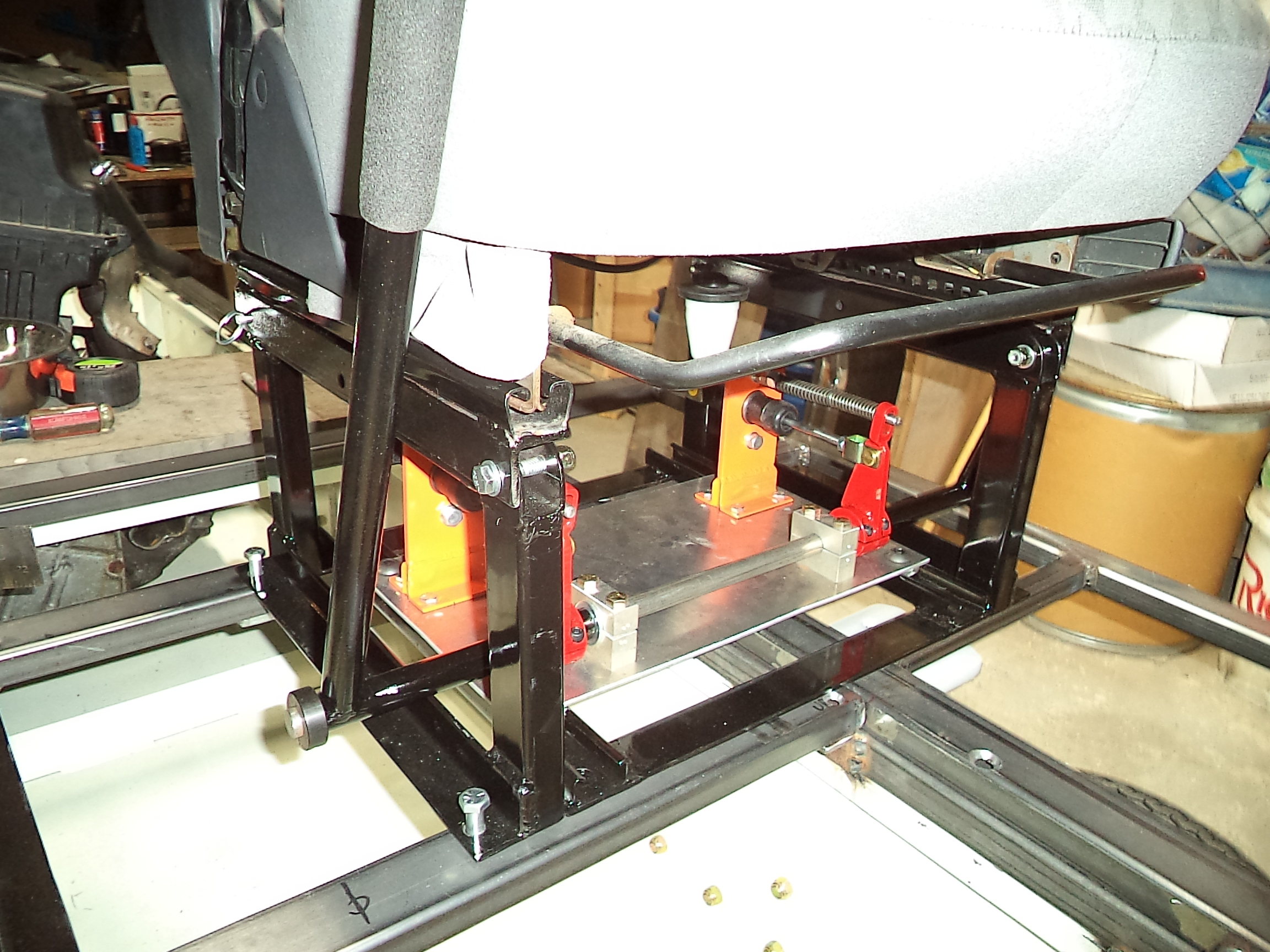

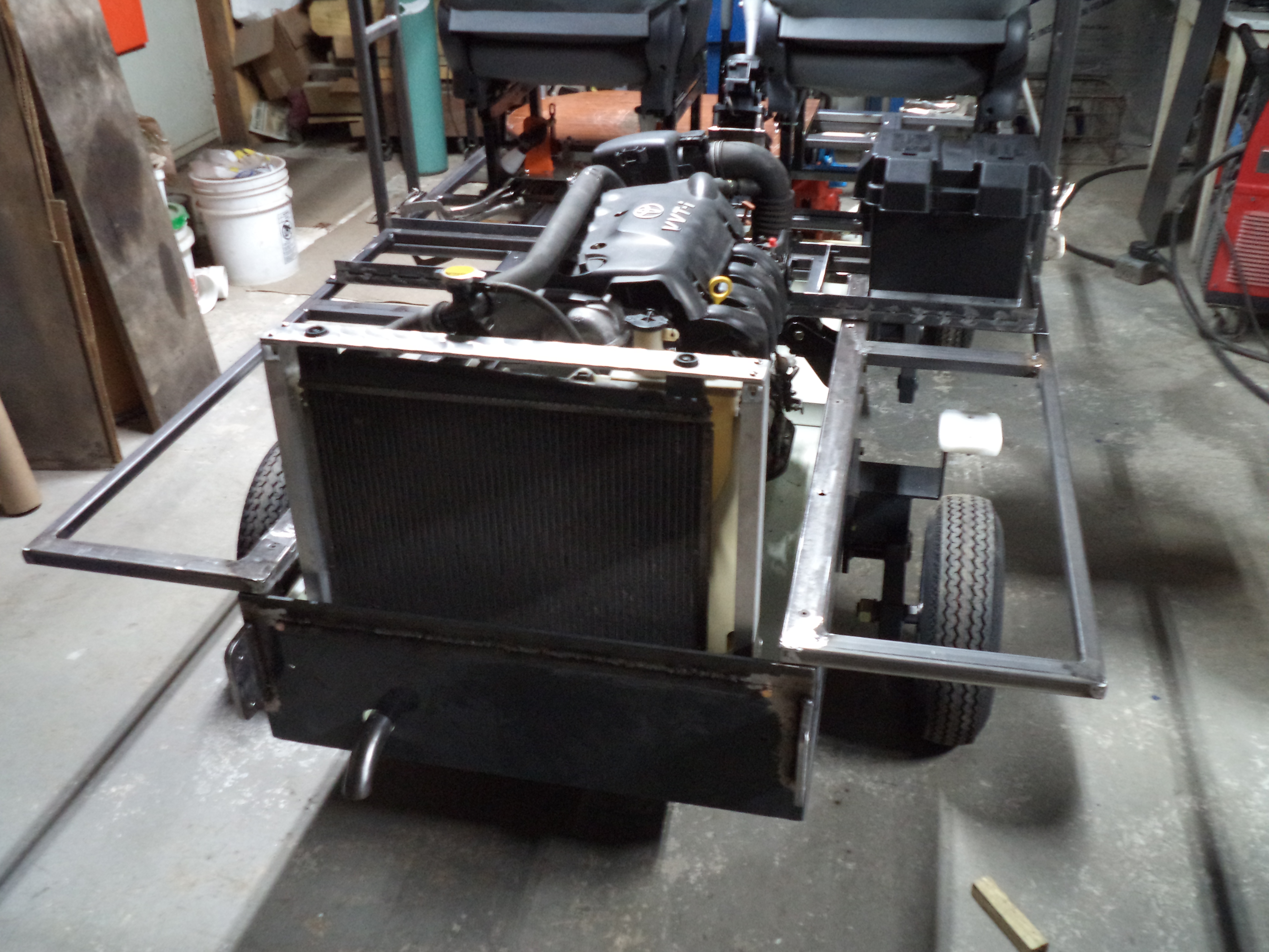

I spent some quality time recently working on the cab floor support framing so I got the seats, steering brake linkage, and shifter all set in place.

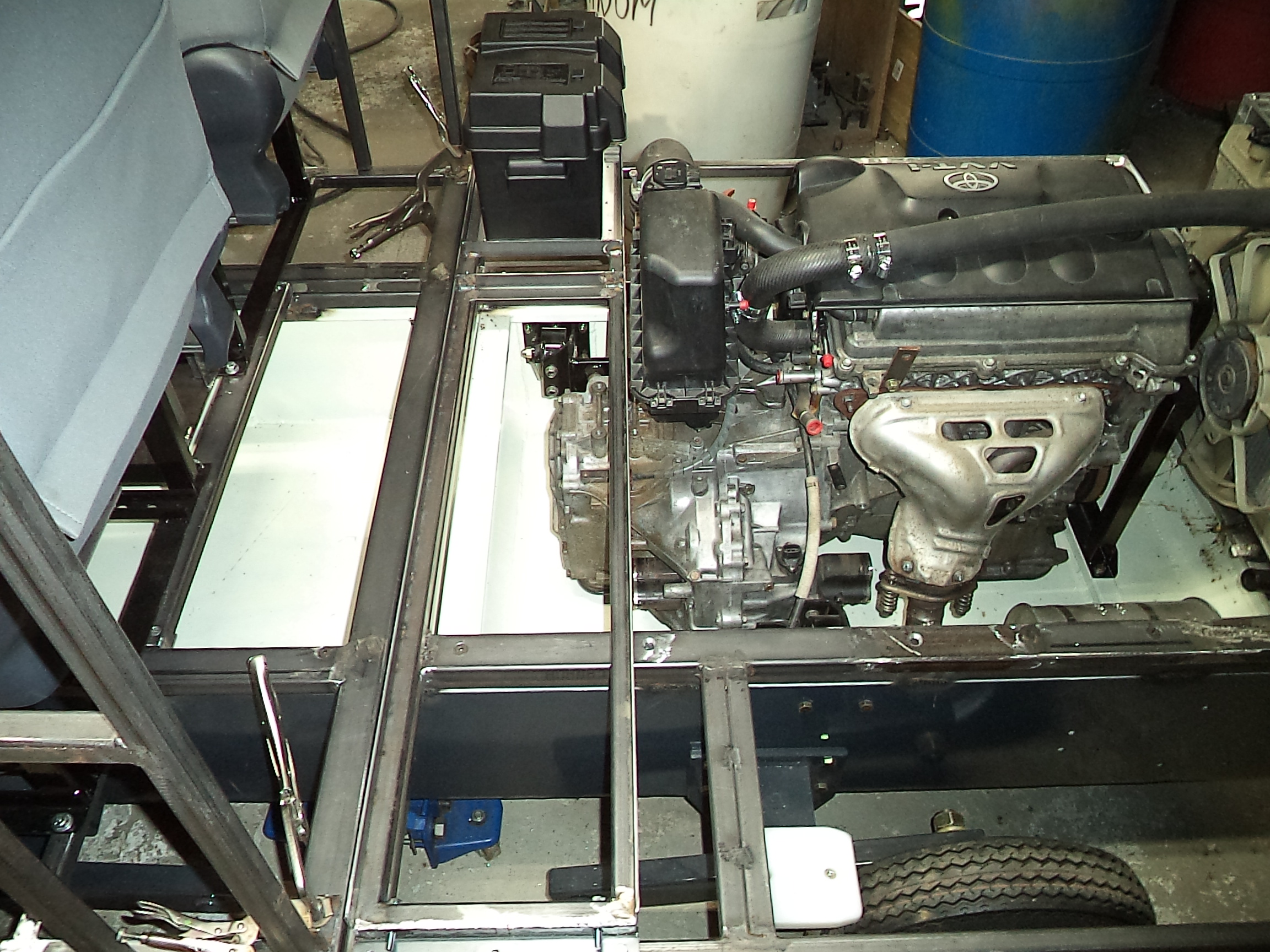

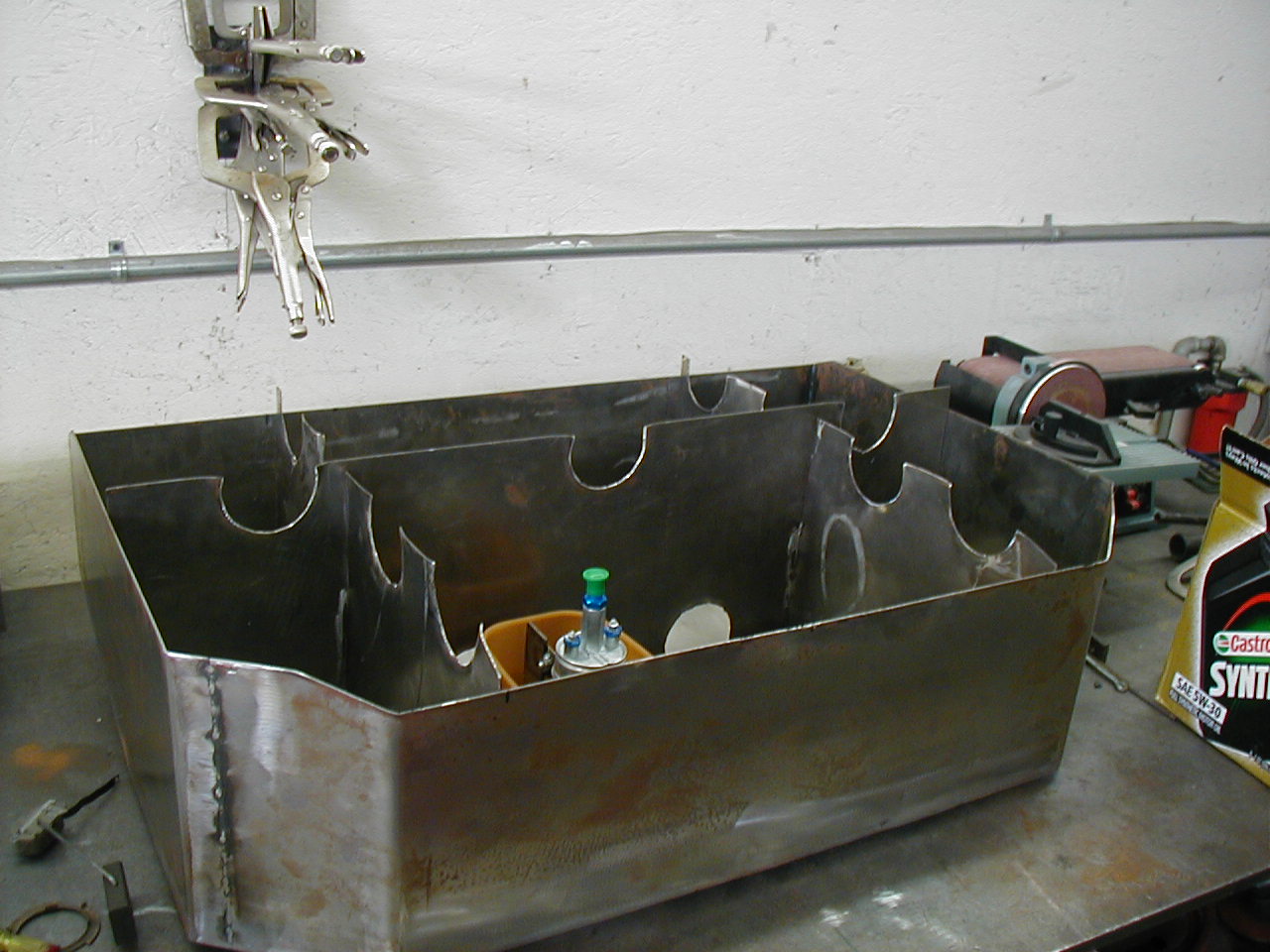

I am currently designing the 14 gal fuel tank, which will set between the engine and the cab, battery compartment.
   / My Senior design project - a "Swamp Thing" tracked vehicle clone #132
You'll need to design the tank with a low spot for the fuel pickup, all fuel injected gas tanks have an internal sump to "capture" the liquid in one area around the fuel pickup. If you catch even one slug of air the engine will stall immediately and you'll have to fool around restarting the thing.
I've been there a few times over the years and learned the hard way. Your tank design looks long and flat on the bottom; hopefully you can design in a few baffles and a low area to mount your internal sump for the fuel pump pickup to sit. Some sumps have one way doors to let liquid in and not be able to reverse out.P1010016.JPGshop pictures July 2004 001.jpg
Your attention to detail is very nice. Don't forget safety, like the battery being very close to the gas tank which could short out on your metal gas tank in a bad situation. Do your seats have side air bags in them? Might be time to remove them.
Here's one I did for an old Monte Carlo with a big block, 30 gallons and if you look closely you can see the sump I scrounged out of a Toyota Corolla gas tank and mounted it in the bottom. I hammered out a 3/8" low area to mount the sump. It still works very well to this day.
Regards, Fred

Thanks for the reminder about the sump and baffles in the fuel tank. I will ensure they are in there. I plan to put the battery in a plastic case so that should make it safer sitting next to the gas tank.

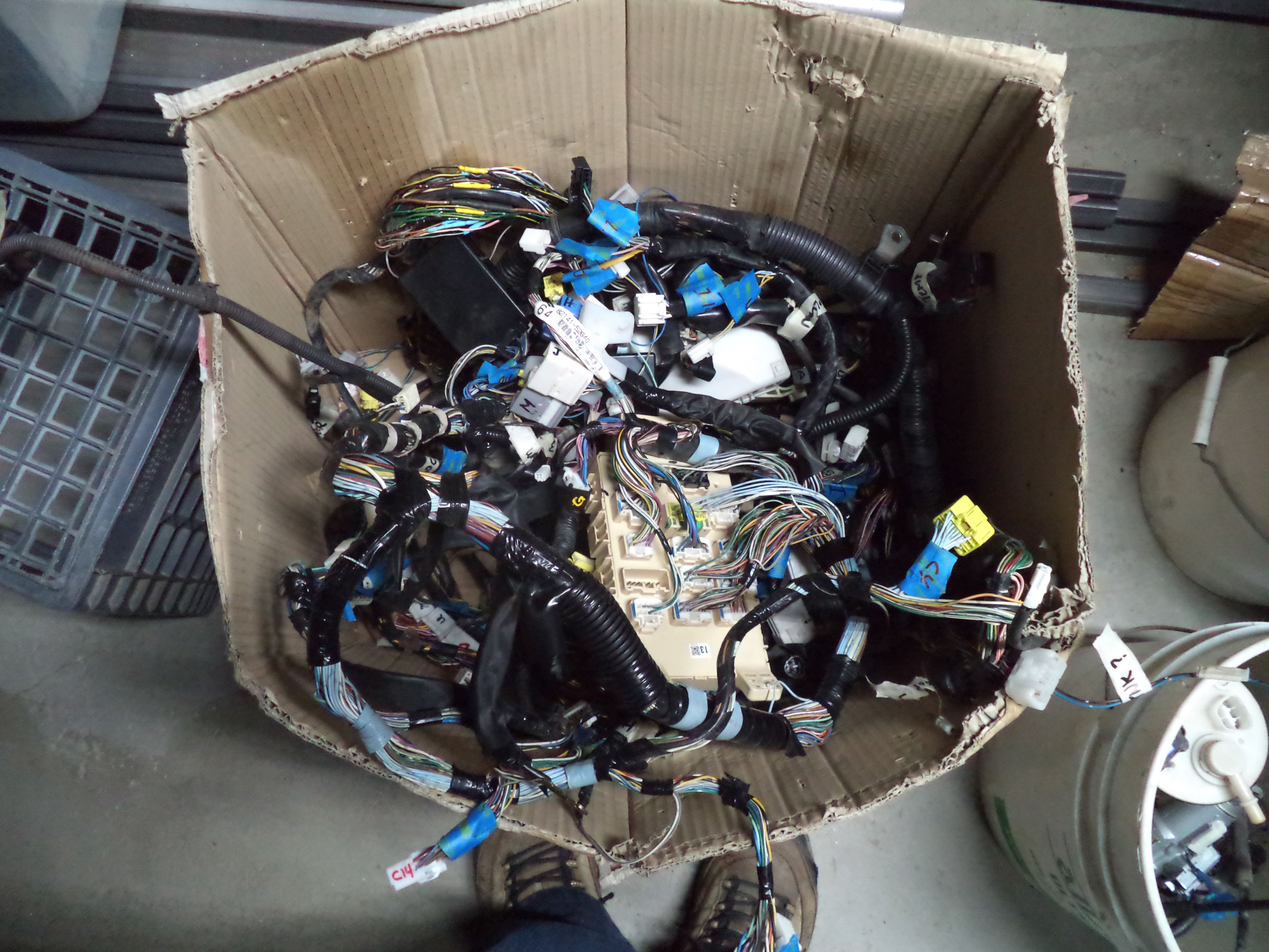

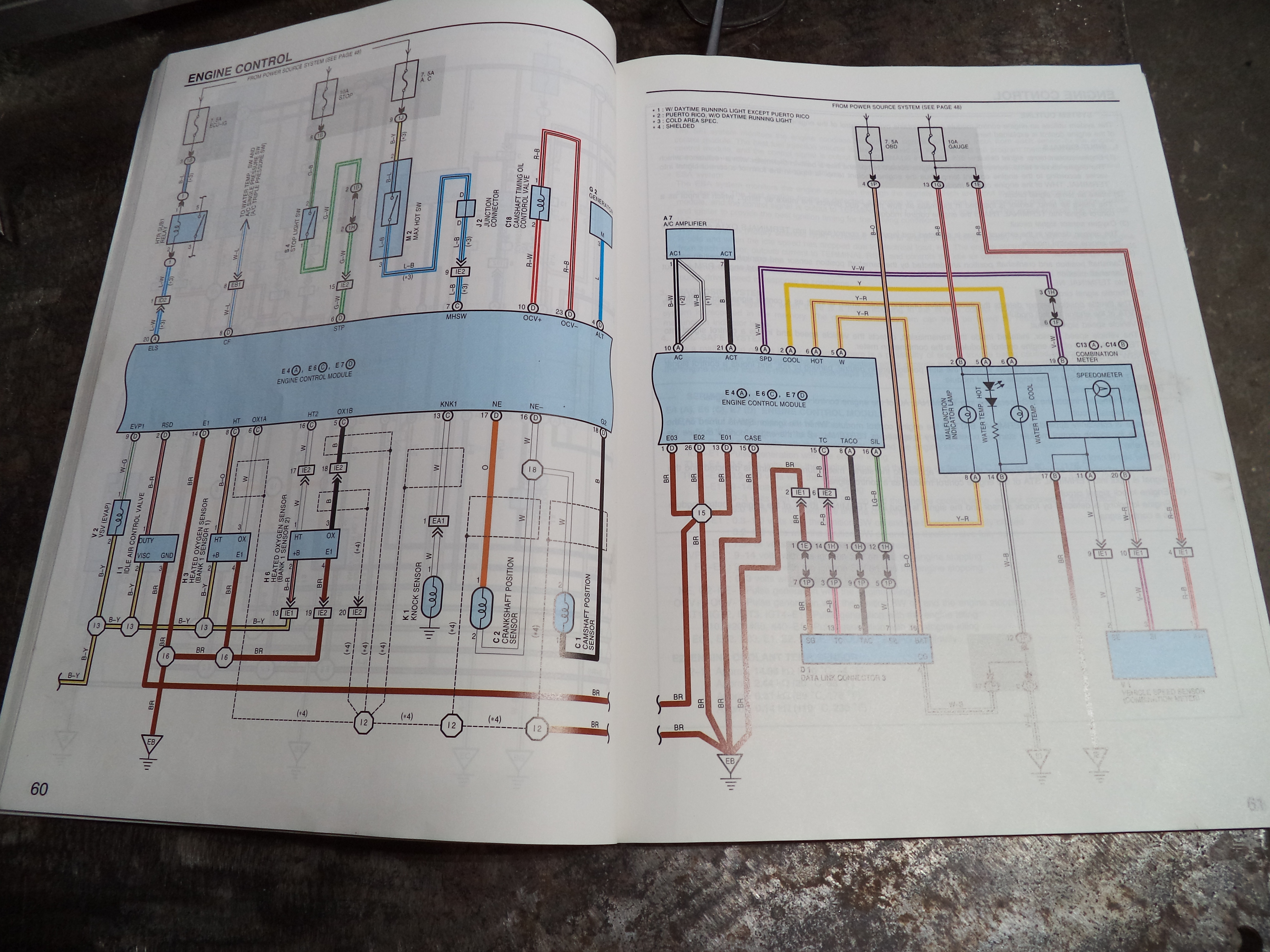

This past week I spent some hours going thru the factory wiring manual (which is actually, very useful) trying to identify what parts of the harness will not be need for Snowzer. I plan to re-purpose a number of the fuses for the new lighting and other accessories. I guess about 70% of this mess could be removed:

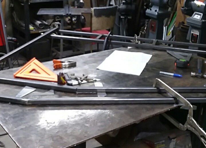

I also welded up the lower part of the cargo frame and made up the subframe that supports the 12.5 gal. fuel tank and battery:
I plan to fab a gas tank shortly which will then allow me to try and start it sometime soon. Once I know it runs, I'll get back to finishing up the axles, driveshaft and cab frame.
View attachment 586084 View attachment 586085
