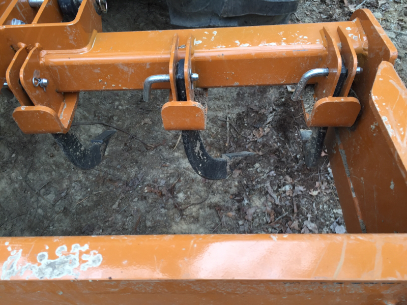

Wow, sounds like she's enjoying the tractor almost as much as you! :) I have that box blade and love it, but Woods lists it on their site as medium duty. http://www.woodsequipment.com/files/Products/Literature/Landcape%20Equipment%20Full%20Line%20B04024.pdf (see p. 9 of the pdf). Your tractor is quite a bit more powerful than mine, but still, she must have had up a good head of steam to do that to the scarifiers!
I am sorry. I meant to say the list it as medium duty but I was told it would hold up like a tank. I did notice in the manual that the scarifier is listed as heavy duty, but again, I imagine the ones in the gannon box are much more stout. Yes, she was really rolling thru there and she tore into some big roots. I picked up a few scarifier blades at tractor supply yesterday, after I left my excavator dealer. I haven't had time to check them for fit. I also got a set of metric wrenches that goes from 21-25 mm. The handles are not small, but those sizes seem to be used a lot on this tractor.

Box blade mayhem.

Wow that is some twisting. I have five hours on mine and am going thru the same thing you are with tightening things. Need to look and see what else needs to be touched when I get on her again in a few days. It will be much easier when I live there. I looked over my son in laws tools and was sad not to see what I needed. This trip the Motorhome and a full toolbox is going down.
