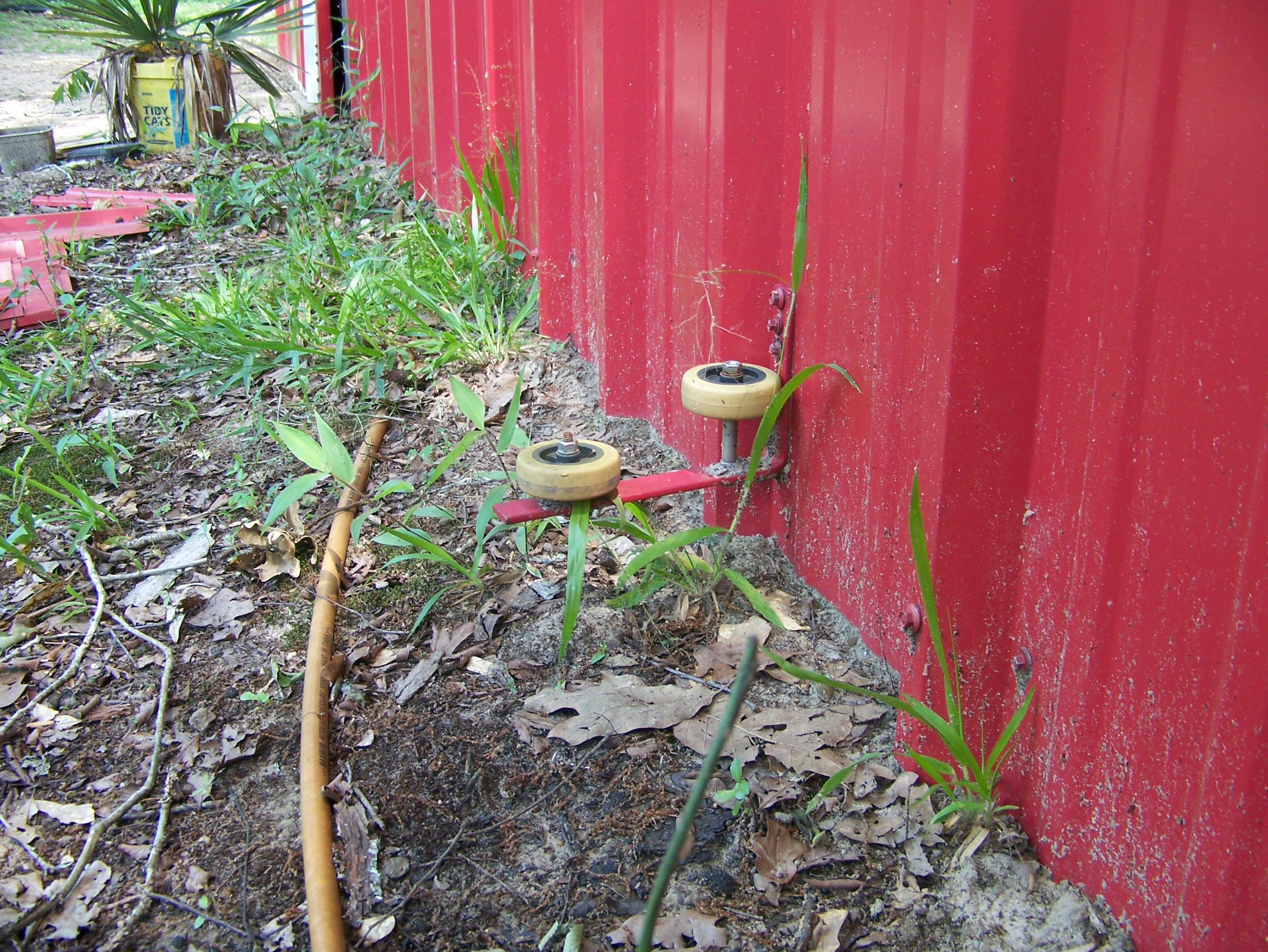

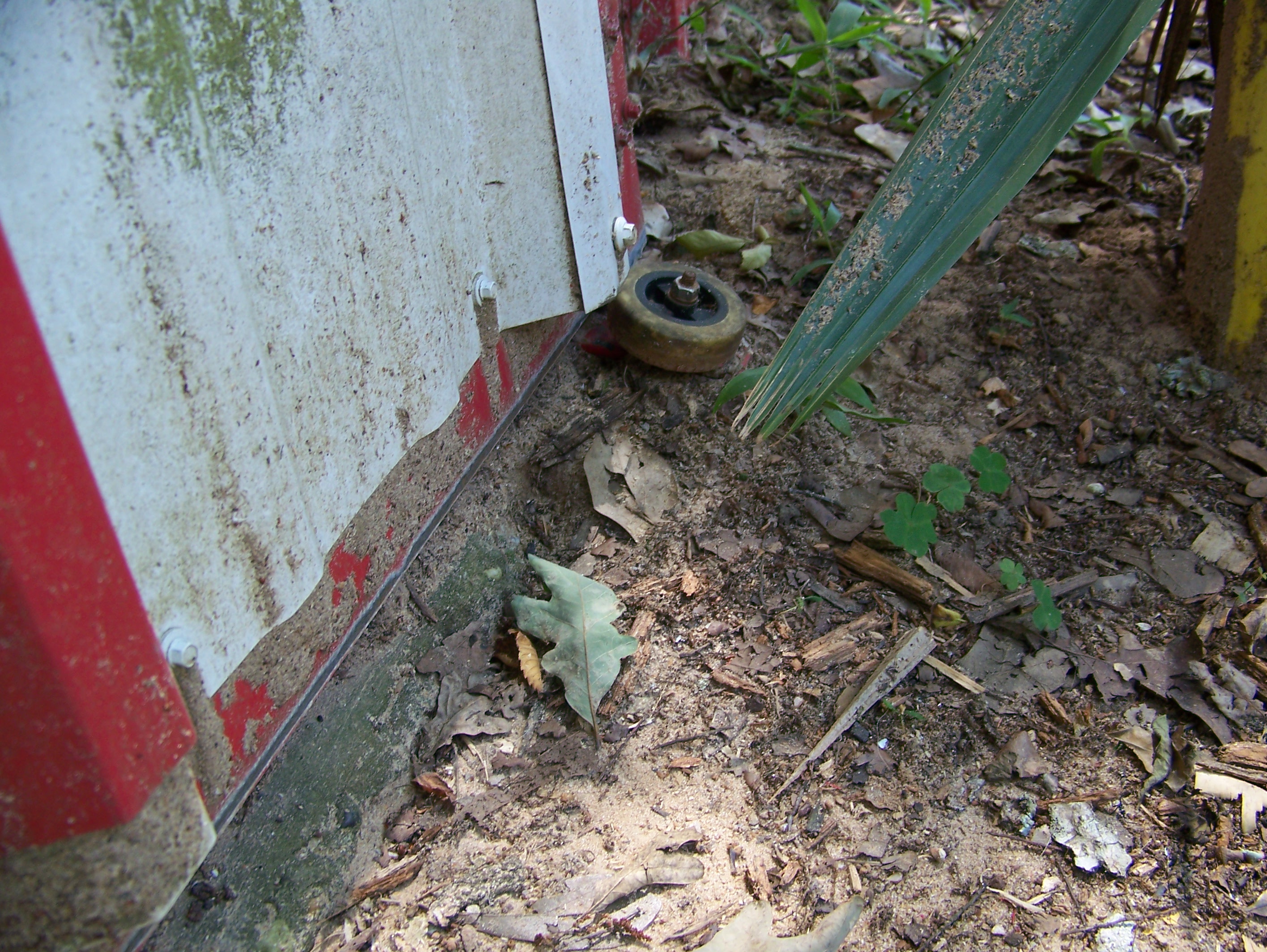

I added doors to the front of my open sided machine shed a few years ago. Used single track for two doors. I added track out past the ends of the shed so the doors could open that way and have the whole side of the shed open at the same time. I'm not sure that was such a good idea. When open, the doors are susceptible to wind.
I use these roller brackets to keep the doors from uplifting with a gust of wind. 4-27-20 Barn Door Roller Bracket.jpg4-27-20 Barn Door Roller.jpg I will be adding 10 foot of rail, after the Mallard hens hatch their nest of eggs right inside the tin that has to be removed for the rail track installation. The door, when all are open, will hang out 2 feet past the building. I have a gate there also. I will have to cut the gate down 6 or so inches and install a post. The post will also help support the door in gusts of wind.

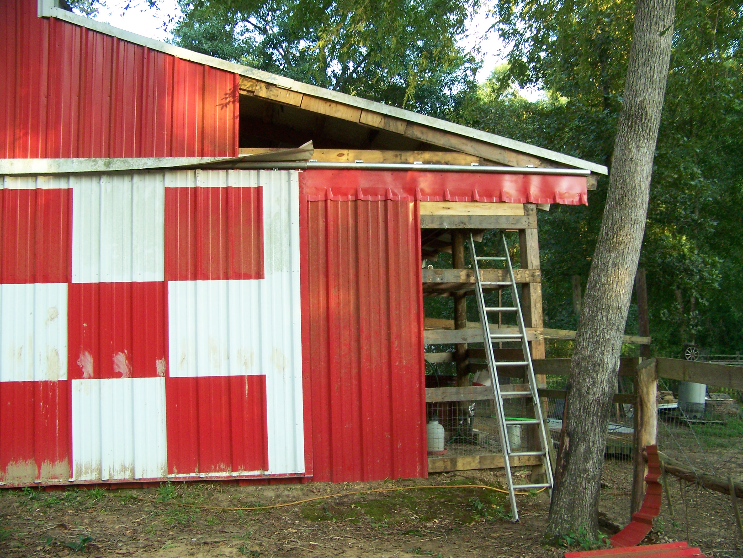

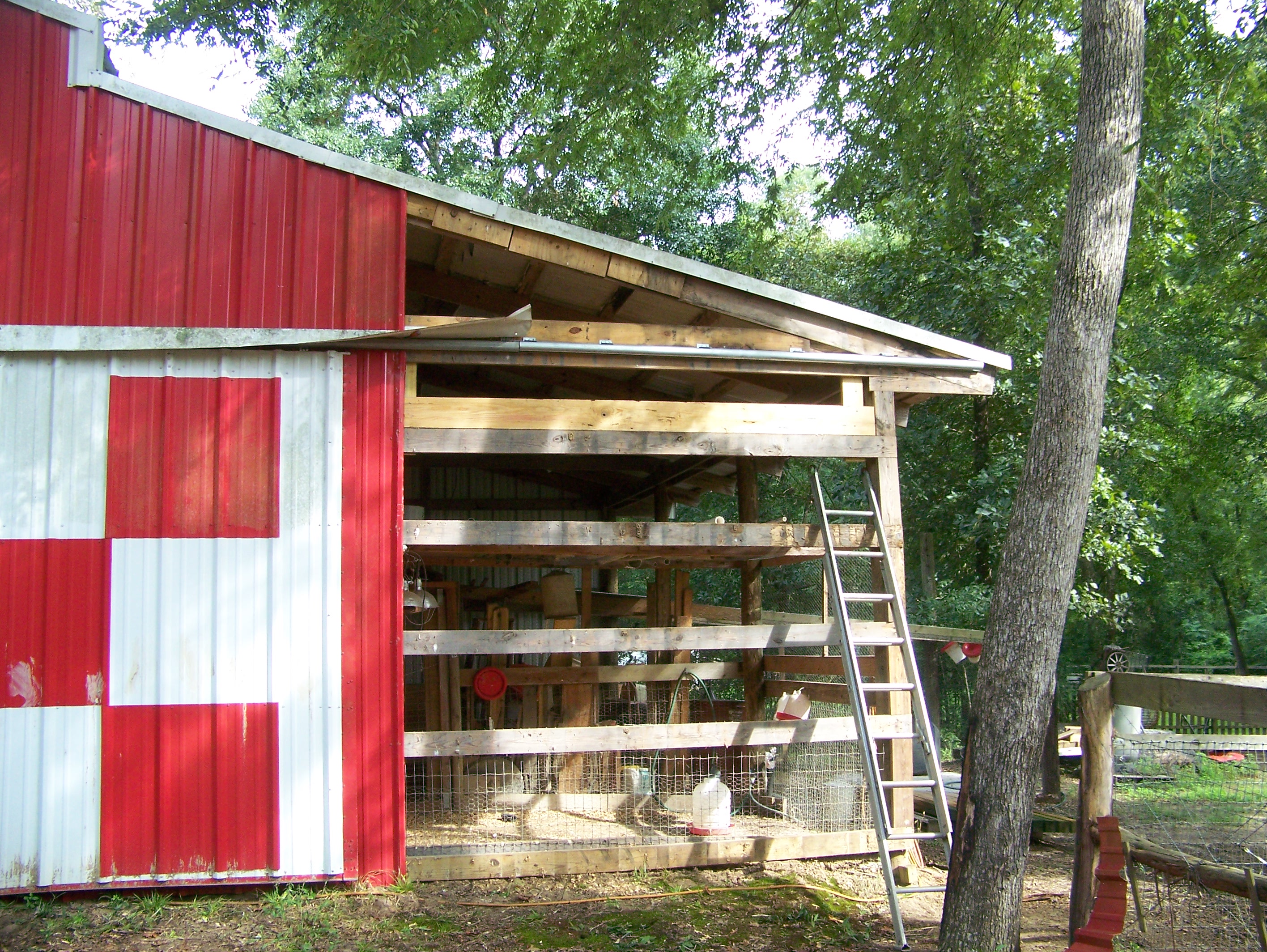

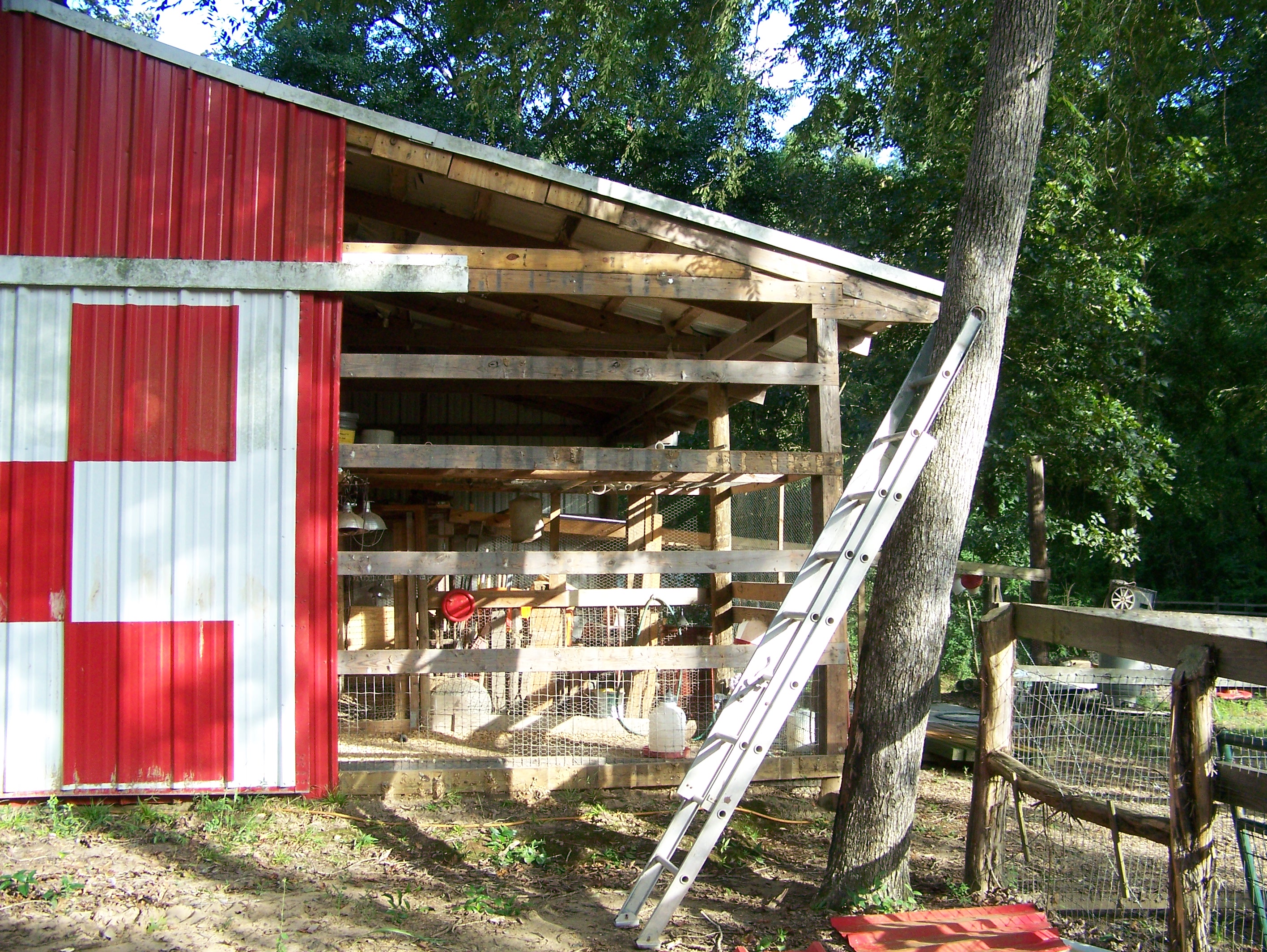

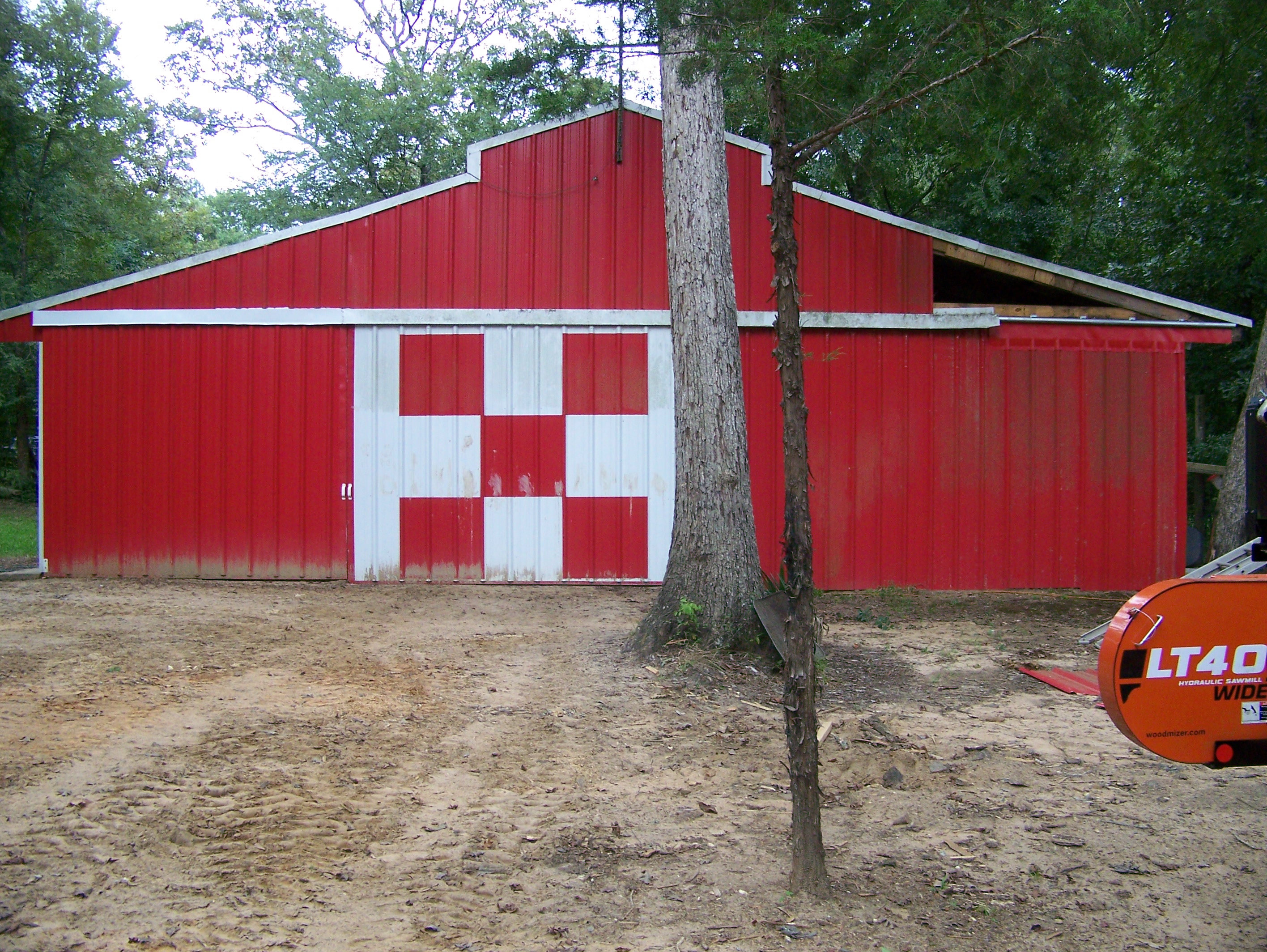

When I enclosed the shed on the barn, I went ahead and bought a 10 foot door rail, 10 foot of flat to corragated tin, and a white door track cover. After the hot summer we are having. I attacked removing tin and installing the rail. All in four hours.7-30-20 Door Rail Tin Removal.jpg7-31-20 Rail Installed.jpg8-1-20 Tin Going Back On.jpg

#357

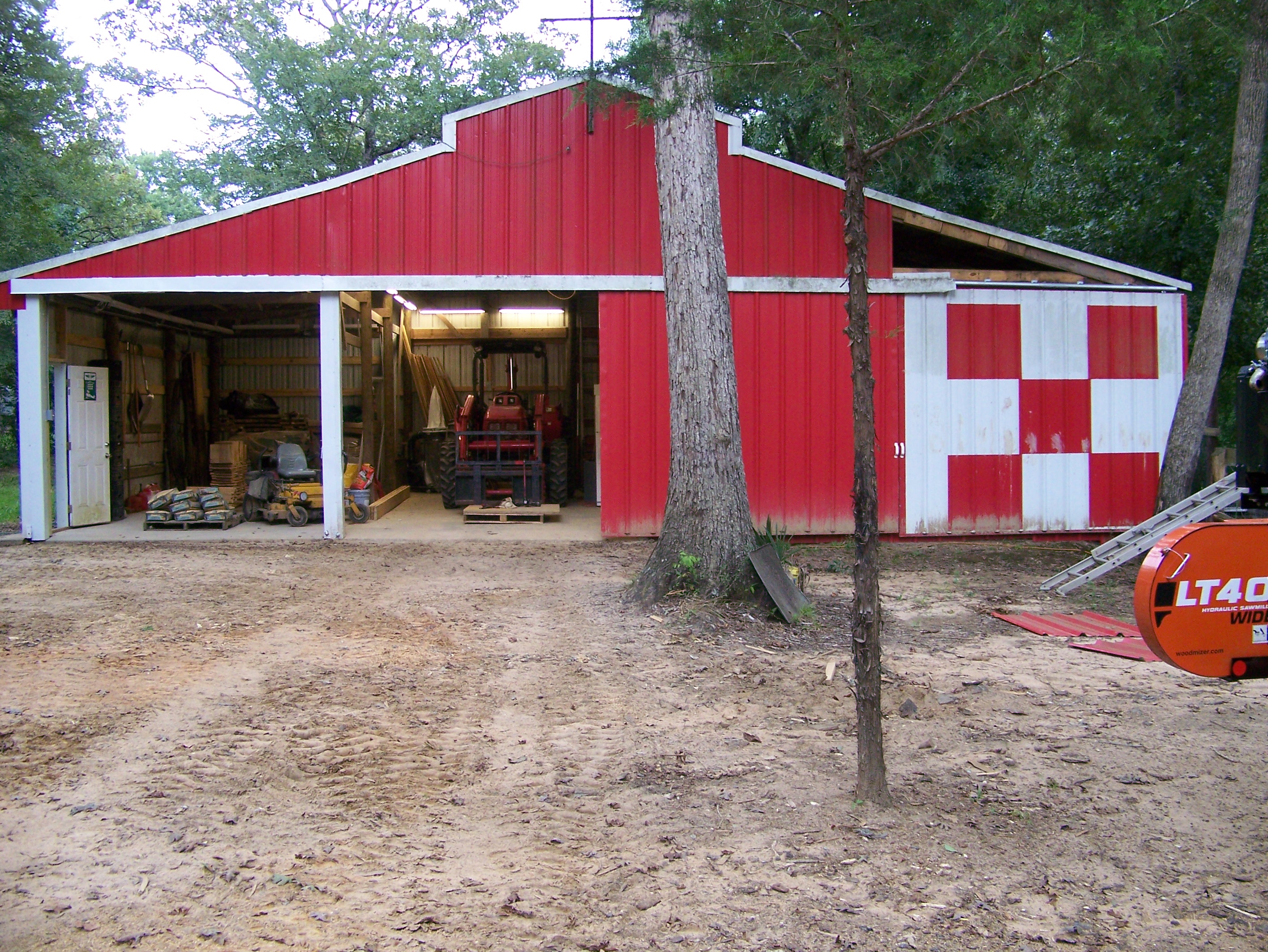

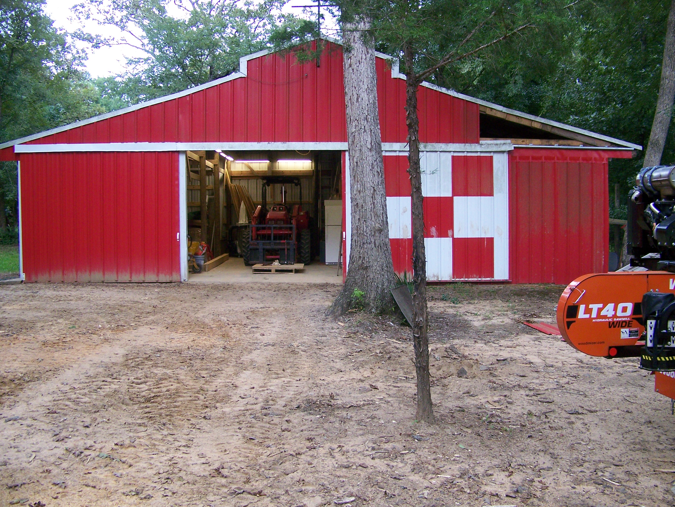

............and got it where I can open the doors up...........8-2-20 Both Barn Door Open.jpg8-2-20 One Barn Door Closed.jpg8-2-20 Both Barn Doors Closed.jpg Sliding checker boards anyone?:laughing:
