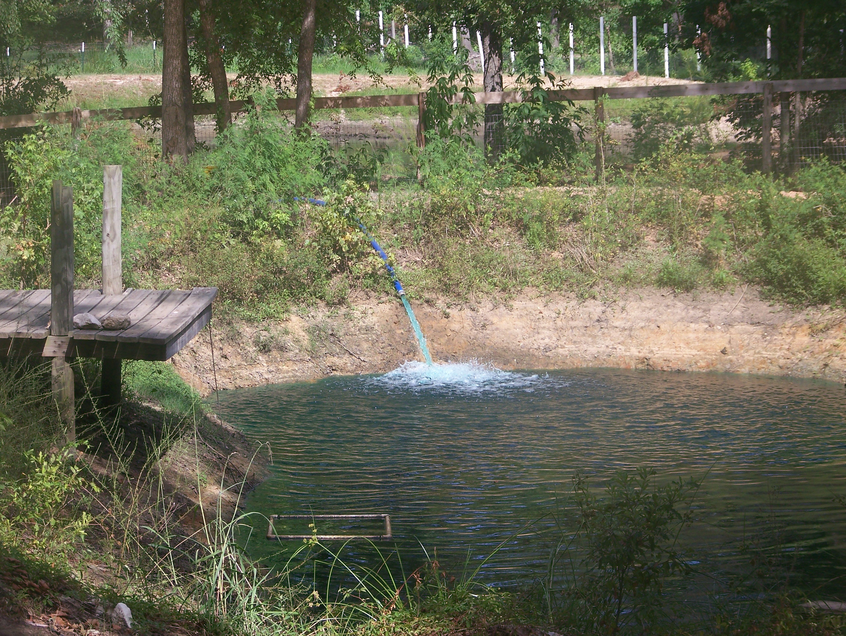

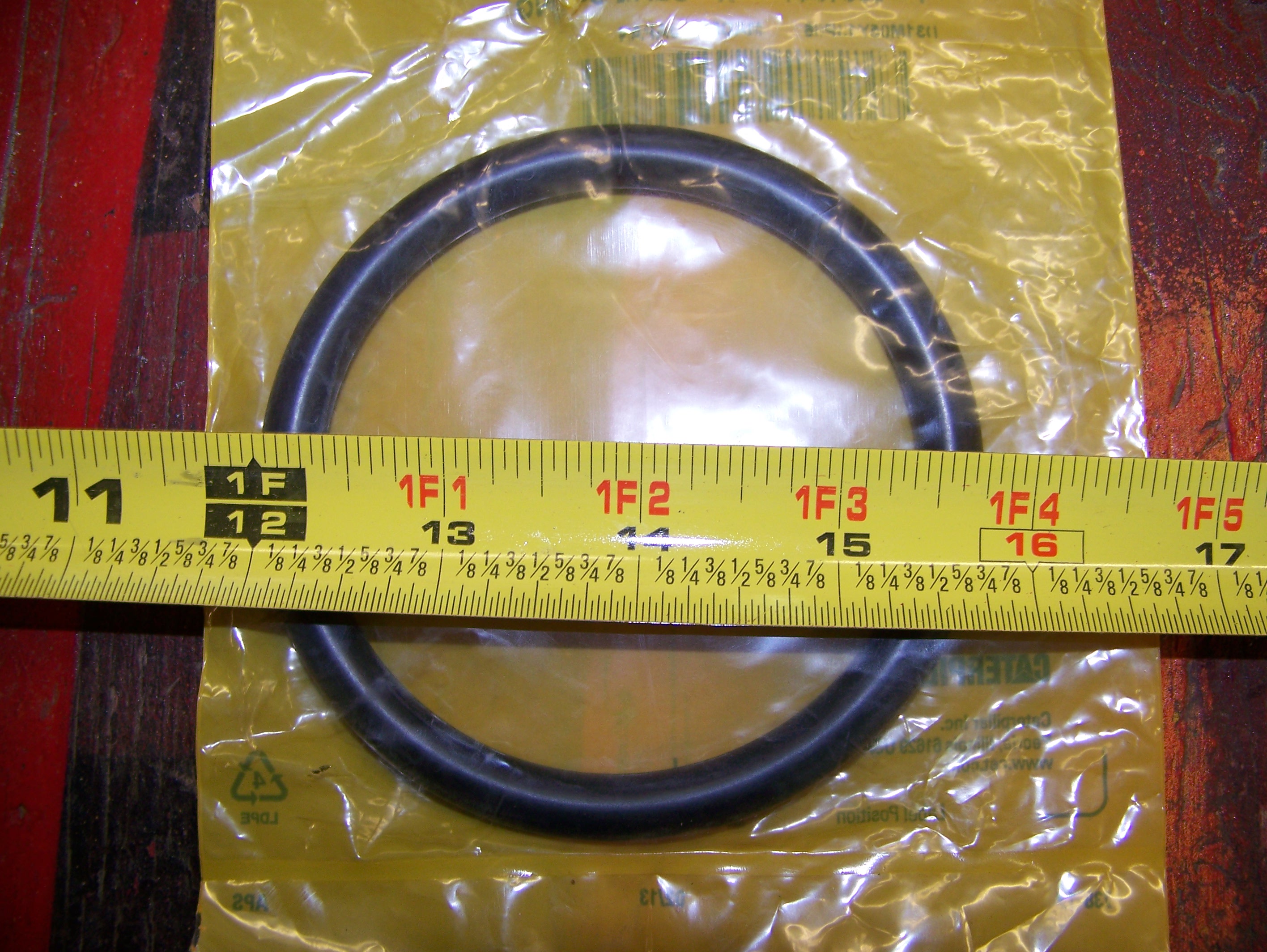

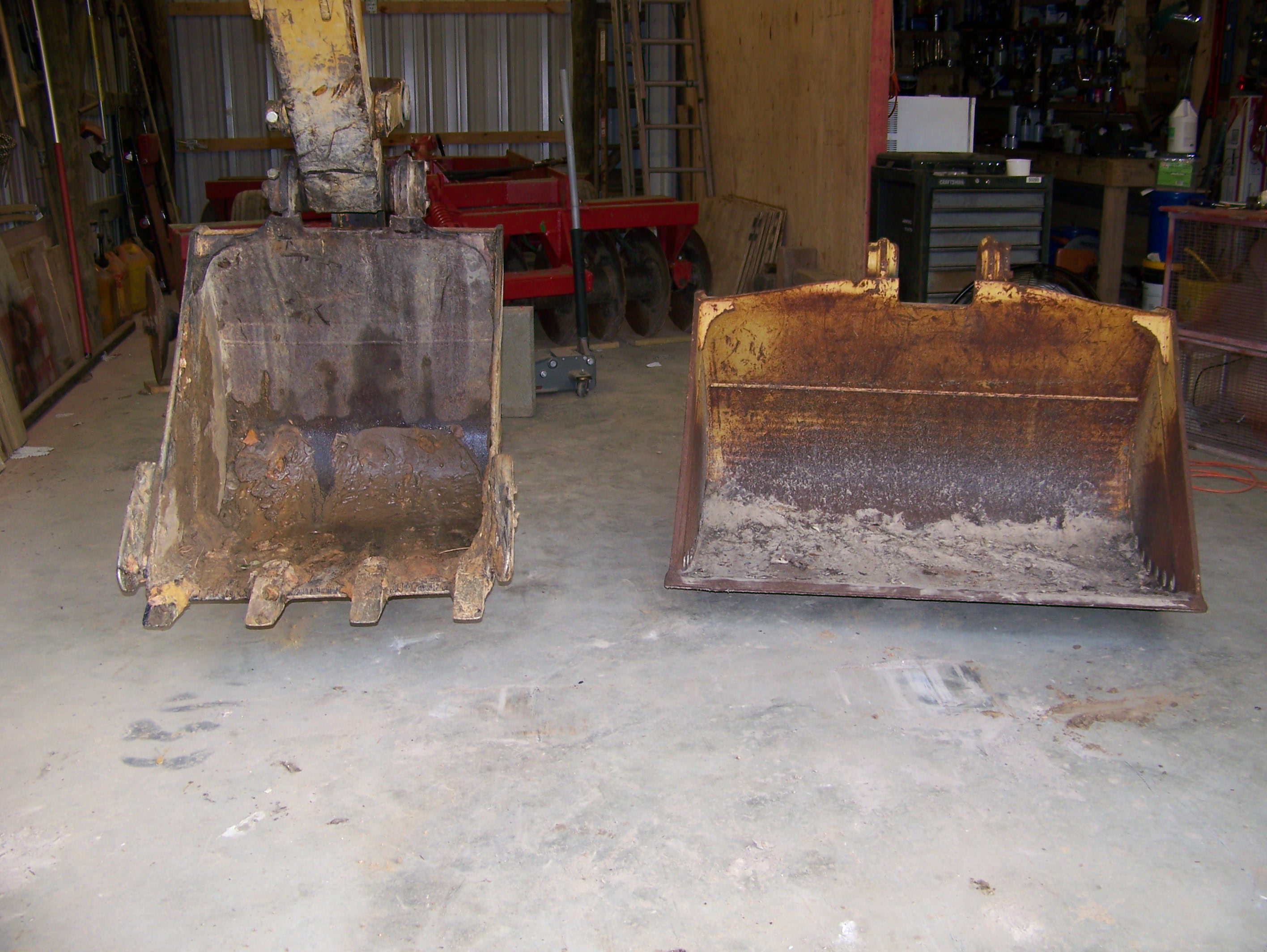

I did get the waterpump out and pumped the island pond water into the small pond to fill it. 7-15-16 Filling Small Pond After Capping Pipe.jpg Then I drug the 48 inch CAT cleanout bucket into the barn. 7-15-16  Buckets 28 & 48 Inch.jpg I got the 48 inch bucket on around 8pm. Then the grease oring seal on both sides of the bucket broke and flew off. The only way to install them (that I could see) was to roll them over the fitting where it is champfered on the edge. I thought they would be okay after only being a few months installed on the 28 inch bucket. I kept working thinking I would keep the bucket pivots out of the water and dirt until I could replace the orings. That is when I found that the bucket's pin retaining bolt holes were 1/2 inch. On the 28 inch bucket the bolts were 5/8ths inch. This includes the pin holes for the bolt. By then it was 9pm, so I called it a night. So I went inside, thinking Mustang CAT was closed on Saturdays.
After cleaning up, I got online and searched for the oring part numbers. Lo and behold, the Mustang CAT parts depart. in H town was open to noon on Saturdays.............and had 4 in stock! I picked up all 4. 7-16-16 New Grease Seal Oring.jpg

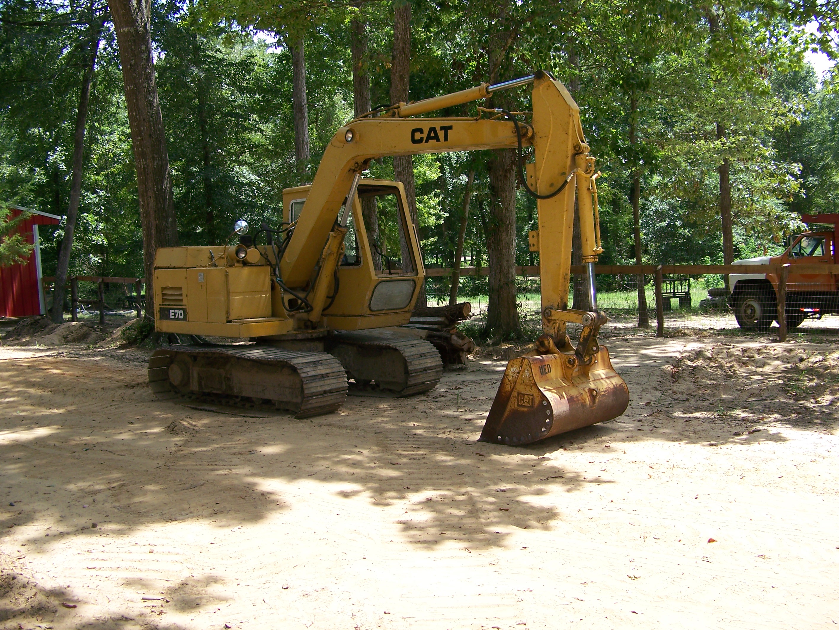

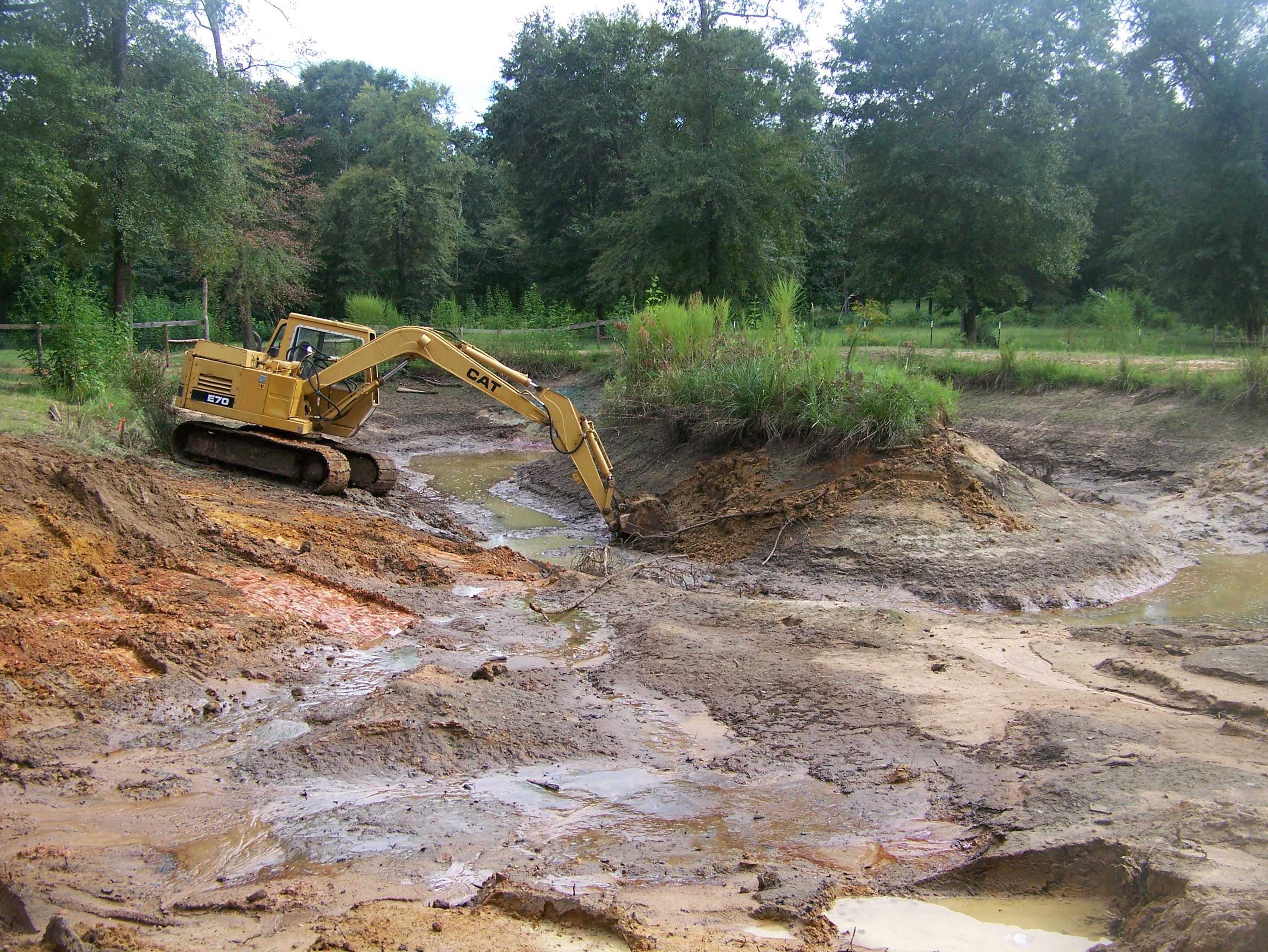

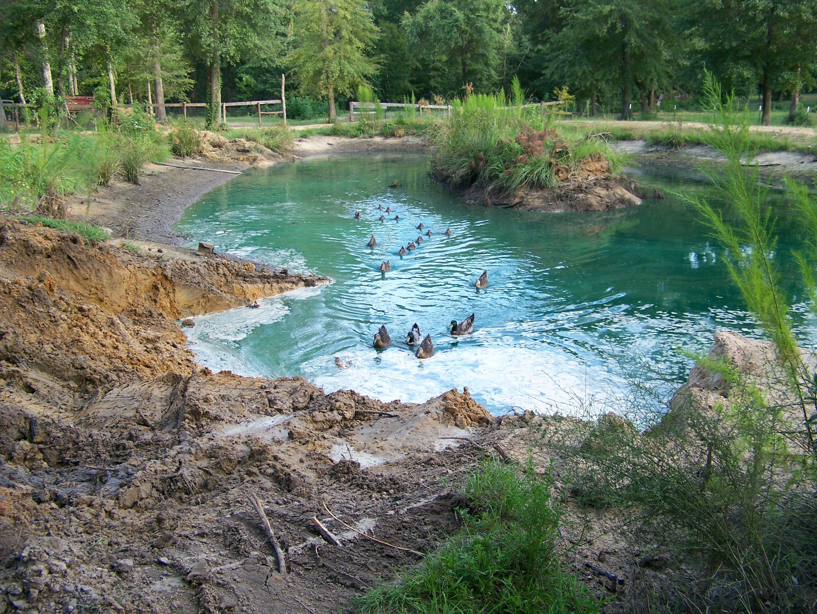

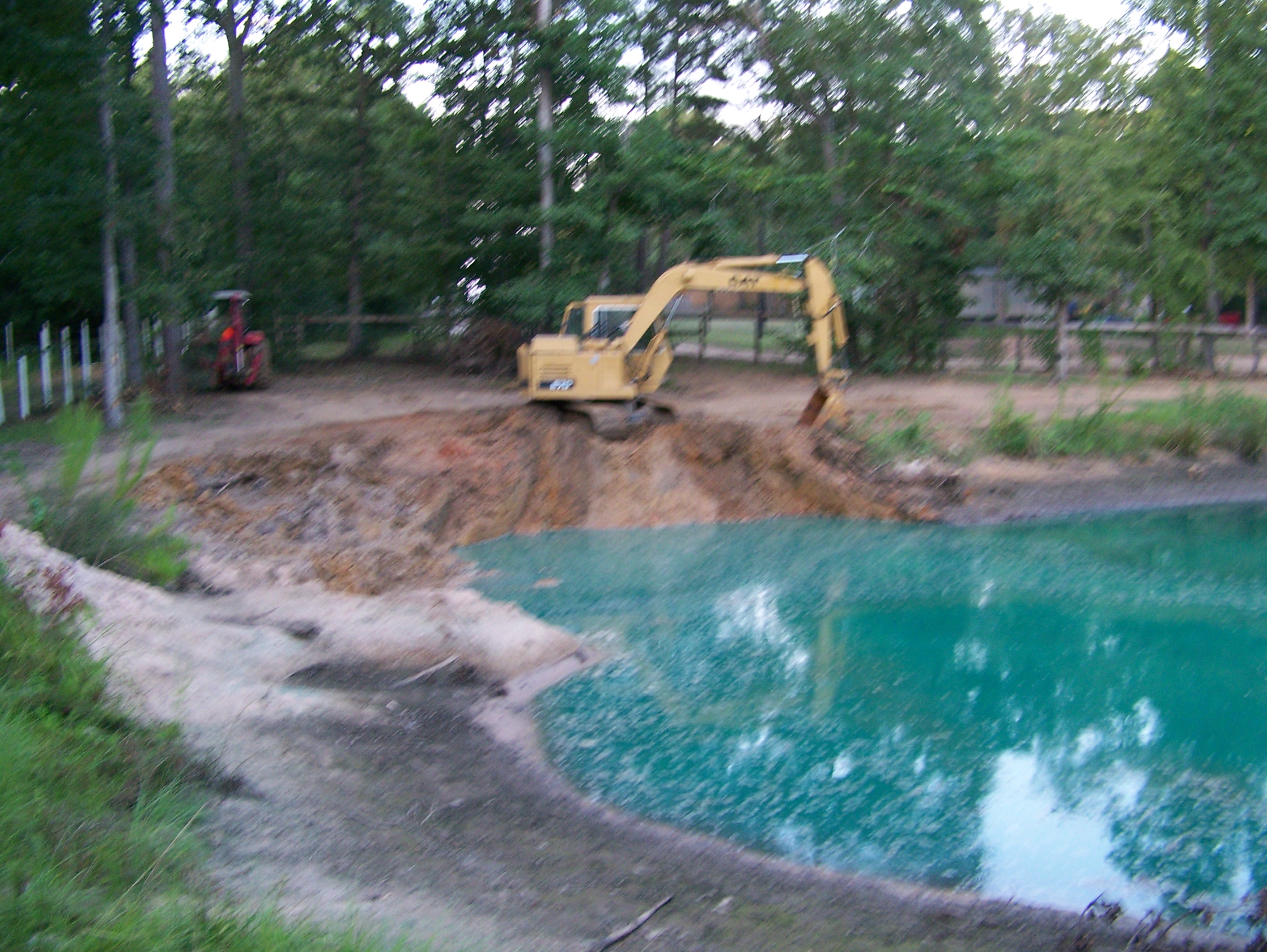

Then I removed the 48 inch bucket and enlarged the pin retainer bolt holes on the bucket. I was ready to dig at 3pm. 7-16-16 CAT Ready for Pond Cleanout.jpgThen I got it out to the pond in position, and parked the dumptruck behind it. I filled the truck and it would not move. I thought it was a bad clutch or the 9 speed Roadranger tranny going out. So I dumped right were it sit....then moved it to smoother ground and reloaded with the Mahindra. Still nothing. So I retired the truck and just dumped into a huge pile to be moved one bucket at a time with the Mahindra. I did that till dark. 7-16-16 Pond Cleanout Commencing.jpg7-16-16 All 18 Ducks Checking Out Progress.jpg These photos show how little shoreline I moved back and the huge spoils pile. The ducks were always curious and I blew the horns on the Mahindra and CAT a lot at them to get out of the way. I even had to blow the air horn on the Ford numerous times to get them to move.

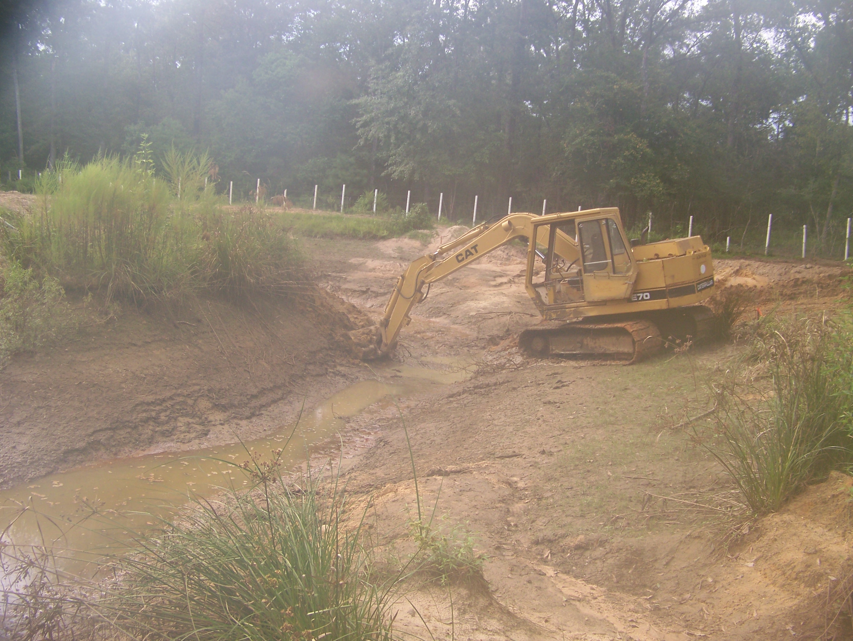

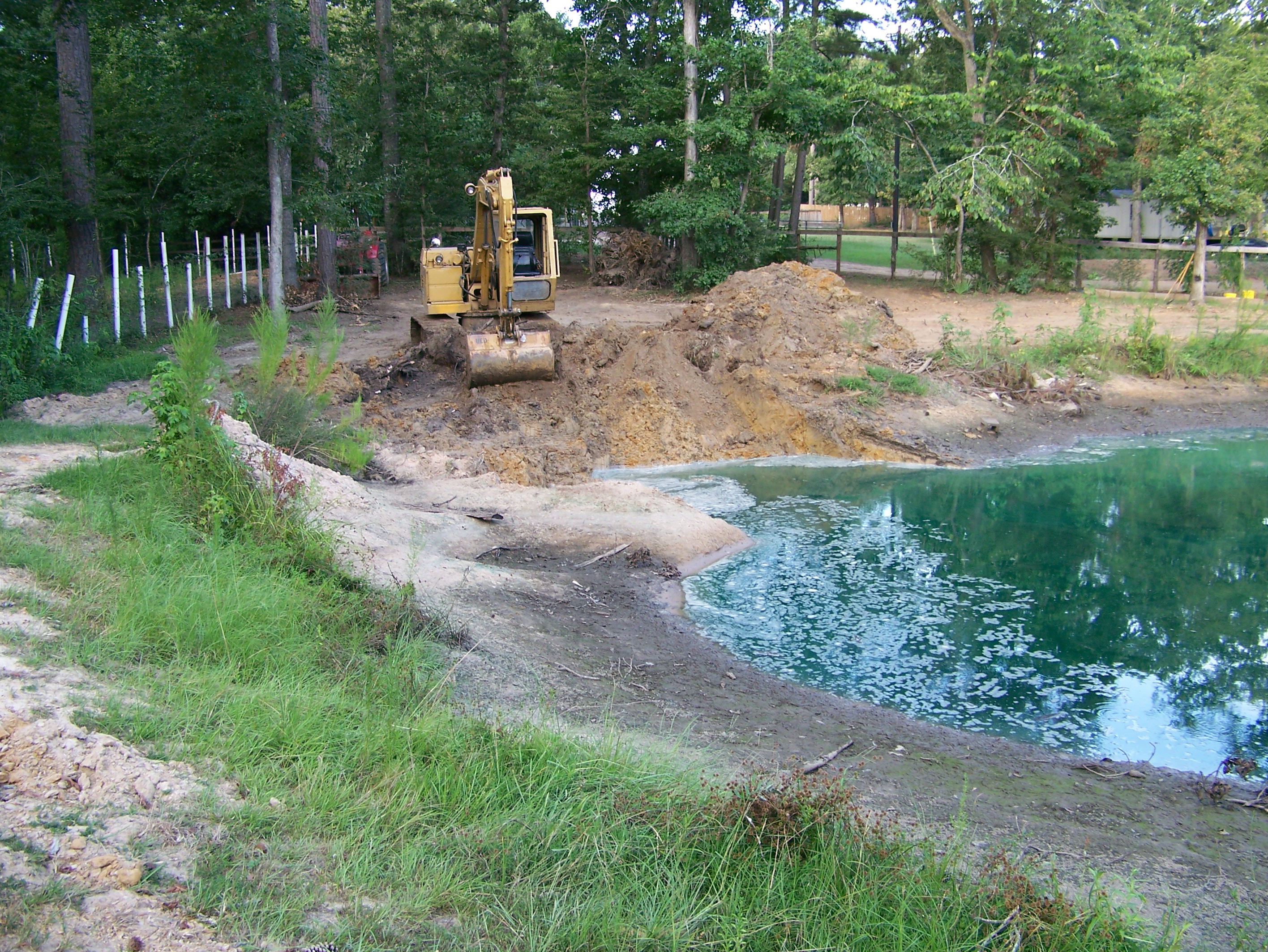

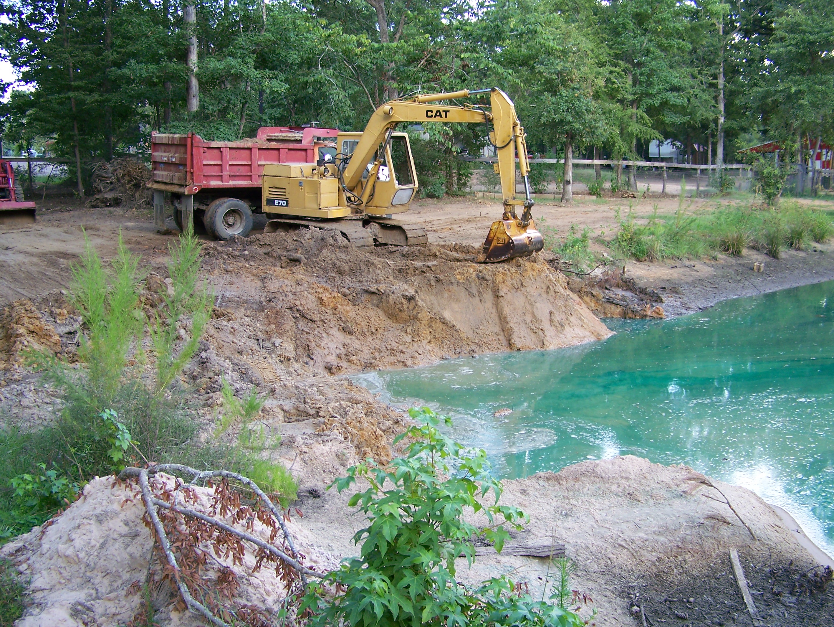

Sunday morning I gave the dumptruck another try........by only putting 4 loader Mahindra buckets in. The truck moved, but labored. Then I monkeyed with the low/high shifter on the 9 speed. It was then I realized the thing was stuck in high, but the lever was in low. Go figure. Then I started moving dirt with 2/3ths full loads. Remember it in a 1992 Ford and over 350,000 miles.................with wet, water leaking clay. The stuff is heavy. No problems with eight each, 48 inch buckets loaded. Photos show the shorline cleanout widening and moving uphill. 7-17-16 Cleanout  Shoreline Starting to Grow.jpg7-17-16 CAT Slowly Filling Dumptruck.jpg
Next time I will try 10 bucket loads.

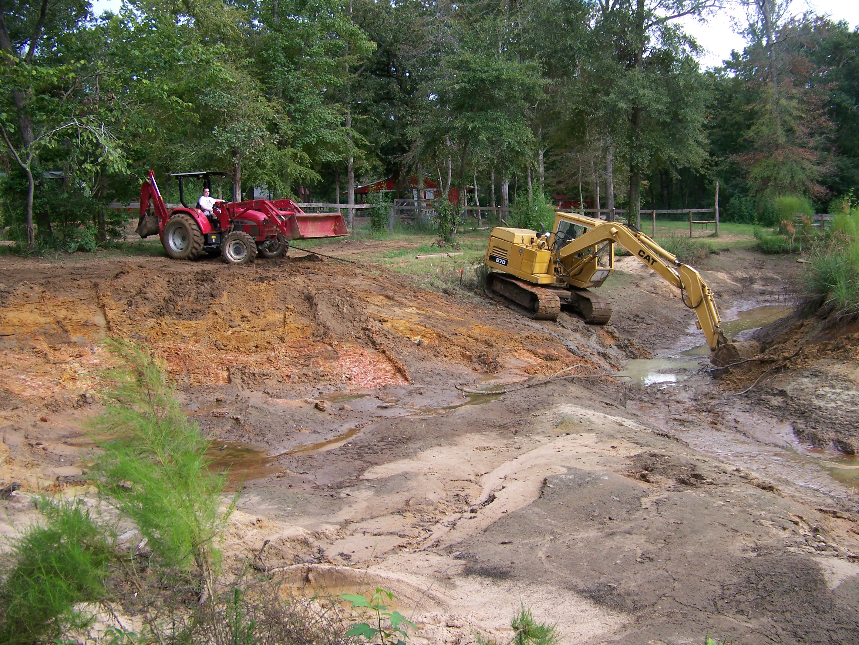

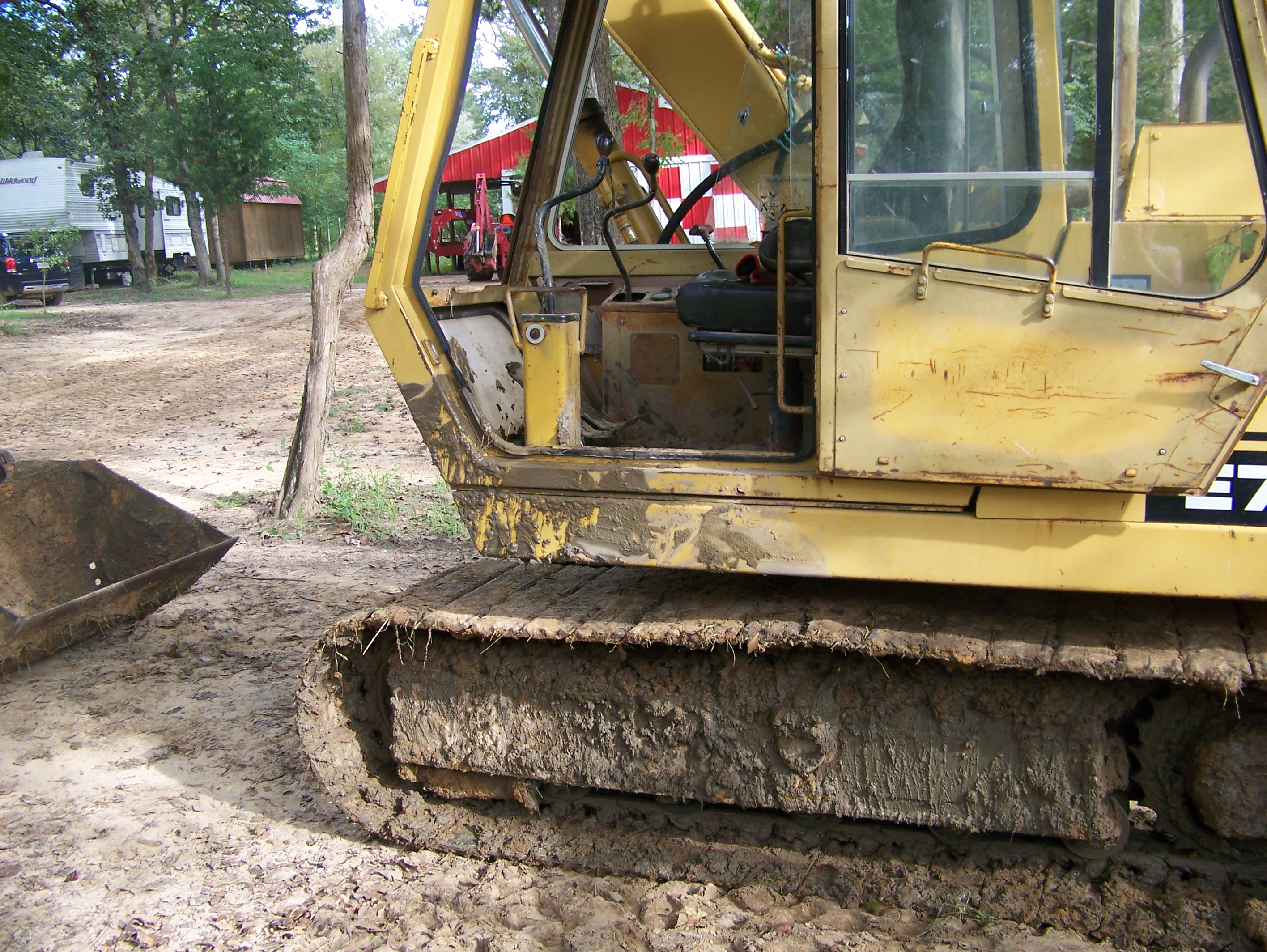

I slid the CAT into the pond's island this afternoon. I was creeping half way down the slope enought to scoop out silt from the base of the island. First bucket okay on scattered vegetation. Second scoop on freshly graded clay slide my left track into the silt. My door opening was at the island and silt was into the door frame corner. I left it at full throttle. I stepped up onto the island and climbed over the right track to climb back up the slope. I got my tractor and another chain (dumptruck needed a pull after dumping near back fence and getting slip stuck) and my son. My son held chain tension while I swung the bucket in front of me and lifted the tracks out of the silt. I didn't realized it, but somewhere in my ride down, the tracks swapped ends. I don't remember backing down the slope anyway. Then he pulled while I alternated between boom and stick pushing with travel. We got her out, but I can not take anymore risks on slopes until I get my hyd. right.
9-5-16 Mahindra & Luke Anchoring CAT Recovery.jpg9-5-16 Mud In & On CAT Door Frame.jpg9-5-16 CAT In Recovery.jpg9-5-16 CAT Bucket Marks On End Of Island.jpg
I didn't think to get the camera before I got it out away from the island. Luke brought the camera to me and the third photo was fogged a little, but you can see the mud on the forward lower door frame. Also the points where the tracks were in the water
