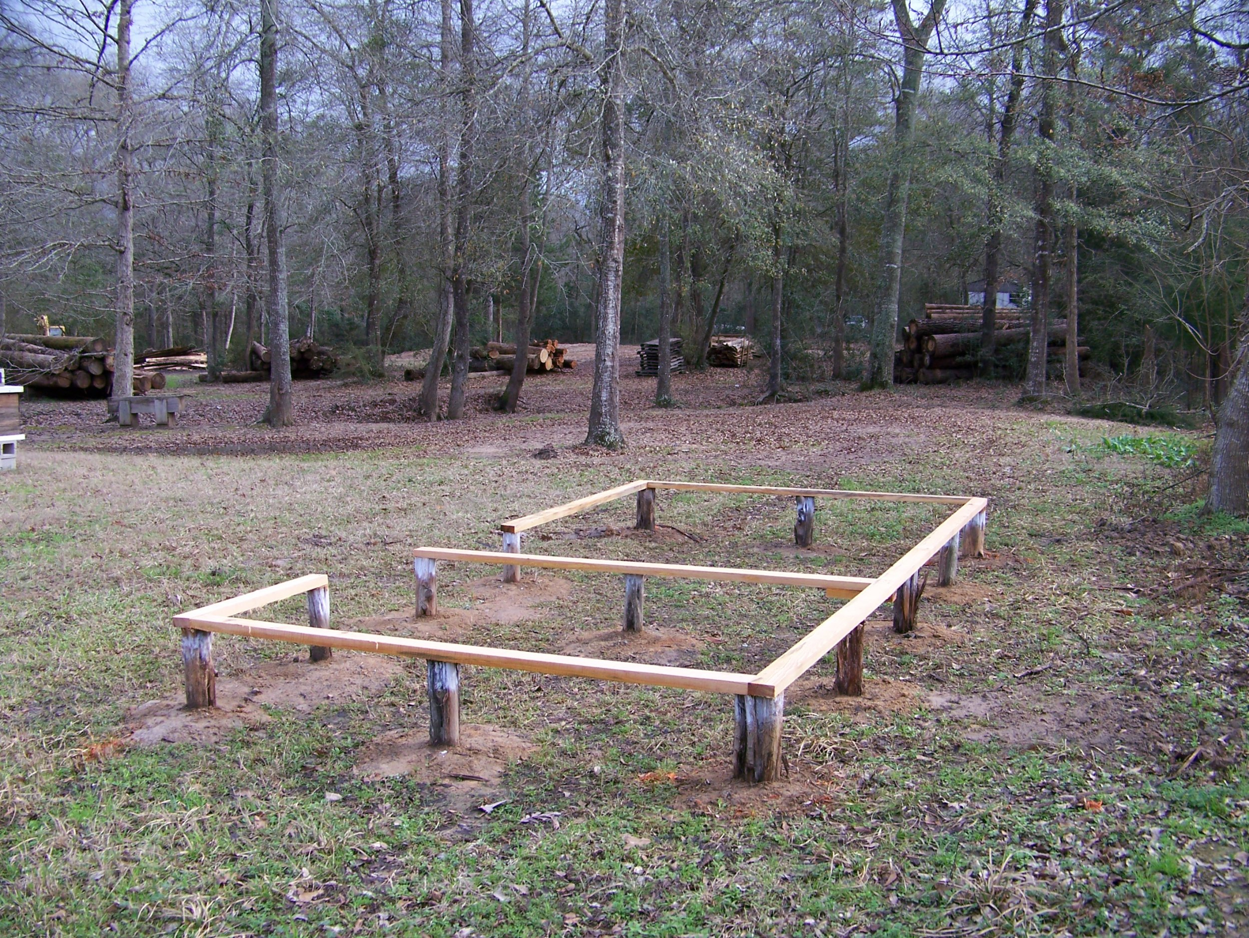

I finally started on the chicken/quail coop for Brady to take care of. It will be 8x16 feet and since it will not have a floor, I am building it on cedar post stub walls. 10 feet for the chickens and 6 feet for quail. Here is the work so far....
I laid the bottom sill yesterday. The day before the sill 2x4s were in a log.
hugs, Brandi

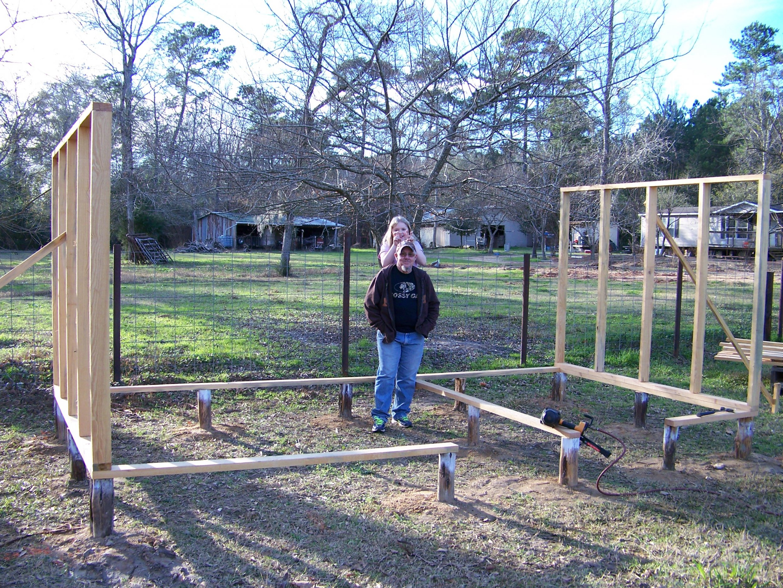

#607
On the 23rd, I got the top sill boards up.
While it rained a week ago, I made the trusses in the barn.
I got 3 trusses up before it got cold and wet.
hugs, Brandi
