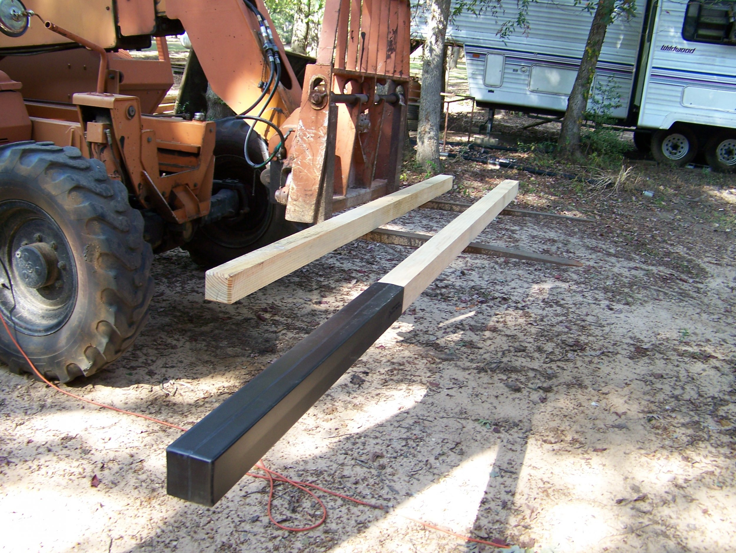

I have been trimming down the poles for Luke's carport for his baby, a 2013 Dodge Challenger R/T.
I had cut the poles to 4x4 months ago. Now I trimmed them down to fit into the plastic sleeves.
Today, I brushed on 3 coats of 8% Copper Naphthenate.
It is diluted 3 gallons of diesel to 1 gallon Copper Naphthenate. After it soaks in, the green will turn brown.

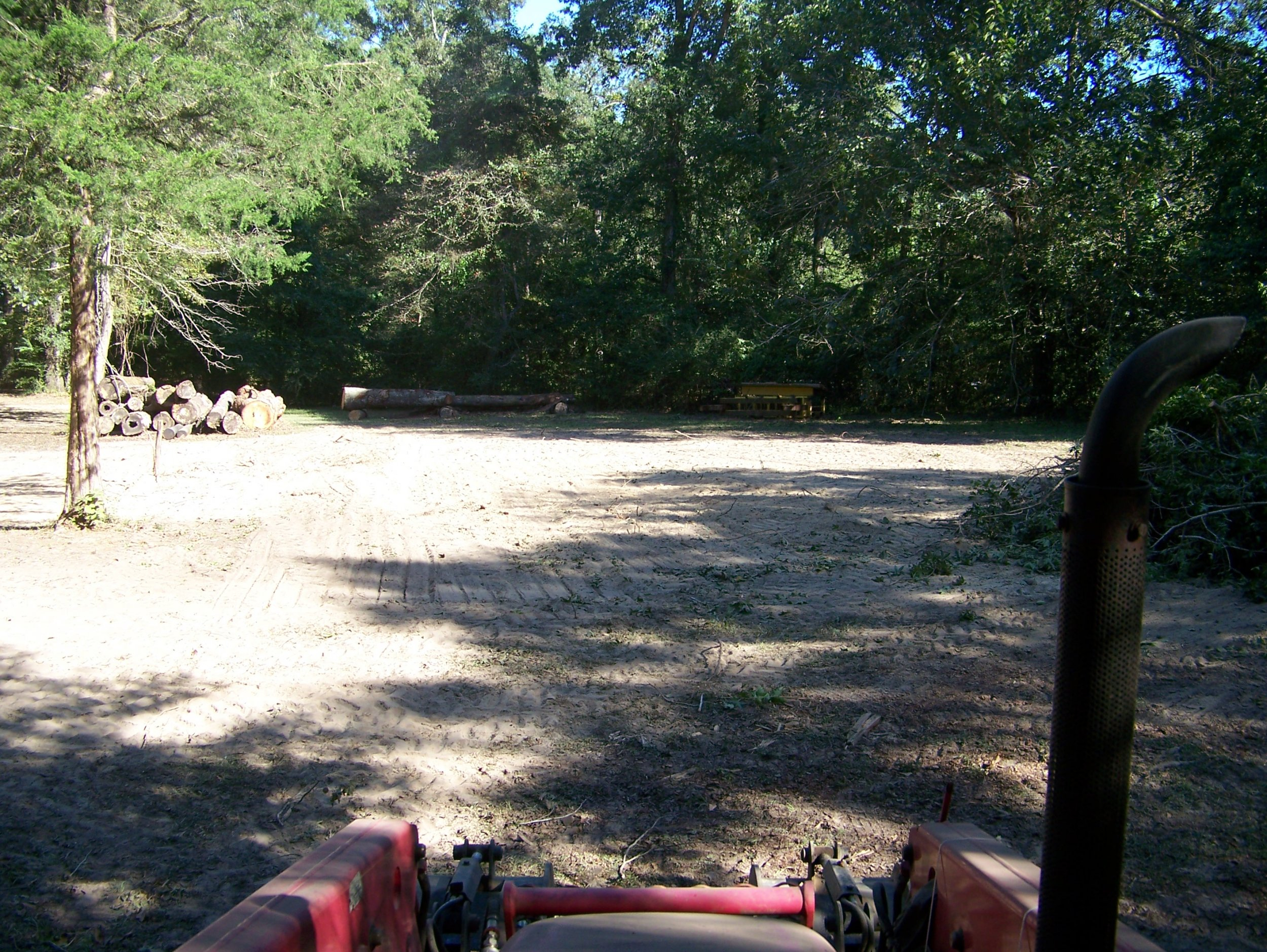

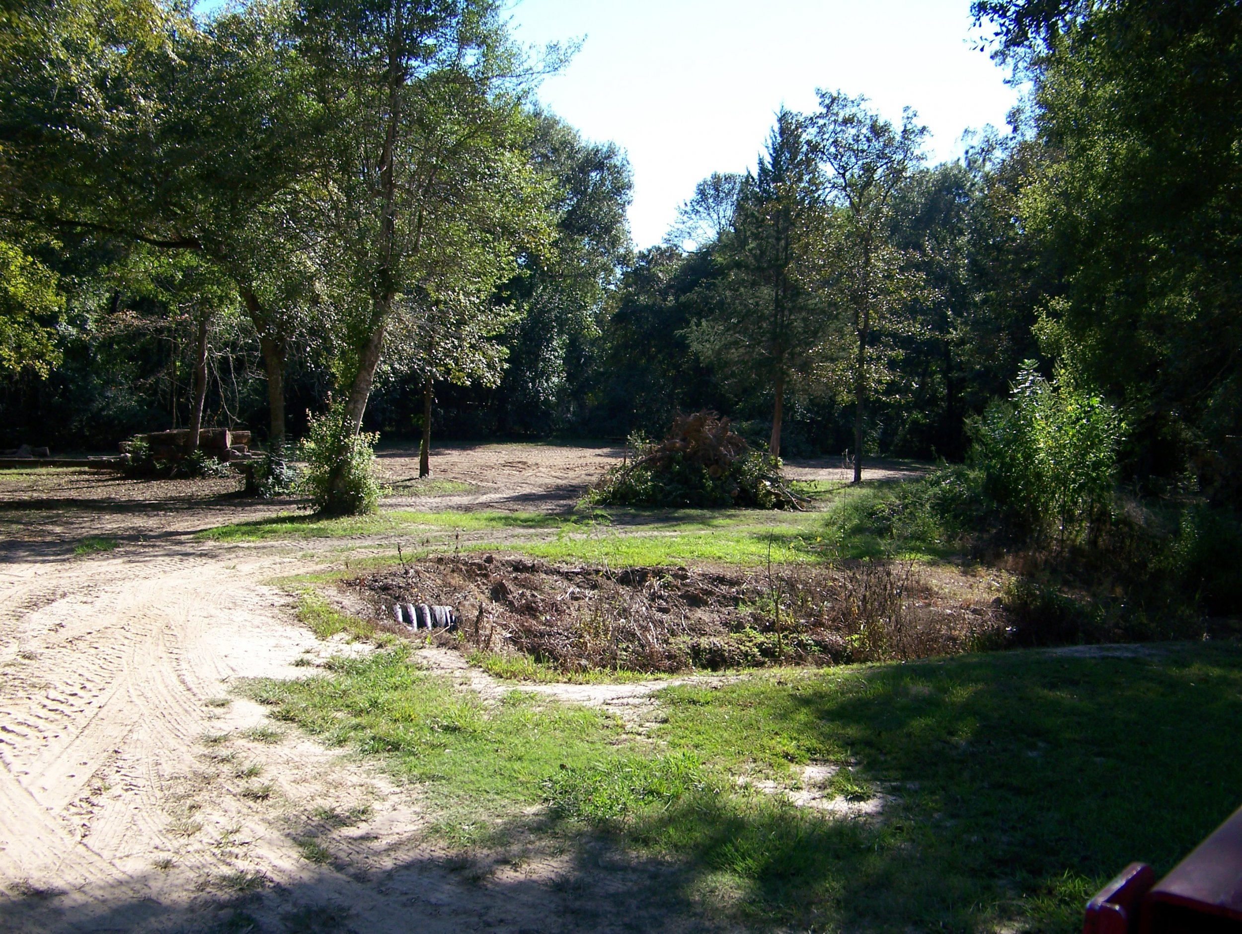

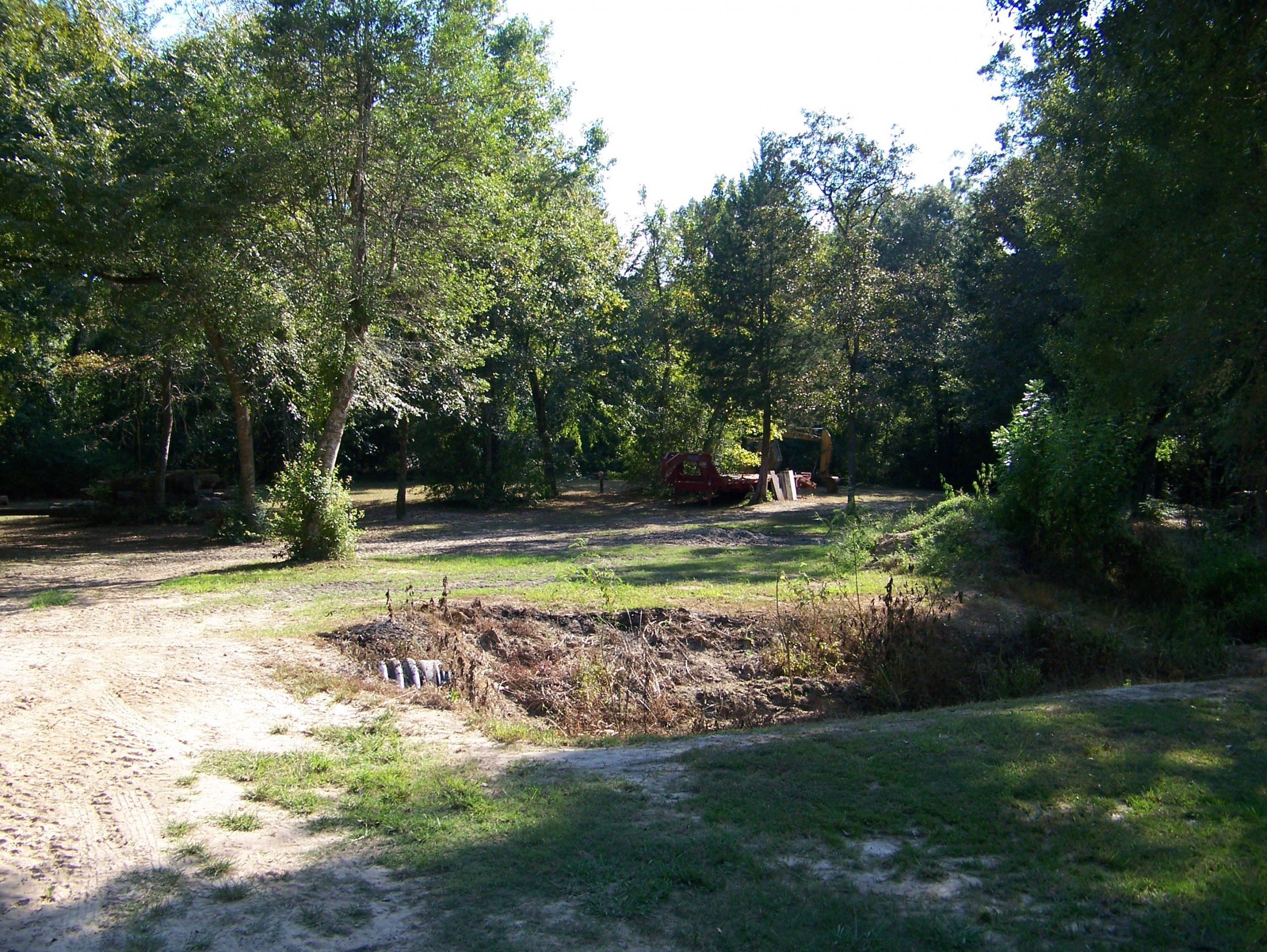

While I am waiting for the brushed on Copper Naphthenate to turn from green to brown, I started clearing for the sawmill shed.
Looking over the gully, here is the site before clearing....
Here is the site after clearing 5 trees.........

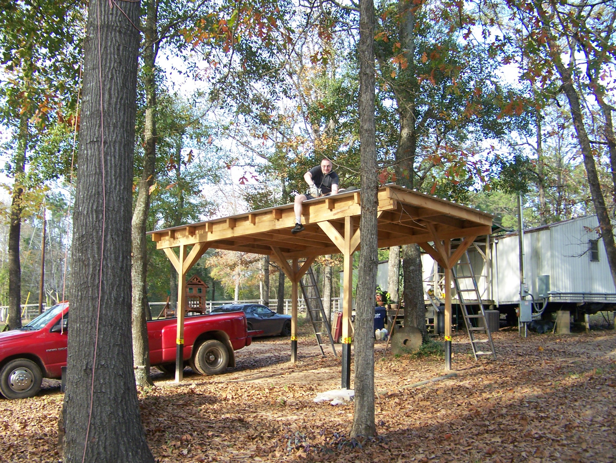

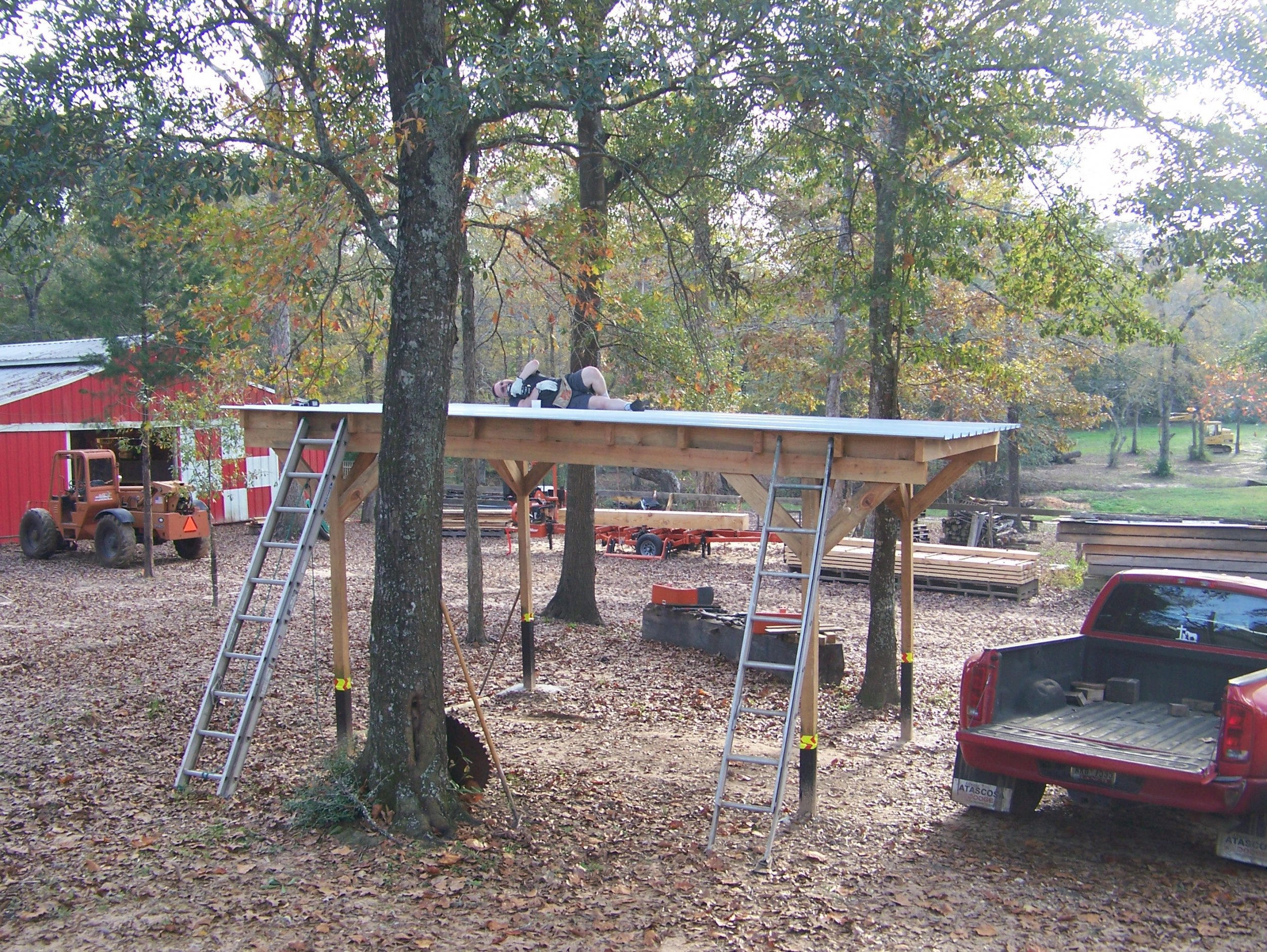

I put off building Luke a carport for as long as I could. It will have to be moved after I get the house in, unless I want a carport and a 2013 Challenger parked in the front yard. Rafters are full size 2x6s, along with the braces. 6 and 8 inch HeadLOK screws (bolts?) hold the frame together. Luke was off today and helped put the screws to the tin.
