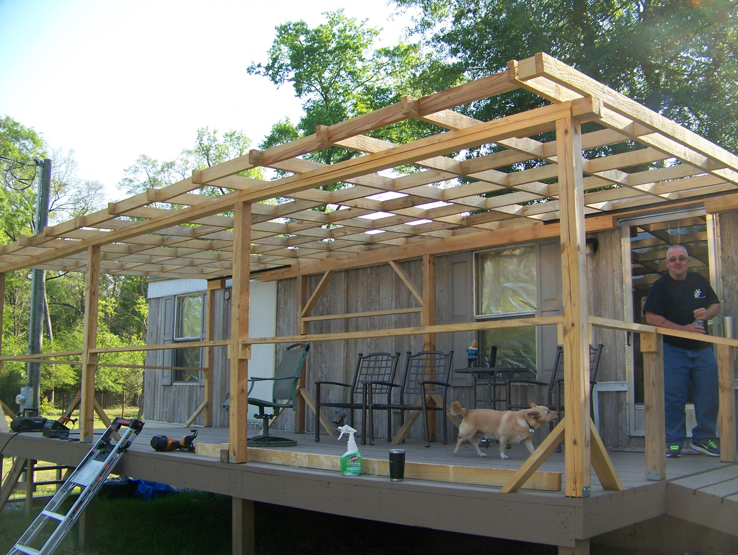

I got the roof frame up back in April. Took a lot cutting short 2x4s to make the pergala style bracing.

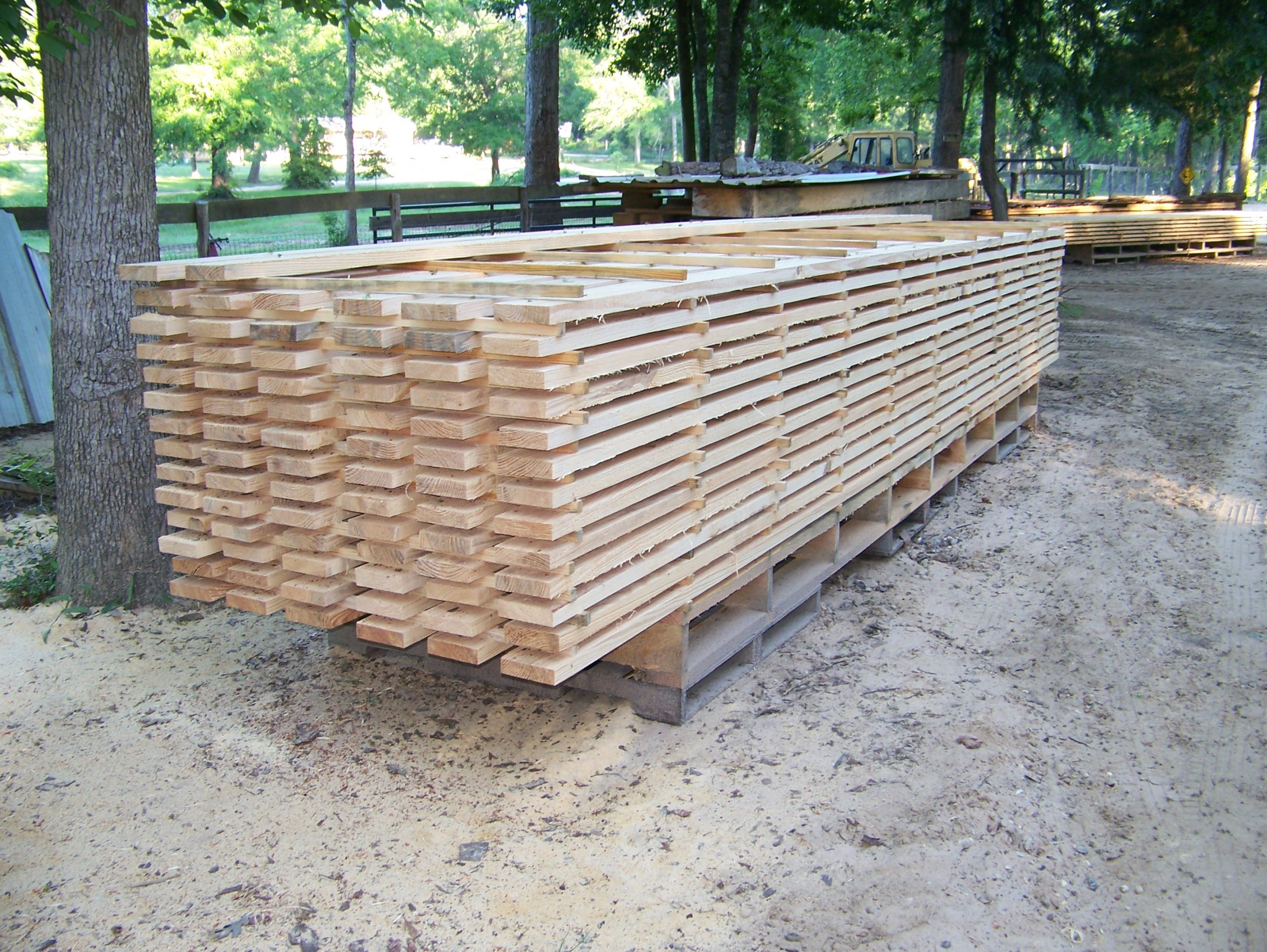

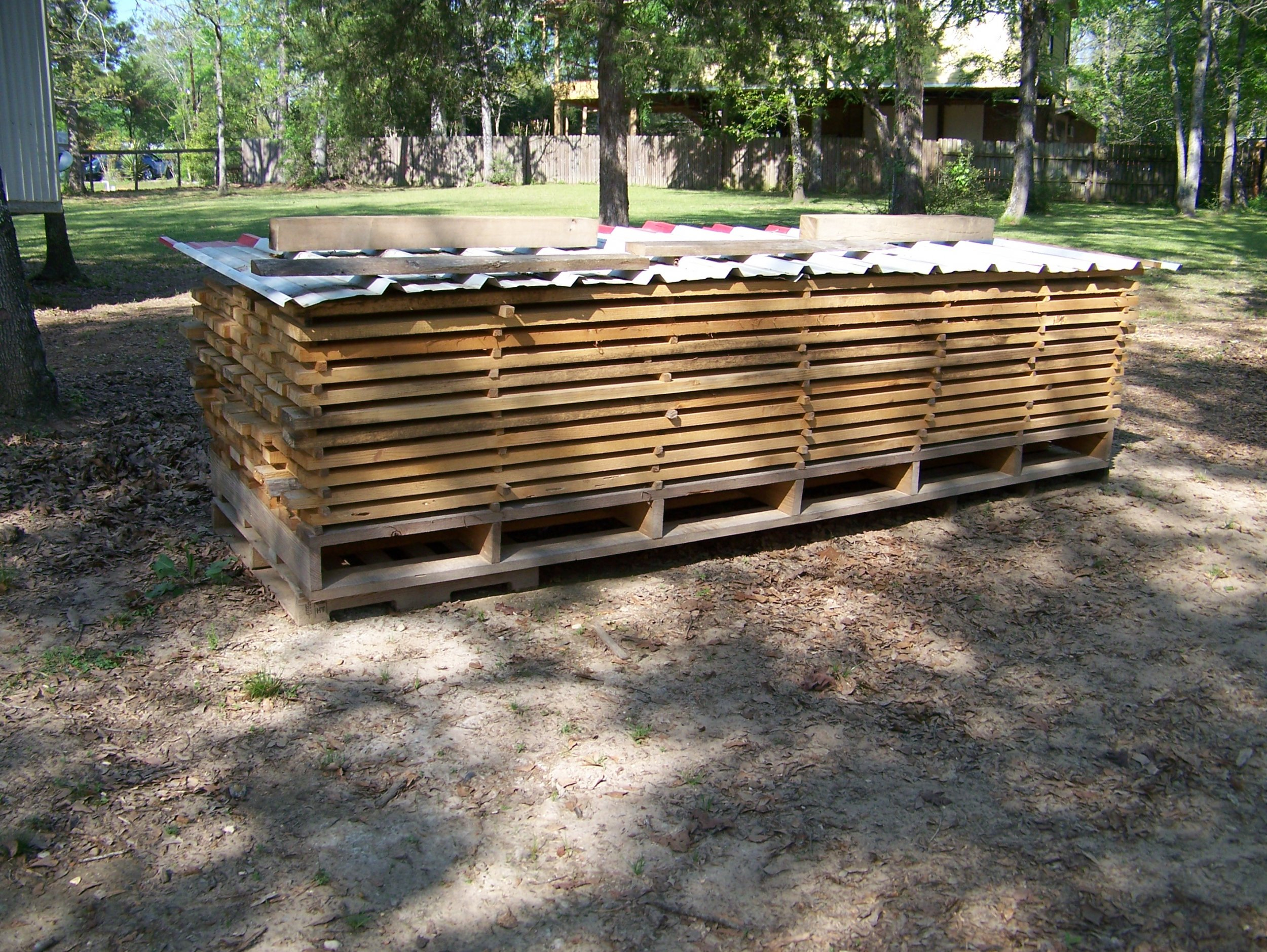

Oh no. Just too busy to post. May was mostly a rain out event(s) here. Back in April, I put a lumber ad in craigslist and deleted it by the end of the month, as I got too many orders. I made about $5,000 in 4 weeks. I did nothing but saw. 8, 10, and even 12 foot 2bys are fun to cut.
But when you get up to 16 foot 2x8s and 20 foot 2x6s......then it is work.
I stacked it all by myself too.

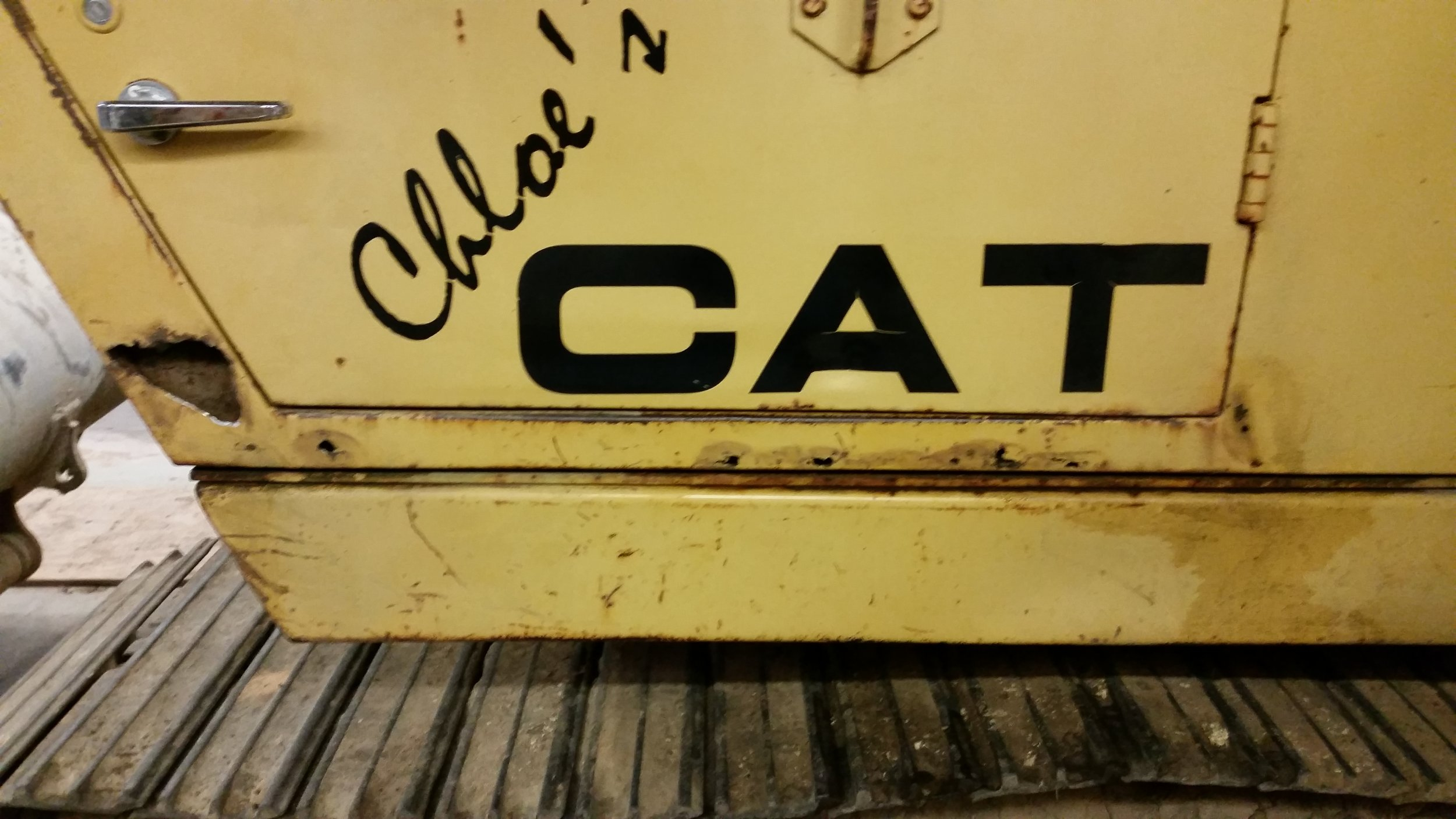

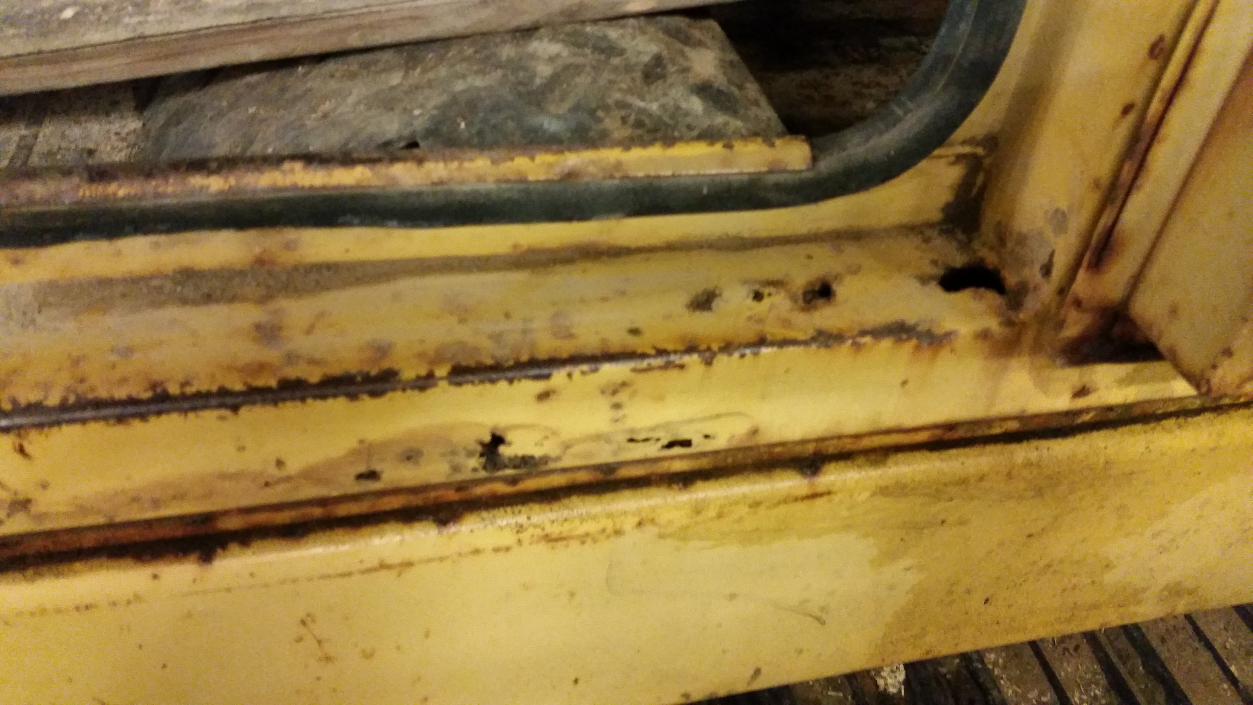

Over time, the CAT developed some surface rust under the door threshold and door post. So I sanded it and it turned into this...............

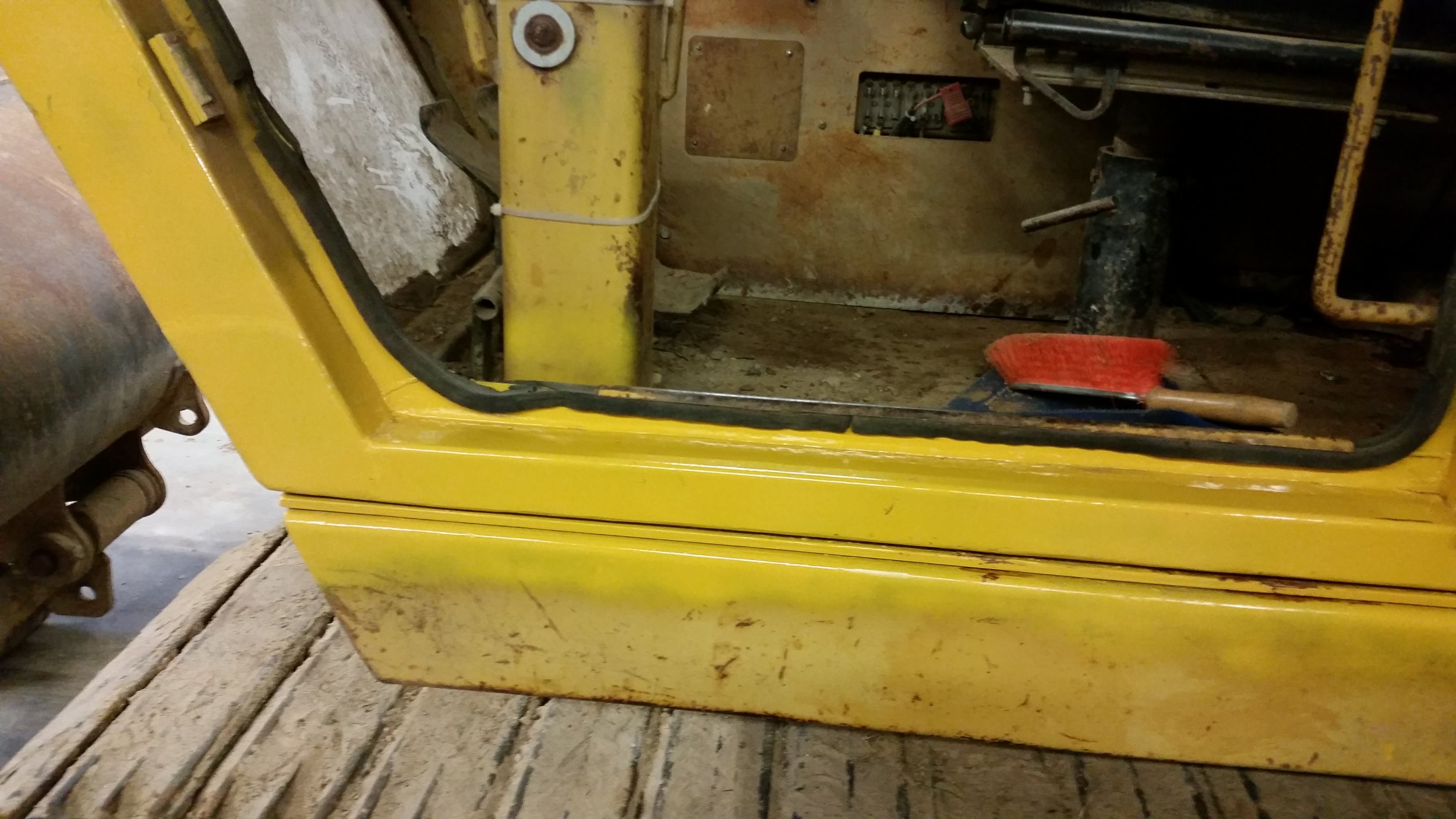

So rainy last week, I welded in repairs. I was welding 1/16" to (I guess) about .080" tube. I wanted to weld it all up, as I had KBS cavity filler to spray inside after painting. But welding the lower edge, I kept blowing out the weld. So I used a broken, 12 inch #40 drill bit for filler. That worked well. For bigger blowouts, I filled in with 3/16" square key stock. That was a lot of grinding.
While doing these repairs, I realized the inside (to the floor of the cab or house) was pitted out. I didn't do anything here. But the cavity filler ran out. Did I mention the cavity filler stinks?
Sorry for the not so clear photos. They were taken with my cell phone.

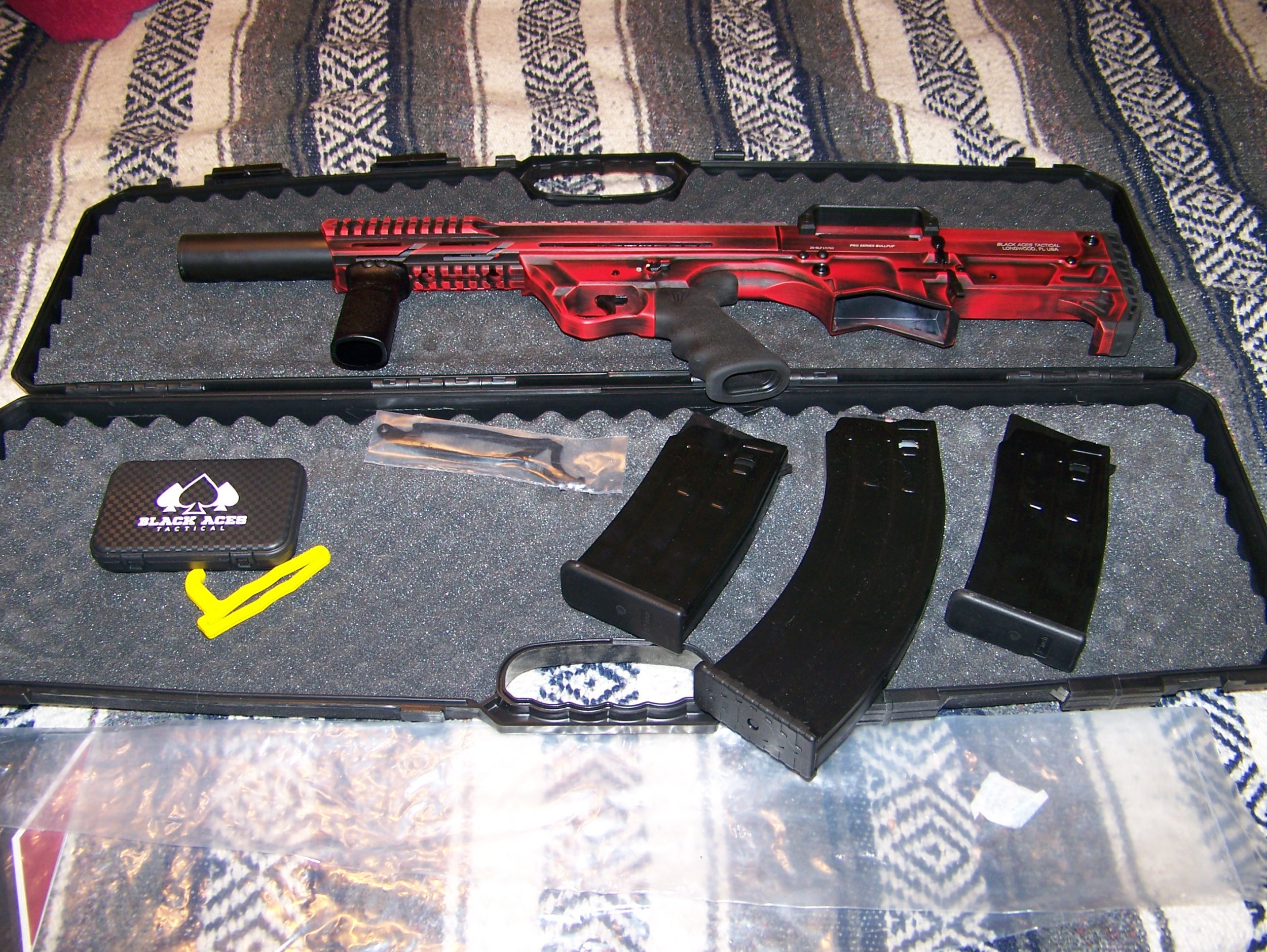

While all the rain was coming down, I found this from Black Arms Tactical............
It is a 12 gauge LEFT HANDED Pro Bullpup shotgun from Guns.com. Atlantic Firearms had 10 round magazines for it also. I bought 4 of them. It came with two 5 round mags and 3 different chokes. I really can't understand why a 18.5 inch barreled shotgun needs chokes. I will have to find out why when I got some "free" time. I haven't even heard it go "bang" yet.
I haven't figured out what the yellow thingie does. It doesn't help load shells, that I can see. Anyone know what it is? It is plastic. Maybe it helps in choke removal and insertion?
Also, I really wanted it in Distressed Green, instead of Distressed Red. But after a friend and inquired around, we found out a green one might be available in a year. Or not! Only other color available in Left Hand was Vietnam Tiger Stripe, which was a non started in colors. Oh yeah..............try firing it right handed...................I dare you!

I had the CAT out in the rain last night. Just as I thought, the area of the angle repair's top holds a little water. I need to either add Bondo or leveling compound, so it will run off. Or just wipe it off after EVERY rain.
