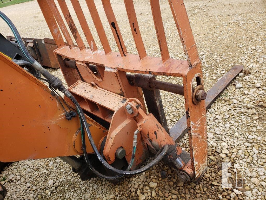

I have 54" forks on my little forklift and I really like the extra length compared to the normal 42" ones. I have 8' forks on a big lift we are using now and they suck. Between a rack that is packed with cylinders and my eyes needing new glasses, you can't really see the end of the forks and have to have a spotter. As far as the SSQA plate, if you can weld a standard plate could be modified for the telehandler. SSQA plates run in the $350 (look rather cheap and imported from the land of people who are not good welders) to pretty nice for about $700. Cut the back off of the one that you are getting on the telehandler and graft it onto a new adapter plate and you should be good to go and have money left in your pocket.
I don't want to do that. It has tilting forks........... Lull Fork Titl Carriage.jpg
I want to keep them intact. But I may swap out the forks on my skid steer plate for these forks.

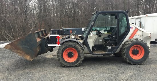

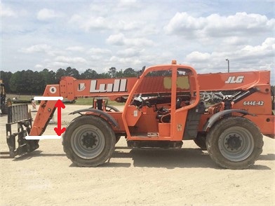

From what I have read it would break the boom where it goes down to the attachment. But yours isn't as long as most fullsize, so it might be OK. I think all of the compact telehandler brands are approved for digging with a bucket.
This is where they break on the fullsize:
This is a V518, Bobcat's first compact telehandler, notice the difference:
Okay, on the gooseneck (my term). That all makes sense now. What about gravel? Sawdust removal will be one of it's duty with a huge, light weight bucket.
