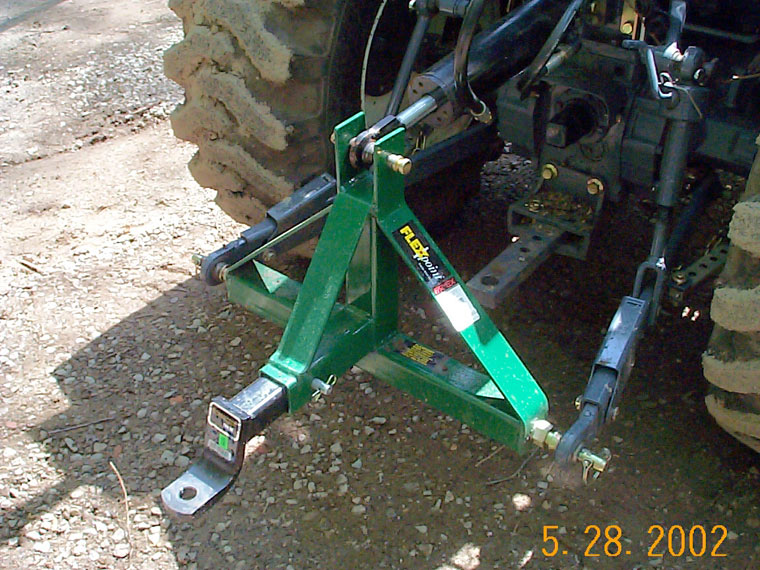

I have a Kasco Quick-Tach adapter Forks, and my <A target="_blank" HREF=http://www.tractorbynet.com/forumfiles/5-145669-Switch_Hitch.jpg>Switch-Hitch</A>. I would prefer to make the personnel lift hook right up the Uni-Hitch but after calling my dealer I decided not to go that route. The cheapest set of Quick-Tach plates he could get were $119 and that is just about the same price I paid for all the material I bought to make this whole project. I decided to have the personnel lift hook up to the Switch-Hitch's 2" receiver. It seemed the most economical and reasonable choice.

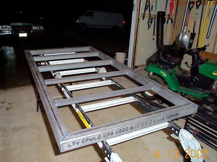

Here is a pic of the upper level (deck) that I worked on tonight. It is made out of 2" by 2" square tubing with an 1/8" wall. It has 1.5" by 1.5" by 1/8" angle iron every foot for bracing to stiffen up the expanded metal that will cover the deck.

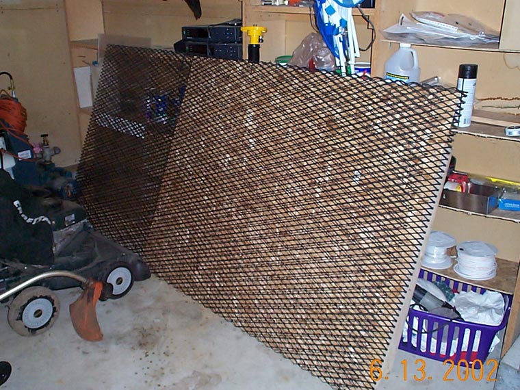

I got two different kinds of expanded metal for the project. I got "3/4 #9 Flat" for the decks and "1-1/2 #13" for the sides. Here is a pic of the two sheets of expanded metal.

I did think about having the lift mount to my forks but I think I have made the right decision about going the 2" receiver way. My forks weigh more than my Switch-Hitch so that would reduce my lifting capacity (not by much, but still). To use it with the forks I would have to have some sort of device to secure it to the fence on the forks, like the safety chains you mentioned. In order to use the safety chains effectively I would need to have the lift up tight against the fence. Using my 30” by 60” design that would leave two 18” sections of fork sticking out in front of the lift (I have 48” forks). I’m sure most of you are cringing at the damage that could do. I could have altered my design to be 48” instead of 30” but I don’t see much value in having an extra 18” of workspace in that direction. The further out I go from the tractor the lower my lift capacity is. I thought I would get more function out of having a longer workspace from right to left like in my 30” by 60” design. I could have made some sort of spacer to anchor the lift 18” away from the fence but again that would reduce my lift capacity. With my 2” receiver design I can also mount the lift to my 3-point because I have a 2” receiver that mounts on the 3-point (see attachment). I’m not sure yet of all the reasons that I might want the personnel lift mounted on the 3-point but then again most people probably never saw a rear blade mounted on a FEL like I did <A target="_blank" HREF=http://www.tractorbynet.com/cgi-bin/compact/showflat.pl?Cat=&Board=projects&Number=153770&page=&view=&sb=&o=&vc=1>here.</A> Having the lift mount on forks may make it more versatile for someone else but having it on the 2” receiver makes it more versatile for me.
I do plan on putting a door in on one end of the lift. I bought some 1” by 1” square tubing with an 1/8” wall. I bought some nice heavy-duty pipe and a piece of solid round stock that fits nicely inside the pipe to make some hinges out of. The other three sides of the lift will be fixed.
I have a couple of different ideas about the top safety rail. I am not sure which way I will go yet I will see when I get that far. I will probably end up enclosing all three sides and the door with the expanded metal.
The beauty of being able to weld is that nothing has to be permanent. If after considerable use by myself I found this lift worthy of sale. I can easily cut the 2” receiver tube off, weld on two pieces of rectangular tubing to the bottom, and fashion up some safety chains. I seriously doubt that I would ever sell it though, I have been self-employed for over 13 years and therefore I am always thinking about liability. Having it on the 2" receiver makes a good excuse for not letting anyone else borrow it.
