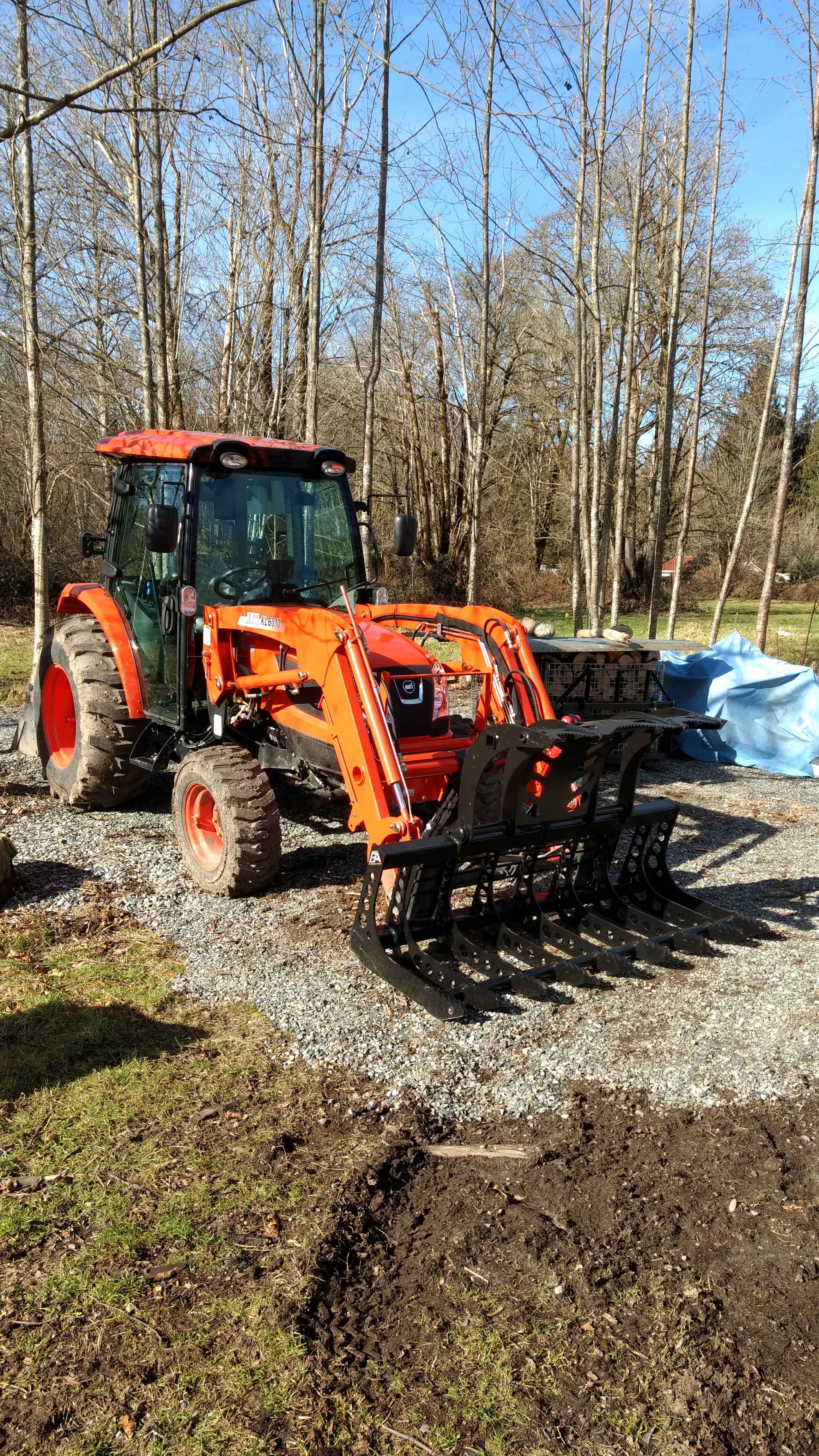

Hose Saver from EA arrived today. What works best to affix one of these things to our tractors? (yeah, I should have figured this out BEFORE I bought one:rolleyes:)
Looks like they provide the option to use a through-bolt or a weld-on piece that you then bolt to.
I have no welder. I could pop off the shield over the hard lines on the torque tube and take it somewhere for the weld-on piece; not sure if this is study enough metal.
   / My NX5510H
#209
Staging the Hose Saver (HS) and I'm not liking how it looks. Some of this has to do with the length of the lines on the grapple- they're 6'. EA said that they were going to provide longer lines and it now looks like that wasn't a good choice. While the HS appears like it will support the 3/8" lines on the loader OK the grapple lines (1/2") have too much slack.
Another issue with the HS is that it seem too short, such that the hose couplings hang down and against the torque tube. If I were to lengthen the 3/8" lines to drop the couplers lower then the excess slack on that side (grapple) is going to be worse.
It's a pain trying to temporarily set things in place to check position/operation. I'll see if I can get a picture (need another set of hands).

Diesel, pics would help. My EA Wicked Root grapple has the Hose Saver mounted on it, so none is needed on the FEL itself. Does your grapple not? Or perhaps are you wanting to add a second HS on the torque tube as well? If so, I hadn't thought of doing that. Can't you just bolt it directly on top of the torque tube cover, using one of the four studs and nuts that fasten the cover to the torque tube? Apologies if I'm misunderstanding.
