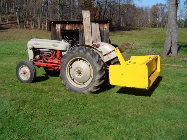

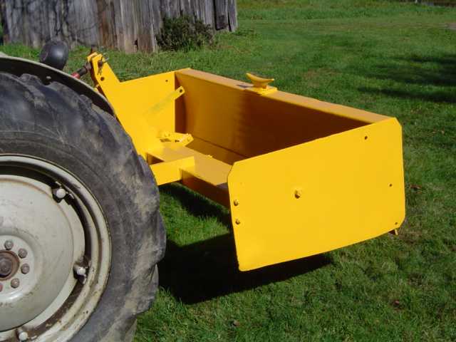

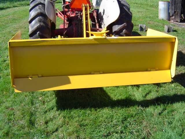

Here is the final outcome. Straightened the sides, as much as was practical, removed the loose rust, painted ... yellow, as you can see. While probably not exactly the original color, close. Plus, I find that things, which are yellow, can't be lost, as easily. :laughing: Currently, it is "sun baking".

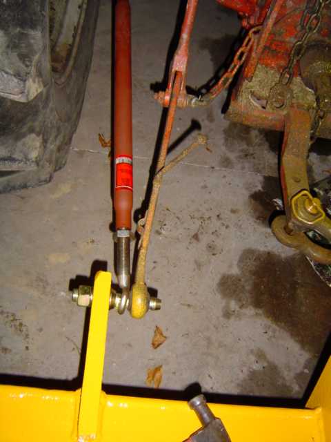

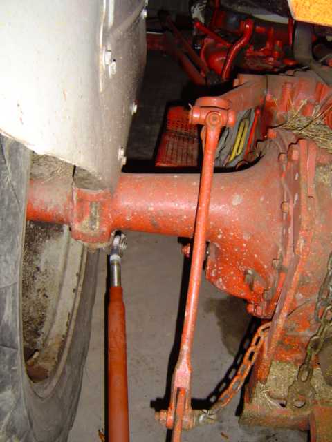

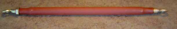

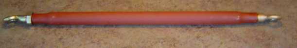

As I said before, the box blade was difficult to hook-up. Part of the problem was, that the "fixed stabilizer bars" were fighting each other. So, I ordered, and received today, a new adjustable stabilizer bar. These weren't specified for the Ford NAA, but I figured I could make it work.
The eye on the RH thread end had a dog-leg, like I would expect would be required. The LH thread end was straight. I tried it and it wasn't quite right. So, I heated and bent a dog-leg on the LH end. My final determination was: that the factory RH end was bent a little too far (on bade in pic) and the LH end, which I bent, was bent a little too far (on tractor in pic). The weather is too nasty to be going from one shop to barn, etc.. I'll get it, when the weather improves.

I took a little of the bend out of each end of the stabilizer bar and it slipped right on. The "adjustable stabilizer" will make a big difference in hooking-up, as I'll be able to pull or push the heavy box blade to the correct position to attach the lower draft linkage. :thumbsup:

I notice, that you have the telescoping stabilizer bar, which I considered. However, I thought a bar that connected to the draw pin would work out better for me, as once the bar was on the draw pin, I could pull or push the box blade for alignment, to get the draft bar to connect.
