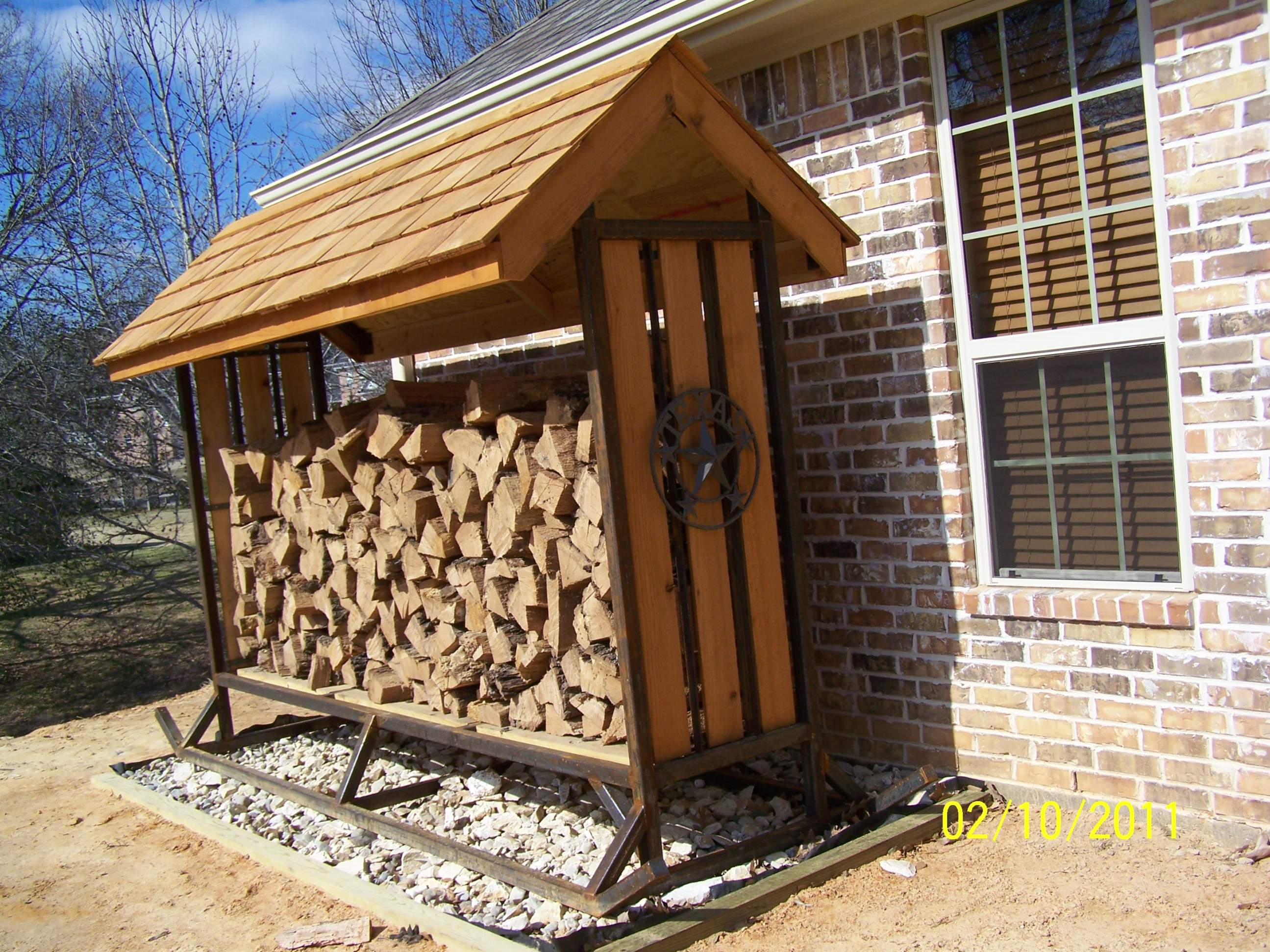

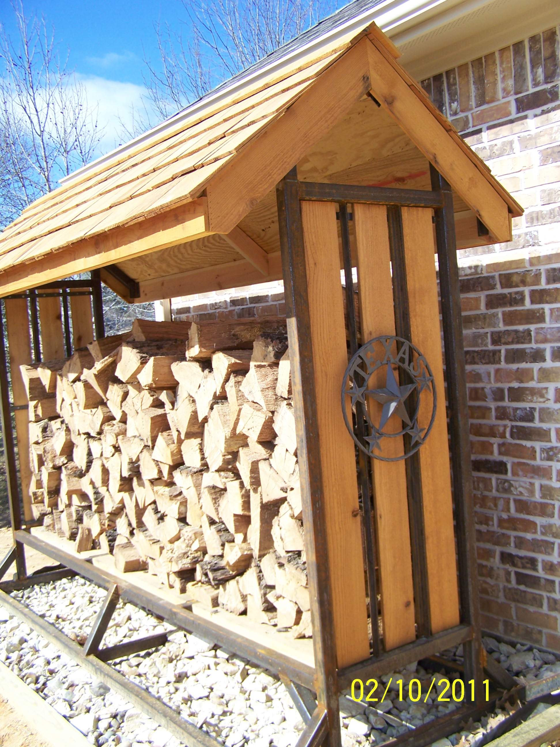

Just got done building ths rack...it kind of kept growing as I went along. I mean the roof was an afterthought. But with the 2x2x1/4" tubing weighing 6-700lbs, the cedar shingle roof and its substructure brings it up to 1000lbs+ and cord of oak weighs in around 3500lbs...total is about 4500lbs. My JD 2520 didnt break a sweat dragging it around the house and positioning it....

Very nice...did you have a plan to work from or is the design original?
Not to take anything away from it...but a little ginger bread on the gable fascia might not look bad...!

Very nice......... you sure don't have to worry about overloading it. Only thing I may have done different, would be just pitch the whole roof away from the house so water is not coming down the roof , hitting the wood rack, and then being directed right at your foundation. But...... no doubt I'm over thiinking it. :thumbsup:

Very nice. If it didn't have the cross pieces on the very bottom, or if they angled up from the "runners" to the crib, it looks like you could hitch it to the drawbar and skid it on those runners to the splitter and back to the house when it's full. Might want it a bit wider and lower for stability if one were to try that. You just gave me and idea - thanks!
Thanks..yeah, it's original. I thought about adding cedar shingle on the end gable like you suggested to dress that part up a little. But snow moved in and I was thinking the project was getting a little overdone...just to hold chunks of wood. I may add that this spring tho. The rack is 6' usable height by 30" deep by 12 feet long. Holds a chord comfortably.
Our home is new with no yard as of now. We will be going hot and heavy in a few weeks. The location of the rack is just temporary and will be a little further away from the house later on. I built it on wide skids to facilitate moving,but the bottom cross pieces will dig in ,so I put temporary pipe rollers under it when moving.
If ya'll notice, I didnt put any finish on the metal. I'm going to let it rust and go over it later with a product that turns the rust into a sort of primer. It will keep it rustic looking and protect it as well. Thats my wifes idea anyways.....
