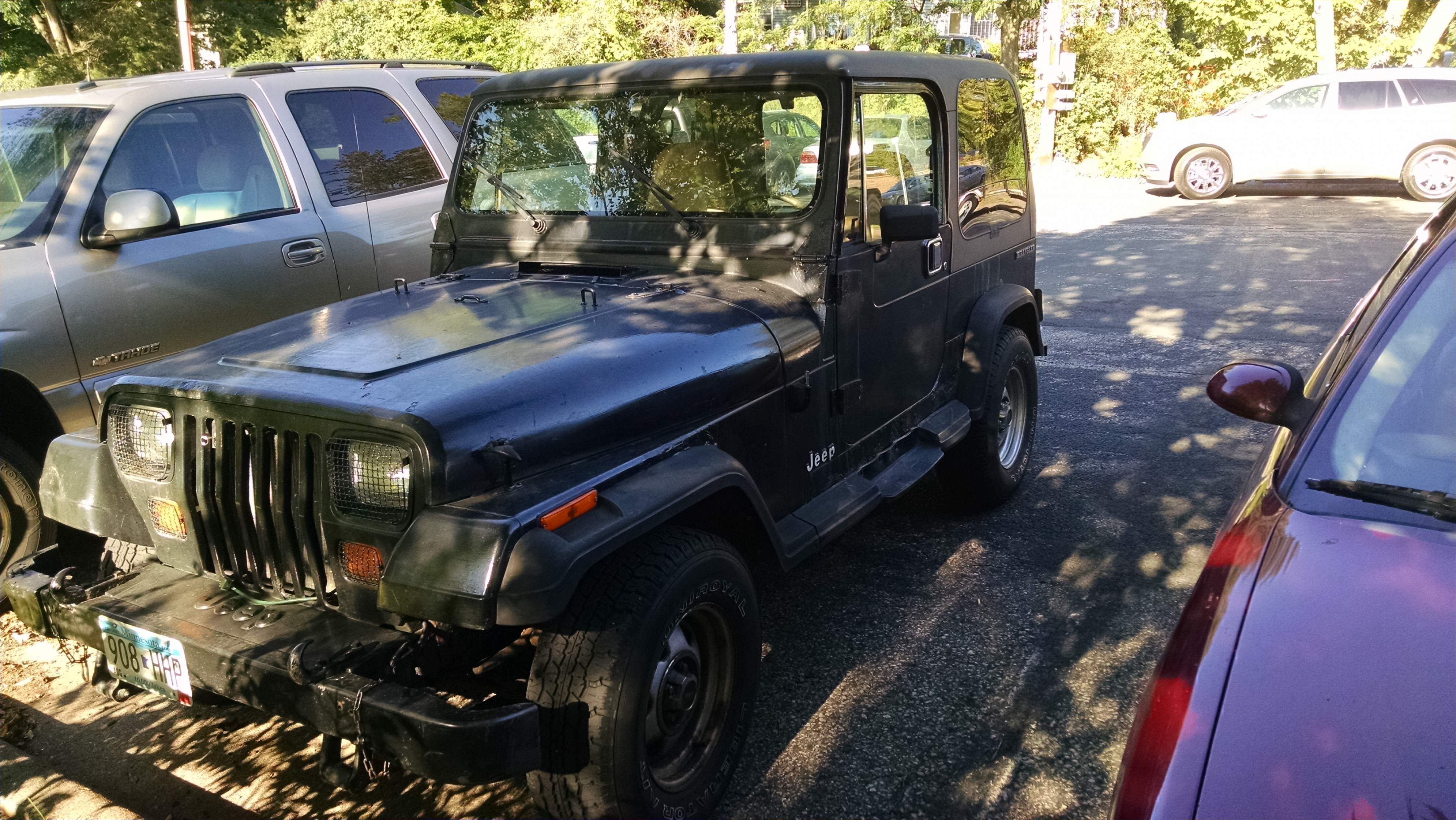

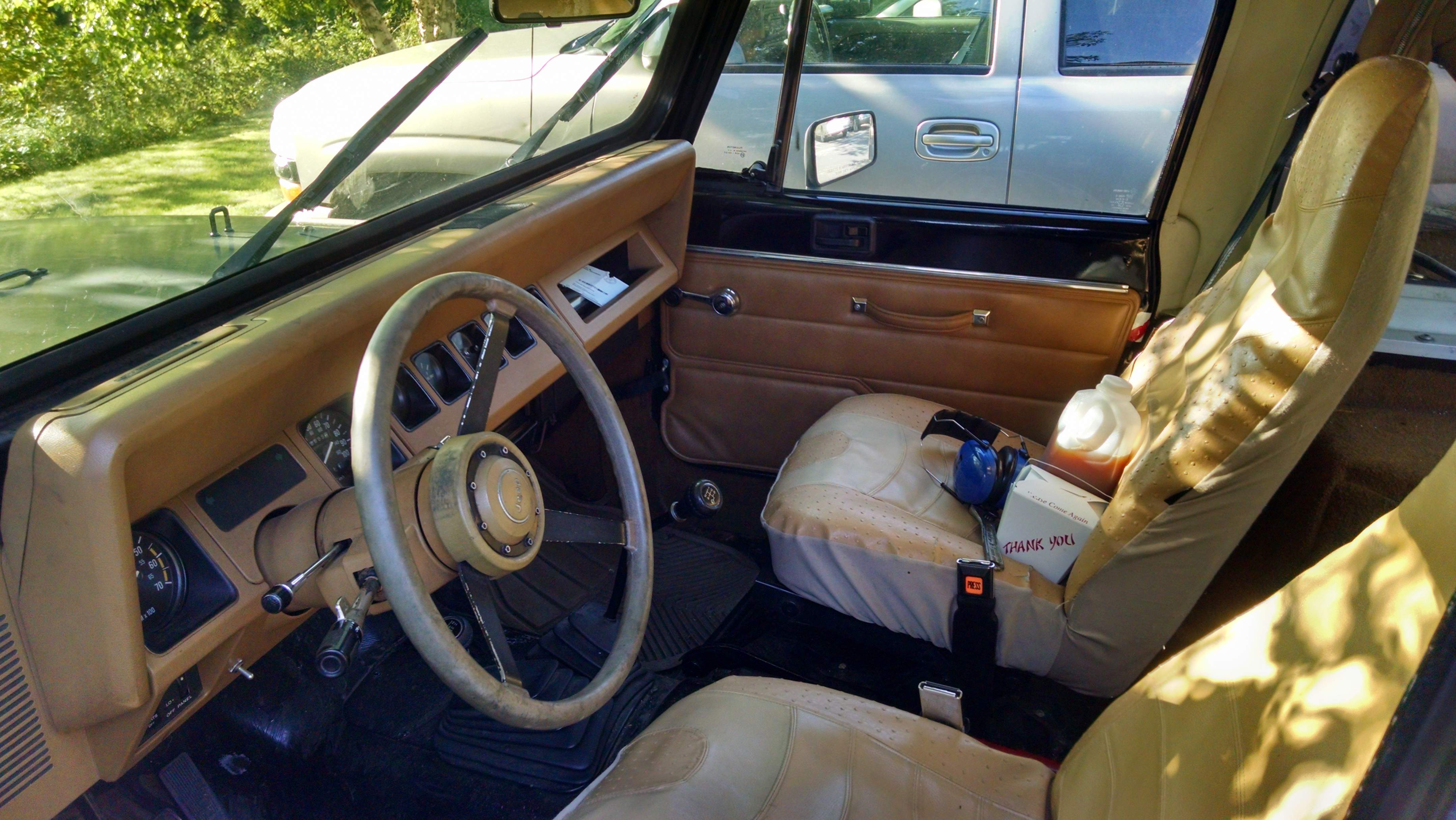

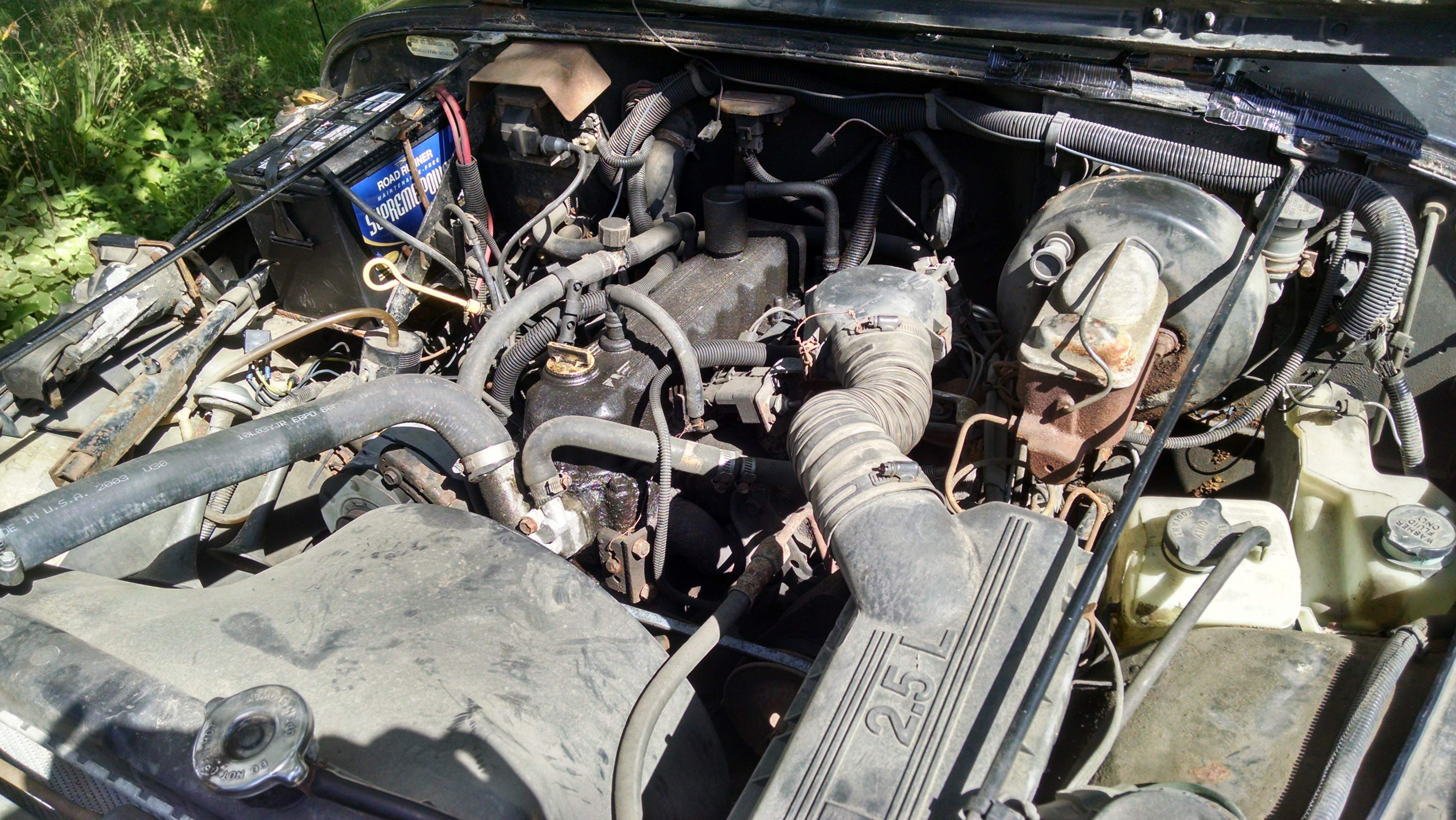

I started a thread a few days ago about buying an 87 Jeep wrangler to use around the farm.
Well, the deal is done. $300 cash and $150 worth of our premium organic vegetables. IMG_20150912_135804406_HDR.jpg

That looks much better than I expected. How does the frame look?

That does look great for the price - you did well!

Yeah, the rust sure takes it's toll up here. This one's got some cancer in the body, but the frame looks good for now. At any rate, I've got nothing to complain about. It runs good and drives down the road just fine. Can't wait to start using it on the farm!

Even a 4 cylinder Jeep can get around pretty good.

For offroad use I'd rather have a straight four than a V8.

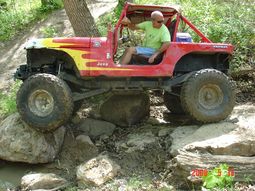

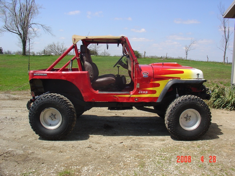

Good find. You'll get many, many years of service out of that Jeep. 4cyl is fine for what you will do with it. If putting a lot of hiway miles on a Jeep I prefer a 6cyl. But you'll be fine.
Cut the sway bars off and the front track bar. Then weld the rear diff solid. You'll then be surprised how well it'll get around on the farm.
You've got a Dana 30 front axle and a Dana 35 rear. Being a 4cyl they are 4.10 gears.
If you want to run a slightly larger tire the cheapest and easiest way to get clearance is a body lift. 1" will allow a couple sizes larger tire. 2" will allow a 32" tire if you don't mind a bit of rubbing when turning sharp. I don't recommend more than a 2" BL.
I'm 5' 10" tall. I like seat risers. Best for me is 1.5". Makes seeing over the hood much easier when offroad. Also uncramps the legs a bit.
I wheeled an 87 Wrangler for 15 years until I lost it in a shop fire. It had evolved quite a bit by then. :)

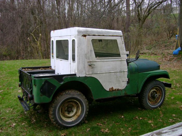

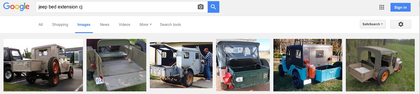

Long ago, almost every farm Jeep in my area had a half-cab so it was a short pickup.
Bed extensions were also common.
