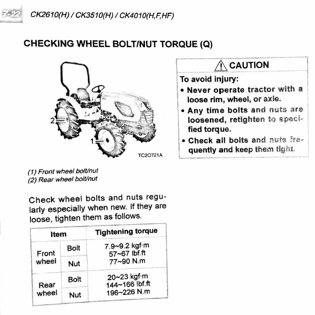

Oh right, things to check:
Loader and wheel bolts - re-torque to spec (edit: don't loosen and re-torque, just set your torque wrench and check if they are still tight enough). Hopefully none are loose, but it can happen.
I would find every grease point and inspect/clean/grease.
Check hydraulic and engine lube oil levels/condition. Coolant too.
Might as well put some wax on it now too, if the body panels and big frame areas are still clean enough!
Where would I find the torque specs? Are they in the owner's manual? (I don't have access to my manual for a few days.)

Yeah, should be in the owners manual. Here is a screen shot from the manual, for lug nut torque anyway. Might have to make educated guesses on the loader bolts. I can't seem to get the whole manual to upload here.

The FEL manual will have full chart of torque specs for loader and all other sized bolts that can be used to check ROPs as well.
