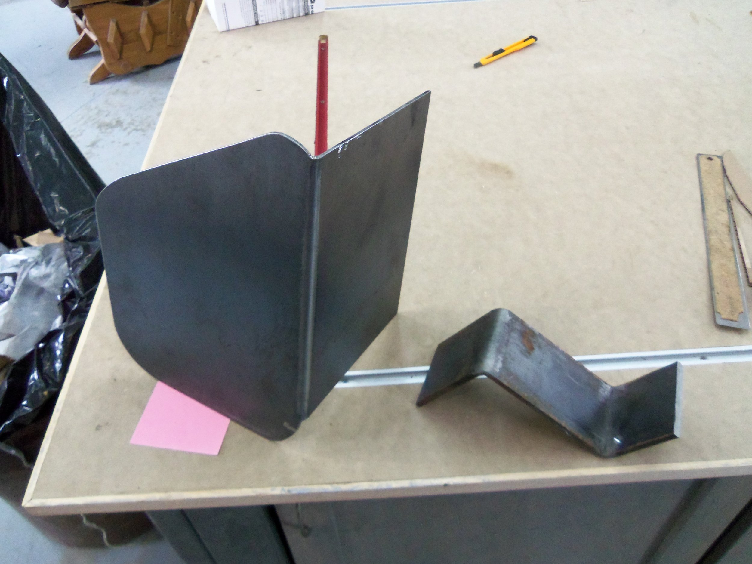

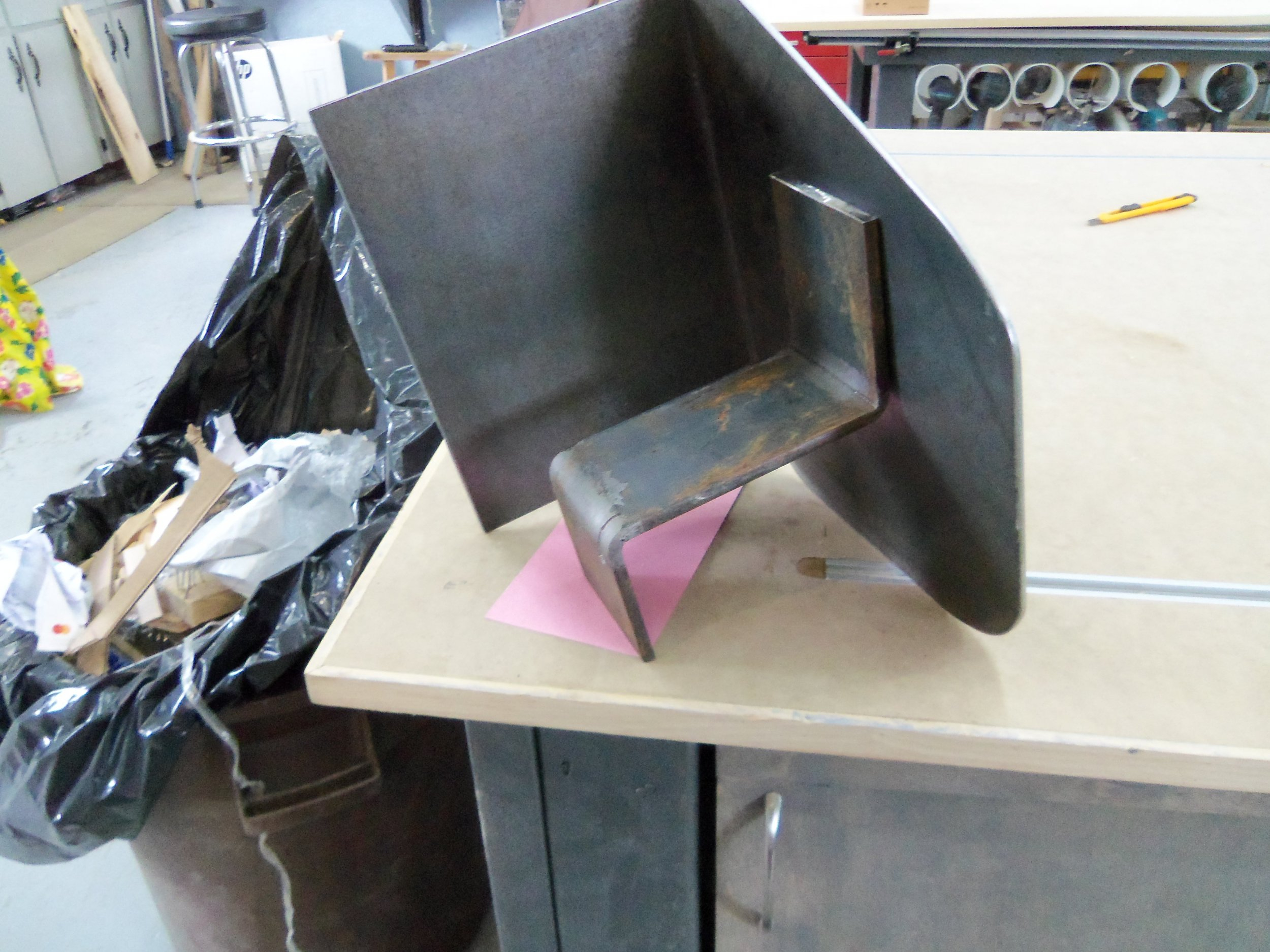

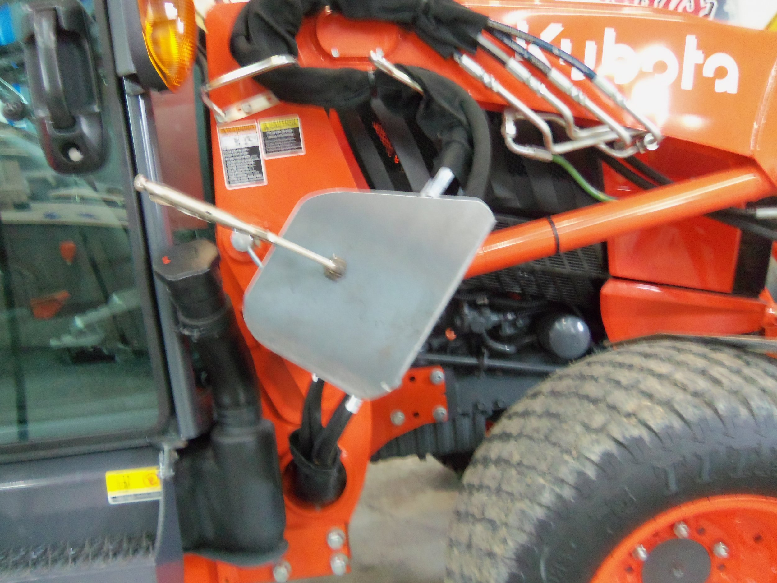

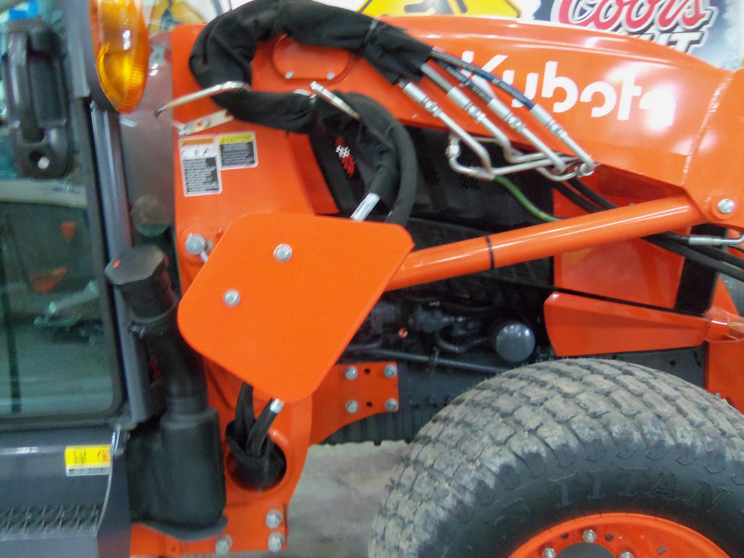

Now a L4060 had B2650
After seeing this on you tube i just had to d one also. I used 1/8 steel for the plate and 1/4 x3 in flat bar it work out pretty good and i thing it look good you don t see the hydraulic hose quick connect any more .

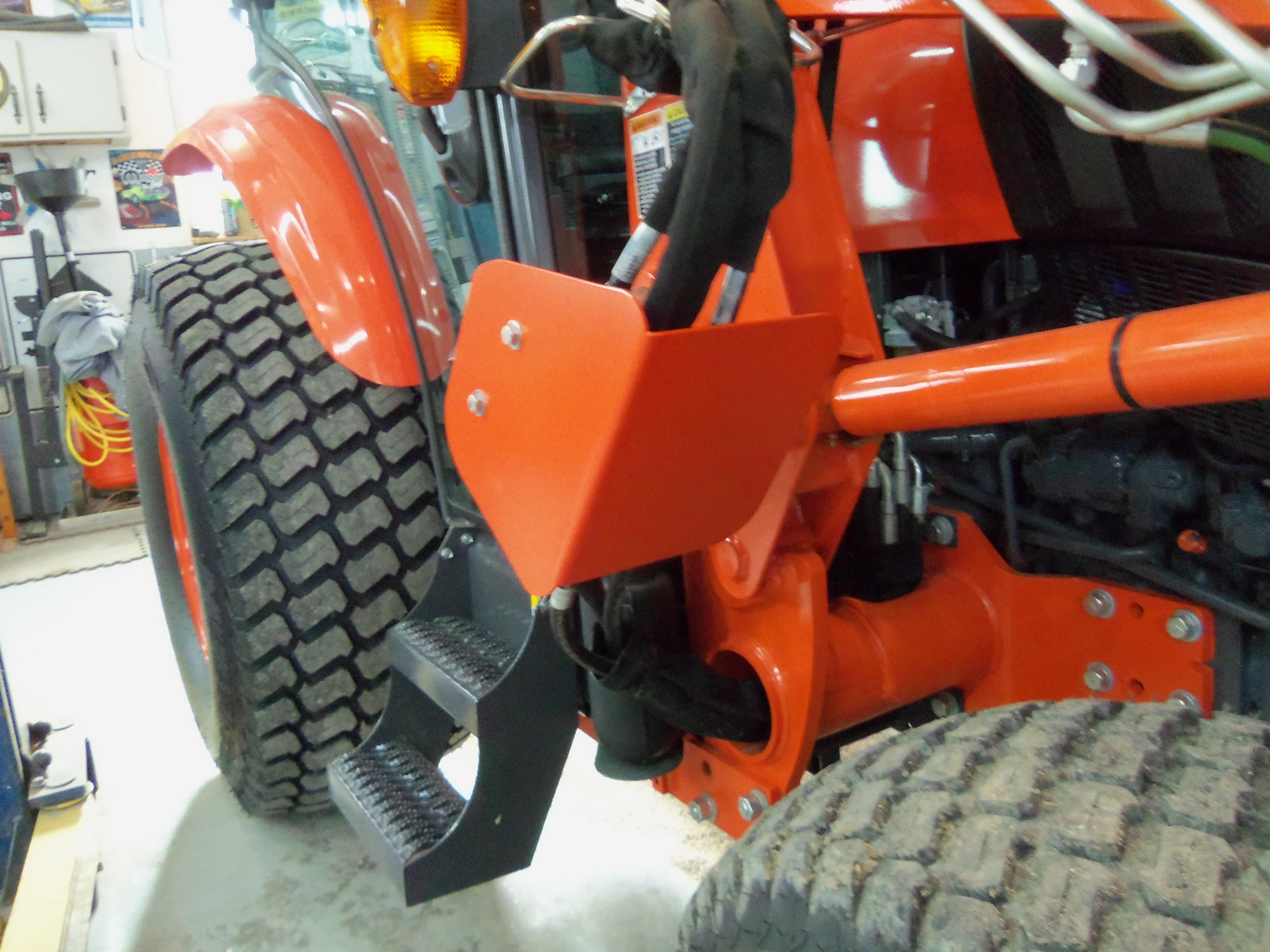

Is that a Paul Short step?
I have his single.

I did it my self saw that on a tractor on you tube it better then the one that comes whit the tractor .
