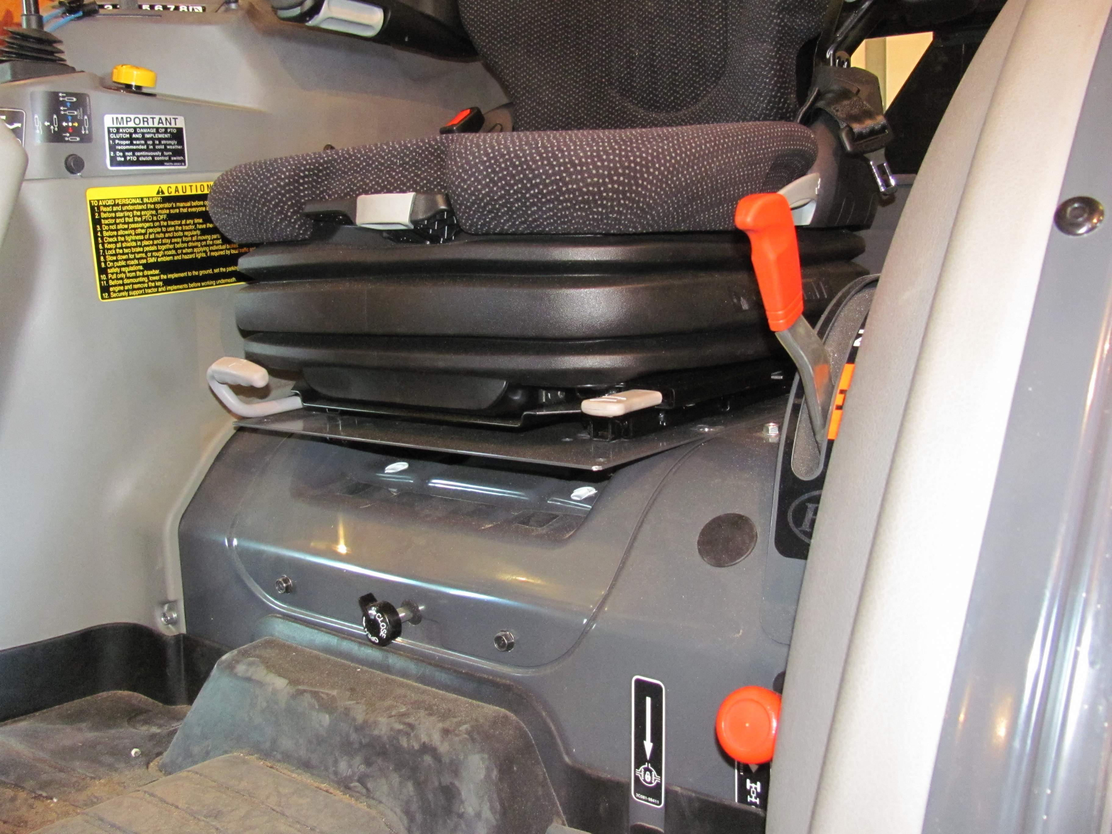

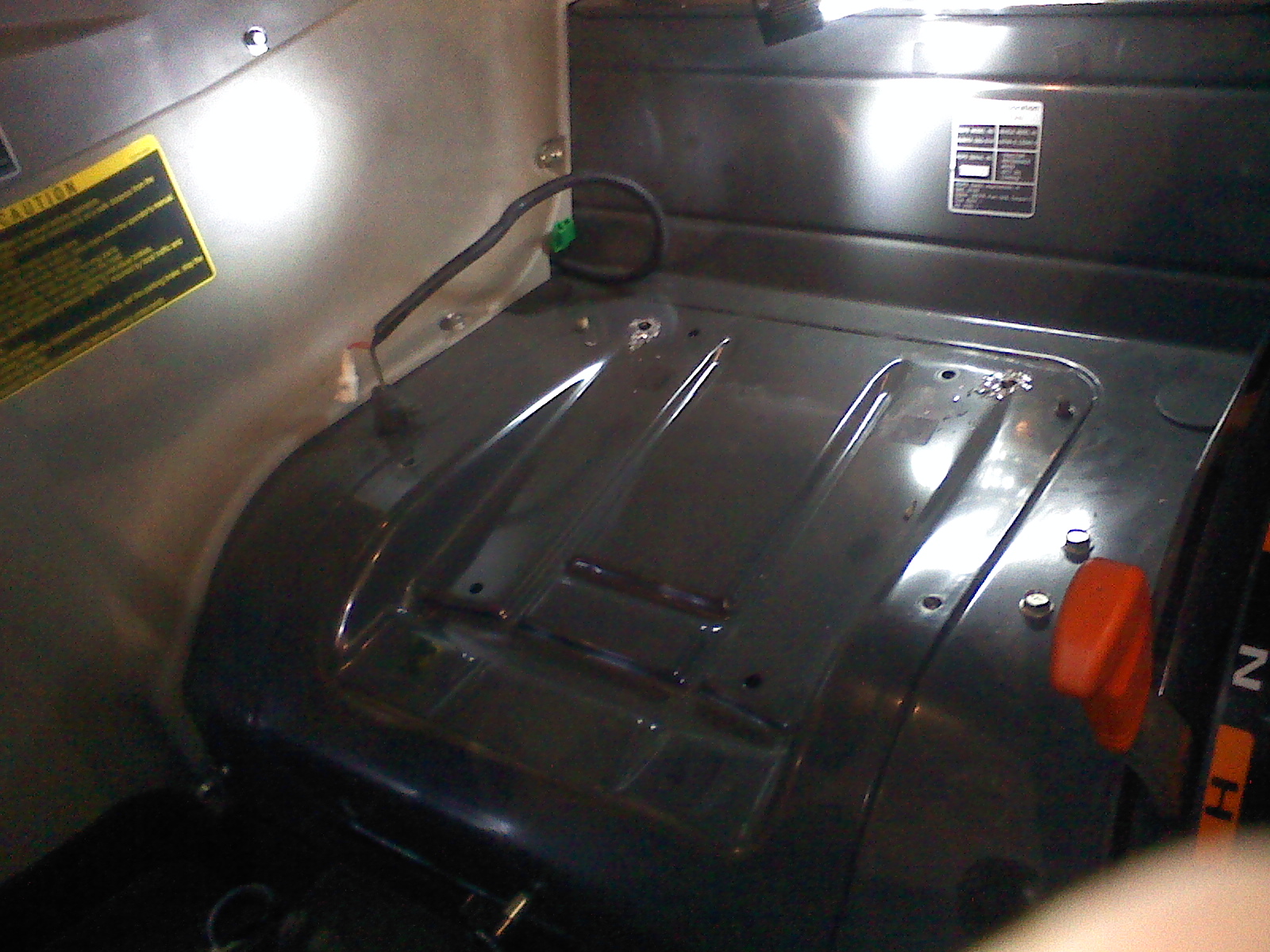

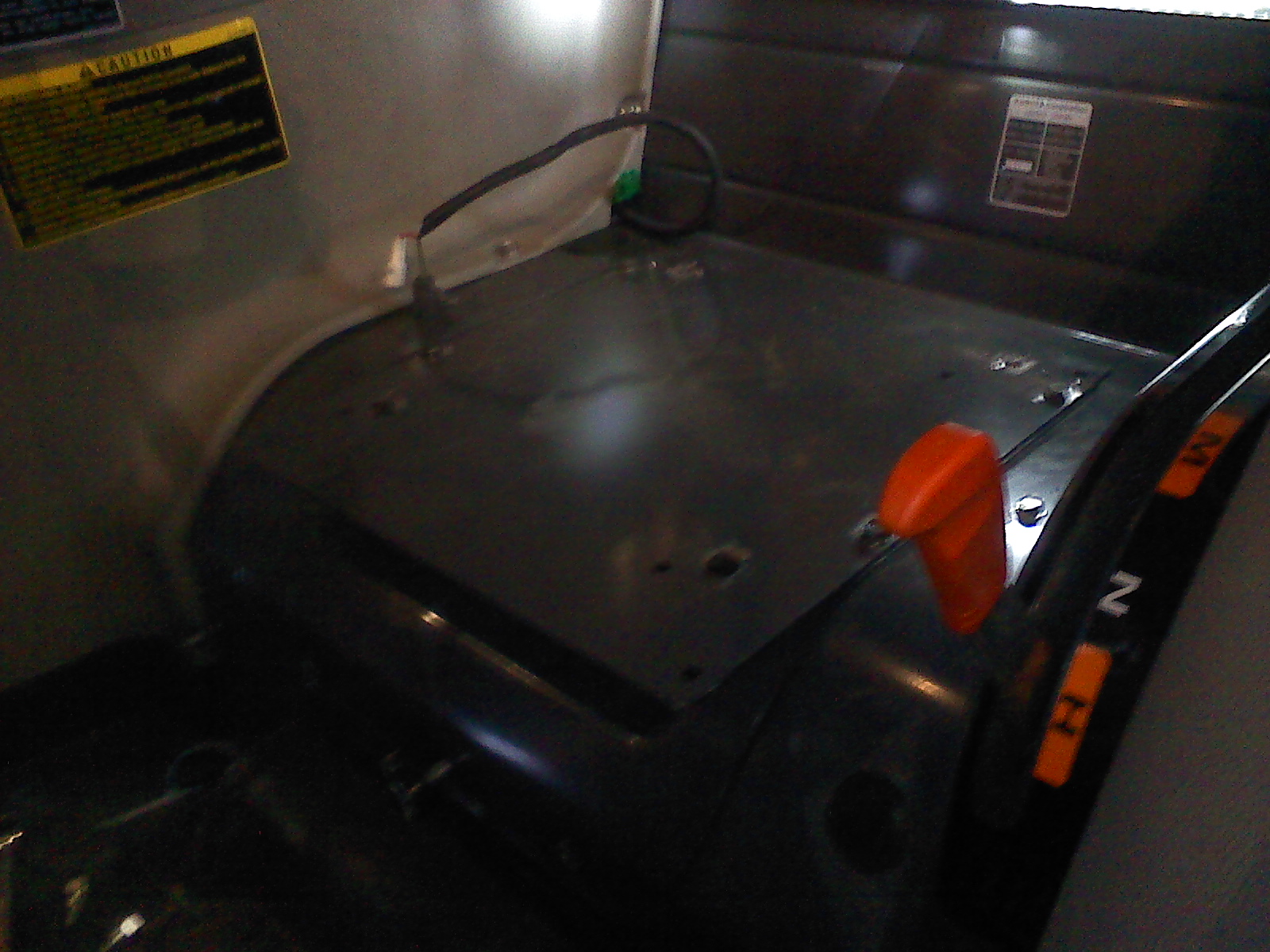

I’m squeezing the MSG93 series seat in now, had to custom drill 2 front mounting holes and weld mounting tabs for the rear base attachments, Its been a really tight fit and the seat arrived with no instructions or hardware. I’m checking with the supplier about this since an expensive seat option like this should at least have mounting instructions.

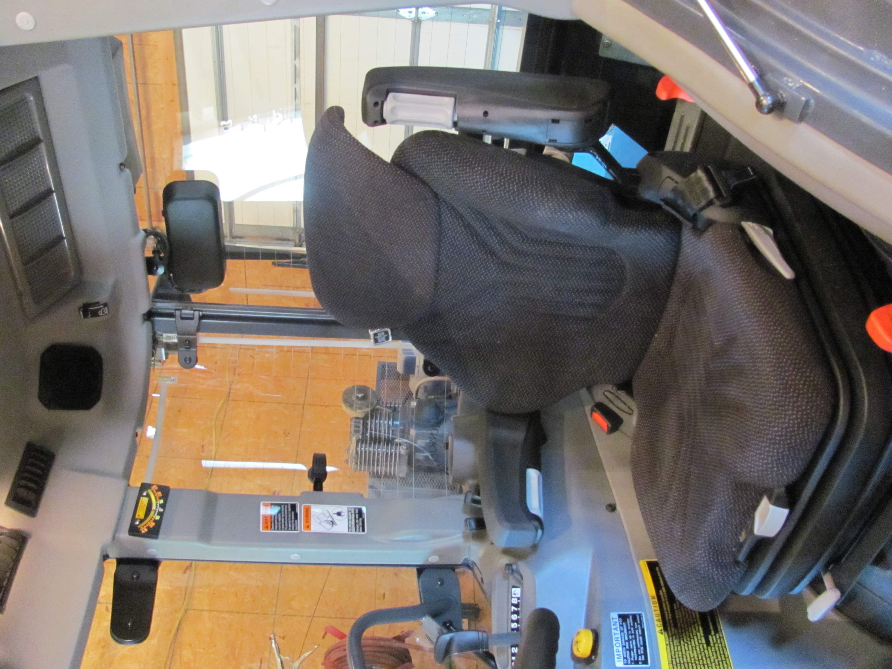

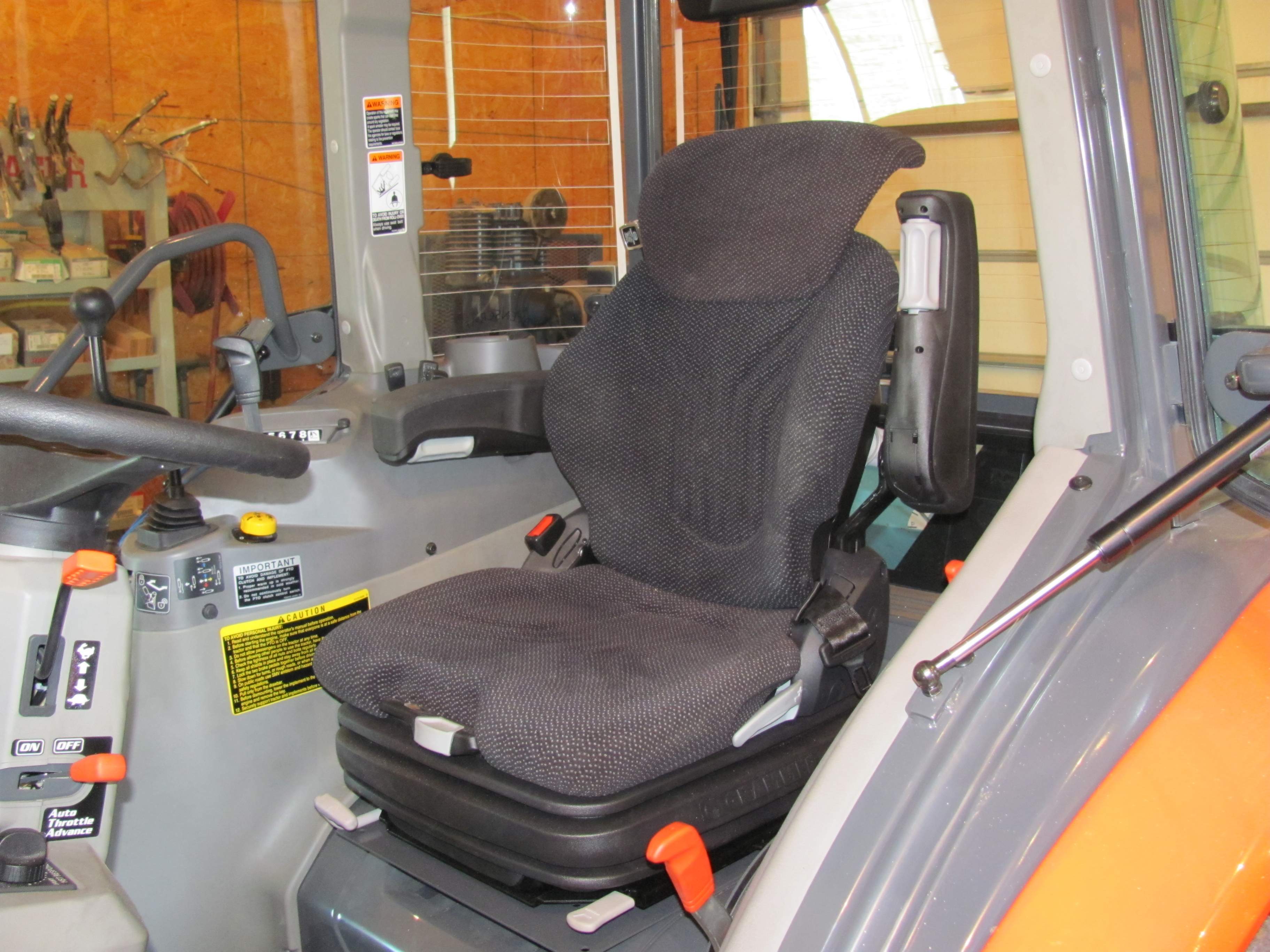

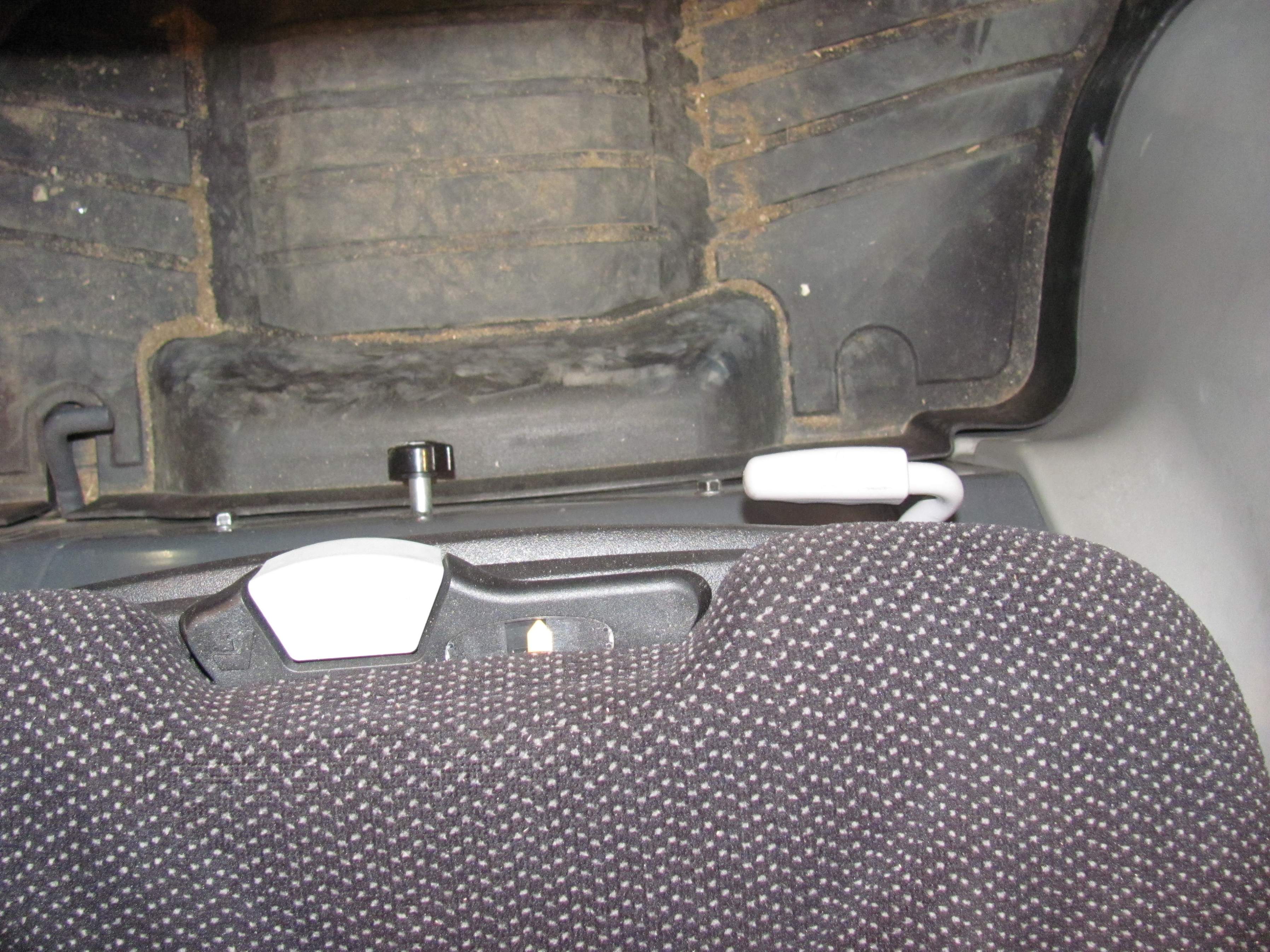

For those with the B3030, the MSG93 seat base was configured with mounting holes that only aligned with the front two holes already in seat floor of the tractor. There was absolutely no way to access the rear of the seat base for bolt installation. I was going to weld mounting tabs to catch the base’s exterior but found the underside of the tractor had foam glued onto the metal area directly under the seat..so..no welding and no fire. I used self tapping screws to mount the tabs to the floor.
The seat track was then mounted and found to still be too far forward when pushed all the way back (not enough leg room). The seat to sliding track interface had to be changed from the original bolt holes to position the seat assembly further to the rear on the slides. Guess what? No bolt holes in the slides so self tapping screws had to be used for the new holes.
The seat is not a simple bolt on for any of those who wish to install the MSG93. It takes patience and play (oh yeah, did I mention the self tapping screws - but drill a small pilot hole for these things to help get them started - and a nice impact drill).
The seat is more comfortable than the mechanical shock variety that I had installed 2 years ago. Vertical motion is well damped. Be aware the the lateral (side to side) bouncing is still quite prevalent with the air cushion providing little comfort.
I’m going to get the armrests ordered now that it appears there is room for these.
