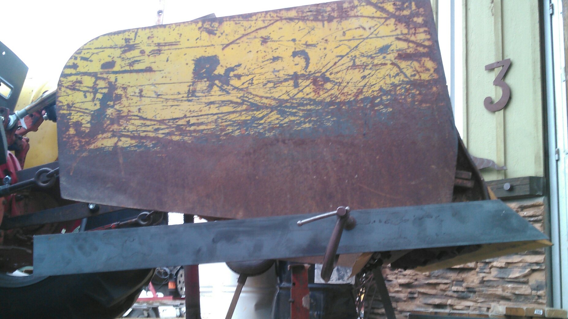

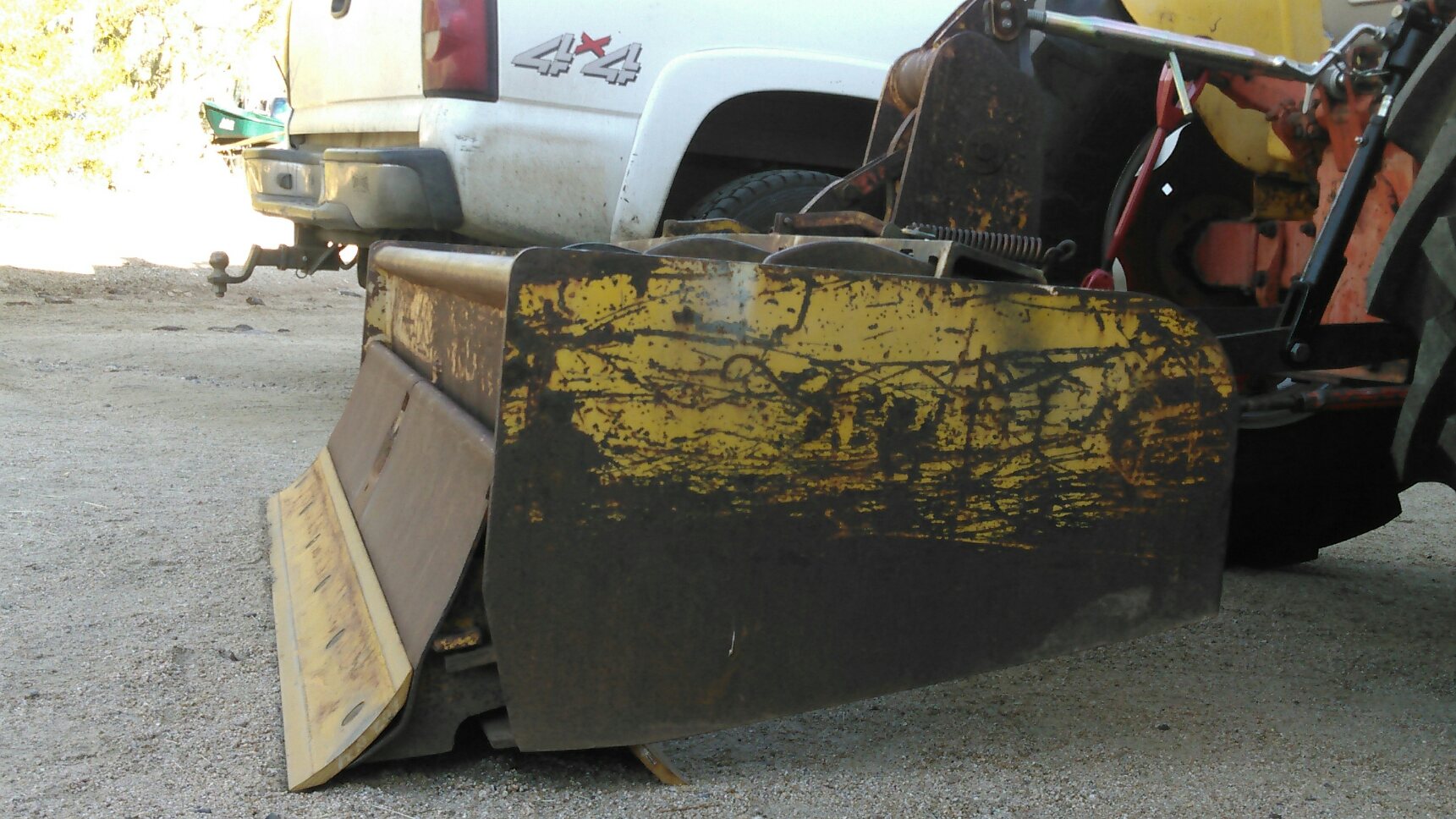

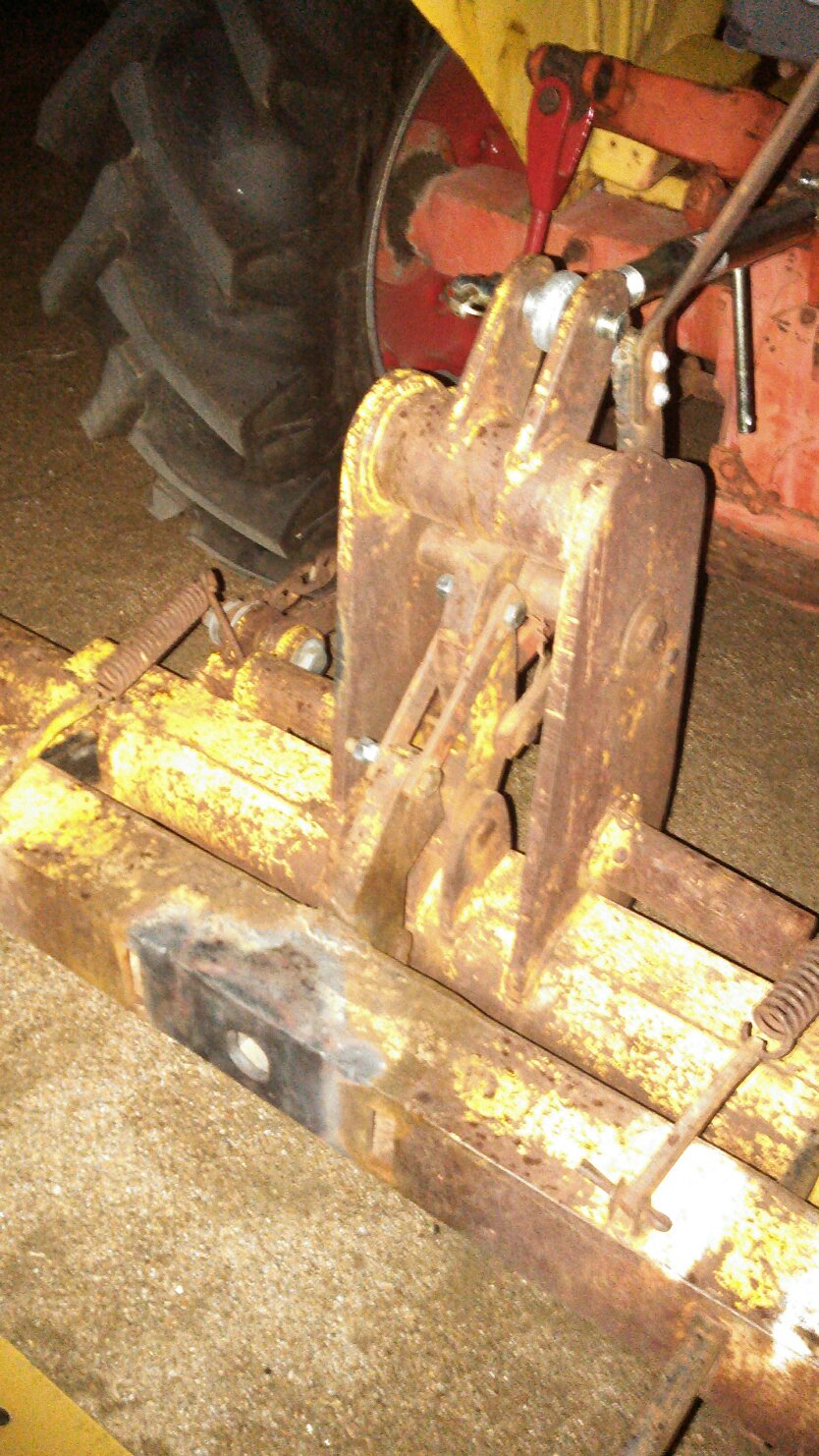

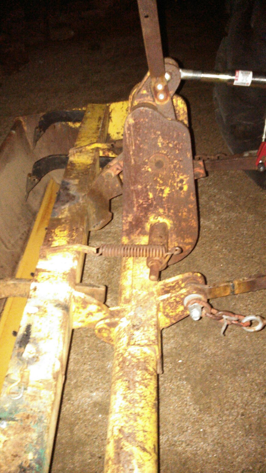

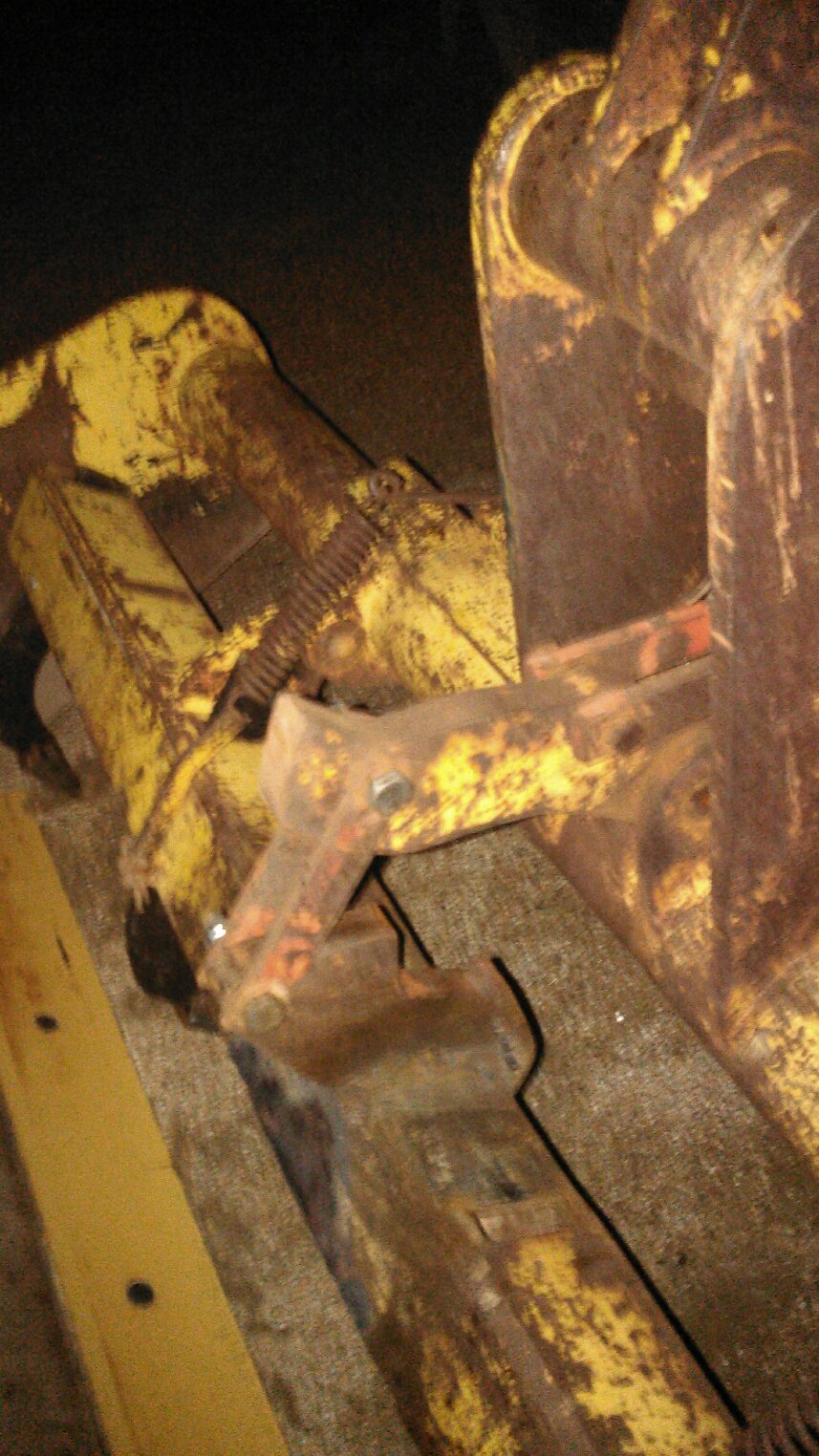

This is the box blade I have. There is a name on the side, just not enough for me to make out. The linkage is not like the other Gannon blades I have seen. I have been trying to determine how much of the sides are missing, so I clamped a straight edge along the top bevel of the brand new 6" blades. There is at least an inch and a half missing from the bottom at the blade mount, as it is worn down to the bolt holes. I have considered cutting out the angled blade mount for rework, as it would make welding and punching new holes easier.

Well hopefully it turns out to be a labor of love as bringing a old worn machine back to life can be really rewarding, and expensive.

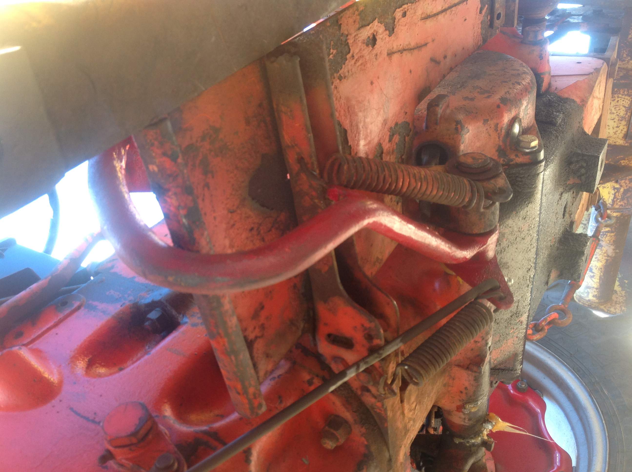

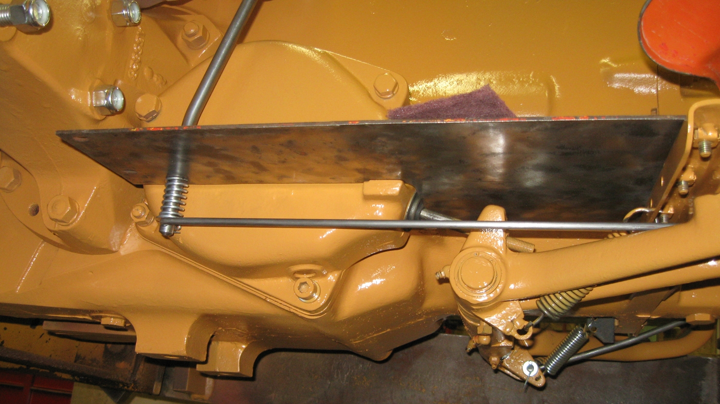

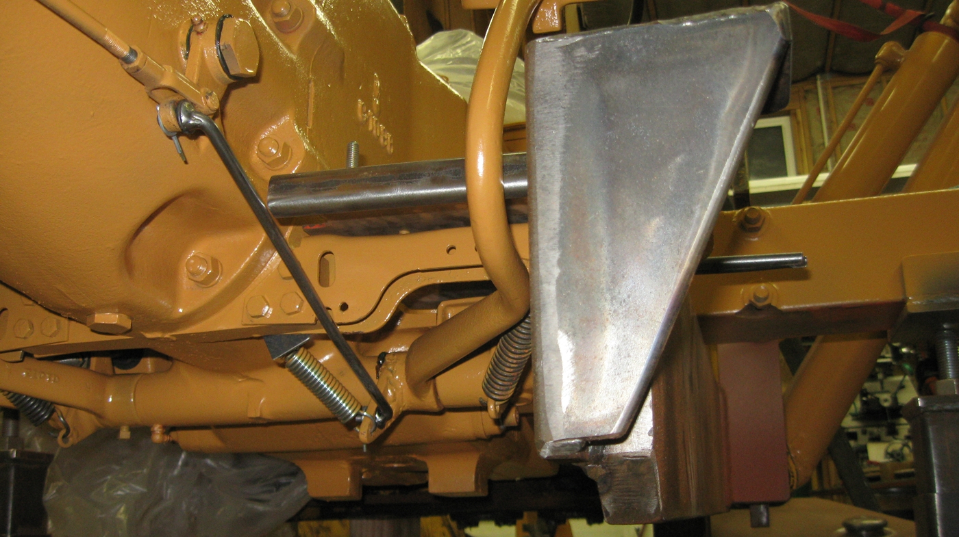

Here are a couple of pictures of my brake and clutch sides of my machine:
Brake side with the new emergency brake handle and rod that I fabricated.
Clutch side and new rod and springs.
I looked at your picture and really appreciate what you're going through. Cheers!

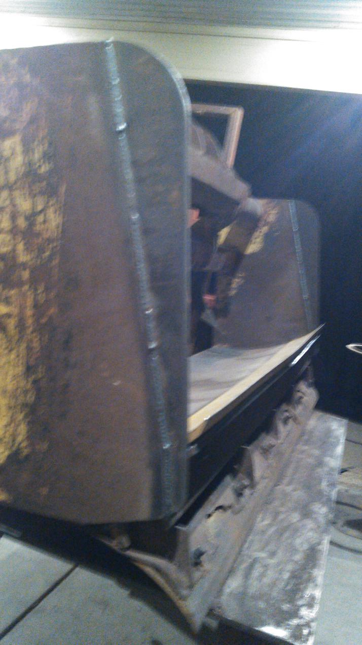

Today I got my box scraper repairs done. I drew up some side plate patches and cut them out today, then welded them on. Then I drew up a 72" x 1 1/2" rectangle with 3/4" half circles along one edge. Then I welded it to the bottom of the blade mount to replace the worn away section.
I'll try to get some better pictures tomorrow after I take it off the table and put it back on the tractor.
