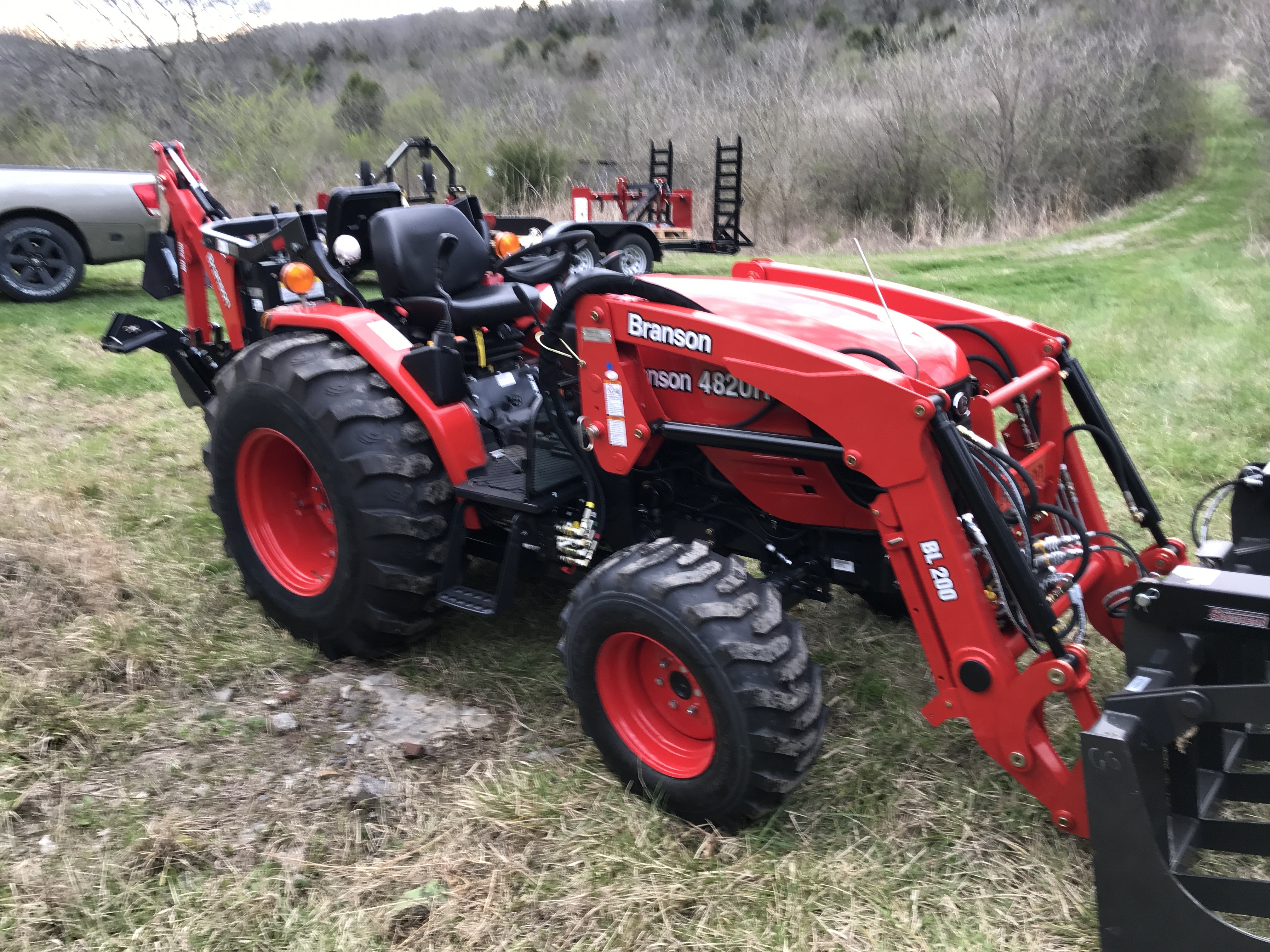

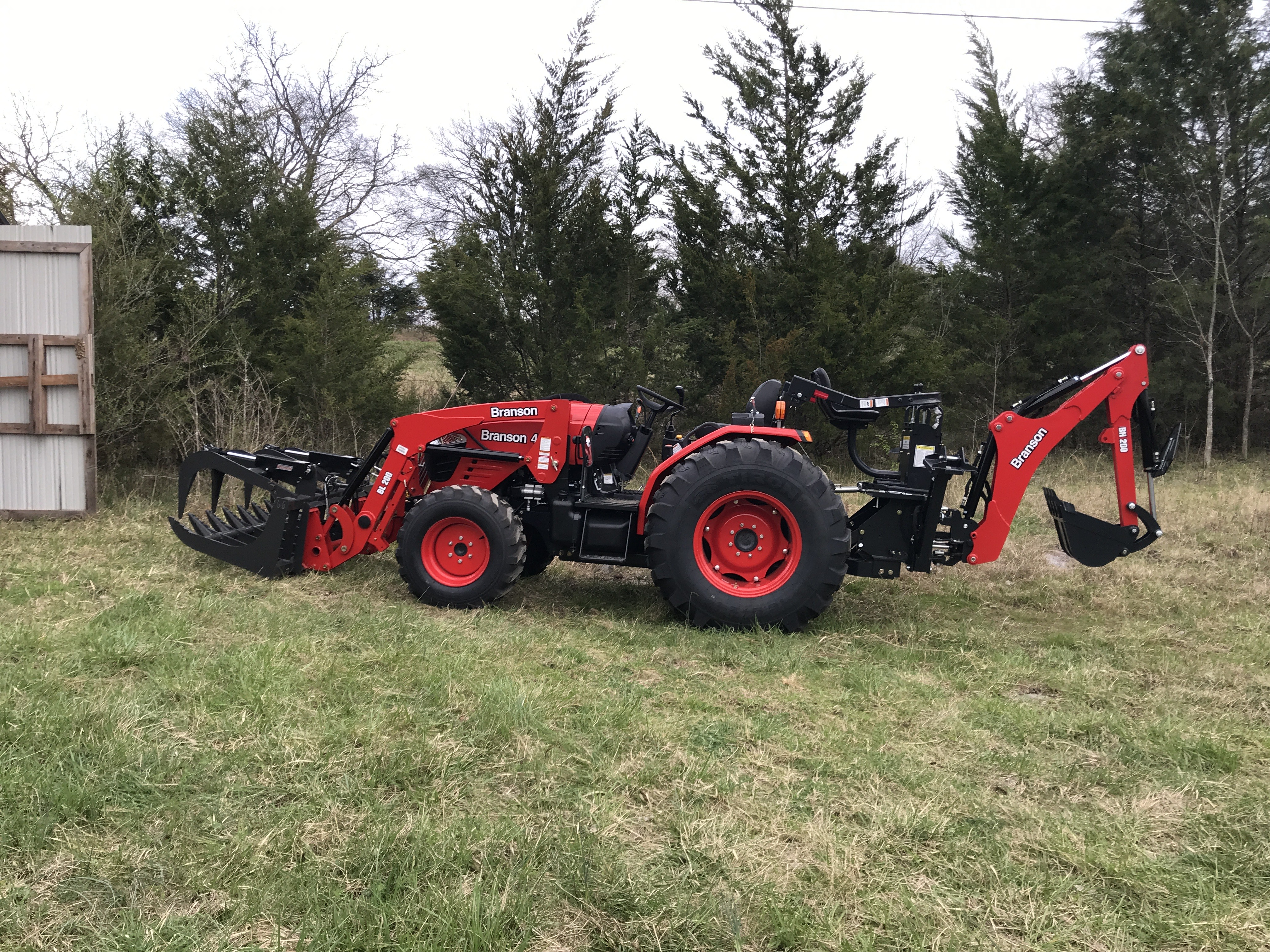

Yesterday, I got my new Branson. It's a 4820R with a BL200 loader and BH200 backhoe. I chose it based on the specifications, price and intangibles, like my impression of the quality and dealer.

Congratulations! Just look the part of a teen boy who has to mow the lawn when you walk out of the door past your wife to do “chores”.
And mind the roll over bar, keep it upright when working!
/ My new Branson
The ROPs was down because my shed door is only 7'. I'll ALWAYS operate with the ROPS in place. My shed is just in front of the tractor.
Thanks for the reminder!
