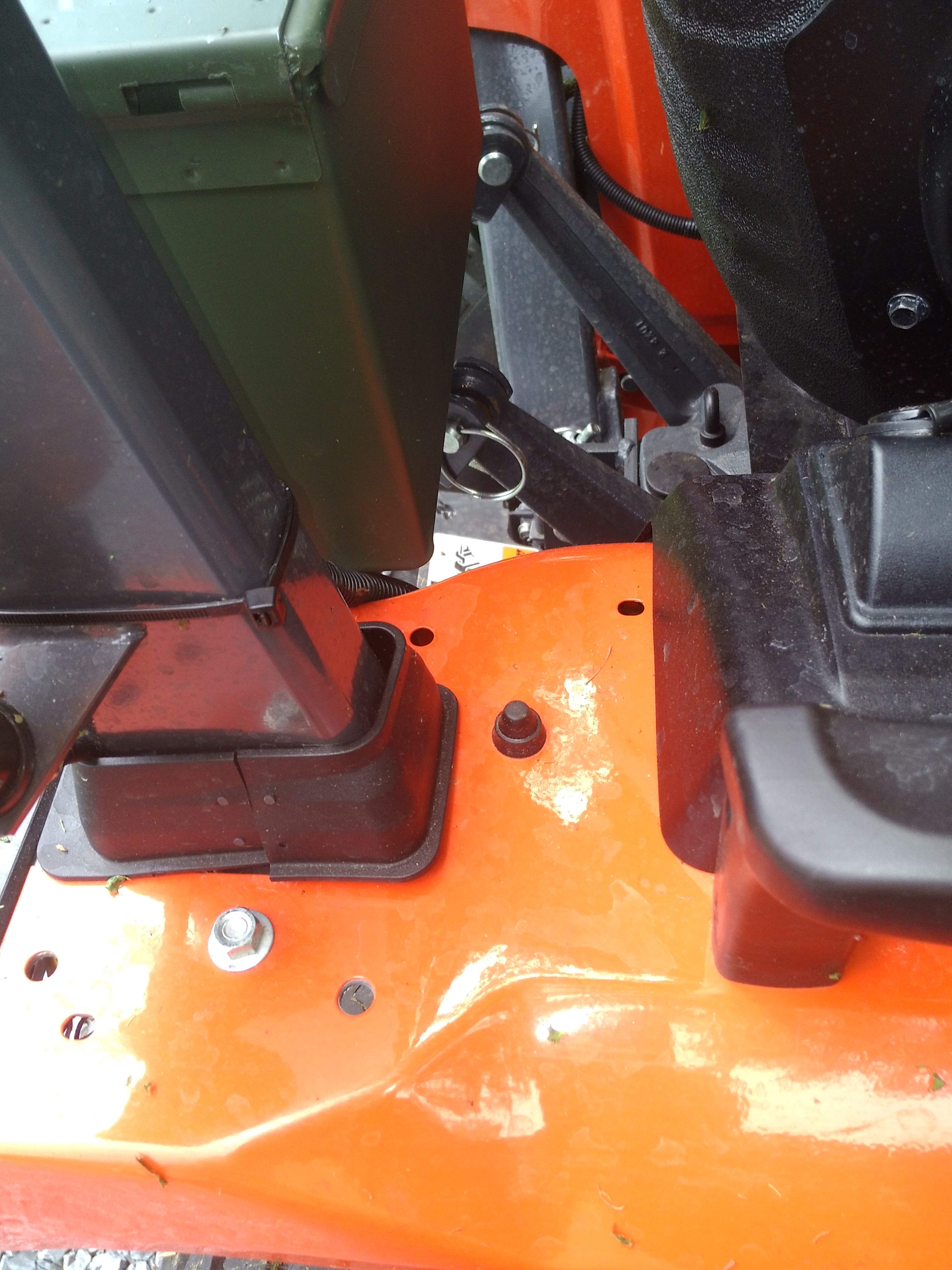

I installed LED lights and a waterproof switch. You will find a pair of connectors under the right rear fender. Can't miss them.

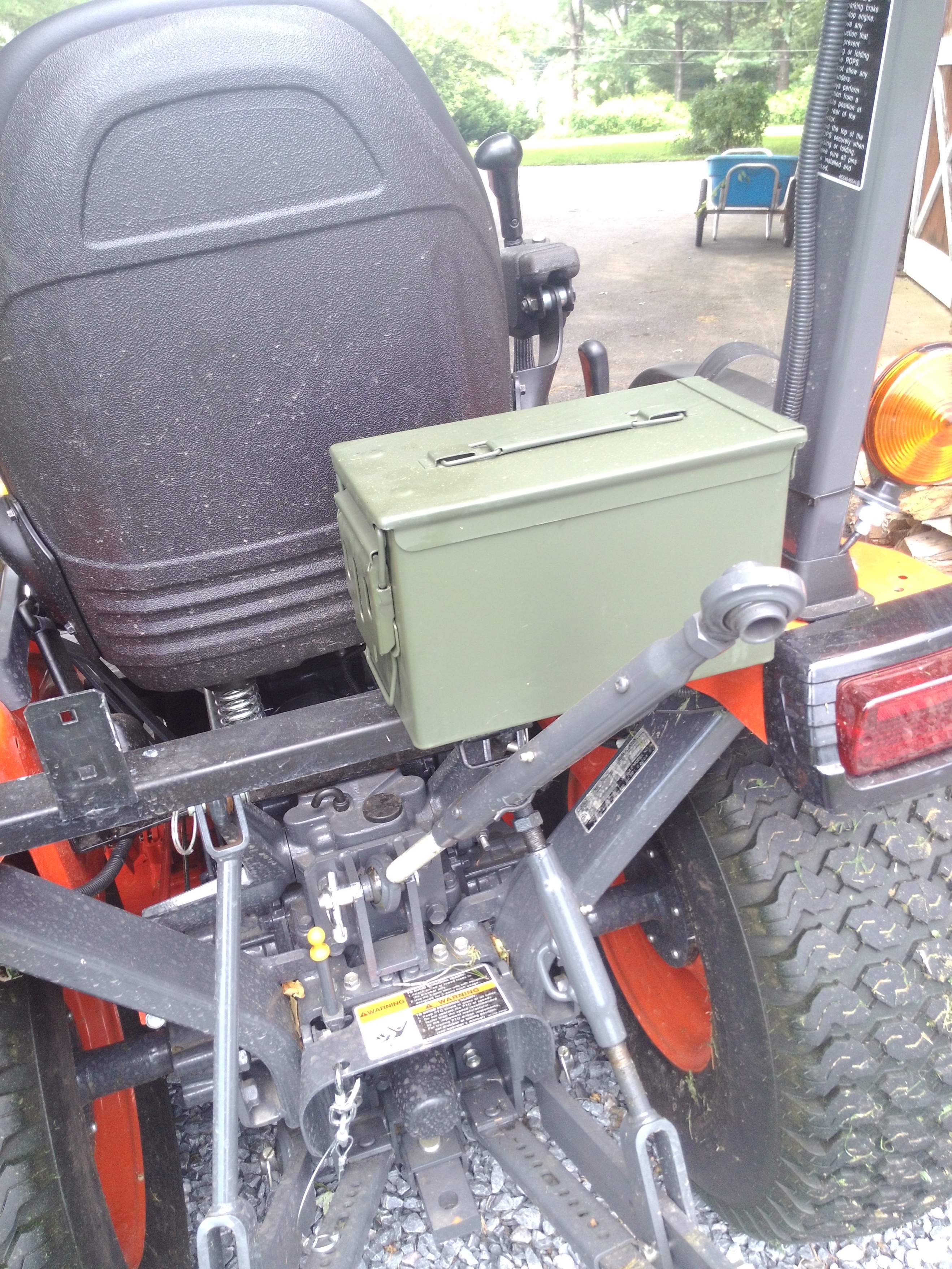

The Tool Box that came with the tractor was too small for my need so I bought this waterproof 50 Cal ammo box off Amazon for about $30. I drilled holes in the bottom and used the mounting system Kubota provided.

I found this arrangement for the stabilizers more convenient and way faster, simple 5 minute job once I got the parts at my local Ace hardware.

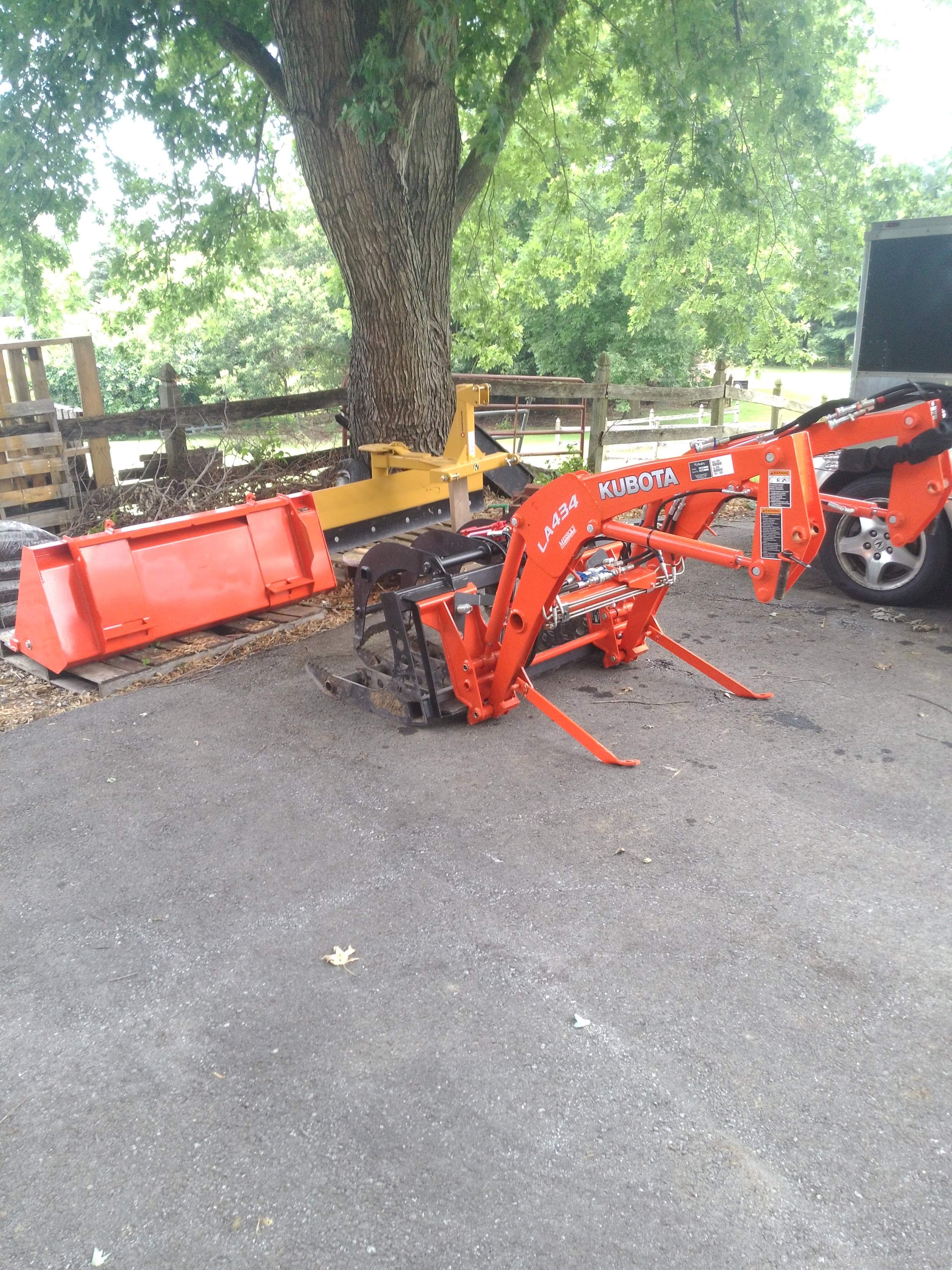

I really love the machine but have one serious gripe with Kubota re: the on and off of the FEL arms. It seems to me that the tractor has to be PERFECTLY level to have a chance of a good marriage of parts and even then good luck. I hate the design of the FEL stand. You'd think they could add more surface area to the legs so you could remove the FEL on grass or dirt. It is a friggin tractor. I really liked the Deere set up much better but in spite of this issue preferred the Kubota. I do remove the FEL regularly, maybe I'm doing something wrong and one of you pros can help me out here.

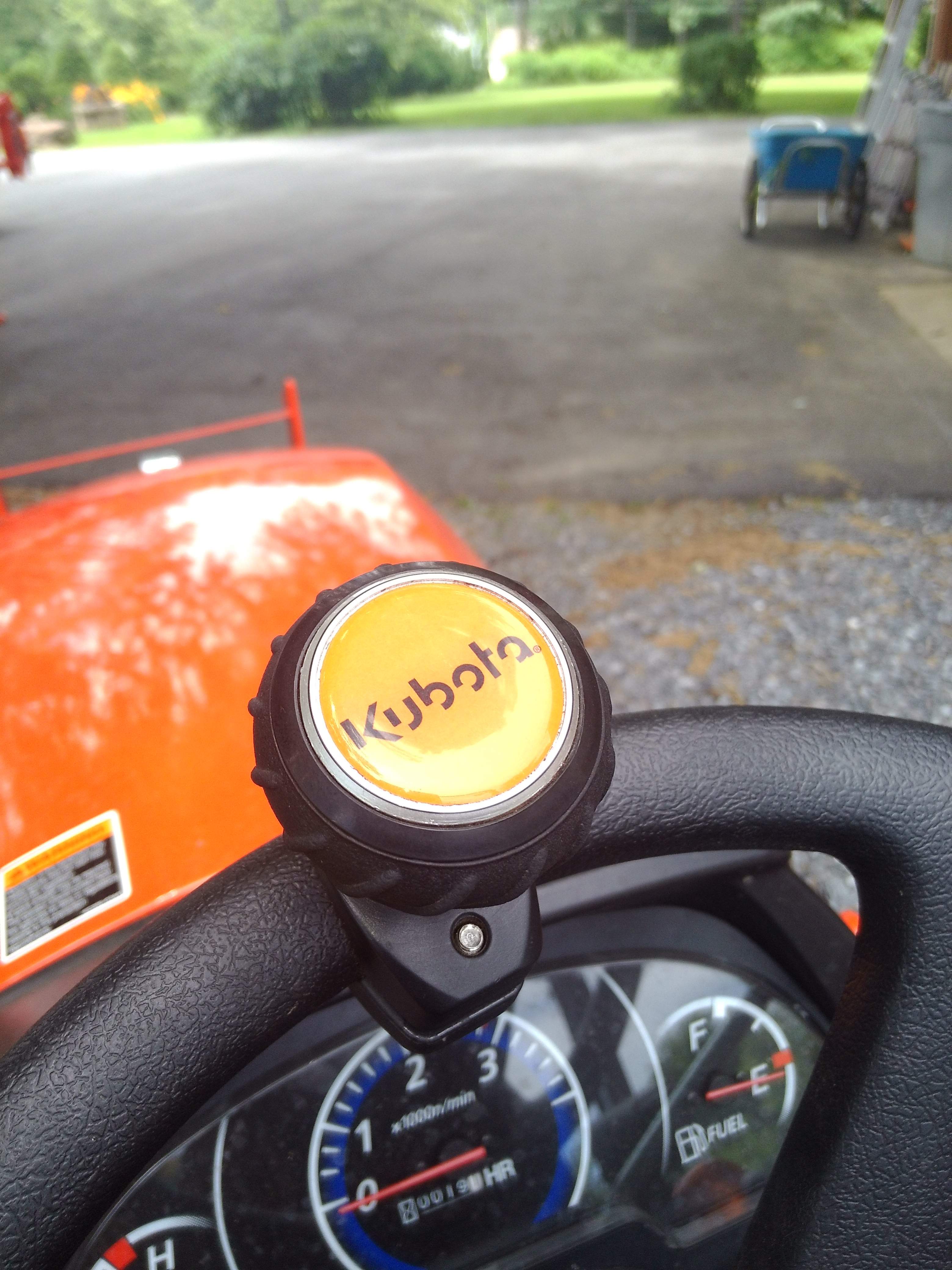

Almost forgot this is a great add-on.

Is the loader remove really any different from that of the BX? I've seen this video, and it looks like he had some problems getting the loader off on the grass. I've only taken mine GC2400 loader off on a concrete floor, either in the shed or garage, but I can certainly understand how it would get hung up a bit.

We have two BXs, a GL and M, all the loaders are easy on/off after the first time or two as there may be some paint interference. I've taken mine off on concrete, rock and dirt. If the dirt is soft, I put a board under the feet. No doubt concrete is preferable, but it's not always available.

It's a little different than the BX but similar. The legs come down individually. I haven't taken off the deck but I know it will be easy enough. It is a drive over but I intend to raise the front with my Rhino ramps for removal and installation, should be a cinch and much easier than the BX which really wasn't bad. Can't answer the last ? and not sure if I really understand it. If you're asking what the cutting height is in the Top position, I'd have to go out and measure. My guess is 5 -6 inches.

I just got off the phone with Neil Messick about my next parts purchase and I mentioned to him the issue and he made the same comment about the paint but I think it's unfortunate that such a first class product like Kubota can't get it right. This should be a seamless, bulletproof process and it's just not. I have lot's of friends that just say "I never remove the FEL" . That's not an option for me.
