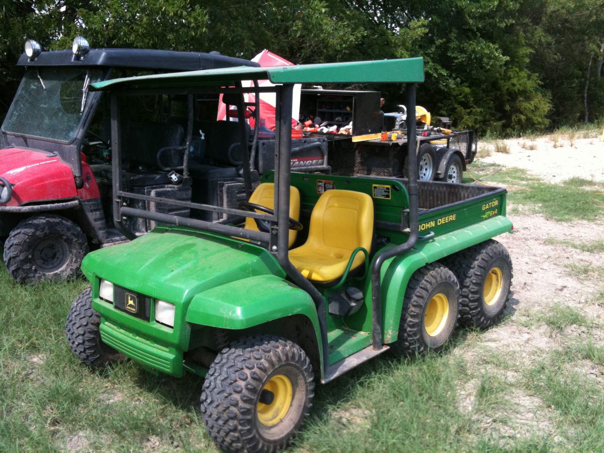

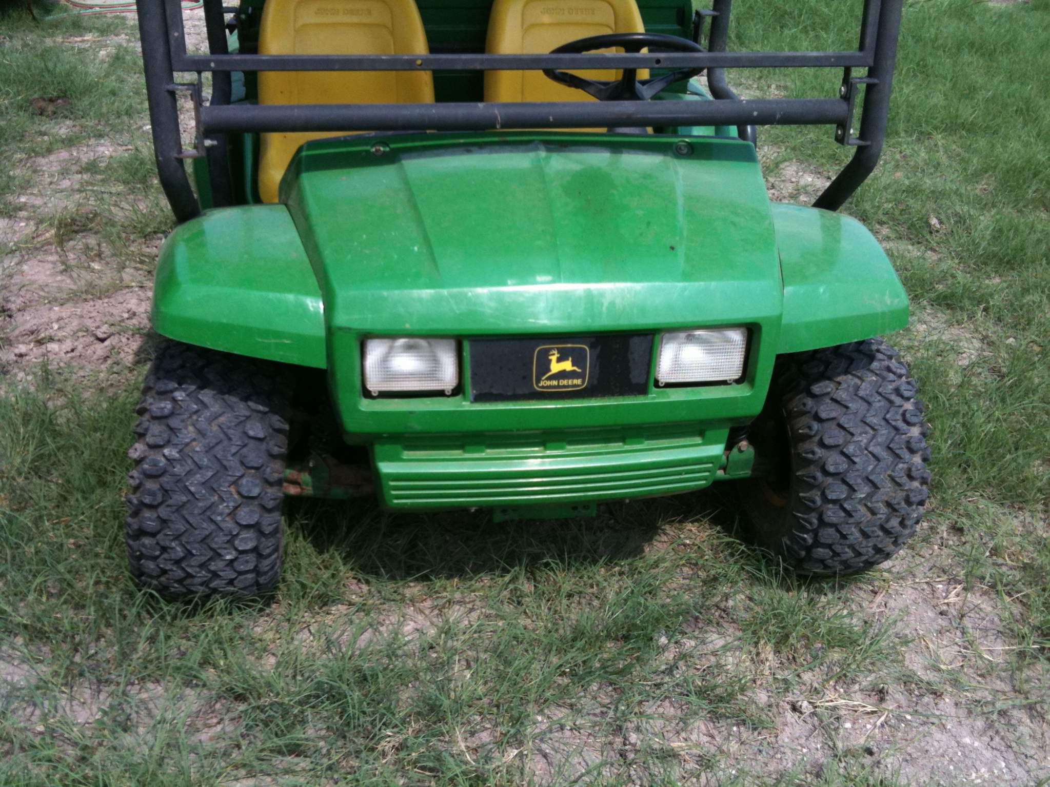

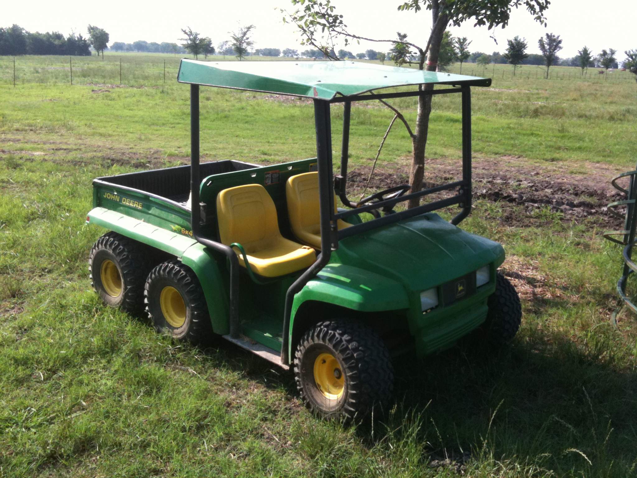

I picked up a used 6x4 Gator. It needs some work, but oh well. I have ordered the manuals on it. It will come in handy.
D.

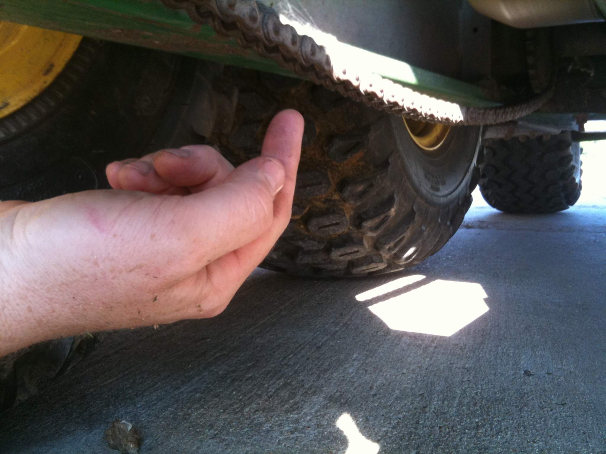

Yeah - they do ride rough and it feels like a low rider. I see they used to offer chain guards (skid plates). I think I will be fabricating my own - looks like JD does not offer them any longer.
I bought this thing right, but it is going to take $500 - $1000 in parts to make it right.

That is a "beefy" looking frame on that roll cage!

Did you have chain guards on yours?

Never tore into the brakes. The JD friction modifier was in a small pint bottle at the parts dept. Just add it to the trans fluid. Did not have chain guards.
