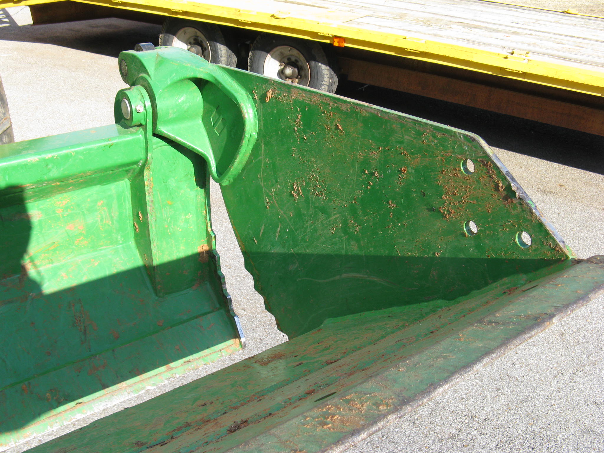

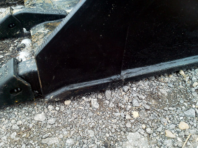

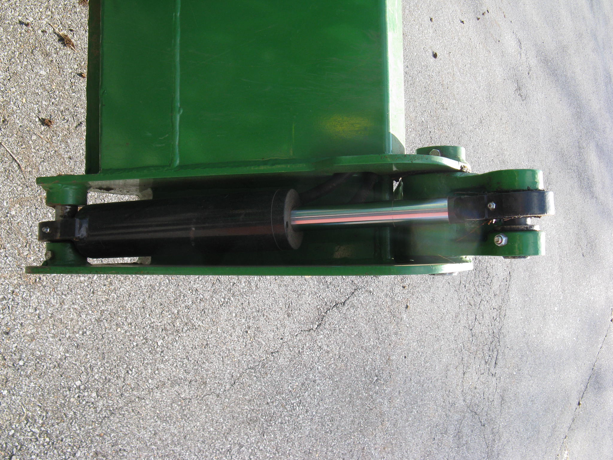

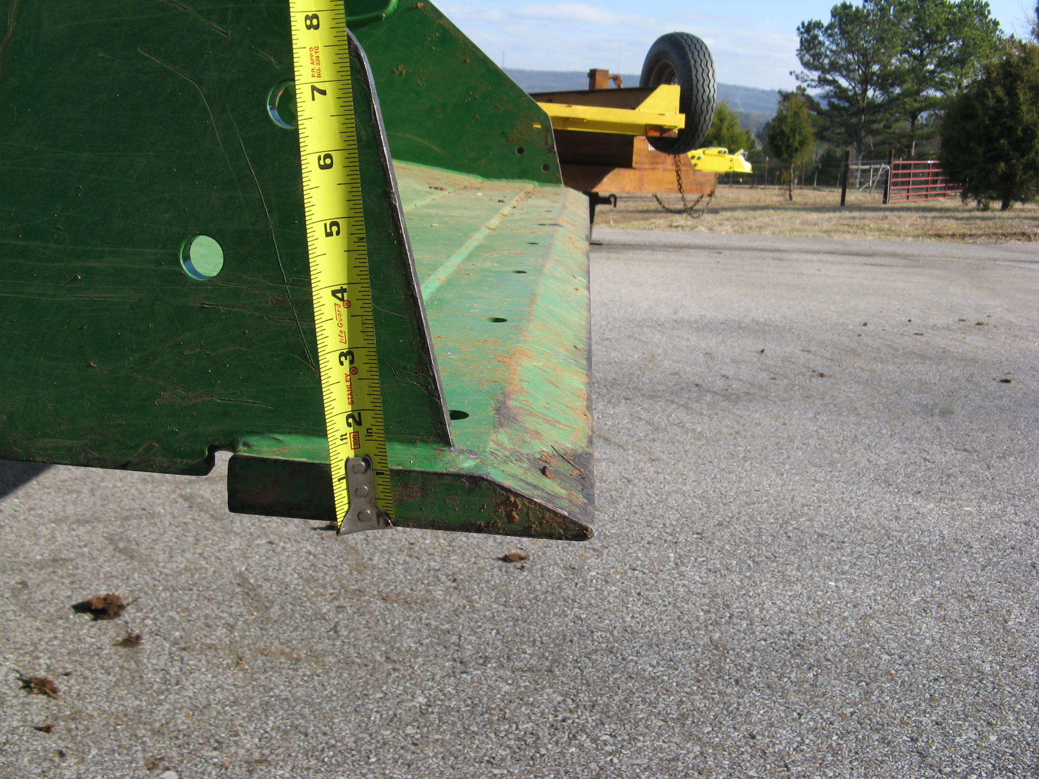

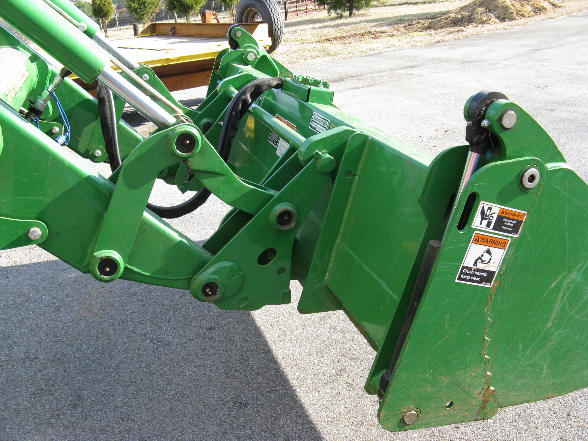

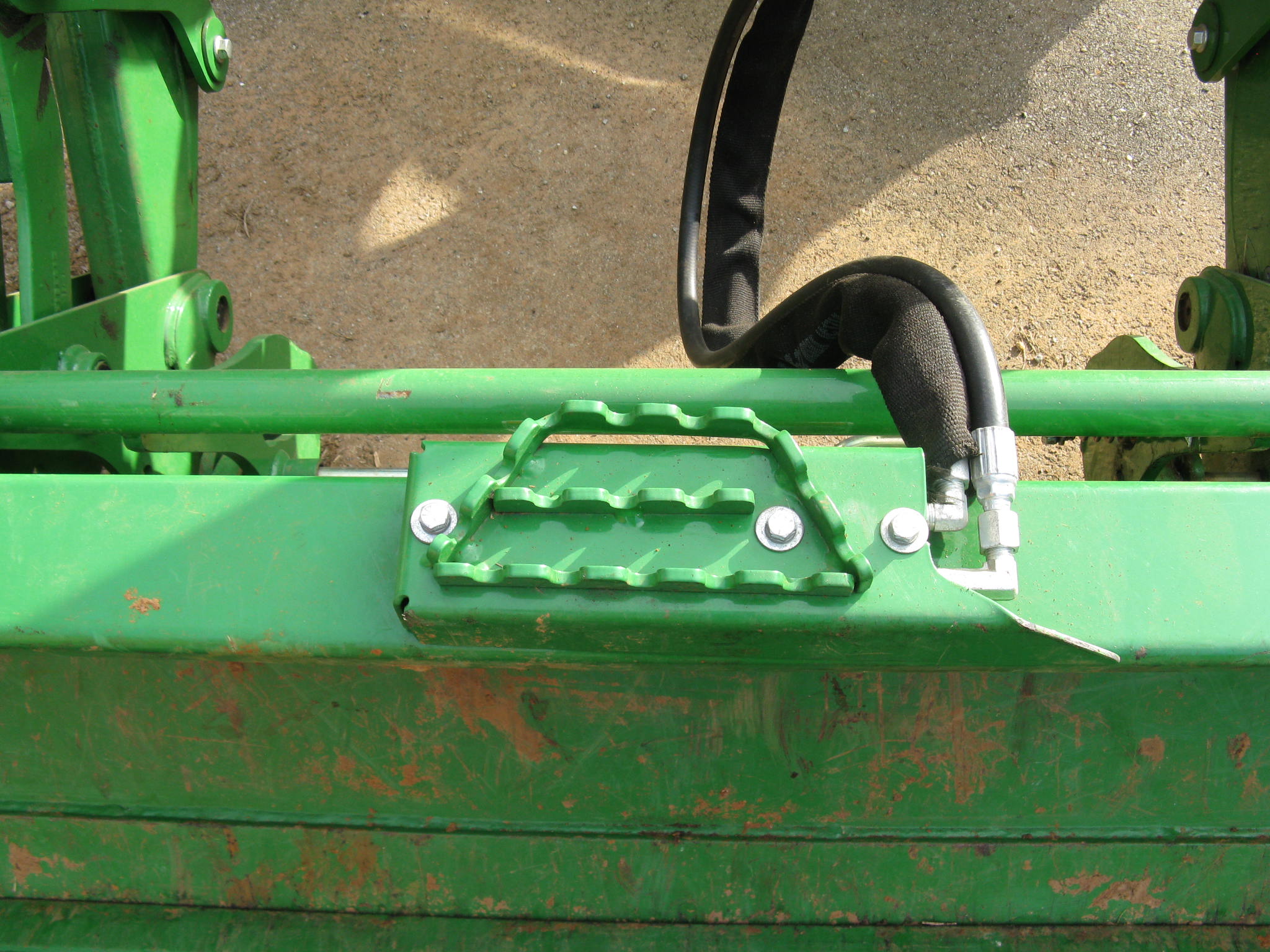

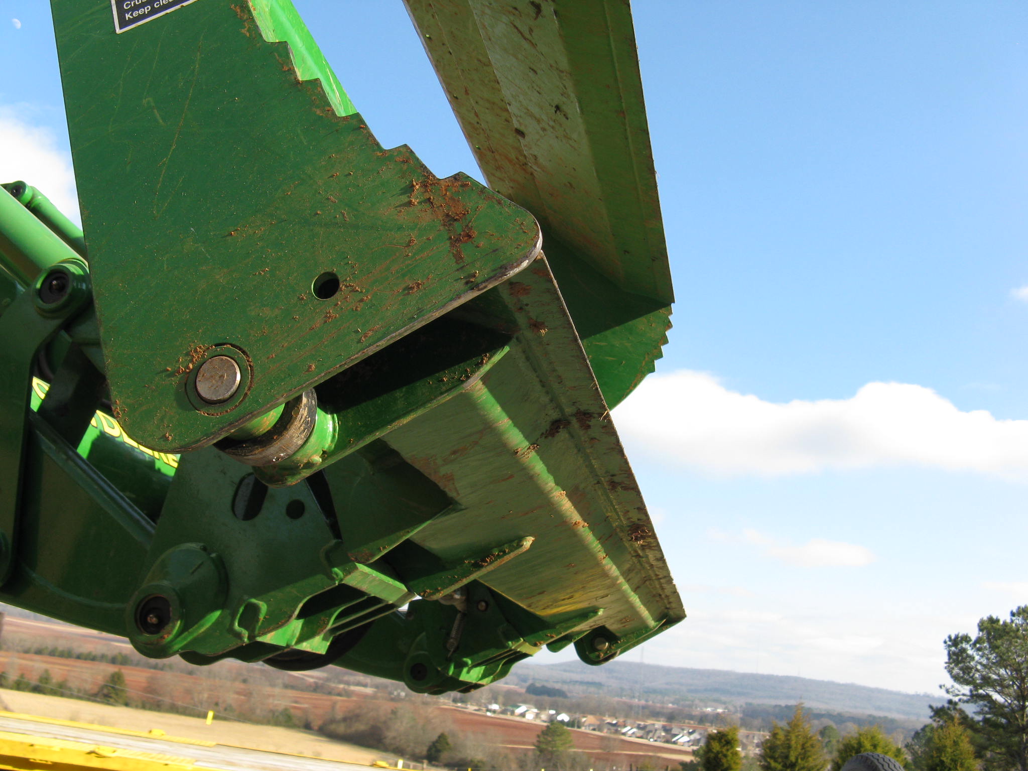

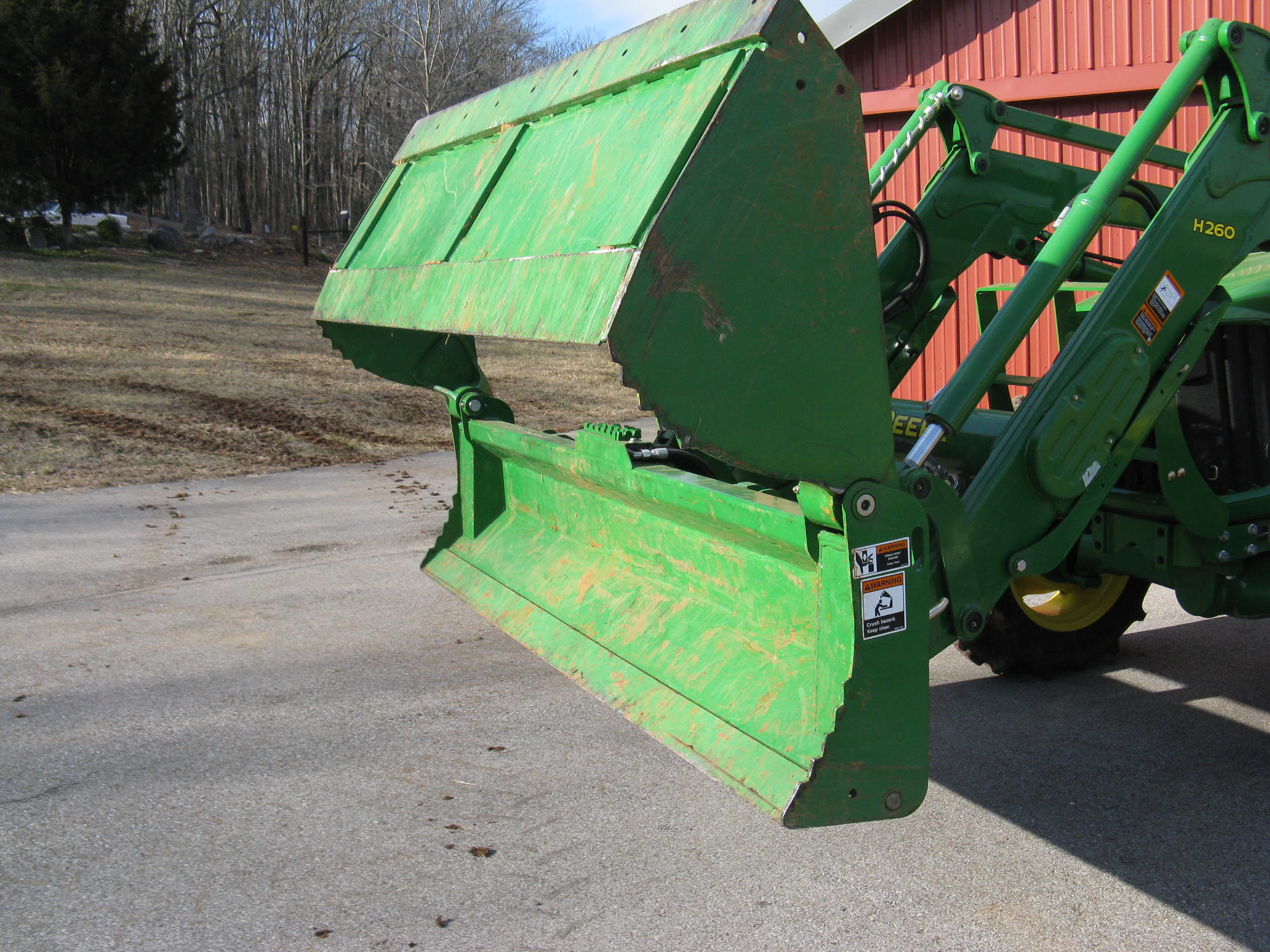

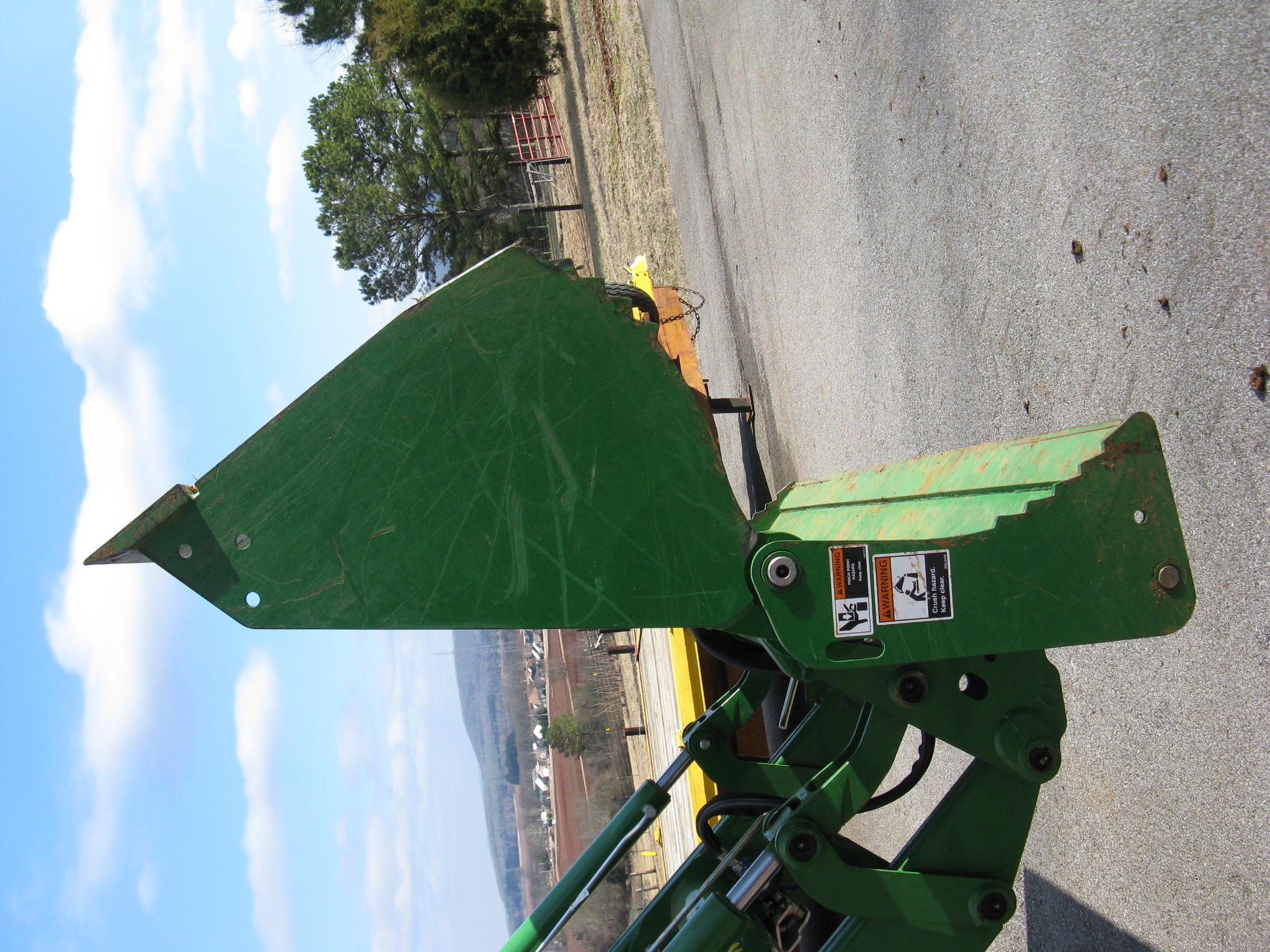

I've gathered about 50 pictures of buckets. There are several ways to go about this. I look at it as a challenge. I'll give it a try someday. Thanks for sharing your pictures, they are in my file for sure. I really like the way yours is built. Only thing I couldn't determine from the pics is how the bucket apron is built, as in what thickness, is it doubled somewhere to add strength, etc. I can see how it's built at the teeth, was more concerned about the back end where it meets the blade.
Here you go. 1/4" thick on the bucket. The back of the bucket is wrapped over the top full length and welded to the back face 2"x4" tubing top and bottom. The quick attach plates are welded to these too. There are 1/2" plates on the side edges of the bucket and 1/2" material is also used to protect the cylinders. The side plates of the jaw section are all 1/2" as are the hinges, braces and wear strips on the bottom of the bucket. As you can see in the photo, the wear strips extend out past the sides of the bucket and are welded to the side plates and 1/2" x 6" cutting edge. The dozer cutting edge is 3/4" x 6" and the clamshell cutting edge 3/4" x 4". The inside floor extends 20" forward from the forward edge of the clamshell cutting edge. The 3/4" x 6" front cutting edge extends 4" forward from the floor.

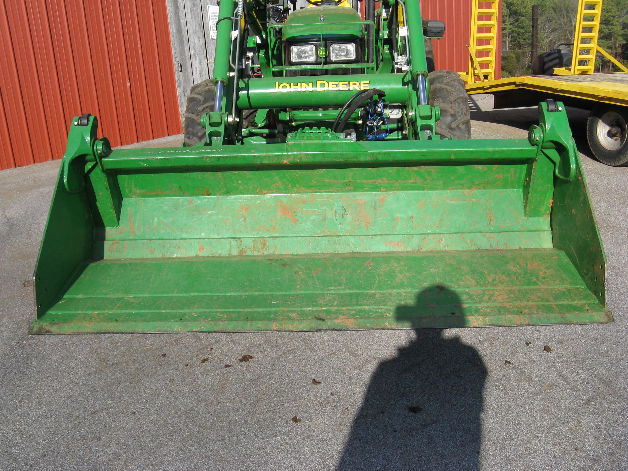

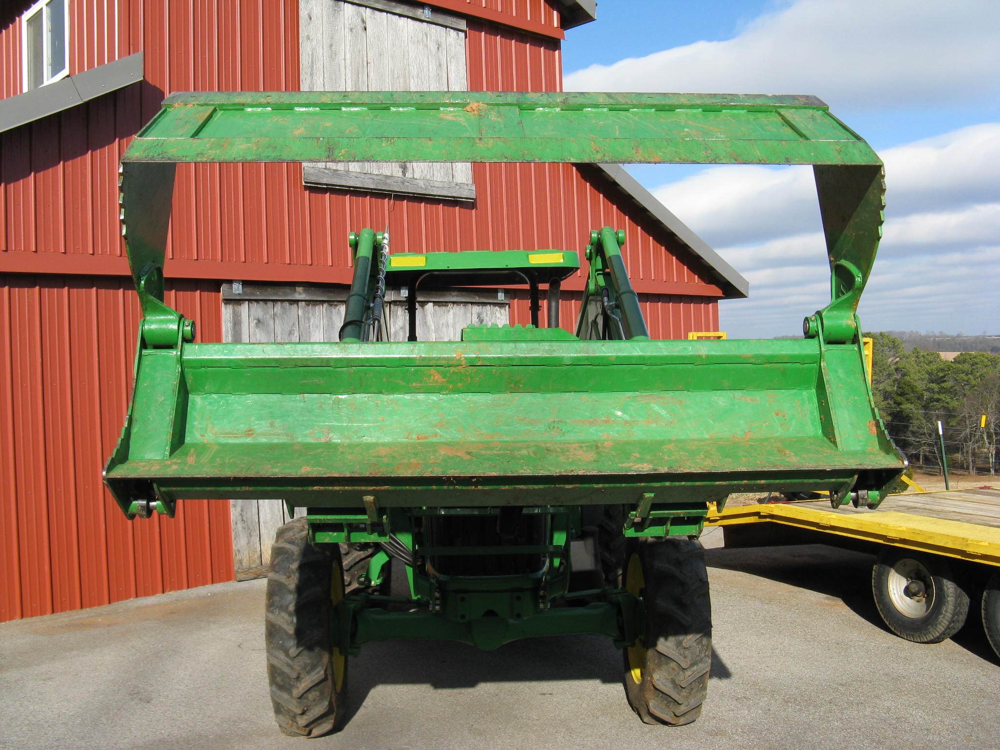

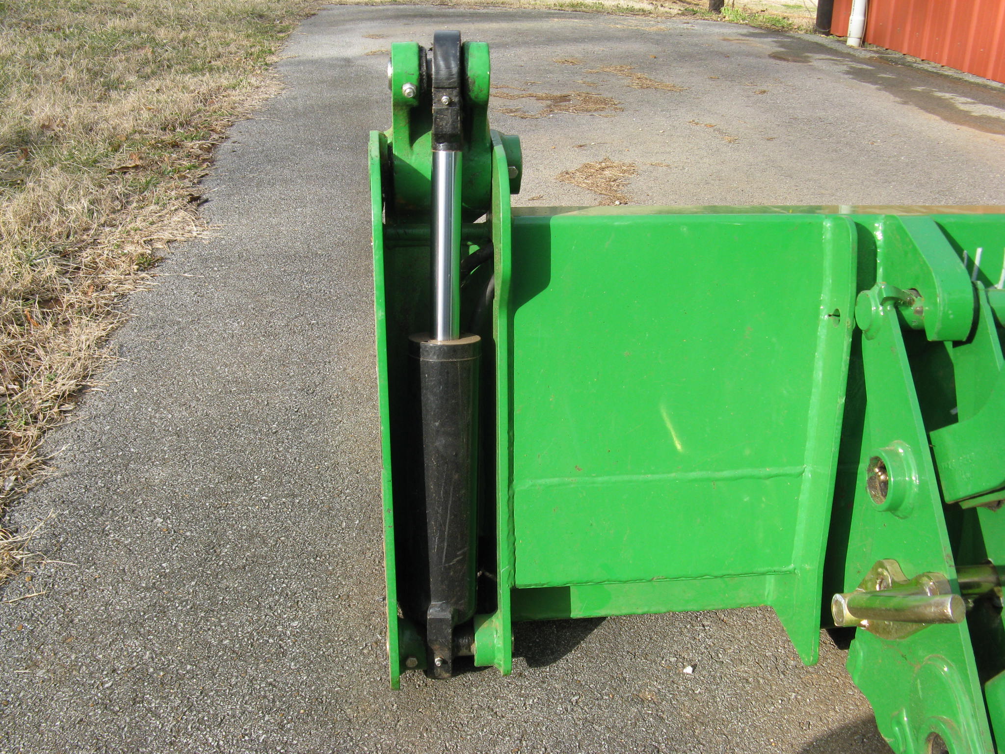

Any other pictures you might have of your bucket I would appreciate. Thanks!!!
Here are a few of the Frontier AY12G. It has a double bottom with a arch to strengthen it and to force breakup of pack clay or dirt as it crossed it so it doesn't stick like a smooth flat bottom creating resistance. Also has a 1" blade front and rear of the clam. 4-in-1 016.jpg4-in-1 018.jpg4-in-1 001.jpg4-in-1 004.jpg4-in-1 005.jpg4-in-1 006.jpg4-in-1 007.jpg4-in-1 008.jpg4-in-1 009.jpg4-in-1 010.jpg4-in-1 011.jpg4-in-1 012.jpg4-in-1 013.jpg4-in-1 014.jpg4-in-1 015.jpg
