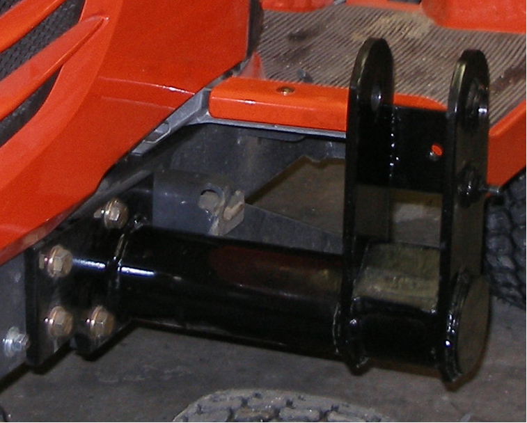

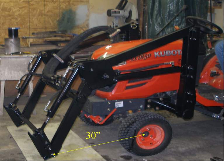

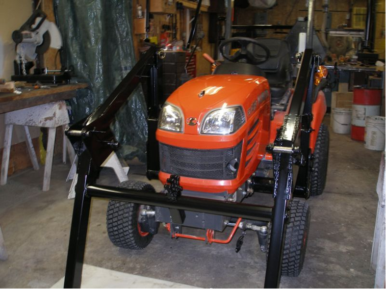

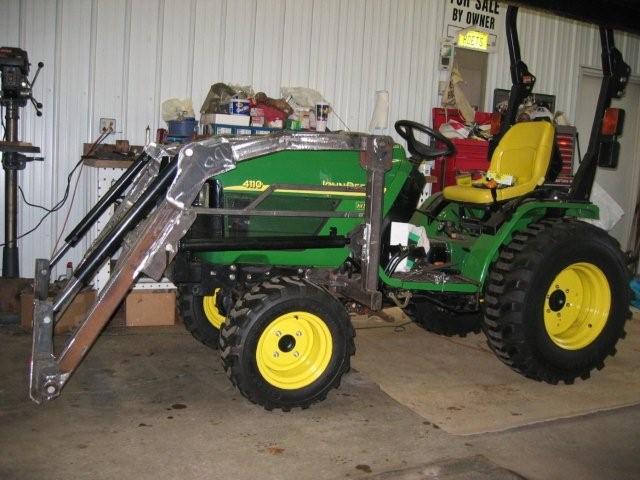

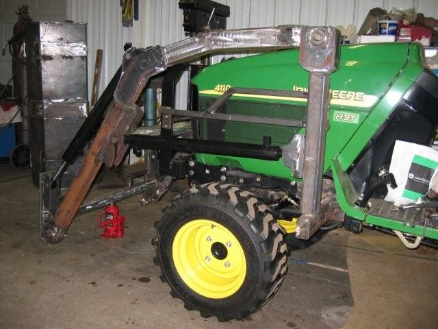

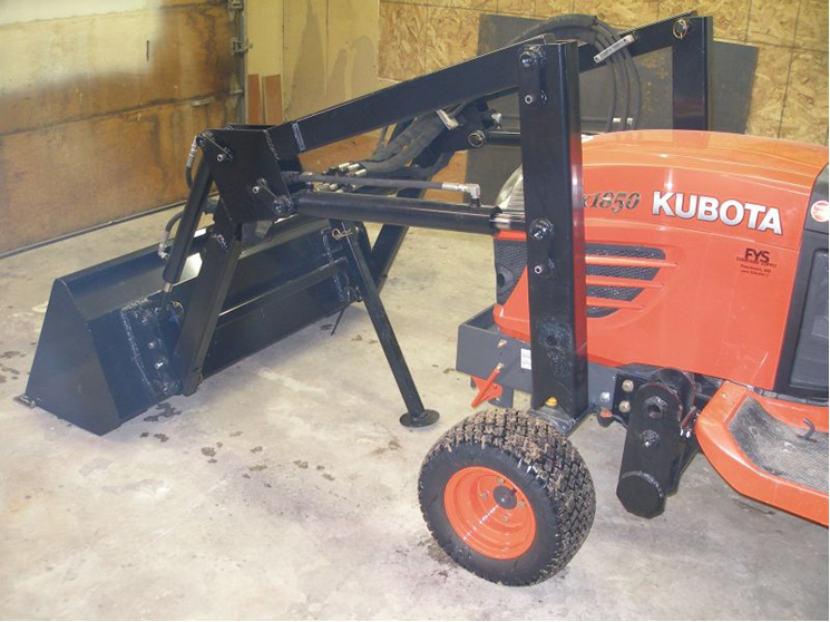

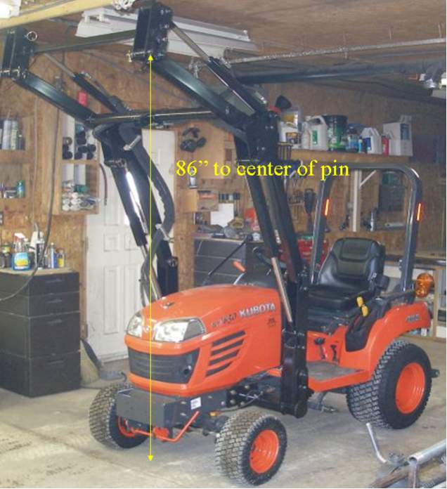

Nice work. 86" height is excellent for a small tractor. Just be careful with it.
The pics are small but it looks like you don't have a support running between the posts and the chassis. On mine they run from the post to the front grille guard (which in turn is bolted to the chassis). I think you'll see something like this on most loaders.
Hmmm, just looking at more pics of loaders, and it seems like the support bar from the towers to the chassis is not as common as I thought. But its quite common on older loaders, especially the heavier duty ones. But the newer loaders that dont have the bar sure do have heavy duty tower brackets bolted to the chassis. And most of them appear to have the ram mounted lower on the tower, which would also help to reduce stress on the tower brackets.
Read your message... your dead on. I wish I talked to you prior to building my loader, this is why I can appreciate a good critic, and learning from others is what it's all about.
   / my loader 20/20 hindsight #24

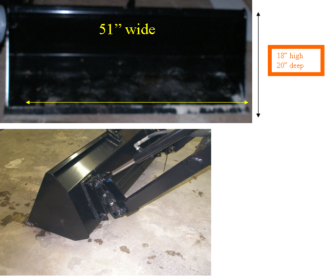

All I can say is WOW! Looks pretty good to me. I have a BX2350, and mine is mounted in a very similar manner. I don't think mine has any more braces between the loader and tractor, but maybe I'm missing something. It sounds like the lifting performance is similar to a factory unit, but I'm guessing here, you have a higher lift. Maybe between 6 and 12 inches. As you have learned, they get pretty tippy with the bucket up high.
I built a ballast box for mine out of lumber. It's pretty poor compared to what I'm sure you could fabricate. Mine is mounted to the 3 point. Look at some pictures of factory units and I'm sure you could fab one pretty easy. Make it so you can add or take weight out. 300 pounds might be a good place to start.
The support braces seems to be a bit of an option - although not a bad one considering that your posts are pretty tall and your home fabrication is probably a bit lighter than the factory stuff. You are probably treating the loader gently at the moment but as time goes by you may find yourself (or someone else) giving it a bit of a pounding... then you'll be glad of every extra bit of strength.
You obviously know how to build stuff so adding a support brace should be a piece of cake.
Incidently, on mine the support braces are bolted between the loader posts and the grill guard. The grille guard is then bolted to the front chassis with a couple of large bolts than can be undone by hand. The whole arrangement comes off with the loader. A grille guard is an excellent idea for a tractor with a loader.
As dodgeman suggested you will probably want some ballast on the back end pretty soon. Thats a fairly big bucket and its 'out there' quite a bit so you may find you have no traction, or even worse your back wheels will be off the ground, when you least expect it.
(Hey its fun critiquing other peoples stuff.)
If I'm not mistaken, your back wheel is already off the ground in this shot...

All though I met or exceeded kubotas steel requirements I am and was worried about it from the start .You are right! I am in the process making a grill guard forks with quick spade attachment this weekend, the frame support will be part of the work as well. Your word criticize is not being taken with discomfort at all. I am enjoying our discussions. As time goes on and I get to the rest of my projects [cab, quick hitch, ripper] I would encourage and welcome your critique.
