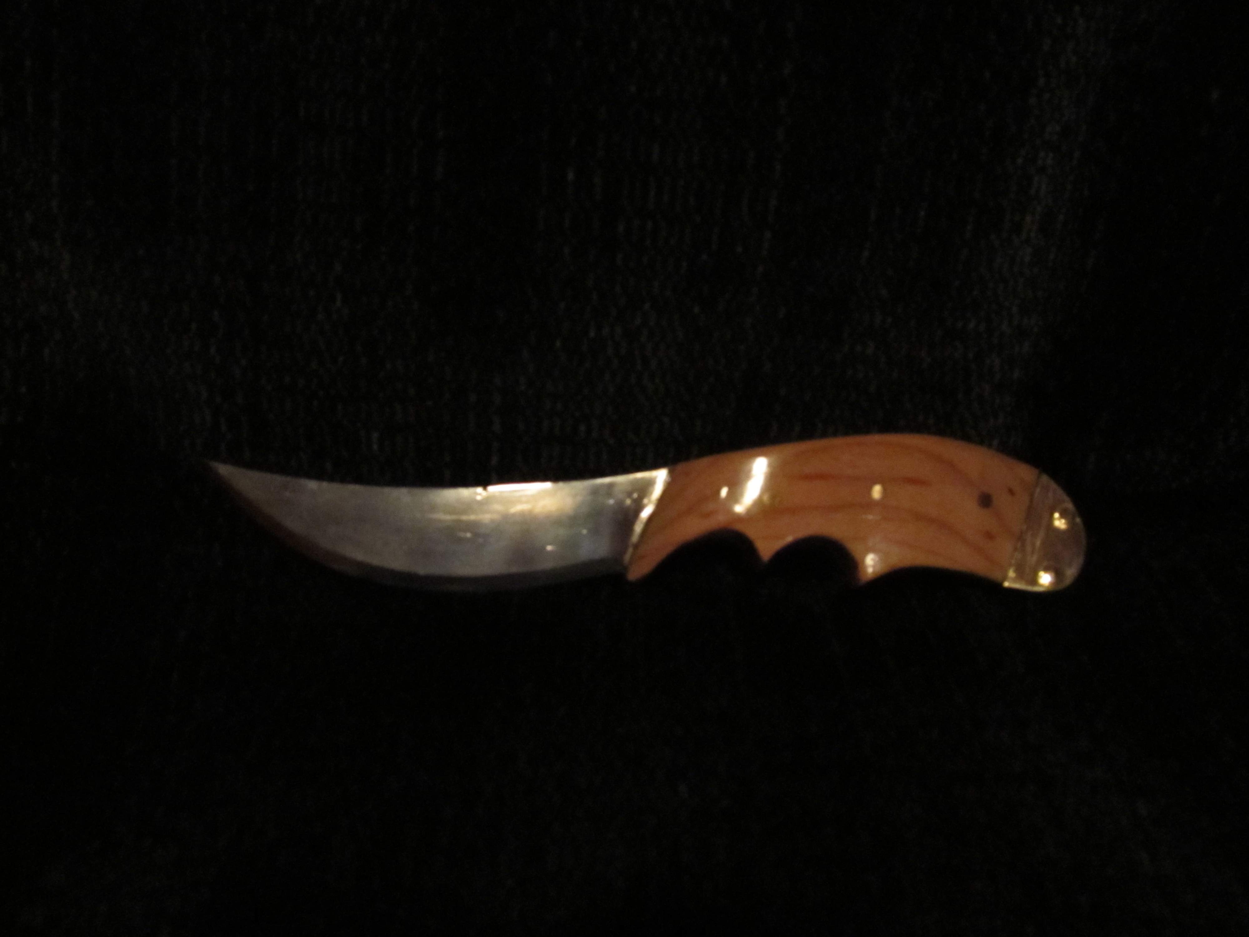

I have been making a new knife and finished it today.Every deer season after I get my deer for the last 4 years I have retired that seasons Knife and built a new one.This one will be for the 2012 season if I am lucky enough to get my deer next year I will build a new on for the next season. It is just a hoby hope you enjoy the photo, I will hand sew a new leather sheath next.
   / My Latest Knife
#2
Well I will try the Knife photo again,If you check this out and there is no photo and you want you could maybe help me caues this is my third attempt.If you help thanks

Good looking knife. I had a friend in Tennessee. whose Father made and sold knives that he made from crosscut saw blades. When his supply of crosscut saw blades became low, he sometimes substituted circular saw blades. What kind of wood is the handle made from? At first, I thought it might be rosewood, but it appears to be stained. :thumbsup:
   / My Latest Knife
It is made from a sash gang saw blade I used to be a saw filler for Hancock Lumber in Pittsfield me.The wood is Cherry it is not stained just clear poly it came from my fire wood pile.
   / My Latest Knife
Well first you have to heat it to 1460 degrees ( to aneal it bring it to a non magnetic state) I do this in my wood stove on Beach coals then cool it slowly, i cool mine by burrying it in wood ashes. Then you cut it so you can heat it back up and open it to a semi circular shape and pound it flat .It takes a while but makes a nice looking blade. I do the re-heating with a oxy acet torch and use an Anvil.
   / My Latest Knife #9
Nice work Jeff! Its nice to see excellence in American craftsmanship.
   / My Latest Knife #10
Good choice in wood. I really couldn't tell from the photo. Didn't mean to appear subjective in regards to the stain issue. Good handiwork.
