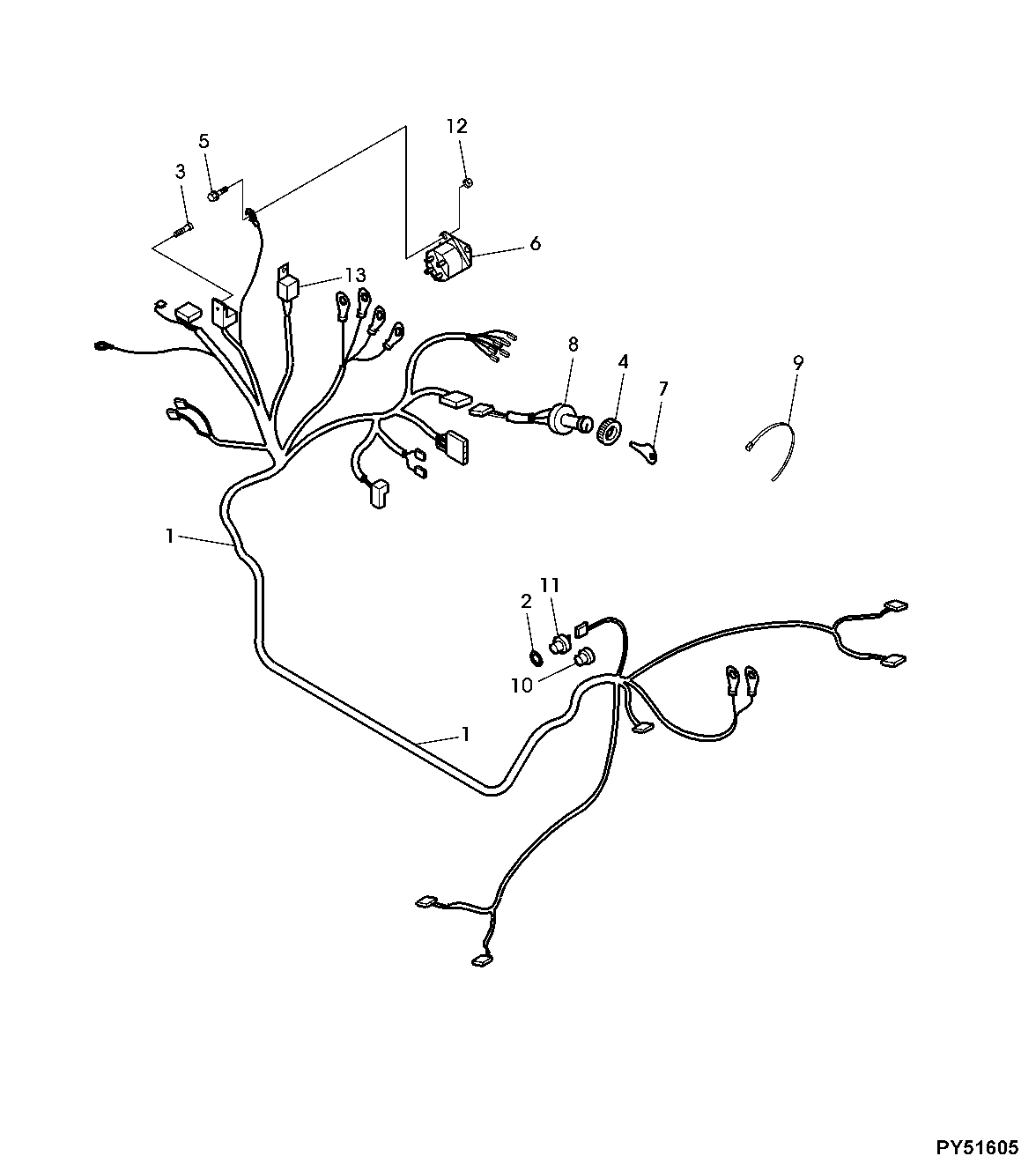

   / My JD3103 Starter Relay smoke - please help replace it
It turns out the wires that connect to Starter Relay burn and short together. I would appreciate very much for any help locating this part and how to replace it.
   / My JD3103 Starter Relay smoke - please help replace it #6
Part's key #6 RE234727 Starter Relay
