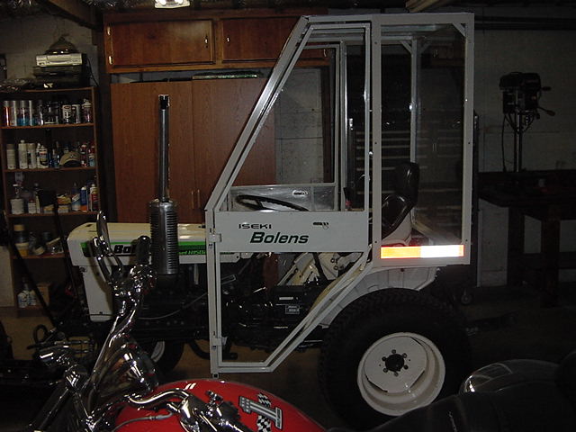

I actually used 1" square tube for the frame, and it is about an 1/8" thick wall. You could actually tip the tractor over with the cab frame I think, when you shake it the tractor shakes with it, its definitely not flimsy. The doors I used 3/4" square tube that is also about 1/8" thick wall. This sounds like it would be heavy, but two guys could remove it easily still, its not tremendously heavy. I wanna say til im done the cab alone will weigh around 200 LBs. thats without the doors since they lift off separately. The plexi pieces definitely added most of the weight.
Originally I would have loved to make this out of square aluminum, however I dont own a spool gun for my MIG welder. And after building it to the point I am at and driving it around, I think the weight of the steel helps to drown out the boiling feel of the diesel engine simply because, well steel is heavier in weight.

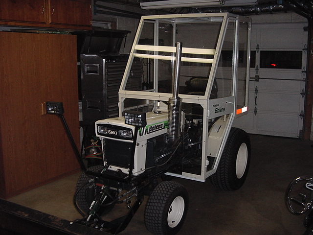

Well I managed to do a little more to the tractor as of late, the cab is finished for now except for a wiper kit I ordered for it. I even went as far as to apply some Bolens/Iseki decals on the doors as a finishing touch. And trim it here and there just for cosmetics. This project has really turned out exactly as I wanted it to. I even added some forward-high mounted lamps for use with the plow as well, as the factory headlights dont seem to do much for driving the tractor at night, they are more to "be seen" than for driver visibility.

The hood actually will not open with the cab in place, it removes. I almost made the entire cab hinge on the rear tranny mount, then swing upward to be able to open the hood, however that whole idea got left behind when I discovered how easy the hood just lifts off the tractor once you remove the front hinge bolts, then undo the hood stay straps in the rear. Very easy and much less metal working involved. I may decide to weld small band steel pieces to the front bolts to make them like large wing nuts for easy removal with no tools, I say "may" but I will more than likely do it as I have been engineering this whole project in my head for sometime, actually since April upon purchasing this tractor, and that was my first discovery was how easy the hood can be unbolted and completely lifted off. And the entire cab is 79" off the floor, tall enuf to give me room for an overhead wiper motor, yet short enuf to fit in all my garage doors and into my workshop for maintenance on it. Im 6' 1" so I needed the height also. It is actually just right for me in all dimensions.
