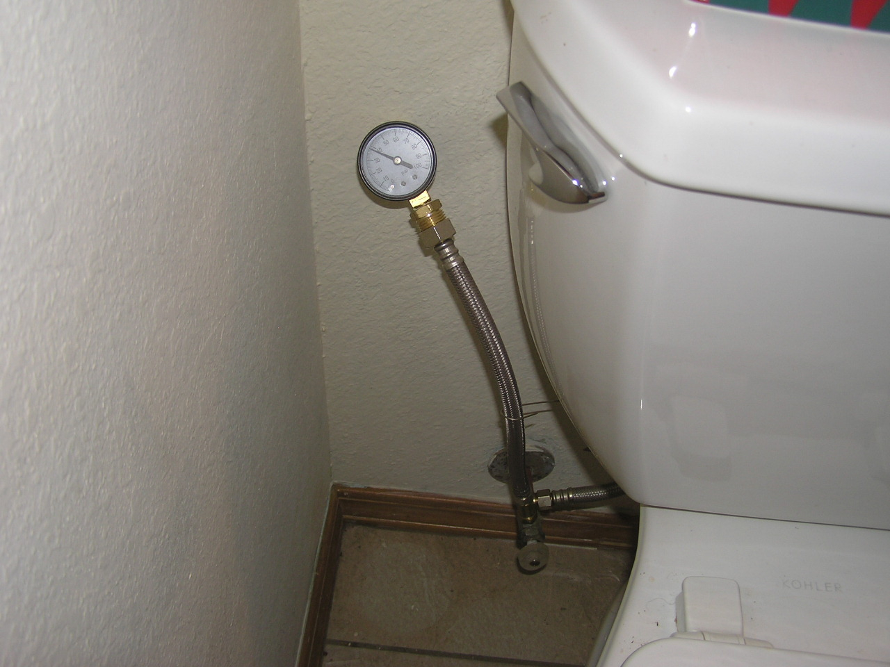

Don't forget a water pressure gauge in some easily viewed place.
This is what I did:
My Throne room is right next to my mechanical room. As I sit and take court, there will be two doors. One to my left goes back into the bathroom. One to the right goes into the mechanical room. All I have to do is take a peek and I see the gauges.
