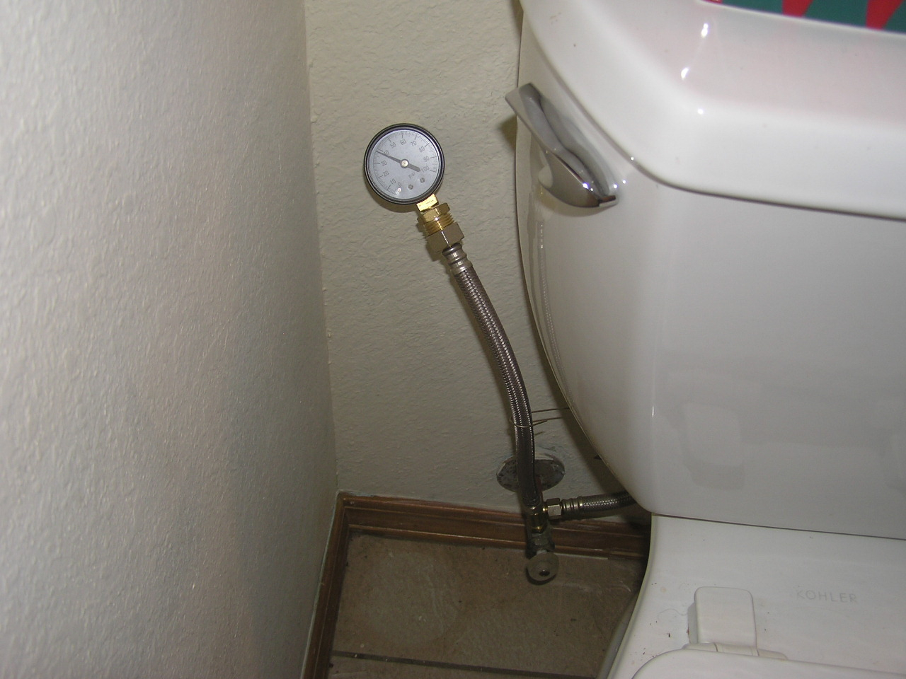

If there is no water pressure gauge easily visible in the house, do this:
I added a tee and a short hose to the shutoff valve.
