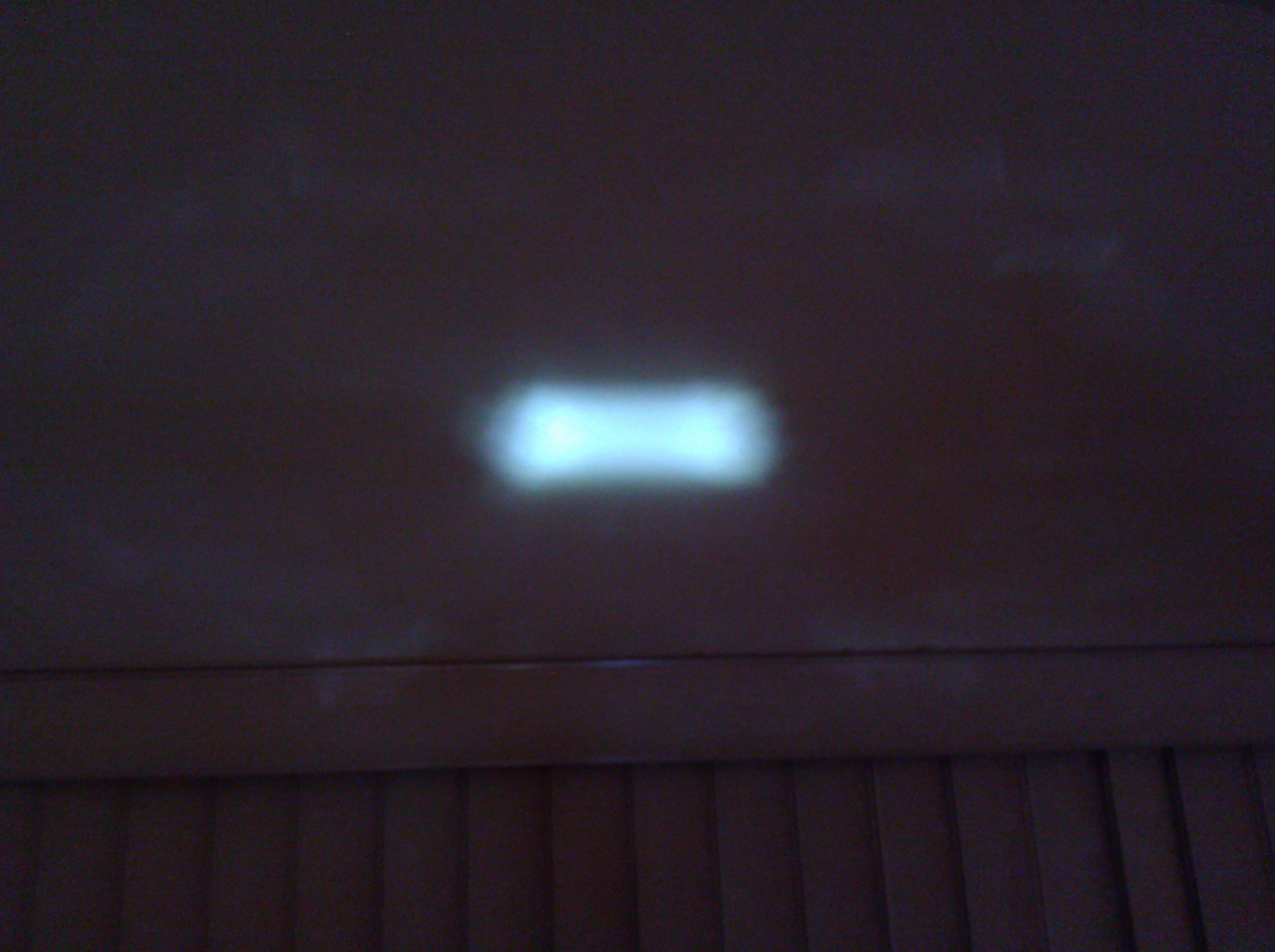

I had a Pep Boys gift card so I went down there today and found a set of LED fog lights. They are about 3 1/2" in diameter and have mounting brackets included. I tested them in the garage tonight and the lights are very bright but they don't spread as much as the fog lights on the cars. They are brighter than the headlights and it seems like the pair draws about 1 amp. I will hook them up with a inline amp meter to check the actual current draw. They were very expensive at $ 50.00 but with the gift card.....
I am thinking of mounting them on the tie rod end, then when I turn the steering wheel they will also turn. It looks like I can remove the nut from the tie rod end and put a small bracket under the nut and tighten it up. Maybe a piece of sheet metal with a hole to clear the stud. Then I need to figure out how to route the wires so they stay out of the way when the wheels are turned. The good news is the fog lights have both the positive and negative wires so they will not need a ground.
Keep in mind my GC2410 does not go in the woods and I try to not even get it wet except for when I wash it. I do wonder if there would be a way to mount some of the other LED fog lights that I see on ebay on the tractor for work lights on the ROPS and maybe even on the backhoe. The LED Fog Lights on ebay are much more reasonably priced and I could use the spare power connector. Or maybe if I replace the headlights and tail lights with LED bulbs I could put a couple more LED worklights on the rear of the tractor. I also noticed there were several 18 and 24 watt LED off road lights for Jeeps etc on ebay, maybe one or two of those mounted under the ROPS connected to the spare power connector.
I have a bunch of 3 watt LED Maglight flashlights and they are super bright so I can only imagine what a 18 watt LED would light up.
Anyway, Happy New Year and I attached a couple pictures of the lights more to come when I mount them. The picture of the light pattern on the wall show it about a foot wide from 4 feet. The light is just powered by a watch battery, the pattern is wider when it is hooked up to 12 volts.
Bruce
