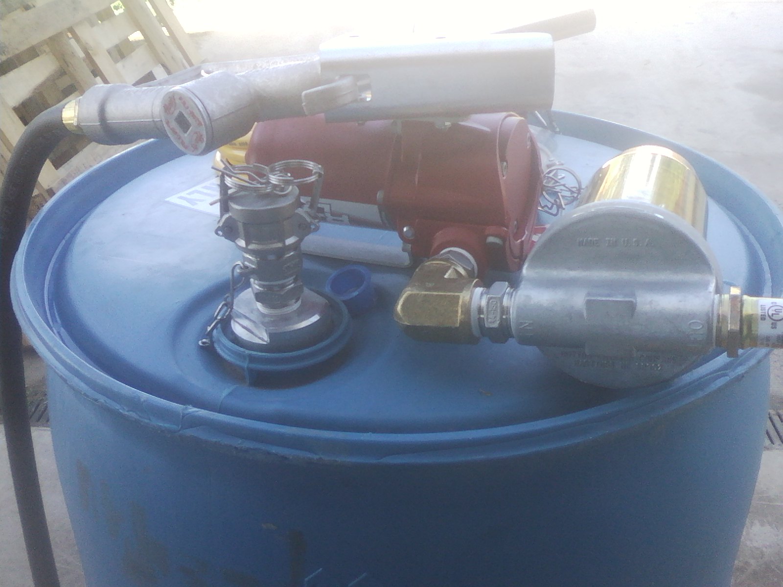

Its been raining a lot so I had a chance to put together most of my 55 gallon drum filling station.
First I used a Fill Rite RD 8 portable 12 v pump. It comes in several configurations, but I got the one with the barrel bung and suction pipe. I used stainless fittings, except for the top 90 (store was out of the SS ones) I went with the smaller pump as I dont need a lot of flow. After the pump I installed a large fuel filter (Water Block element). I went with cam lock fittings so I can remove the pump when I go to fill. It also allows the pump to swivel some. The fuel cap came from TSC. Got it out of their sale bin as the package had been opened..
I haven't filled it yet as I am still working on how to secure the barrel to my plastic pallet. I went with the plastic for long term durability. I tried just strapping it down, but the bottom will slide too easily on the pallet. I am thinking of picking up some 1.5" aluminum L channel, and slicing on side so it can bend around the barrel base and then bolting the bent L section down with bolts with fender washers to keep the barrel bottom in place. Any other ideas. The barrel used to contain ethanol so should be good for diesel per the oil dealer I got it from. The warning stickers also cam from TSC - required here.

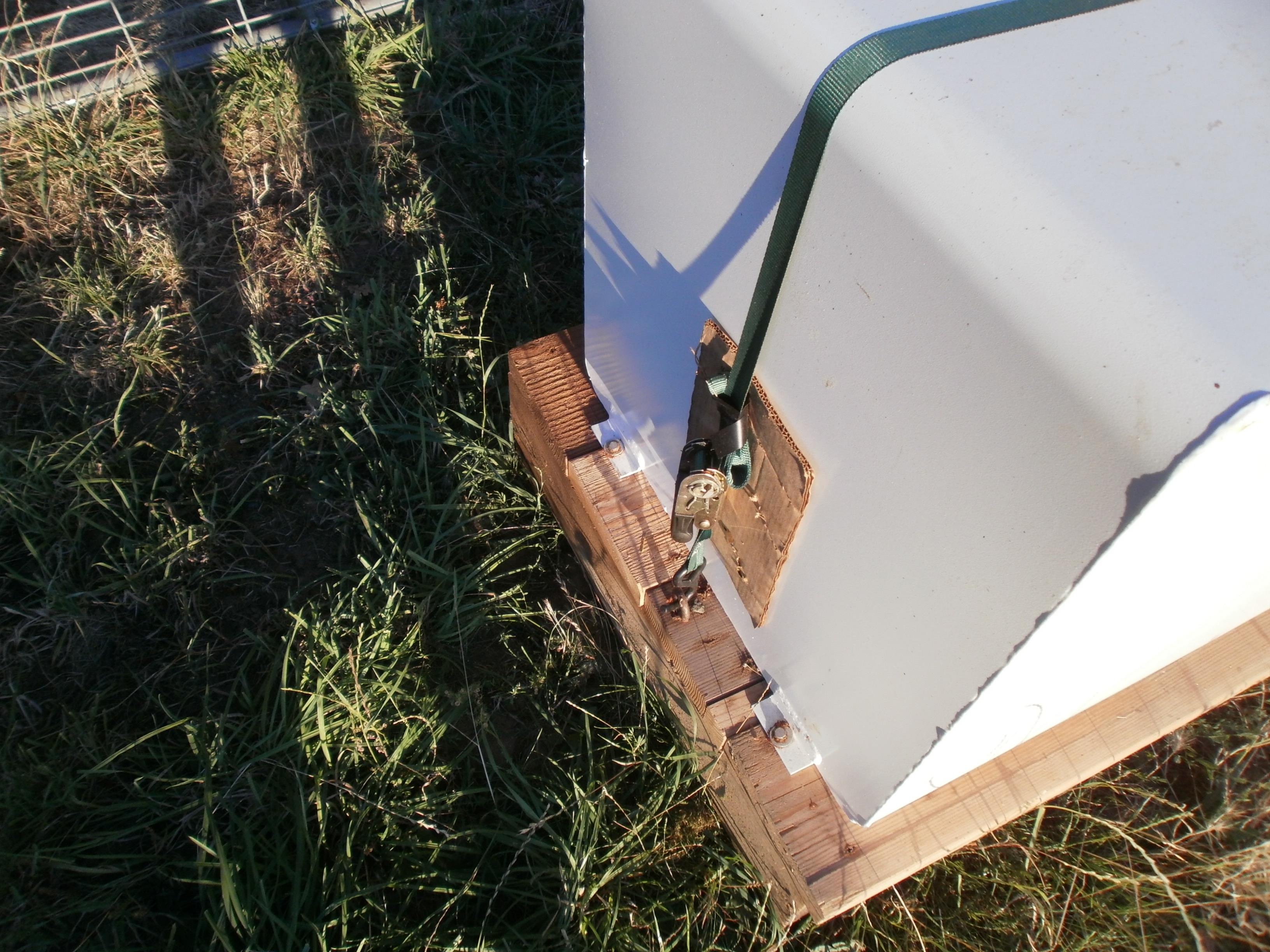

ALWAYS I enjoy everybody's input on this stuff. I have had used an oil drum for thirty five years, tucked away in my woodshed with an ol Tolkiem hand operated pump and a see through filter bowl with filter. It was always a hassle loading up and unloading it when full. This summer I nicked it with my FEL, and I was able to patch it after wrestling it and laying down on its' side. I figured I was pretty lucky and spewed two or three gallons and that it was time to get proper unit.
I went down to the farm store and bought a rectangular container, mounted it on a small pallet I made and because I have SSQA forks, I have now made me a nice portable fill station that is a heck of a lot more stable and easier to handle.
I don't use enough to justify packing a permanent transfer tank in my pickup.
No need to bend or wrap anything. Just cut 3 or 4 4" sections of angle iron (or aluminum, if you prefer) and bolt it to the pallet at either 90 or 120 degree intervals. You don't need 100% contact with the barrel to keep it in place, just enough to stop it from moving in that direction. Trap it in three or 4 directions and you have it secured.
   / My fuel station build (55 gallon drum with portable RD 8 Fill Rite pump) #10
Just make sure your fill cap is not completely air tight or you might collapse the plastic drum after pumping out several gallons of fuel. Otherwise it looks like a pretty workable fuel storage system.
