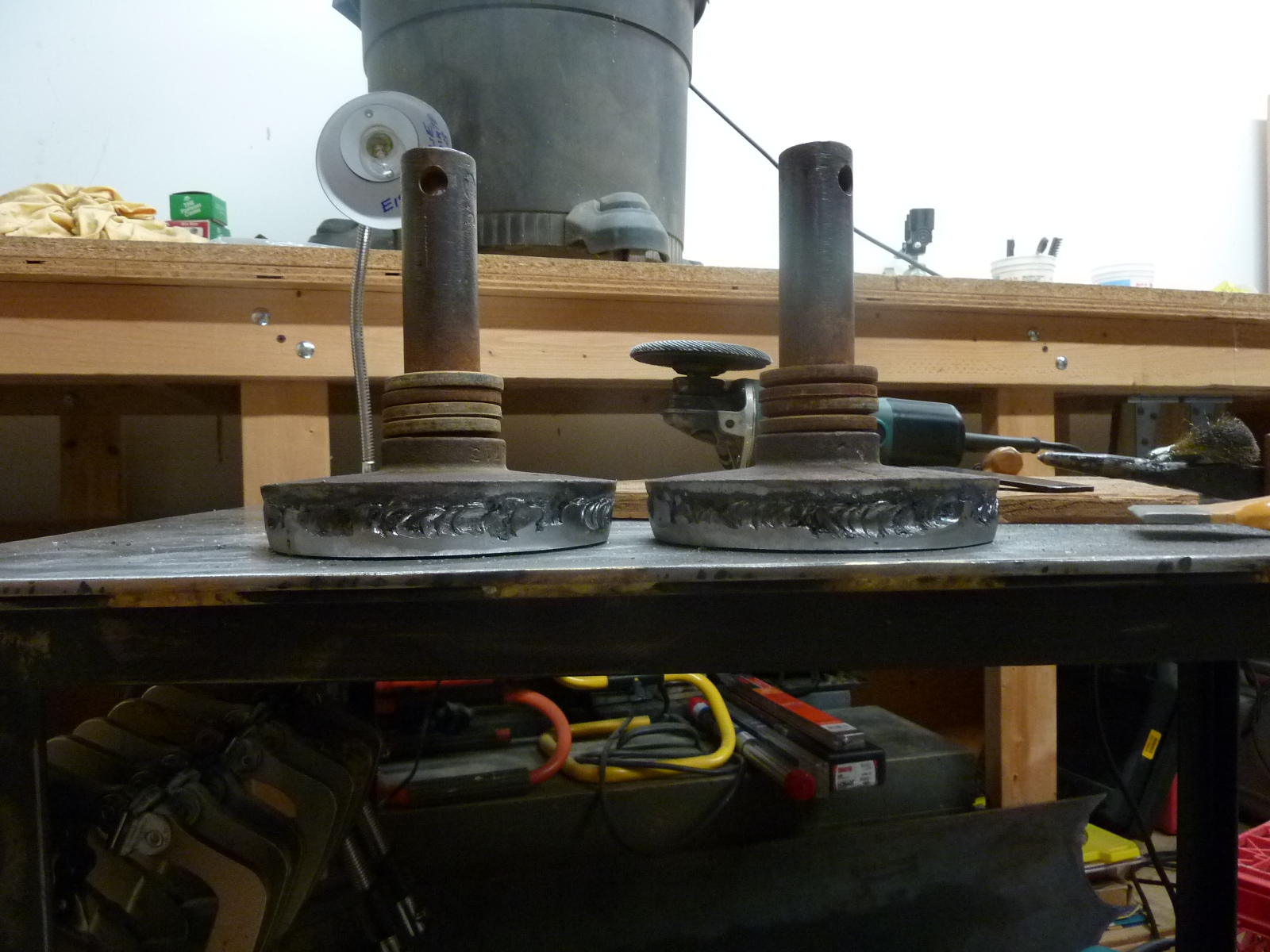

I bought myself an old tombstone AC welder and I am learning how to use it. This is my "ventilation" system plus I have the cellar door open a crack. Works good. I can see all the smoke going into the "hood" as I weld. I don't even set the smoke detector off and my wife says there is no smell upstairs.

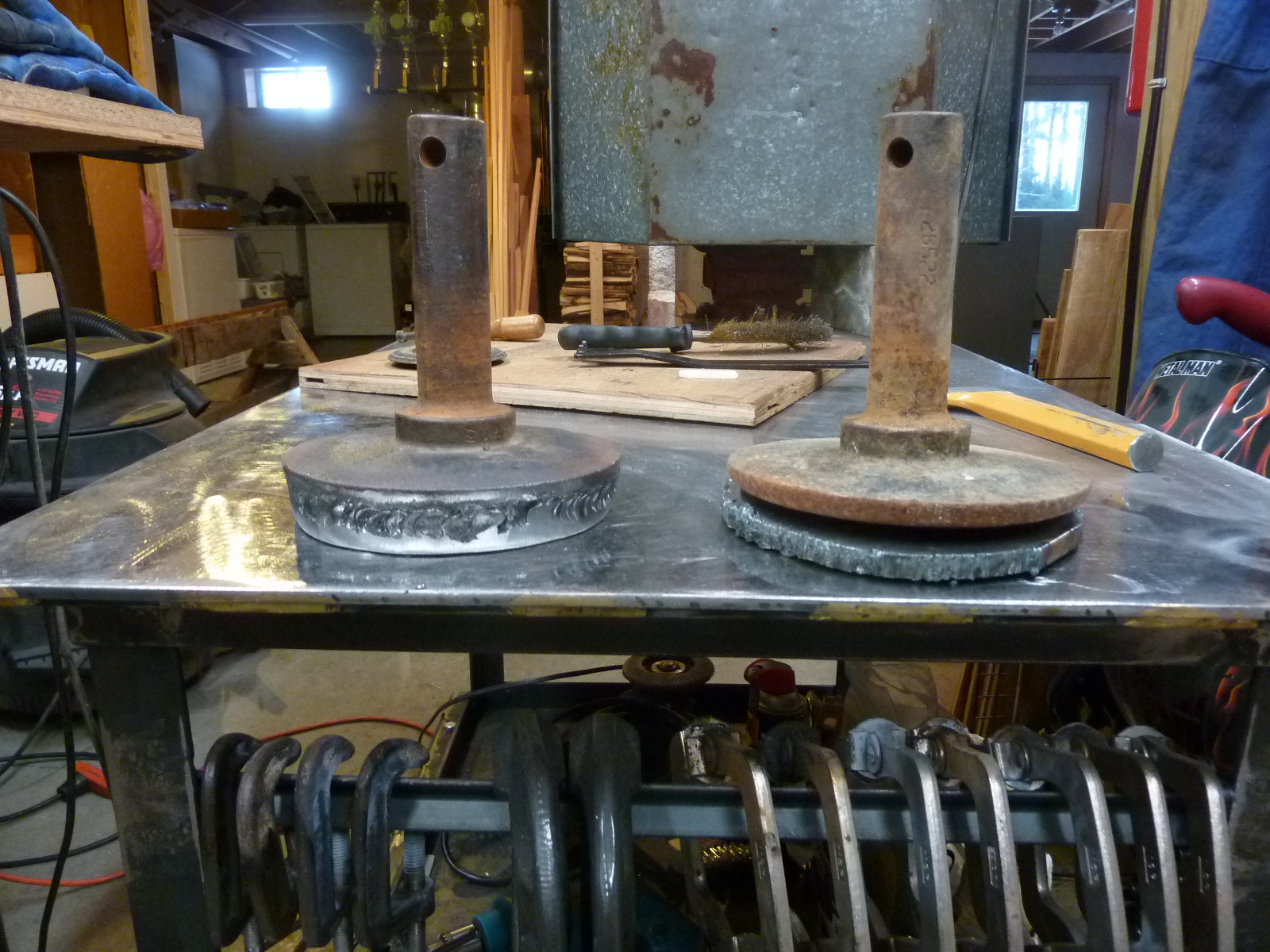

Anyway, I thought I should do something that doesn't matter for a first project. But I wanted to do something heavy. So I built up some worn down plow shoes. Harmless enough. These are utilitarian welds not those of a craftsman. :) Doing this is a lot more interesting than just laying beads like I have been doing.

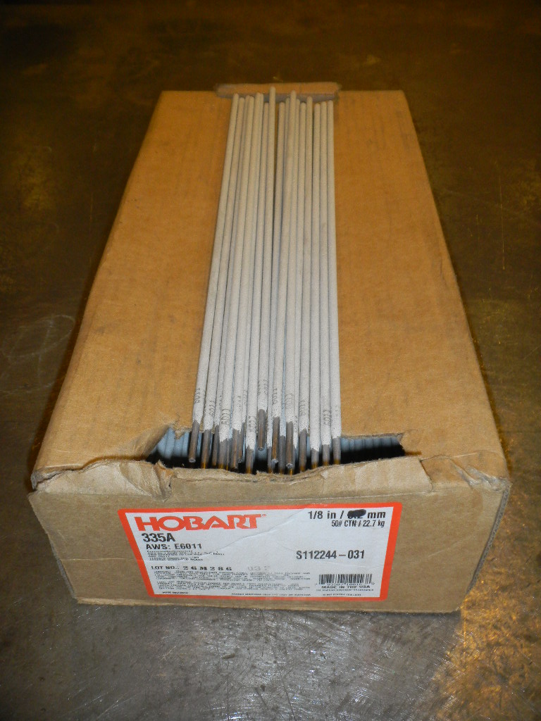

If you go to buy some 6011, I really like Hobart's 335A 6011.

That is Lincoln Fleetweld 180 (6011). An almost full 5 lb box came with the welder along with some 6013 and 7014 which I have not tried yet. The 6011 is just about gone now I might try the Hobart. I have been keeping everything the same so I can see if I am getting any better at it. Which I am, even thought you can see from my work I have a long way to go.

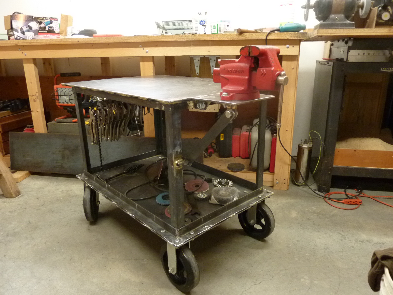

Thanks Dragoneggs. I built the table with my torch set along with some advise I got here. In the same "shop". It is one of the handiest things I have. I use it for everything it seems. It was my first major welding project.

Nice welding table. Only thing I would have done differently is use non-swiveling casters with locking capability.
