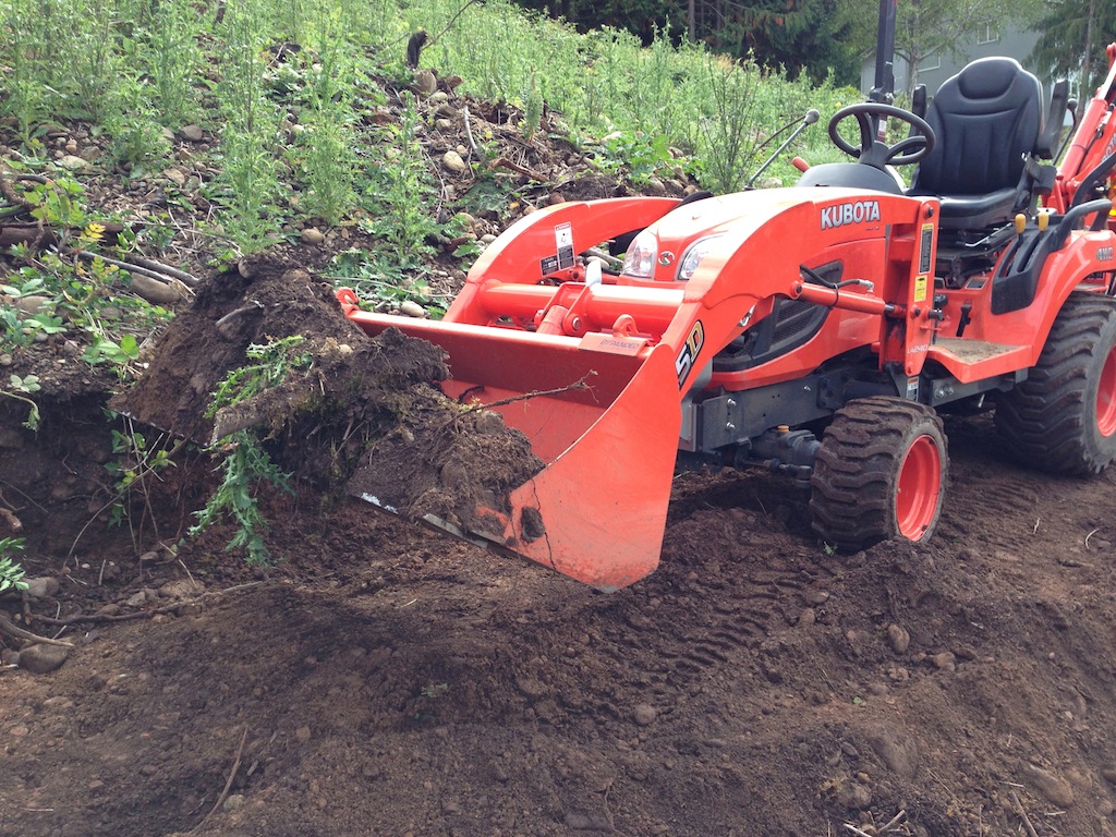

Who says loaders aren't meant for digging :D
View attachment 335818 View attachment 335819
Did the Piranha tooth bar loosen up all the soil in the bucket?
Yes... but I have to admit... some of the soil is loose because I had an excavator come in and clear about 4 months ago. But I am digging well below grade and what he tore up. I could not do this without the PTB. Prior to installing it, the straight edge of my FEL could dig a thing. The tooth bar dislodges rocks and will cut wet clay (although I have only a few spots of that), pull large roots and gives me a little more volume in my bucket. Absolutely love it. Best mod I have done. Well maybe the wheel spacers saved a rollover or two, so that ranks up there too!

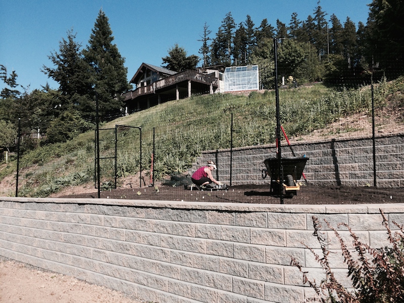

Okay a brief update after letting the winter settle things out. I am happy to report that I have not had any settling of the blocks and things seem to be in great shape and the drains working. We imported some garden soil and I just finished surrounding the garden with deer fencing 7.5ft high and installed a three foot gate. Here is the latest... I caught my wife in the 'pen' this afternoon planting starts!
