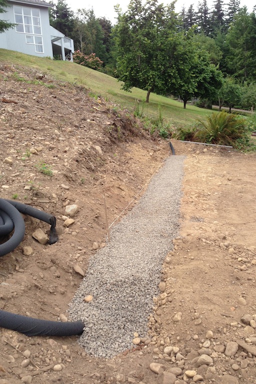

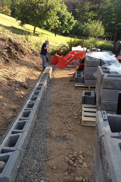

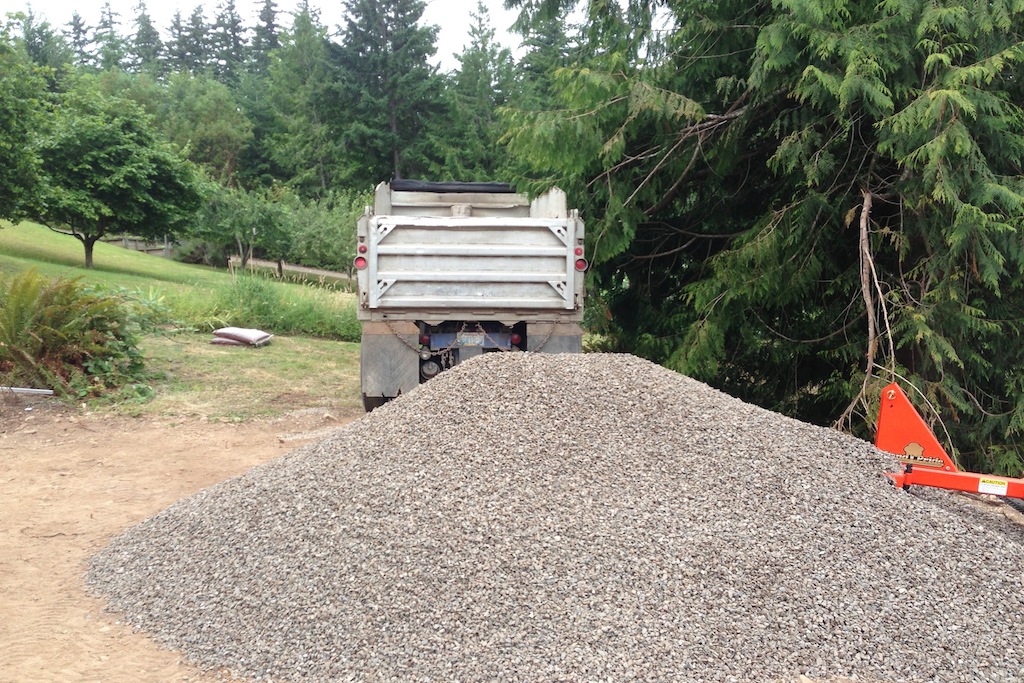

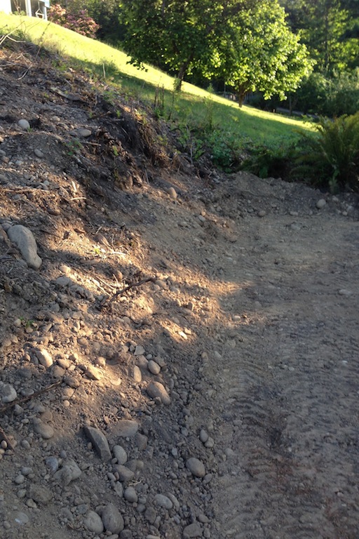

Okay trying to tame my steep slope on 1.5 acres of incredible view property. Most of the slope is 20 to 25 degrees, some up to 35 degrees near house. Starting at the bottom. First wall will be 4 ft using Allan Blocks. These are 8 by 18 by 12 and weigh about 75lbs. Here are some initial pics...
First pic shows initial cut into hill
Had 10 yards of 3/4 crushed/clean delivered... oops! Misjudged the load and partially buried my Landpride Rake :shocked:
Cut trench, laid down perforated drainpipe, covered, leveled, and tamped gravel
First row down and filling with gravel and tamping (with beautiful wife that is carrying blocks with me!) :cloud9:

I plan to put a sheet of plywood behind the wall as I build it up to hold the gravel backfill next the wall and allow me to push fill behind it from the slope. Haven't seen that trick before but I figure I can fill in a course at a time and then pull out the plywood sheet and reposition. Comments?
   / My first of many Retaining Walls to tame my slope - DIY #4
I plan to put a sheet of plywood behind the wall as I build it up to hold the gravel backfill next to the wall and allow me to push fill behind it from the slope. Haven't seen that trick before but I figure I can fill in a course at a time and then pull out the plywood sheet and reposition. Comments?
We repaired bulging basement walls on a few homes when I worked concrete. We used a sheet of plywood when we backfilled to keep the stone against the new wall from mixing with the backfilled dirt. We put large C-clamps on the top edge of plywood and used tooth of tractor bucket to lift it up as we went. You won't be able to lift it by hand.
Good idea. Just installed hooks on my bucket. Could be first use! I was figuring pulling the plywood up after filling about 1ft of gravel and fill on each side. How deep did you fill before pulling up plywood?
