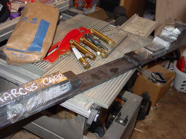

#20
moved to the My first Grapple thread
