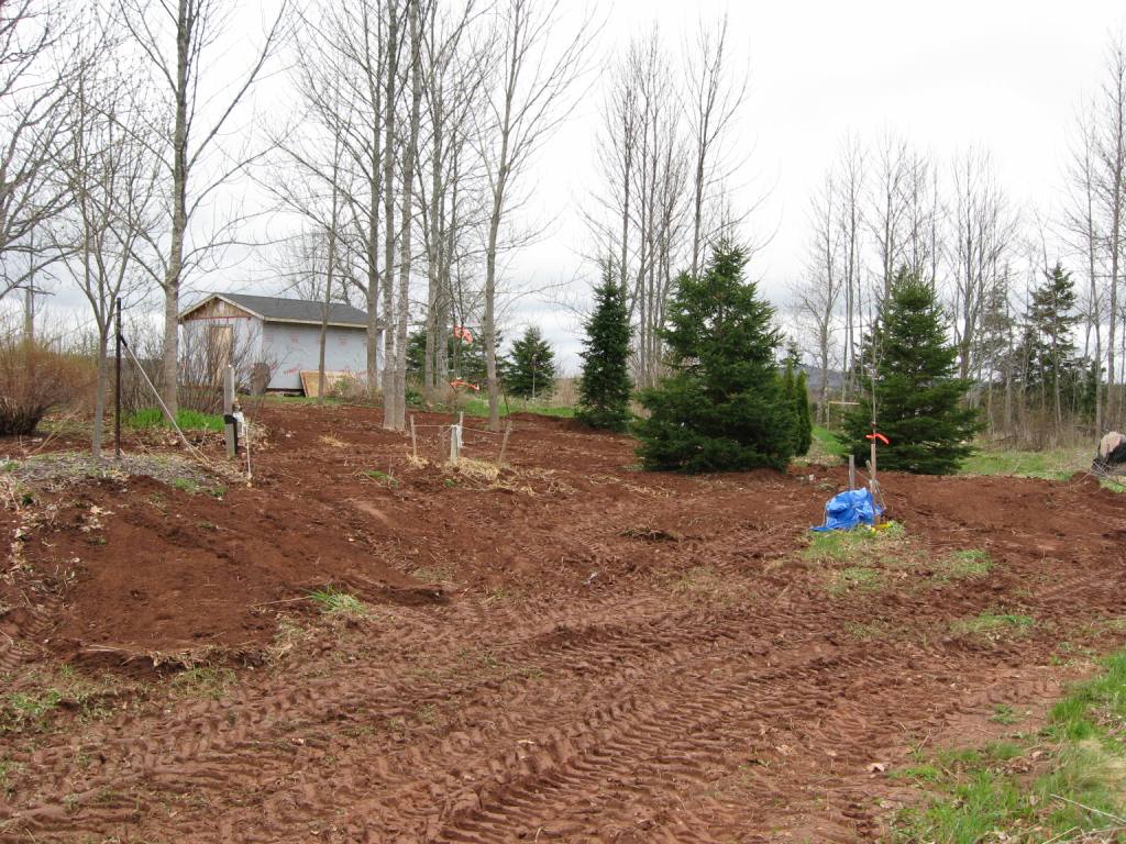

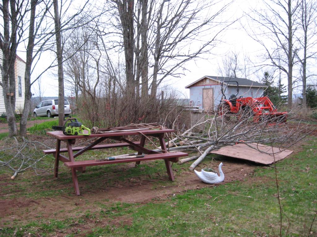

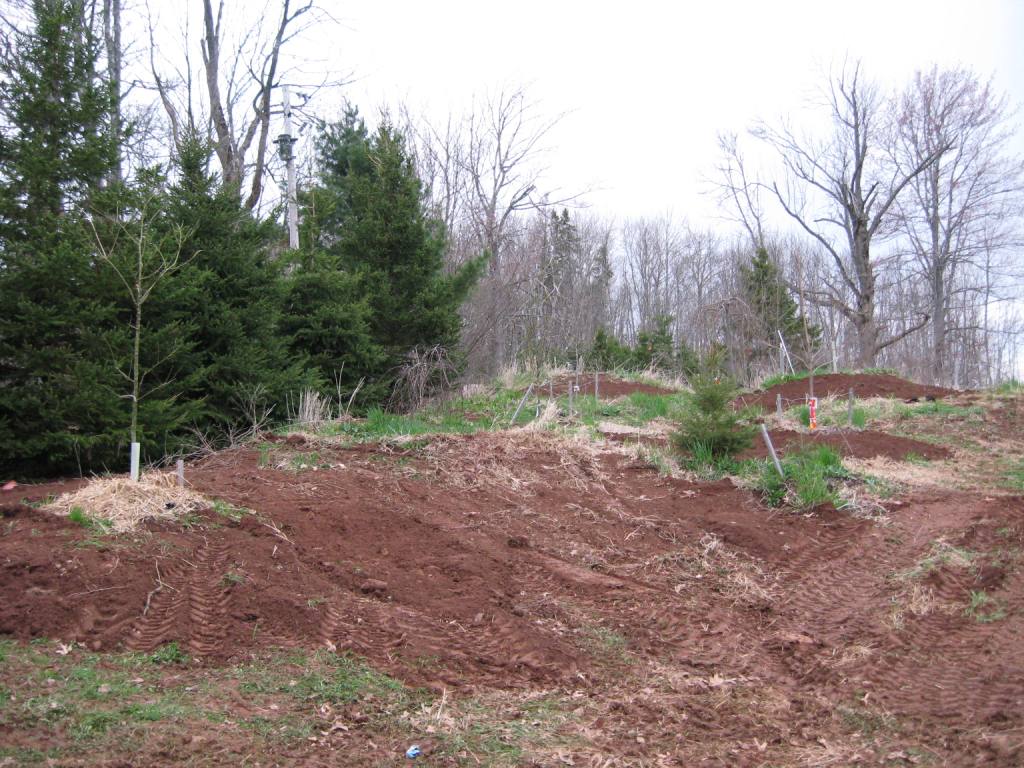

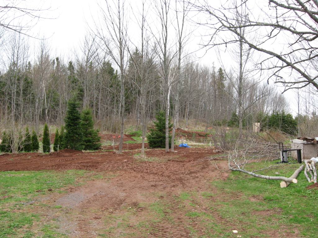

Well after buying my new toy I was out of the country for three weeks and work was a zoo when I came back so I didnt have a chance to even work it.
Well I put 6 hours on it this weekend moving wet topsoil around, leveling off a few things, and generally learning how to use it.
I thought that I might have bought a bit too large of a chassis size but it sure is nimble for its size.
I knew the hydro would take some time to get on to and with all the options of the 40 series it did take a while. Once I figured out that the auto throttle should only be used for traveling and not work I was off. I love the stall guard feature which makes this unit worth the extra dollars itself. The Kubota hydro is so precise and easy to use.
One thing I noticed that didnt make sense to me is the HST response setting is taken into consideration with the stall guard feature. If you have your response set to slow the stall guard will not react quickly enough to reduce engine lugging. No big deal, when I am mowing I will just have it set to med or high.
I love my new Kubota and cant wait to get more seat time after it dries up.
I dont have any WOW pictures but just a few of after the dirt moving.
More to come as I start the projects...
