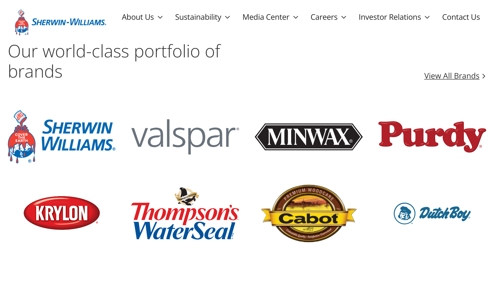

From what I understand, Valspar owns Sherwin Williams. The Manager at Sherwin Williams told me that they the paint they sell at Lowes is cheaper then what they sell it for in their store, but it's the exact same paint. Since the Lockdown, I've been going to Kelly Moore instead of Sherwin Williams. They did not go so crazy with things, and they have not run out of paint like Sherwin Williams has. On my own home, I use Valspar paint. I think it's as good as anything else, but for a better price. My clients all want Sherwin Williams.
