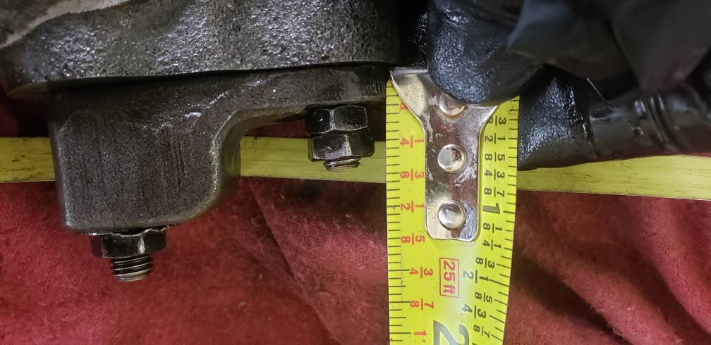

Secondly I am glad to report that I put my ole 1700 thru the wringers today for 8 hours of grueling heavy work. I pulled many wood posts out, skidded logs , cut and moved brush and made a big brush pile (Relatively Speaking). The hydraulic system passed all the tests with flying colors. I had hard time pulling some of the posts out and at times raised the front end also. I was careful not to screw it up:D :D . I have put the tractor in barn for winter hibernation and gave it a few months off because of good performance today. I think all the hydraulic repair I have done did the trick. Thanks a lot for all the good inputs I received.

J.C. I have been having trouble with my 1700 hydraulics too and have cleaned the filter repeatedly and changed the oil a couple of times and made sure I got all the old gunk out of the differential and after I use the tractor for a couple of rounds of mowing, the hydraulic pressure goes down and I am dragging my brushhog. I have to let it cool down and then take it back to the barn!
I was inspired by your article and bought the seal kit thinking that might solve my problem and I took the pump off and tore it all apart and replaced the seals and now it has NO pressure and I thought I let it run long enough that it should have been primed like you mentioned.
I have a few of questions.
1) Are the seals to be flat side down? If not they didn't seam to fit flush. I couldn't find my manual. Didn't know if this might be the problem or not.
2) The pump seemed hard to turn by hand after I put it back together and tightened up the screws. I did not check it before I tore it down to see how free it was. Why do you think it was hard to turn? It got hard when I tightened up the allen head screws. Do they have a specified torque?
3) I was going to get a pressure gauge and test the pressure just to see how much pressure it was making if any. Can you tell me what size the fitting is needed to attach the hose and I read in another post that I needed a gauge that would read 3K PSI. I assume I would need a special hydraulic hose for the gauge too?
ALso NH sold me the wrong gasket for the pump. I have a square one and they sold me a round one, but was 75 miles from the dealer so I used the old one. It was not in bad shape. Do you know if there are different series pumps and gaskets?
One last thing - I did buy a new seal for the pump, but did not install it. Do you have a good procedure to change it.
